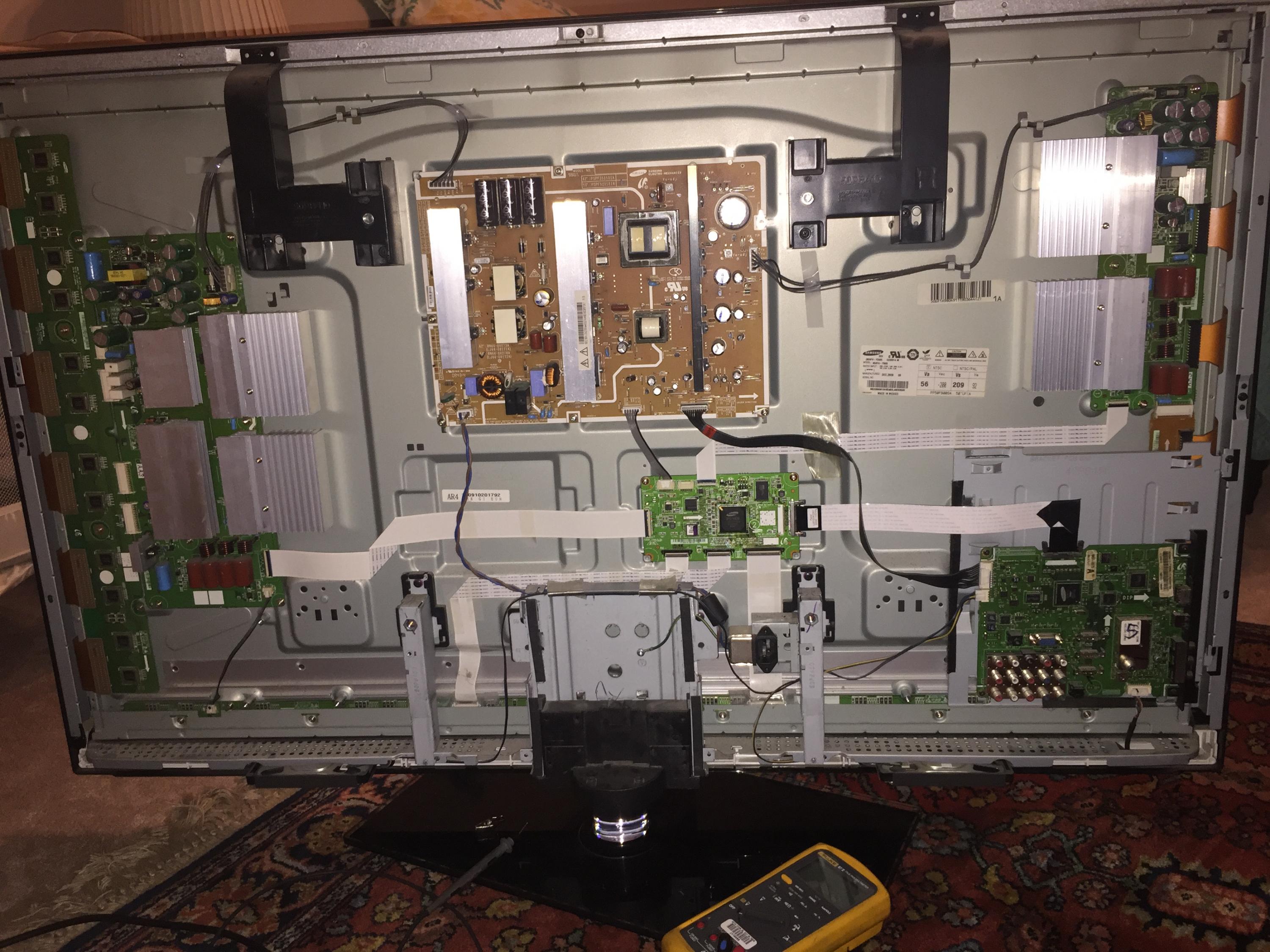

    Samsung plasma pn50b550t2f power on/off
    Hello, i have a 50 in samsung pn50b550t2f. when i power it on it clicks to turn on, then clicks off. if i leave it plugged in it will continue to try to turn on then power off. I have unplugged my x sus and y sus and problem still remains. If i unplug the t-con board (aka logic board) it will power on but still no picture.
    on my pcb i have all the proper voltage at the pins, stand by voltage ect. the only problem with voltages is the VA test point gets to 36 volts before the tv will power off, should be 58 volts. VS is 3 volts, ve 3 volts and vscan is 0, granted tv only powers up for a couple seconds.
    no bulged caps, no burning smell, no signs of arcing. Im looking for guidance of where to go next. I was going to change out my PCB and/or logic board but i dont want to throw a bunch of money into this set. i read there is a small chance it could be the main board.
    *A service manual would be ideal*
    Thank you in advance everyone

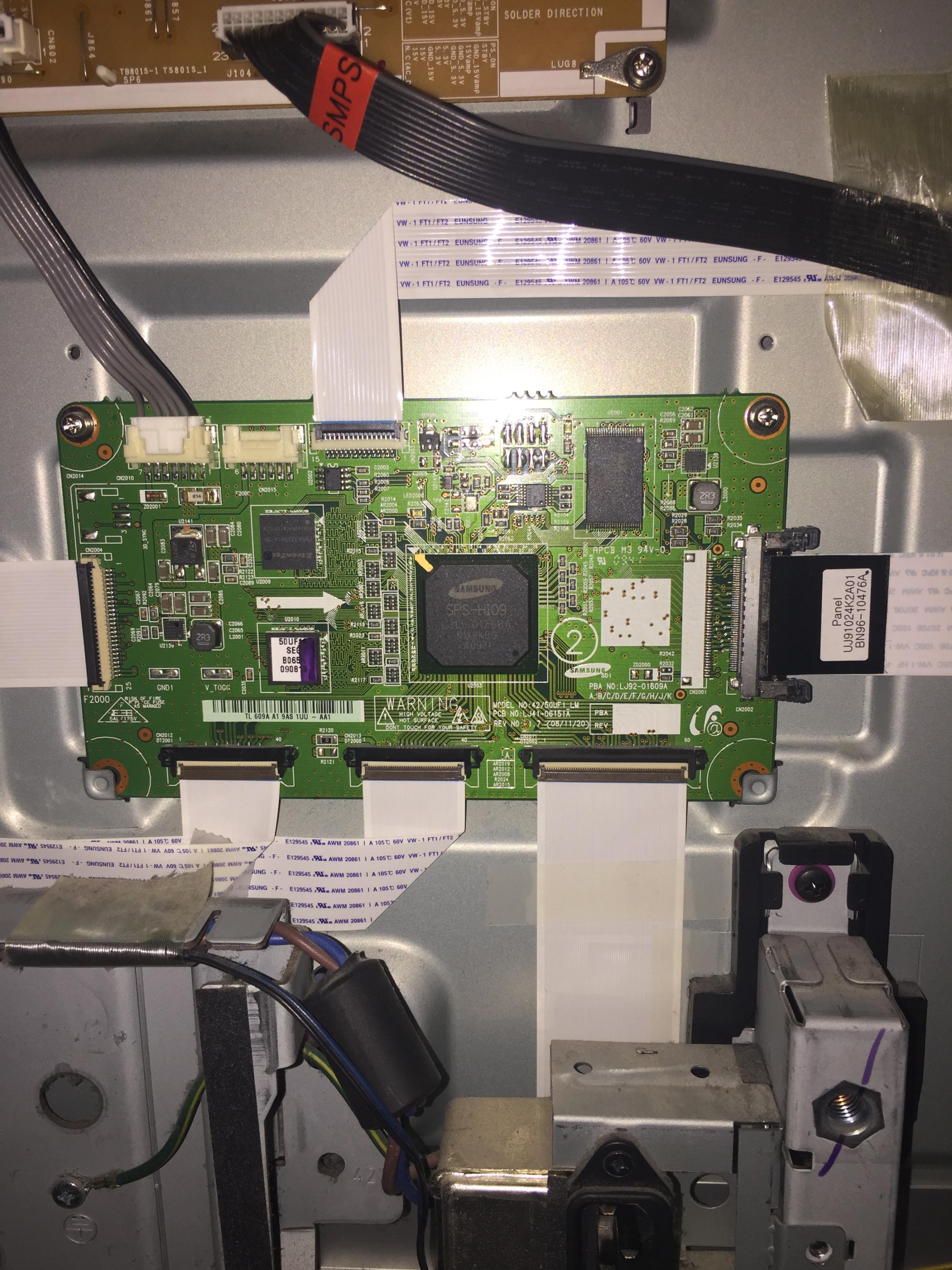

    Re: Samsung plasma pn50b550t2f power on/off
    Hi bsickler,
    I've just discovered that my own main board had a burned out processor. If you want to make sure its a main board issue, I'll recommend that you go through the two last steps in this video https://www.youtube.com/watch?v=JjrwTZC5nVg
    Short the VSon with gnd (RTN) on the power cable running to your main board. Remove cable from logic board to main board and short the two highest pins on the logic board. Your TV should then run through test patterns on your screen and you have then confirmed the issue is the main board.

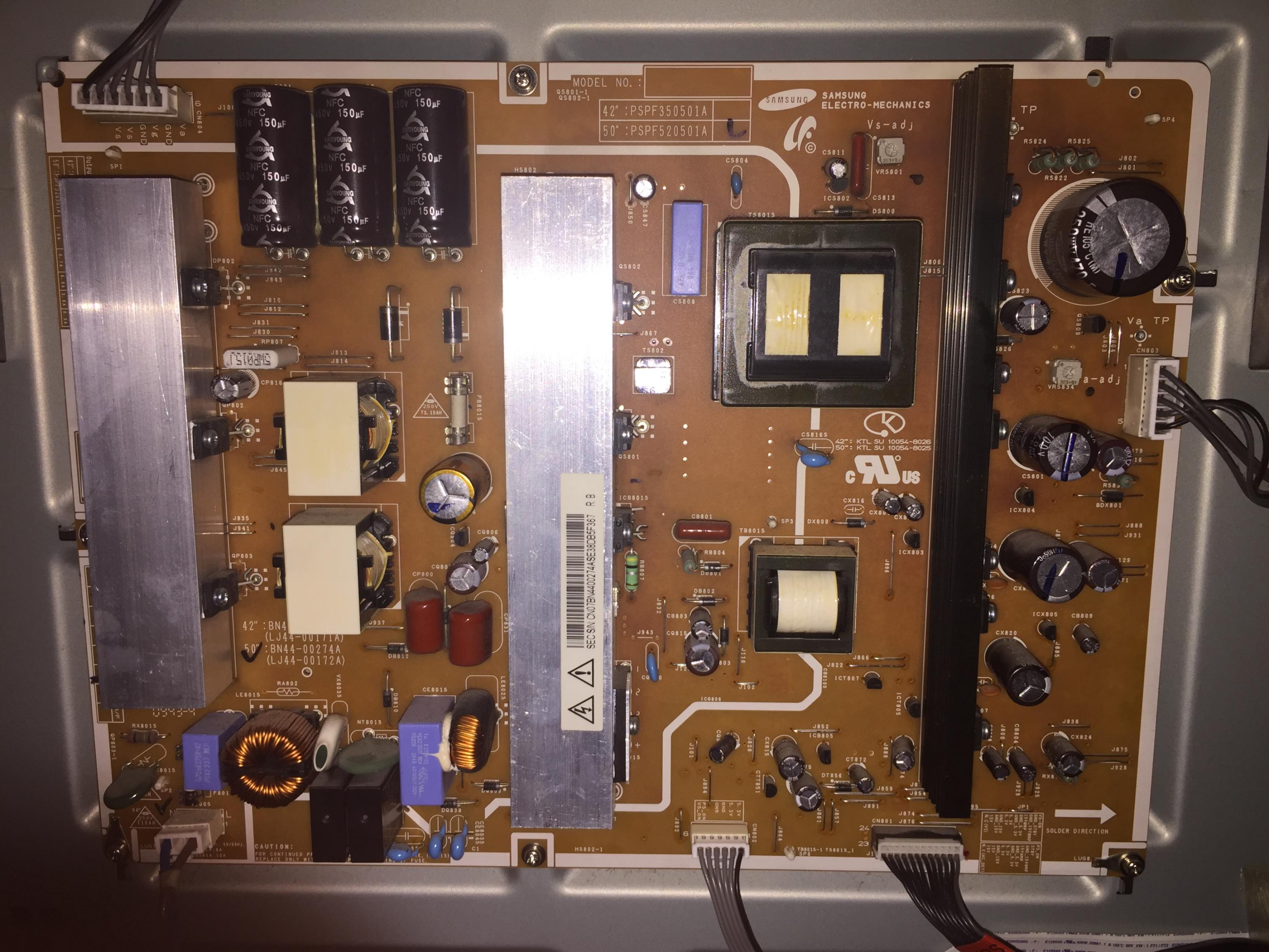

        Hey guys, looking into a new power supply, I can't think of anything else so I'm totally open to ideas from the pros on here. Any recommendations on a trusted company so indoor waste my time ordering a bad board? If anyone has any further troubleshooting ideas in game. Thank you

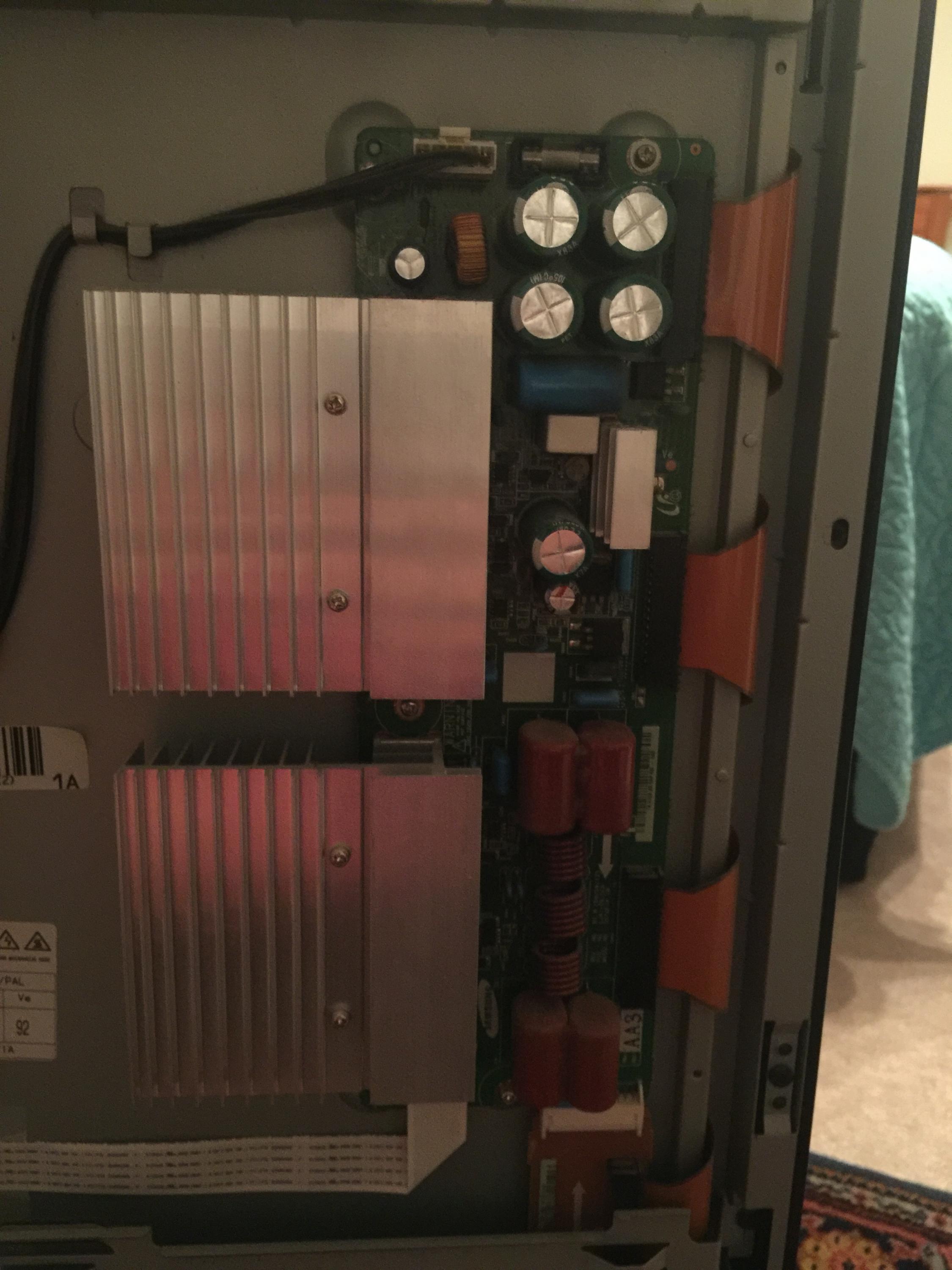

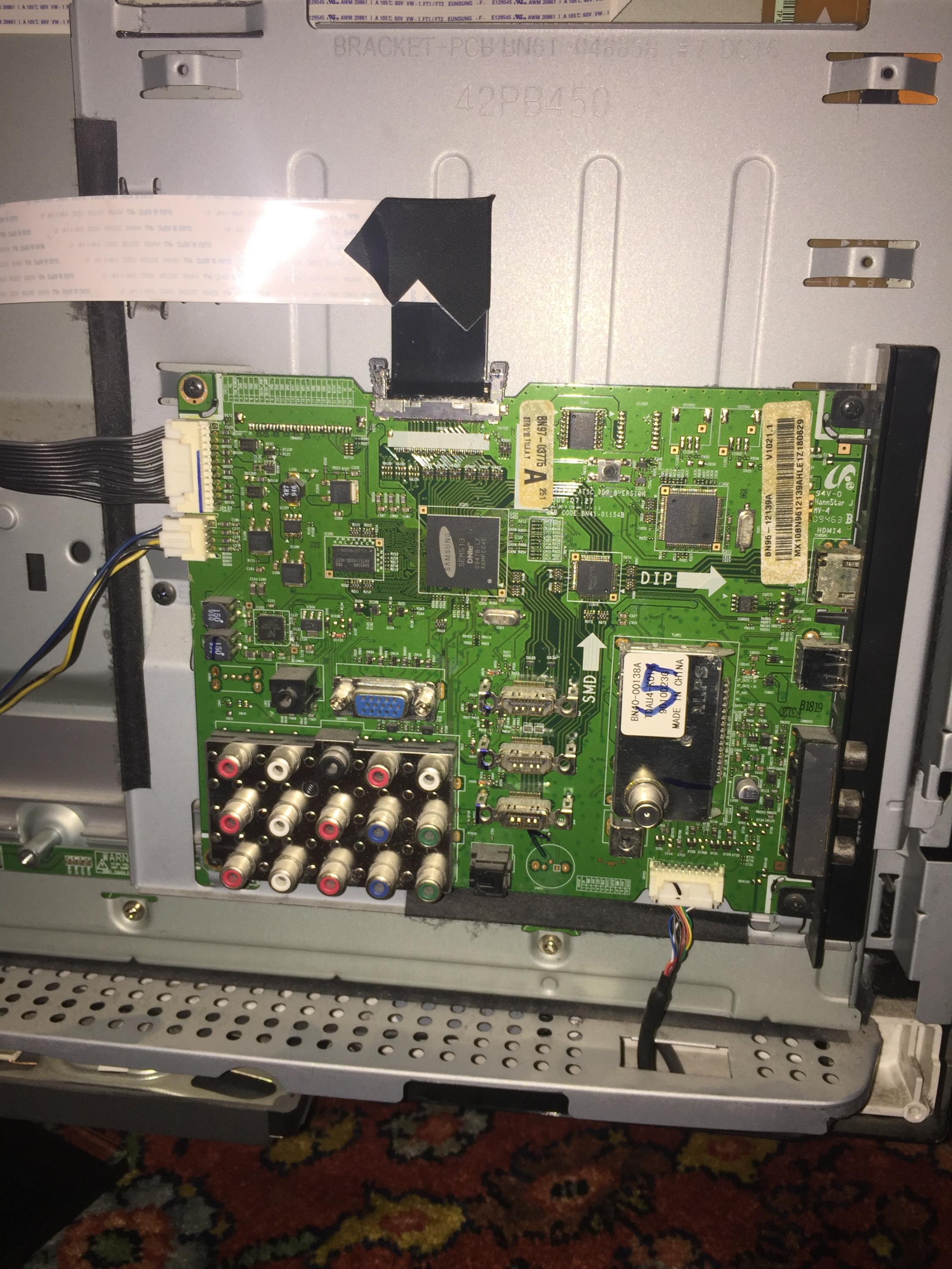

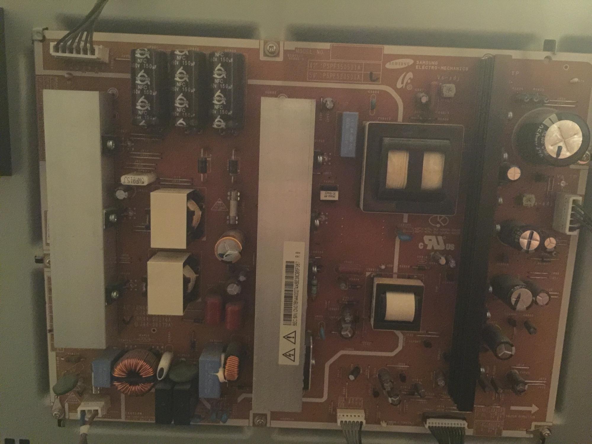

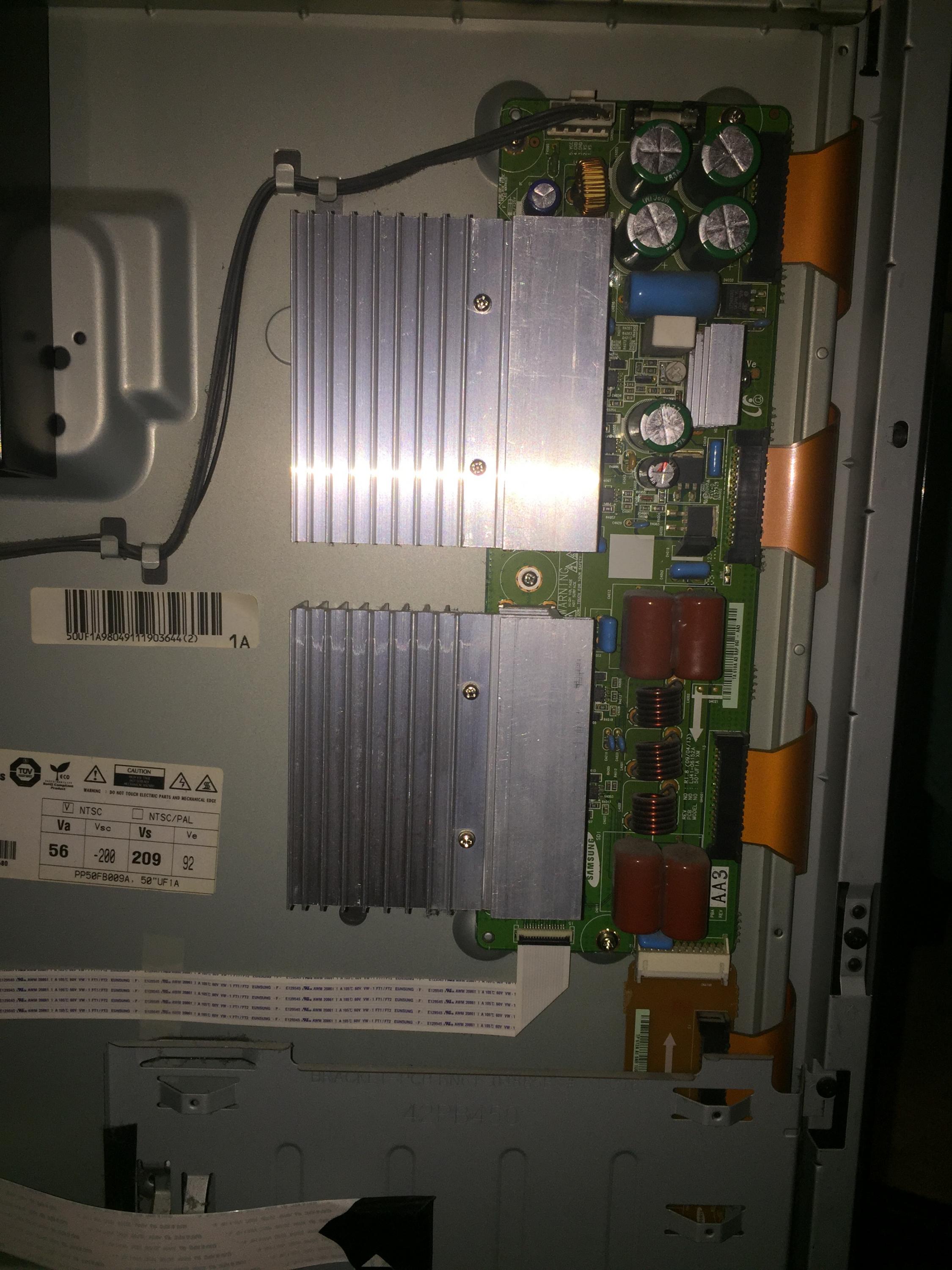

        • bsickler
          • Aug 2016
          • 18
          I totally forgot to load pictures! Hope this helps the chain. Thanks in advance
            Hi again bsickler,
            As I'm not an expert in this matter, I can't say for certain, that it's PS issue, but at least the issue is still there, when you bypass the main board. So unless you are unlucky and have several issues with your TV, I would assume that the issue is the PS.
            I've stumbled upon a lot of samsung click click PS videos on youtube (here fx: https://www.youtube.com/watch?v=quk9u7NoVbw) and it's usually caused by bad caps.
            Bad capacitors are not always bulged up, some of them you can't see any visual damage to. You can either check your caps by measuring them (try searching on youtube on how to do this) or you can take a chance and order a new PS board on the interwebs. As I haven't ordered anything from any retailer of TV-parts yet, I can't really recommend any, but a friend of mine had success with https://spares2repair.co.uk. Otherwise there's a thread on this forum with recommendations.
            • cliff_hootarski
              • Jul 2006
              • 411

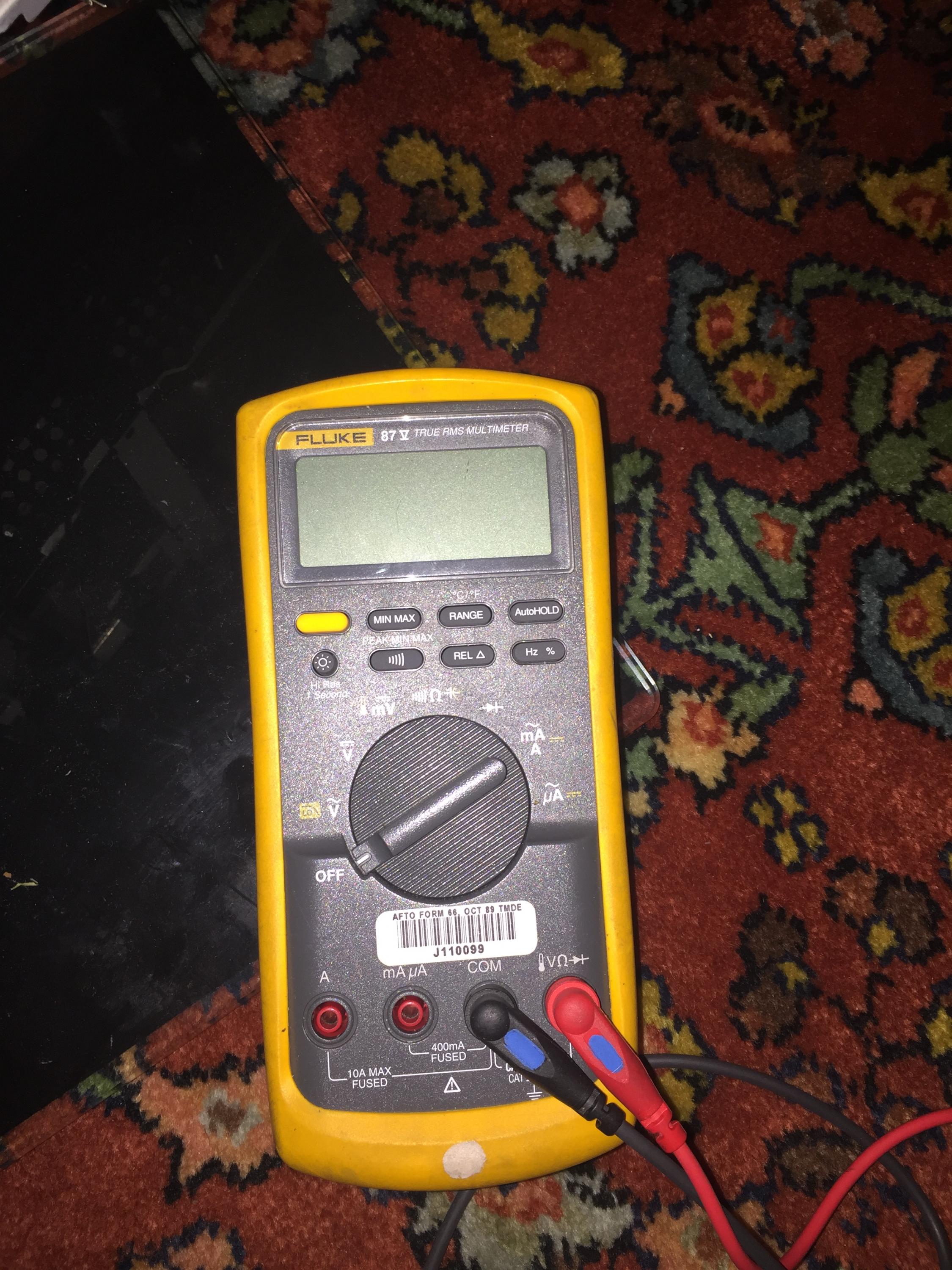

              Need good high resolution pictures of the entire back of the TV to see how things are connected. Also good well lit high resolution pictures of each board.
              Picture of your multi-meter too or the model number of it.
              • bsickler
                • Aug 2016
                • 18

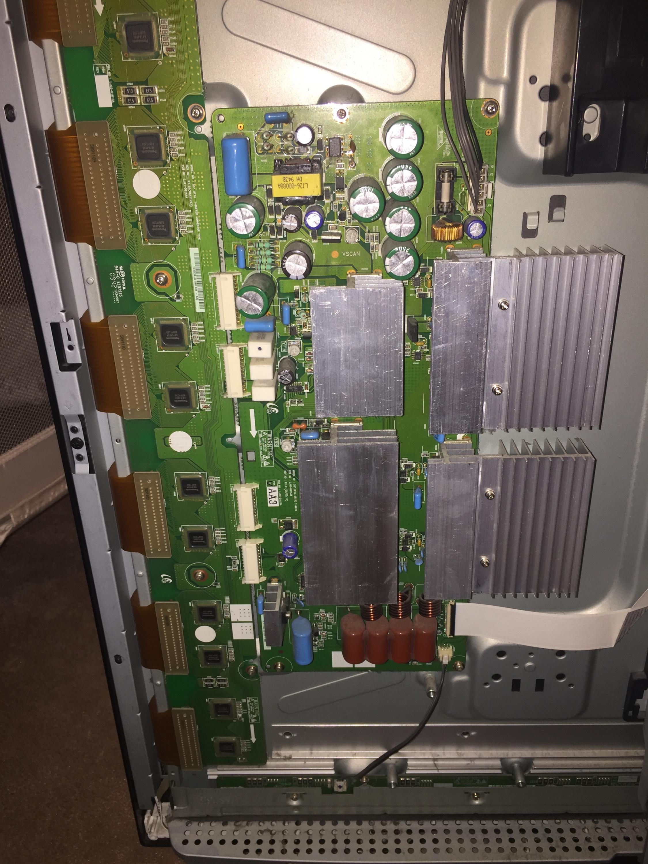

                As requested pictures of the boards. I appreciate you reply. its possible the gold colored cap on the PCB has a slight swelling, but it feels flat. This is my first time inside a tv, so my learning curve is high. ive learned a lot and im happy there are people out there who know what they are talking about. As a quick recap i disconnected the y sus, x sus and the same issue with the tv (ruling out those boards), if i try to start the auto gen test by bypassing the main board and jumping pins 3 and 4 of the logic board i have the same problem (ruling out the main board) that leavs the PCB and the logic board. I have not unplugged the touch panel and fired it up to see if the problem relives itself, but at this point im doubtful thats the problem. i have the correct stand by voltage, and the volt changes for the power on cycle are correct. I can not get an accurate reading of the Va, Vs, Ve, and Vscan because the tv is not on long enough. so it is possible that the PCB has a fault when it tries to power on, or the logic board has a fault. Again first timer here so please feel free to correct me in my troubleshooting if something i said seems off or wrong. thank you for your guys time.

                    • mmartell
                      • Oct 2013
                      • 3189
                      Shorted ysus or xsus. Plug everything back in but now disconnect the ysus power harness and see if the set powers on and stays on. Of course you won't have a picture but not to worry....
