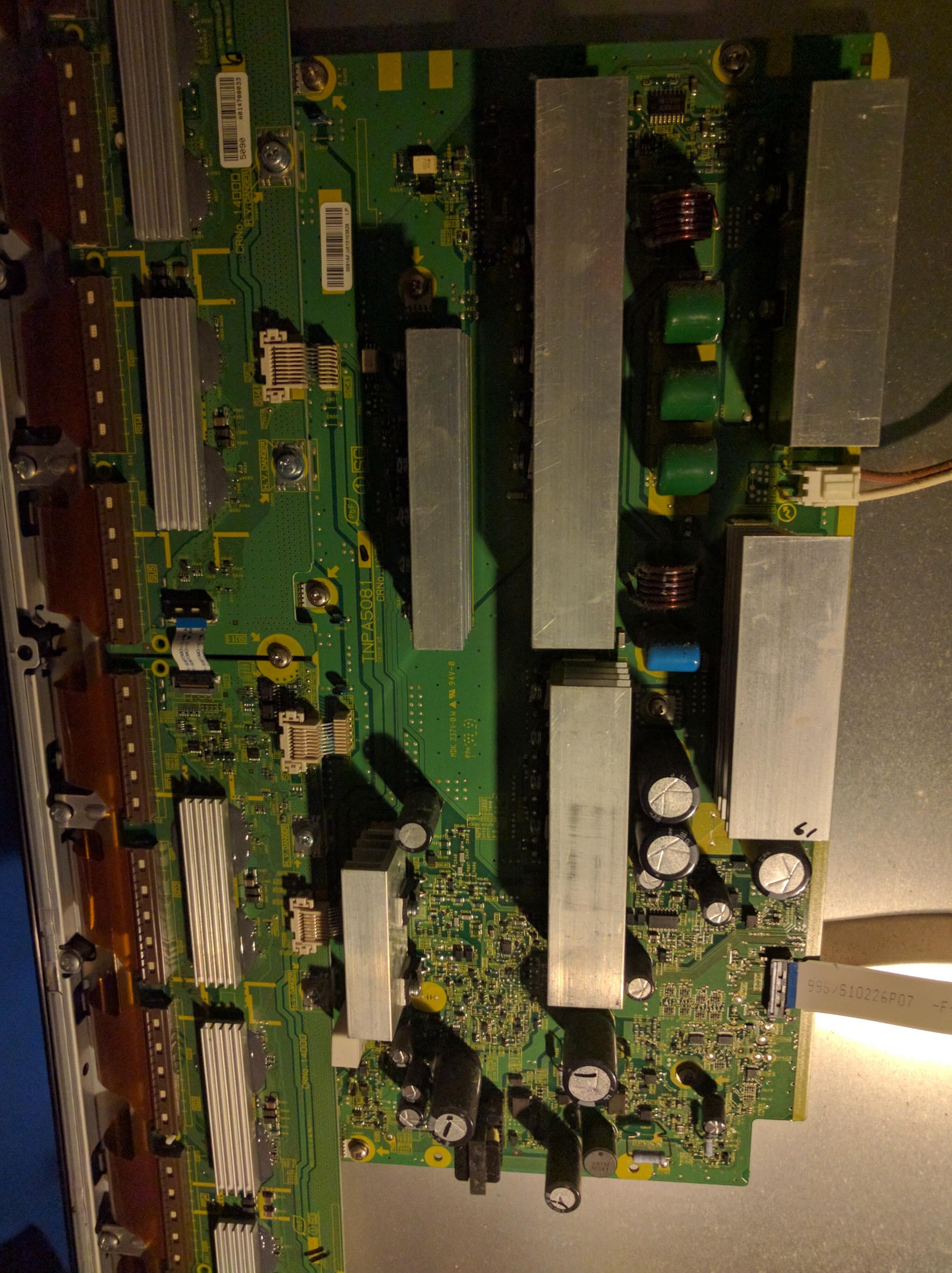

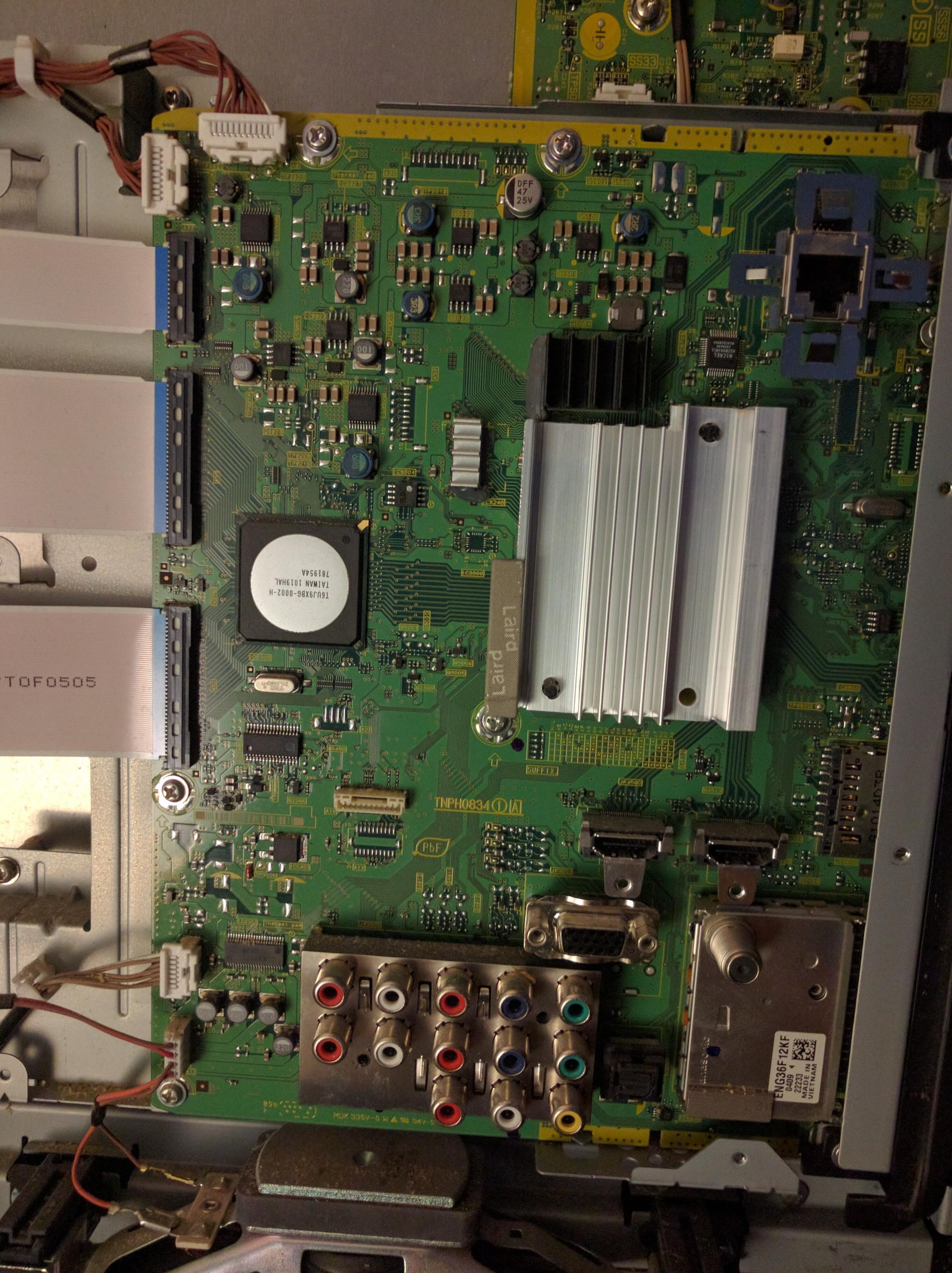

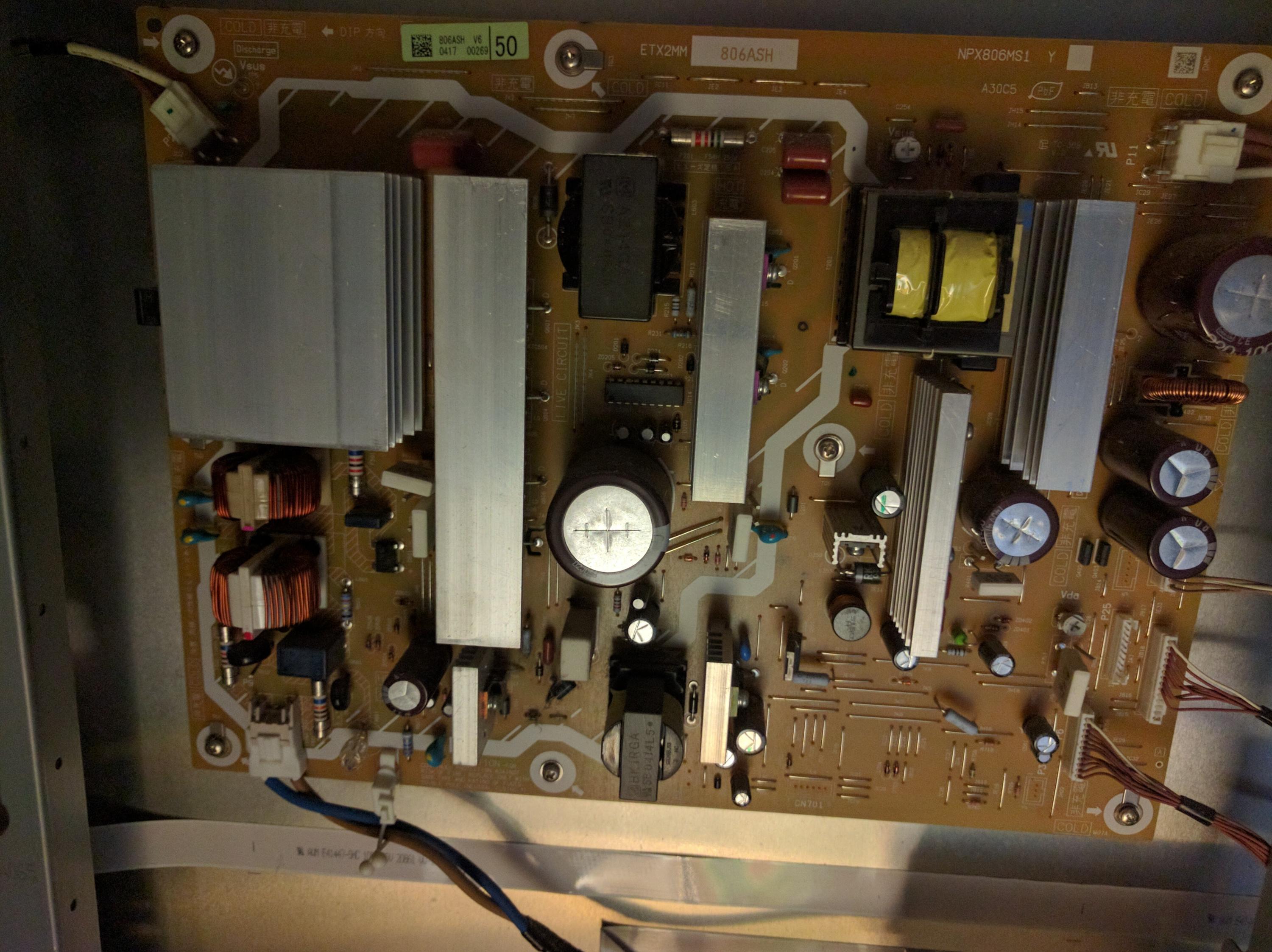

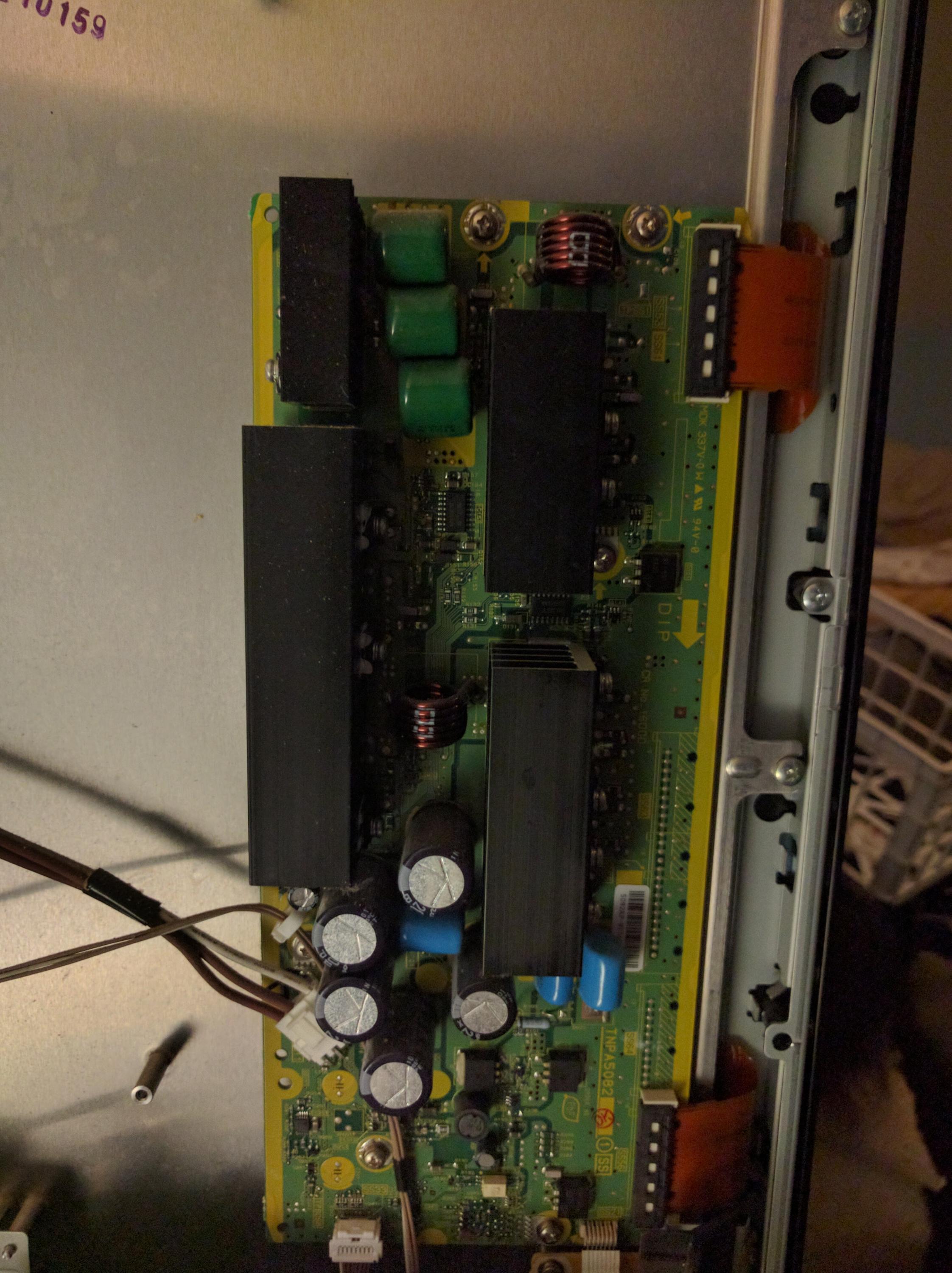

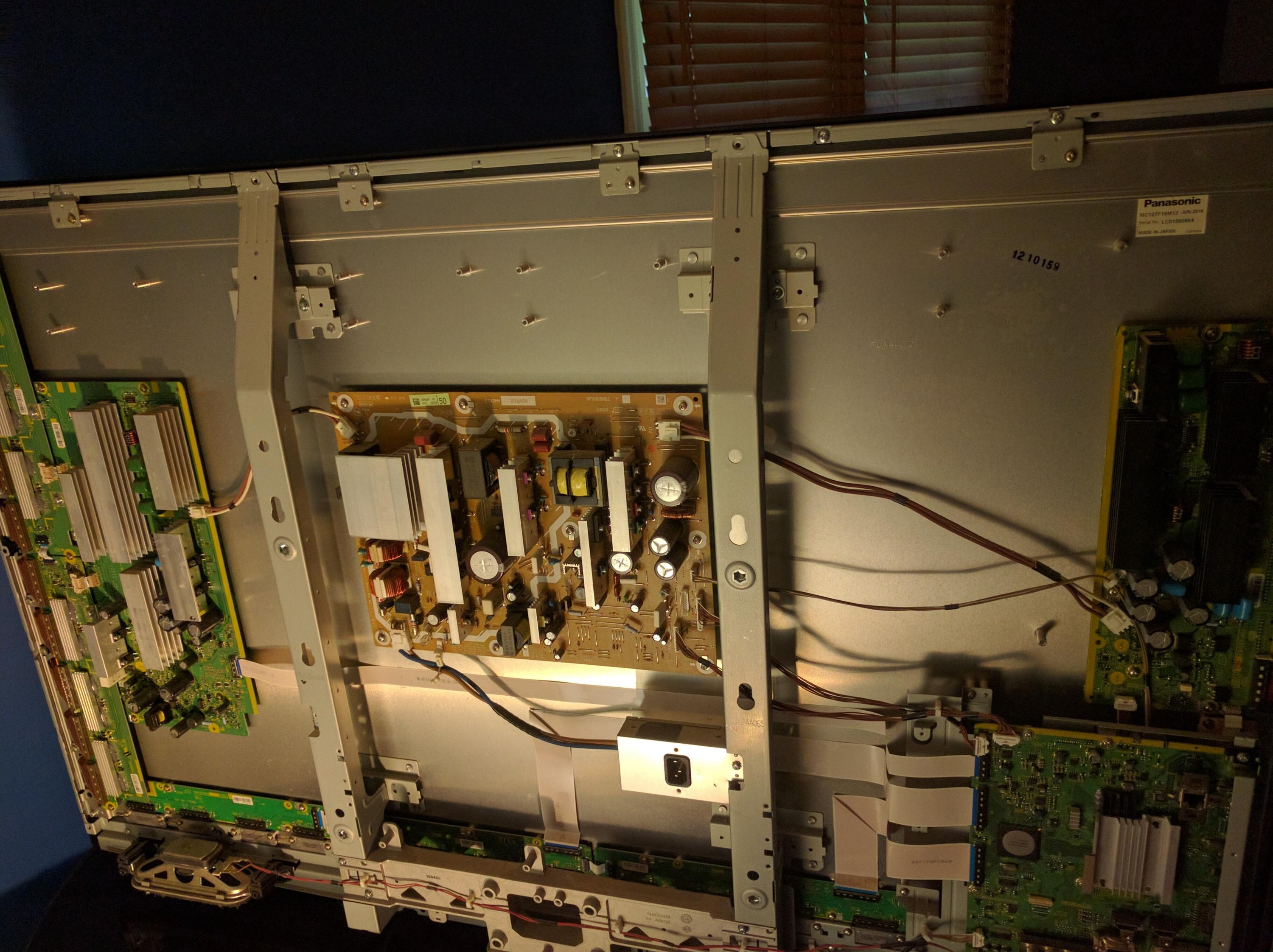

    Here are some pics of the back. There's nothing visually wrong that I can tell. Looking at the schematics it looks like everything with the HDMI should be contained on the A board, unless there was a general power failure, which I can find no evidence for (again with the aforementioned lack of direct voltage testing). If anything jumps out at anyone else, or if indeed the A board seems like a good bet, please let me know. Thanks!

        To high current went through your x-box into the mainboard from your tv. You are lucky the tv turns on and displays a picture.
        The current has fried the HDMI controller on the mainboard. You can repair it yourself if you know how to desolder the chip on the mainboard and resolder the new chip back on.
        If you don't want to repair it yourself then order a mainboard on ebay/shopjimmy and simply replace it.
        You can also use component. Its the same quality as HDMI but without sound.
        TNPH0834 is your mainboard.
        Normally there is also a white sticker that says the version of your board. Its probably hidden under the metal shield on the right hand side.
