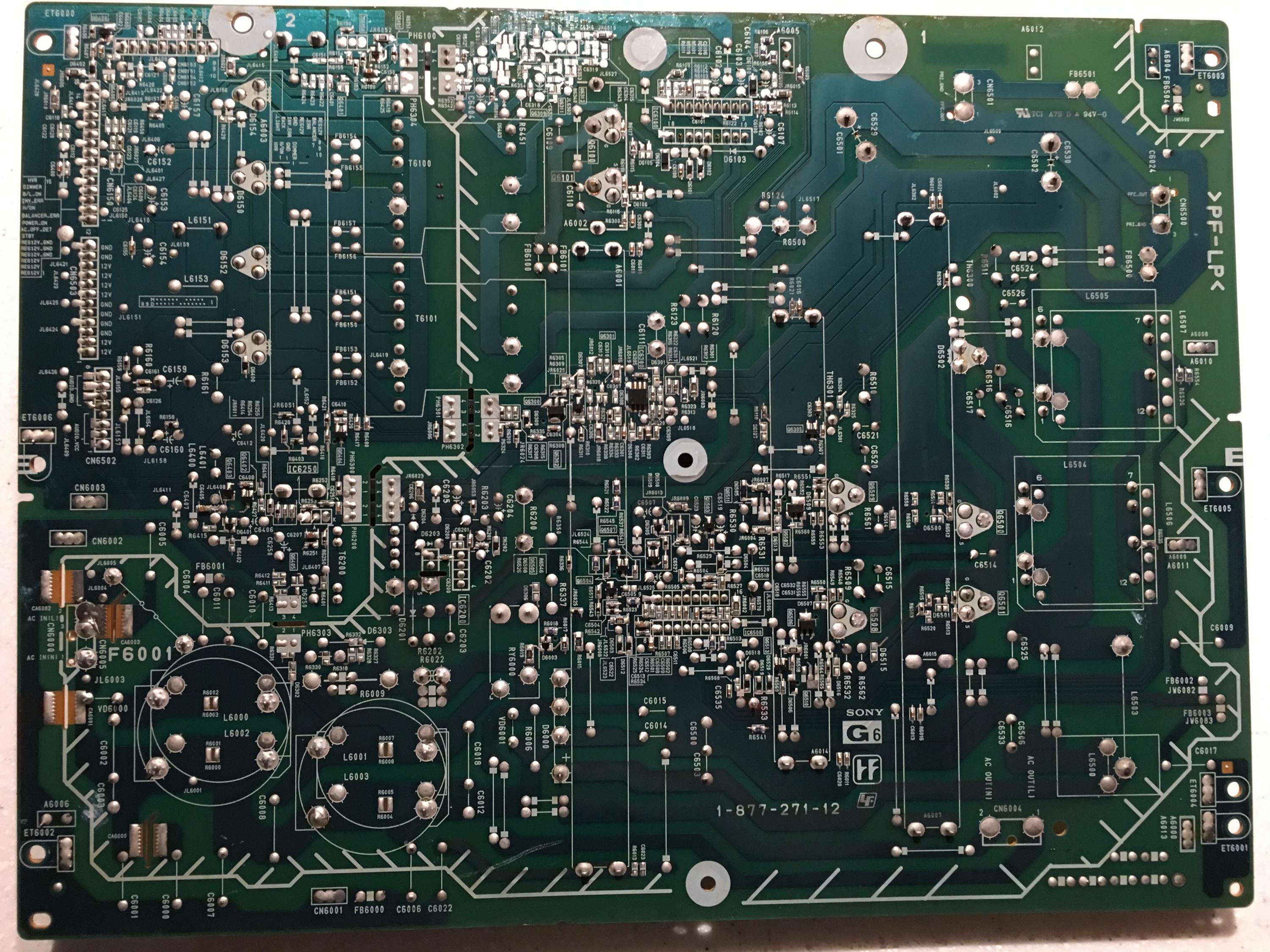

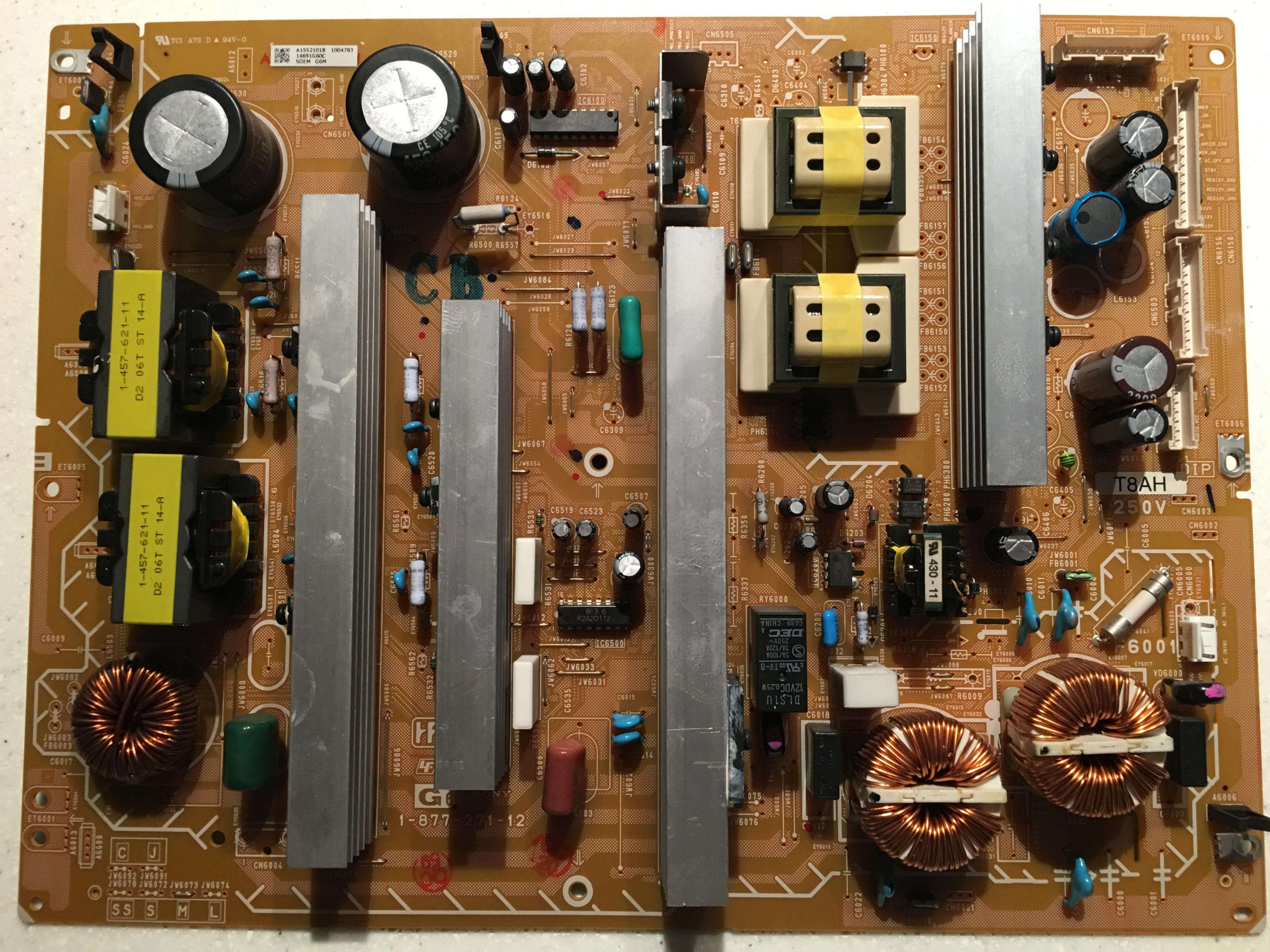

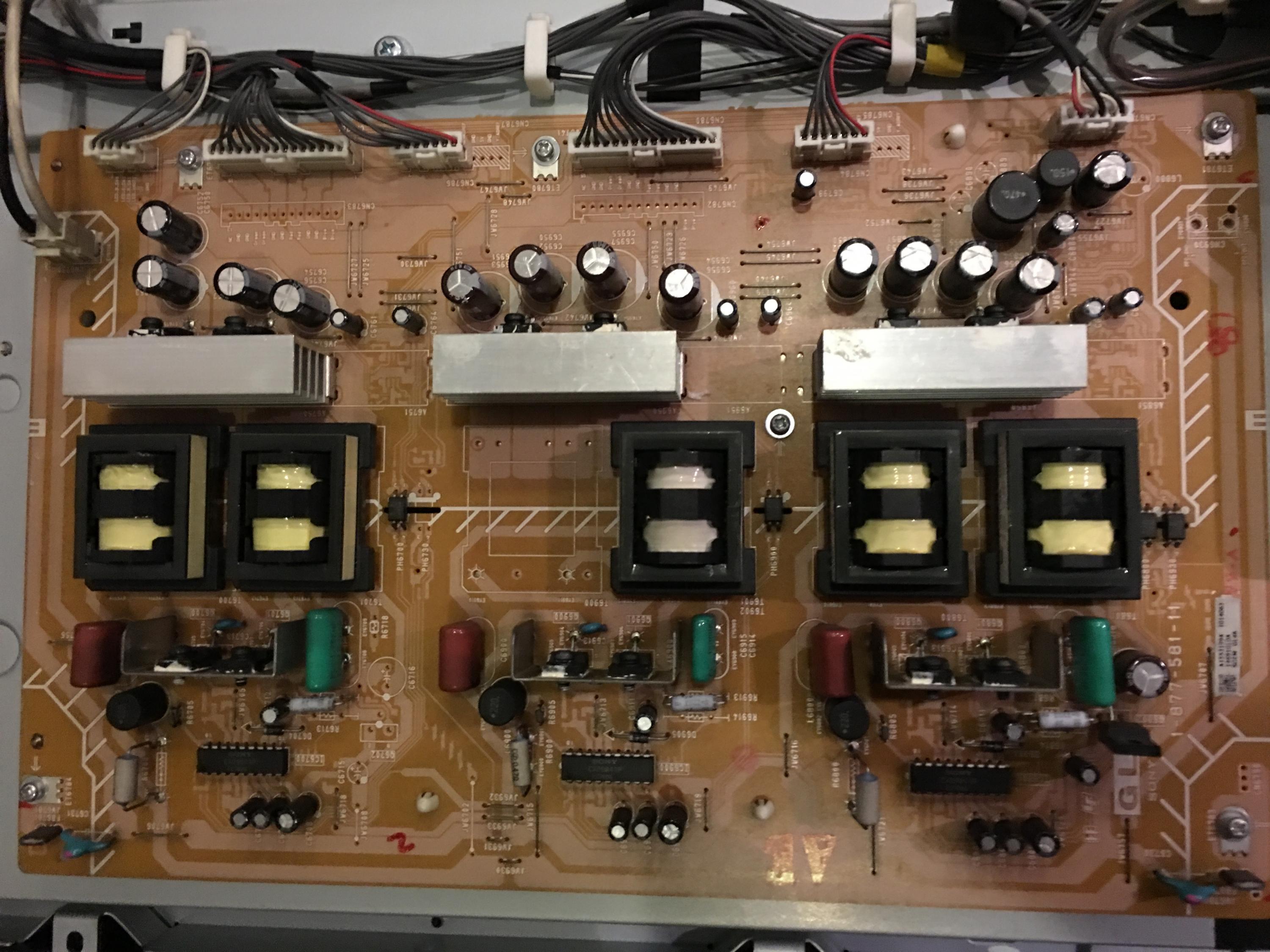

            Re: KDL-40X4500 and KDL-46X4500 Issues
            I took a picture of the front and back of the 46" TV G6 board.
            It's been a long day, so I only took a photo of the top of the GL board.
