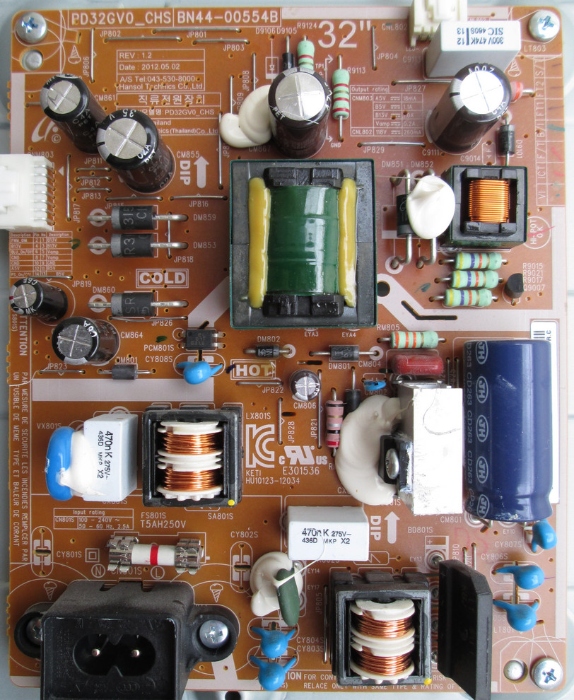

    Received a Samsung UN32EH4003FXZA LED TV with starting problems.
    From experience with this model guessed it had bad cap(s) so checked the Power Supply and found the 47uF 160 V cap starting to bulge. The adjacent 47 200 V cap and all the other caps are OK.
    I would like to upgrade the failing 47uF 160 V cap so appreciate any suggestions.

    Re: Suggestions to UpGrade Power Supply?
    Forgot to mention that have searched the Internet to check if anyone has determined why these 47uF 160 V caps are failing but to date have found nothing.
    My 1st guess is since this is an inexpensive TV, Samsung was trying to save money on caps.
    Am thinking about upgrading this cap to 200 V as radiotvnut posted "Samsung 32" from 2012 (easy fix)" http://www.videokarma.org/archive/in.../t-264566.html
    Am also wondering if it is worthwhile to use a low ESR, long life,... cap?
    Appreciate any suggestions.

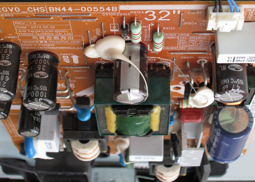

      http://www.samwha.com/capacitor/company/com.aspx
      What is the series of that SAMWHA cap?
      It is not easy to find 47uF 160/200VDC LOW ESR cap which should be used for that filter cap for the LED driver circuit..
          I would guess the additional heat from the transformer located below it helped cook it as the other 47/200 looks in better shape.
            budm,
            "It is not easy to find 47uF 160/200VDC LOW ESR cap which should be used for that filter cap for the LED driver circuit.."
            Question: If can find a suitable cap, do you think a LOW ESR cap is worth while in this circuit?
                That LED driver power supply is switching power supply so the replacement has to be LOW ESR type, you can also get the spec of the SAMWHA WL series cap to find something that will match the original spec.
                    Maybe lay the new cap on its side under the bn44...... there seems to be enough open space. I admit, I've done it before (when I could only get axial caps,or replacements were too big).Glue it down with some hi-tech RTV sillicone.
                        tvtimmy,
                        "Maybe lay the new cap on its side..." Thanks for the tip! May have to do it.
