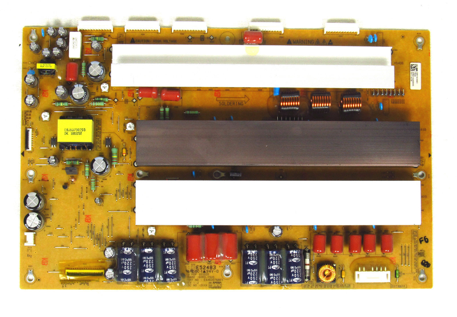

    hi all.. i have a lg 60pz950 plasma and just recently i noticed some intermittent issues with the display im getting a pinkish/green fuzzyness ? comes and go depending on image. Any idea of what the cause could be?

    x sustain or y sustain.....check voltages and adjust them. Also perhaps cold solder joints.

      thanks for your reply... how do i go about changing the voltages?
        Re: 60PZ950 Color issue
        You would measure the voltage and there should be a little plastic screw on the y board you can use to adjust the voltage. Same with the x board.

          Be careful adjusting the voltages with the small potmeter. It can destroy the board and even the panel.
          Just measure them first and see if they match with the sticker on the panel/service manual. If they match then its probably a board or even panel failure....
            Also mark the side of the controls with felt tip pen so you know where the were originally. This could be your Vsus board, there are 4 white controls on the lower part of the board, they are also labeled for what they adjust. there are also test points marked for where you measure the voltage, some are measured with reference to ground and some like the VY have 2 test points on the board (in this picture, below the top heatsink and to the left are 2 test points marked "VY"
            There are usually 2 adjustments marke "set up" and "set down" that you normally adjust with a scope (they adjust a waveform so a meter won't help)
            they can be adjusted by looking at the speckels in the light or dark areas of the picture.

              just an update.. bad solder (cracked) under the coils. re soldered and back to brand new again, thanks for your help guys
