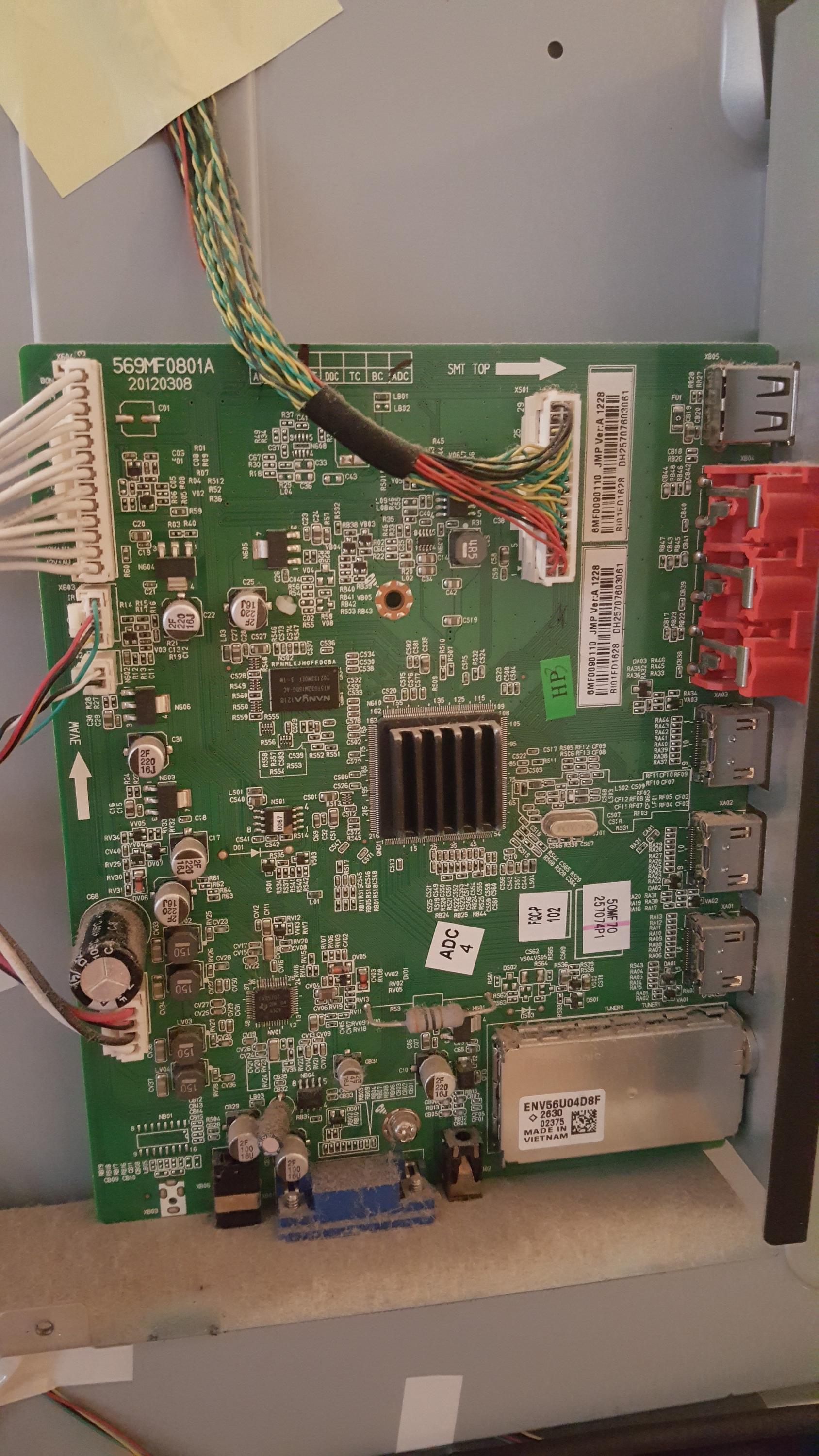

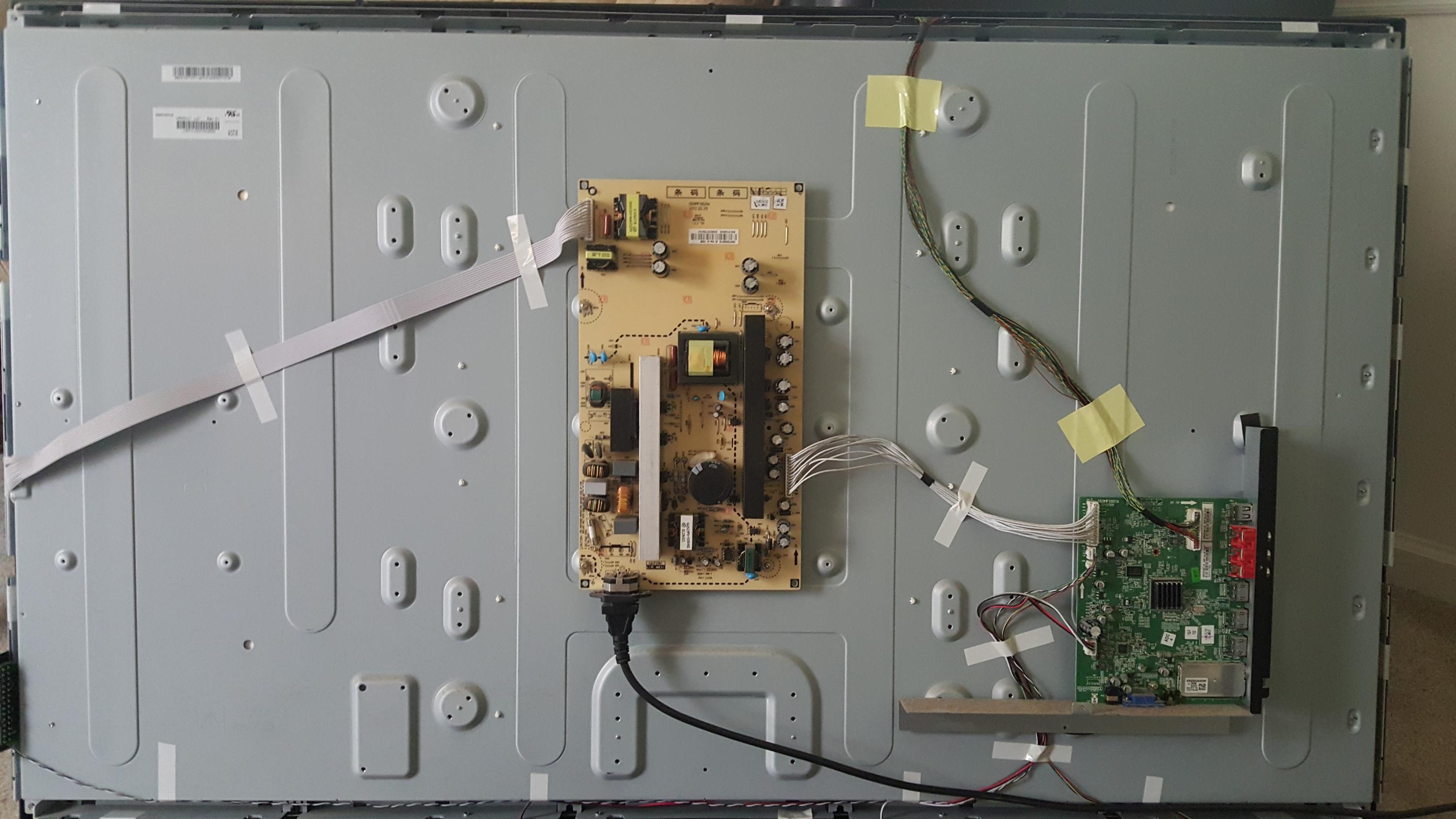

    I have a 50" Insignia LCD TV that will not power on or show signs of life. The gentleman I got the TV from said it one day would not turn on and would not even get the red standby light in the front corner anymore.

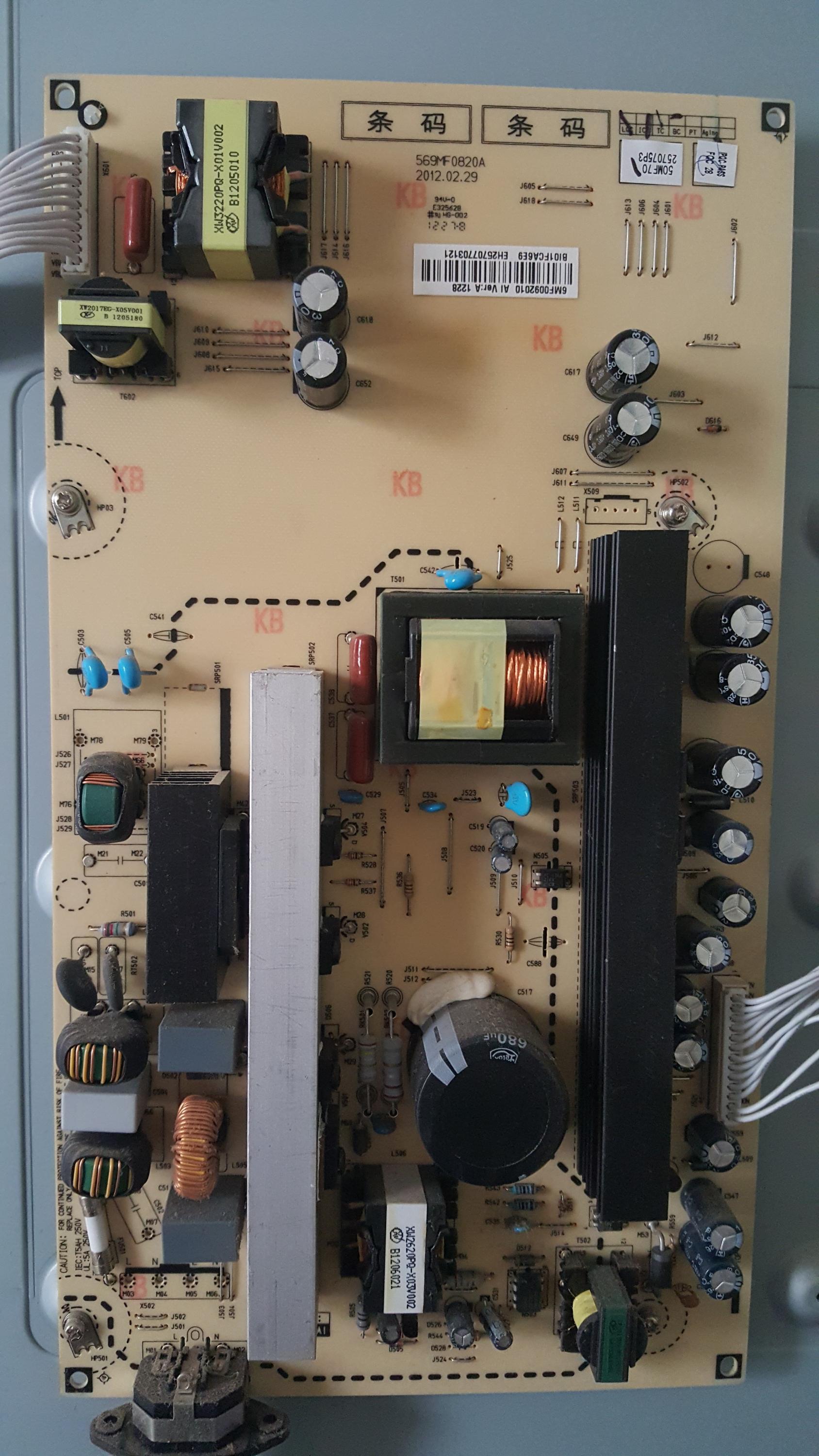

    I opened it up and tested the PS fuse, it has 120V running through it. Testing the pin outs on the cable connecting the PS board to the main board I get the following voltages:
    • 12V - 11.94V
    • 12V - 11.94V
    • GND
    • GND
    • 12V - 11.83V
    • 12V - 11.83V
    • GND
    • GND
    • PON - 2.93
    • 5V1 - 5.14V
    • 5Vsb - 5.14V
    • PWM - 3.32V
    • BON - Fluctuates between 0.01V and 0.00V. What does BON power?

    Re: Insignia NS-50L240A13 - Not Turning On
    BON: Backlights ON (BL-ON), so it looks like your main board is not sending the Backlights ON command to turn on the backlights circuit.

        Yep, that makes sense! There is no picture on the screen when I hold a flash light to it. Like I said, not even the red LED comes on down in the front corner. Unconnecting the cable going to the main board from the PS board did not bring a back-light either.
        There is a cable running from the PS board to the left side of the screen. I assume that is the cable which powers the back-light? It is reading 0V down the entire connector. I don't have any 1K resistors so wasn't able to try and jump it.

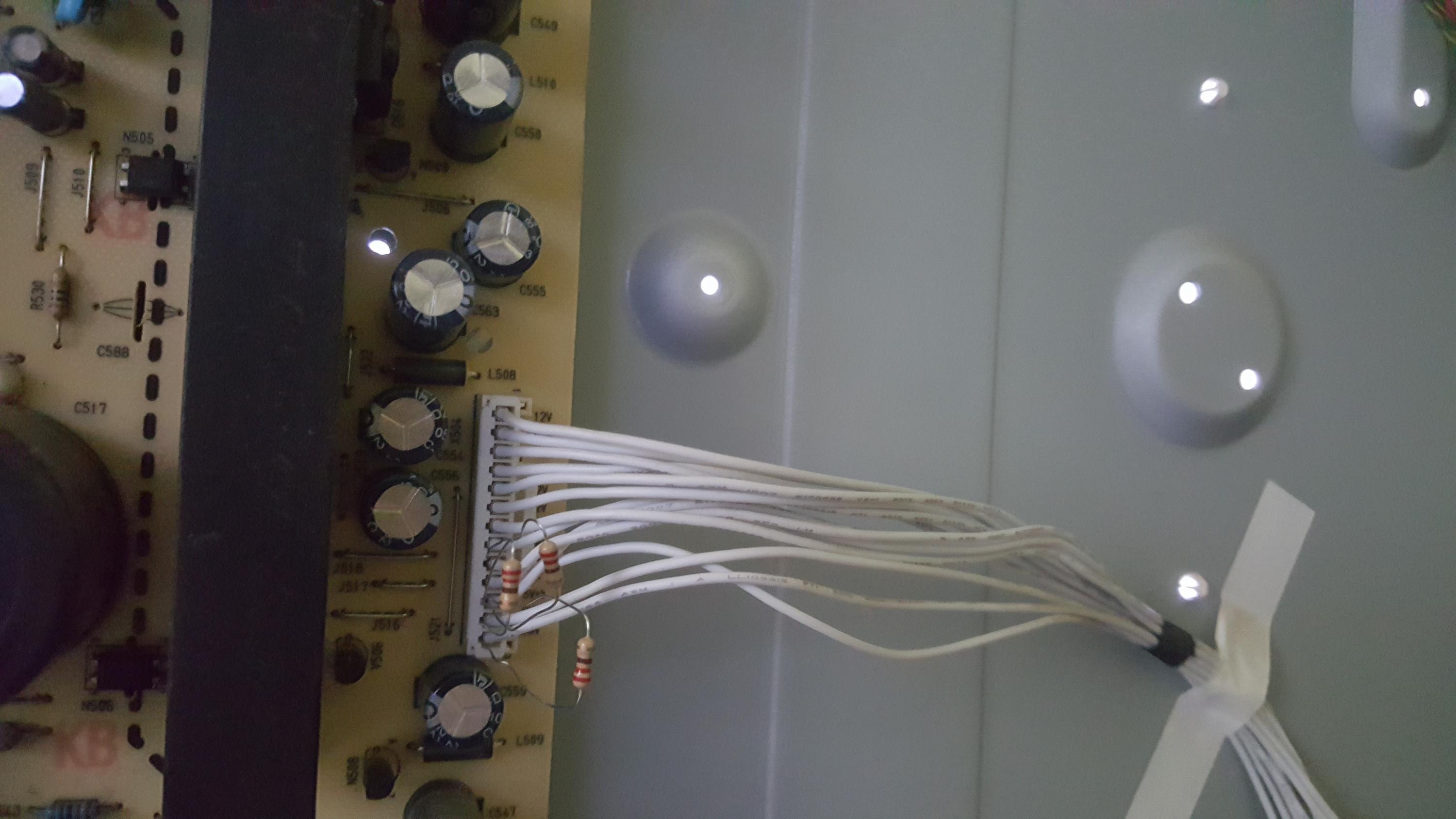

            An update, I took two resistors and jumped the pins of 5Vsb and BON and then 5Vsb and PON and the backlight lit for a second and went back off. I left the resistors on the pins and tested the voltage at the BON pin and with the resistors on the respective pins still, BON reads 5.15V. Also, two of the pin outs on the cable going from the PS to the back-light behind the panel read around 5V.
            So does this point to a more then likely issue with the main board? I was trying to source another main board, and everywhere is out of stock. One company says that they can repair it, but still going to run $100 dollars, so i'd like to be sure before going that route. The company is PTS Electronics, anyone deal with them before?
            • ECU_Techie
              • Jul 2016
              • 45
              It has to be the main board. If I unplug everything from the main board and plug the tv in with the resistors in the pin outs of the one cable, the back-light comes on. If I only have the power cable to the main board plugged in, the back-light will not come on until I unplug the power cable from the main board. At that point the back-light comes back on.
              I got the back-light to stay on by putting in a third resistor going between 5Vsb and PWM. In the picture below, you can see the three resistors and through the holes of the backside of the panel you can see the back-light is on.
                Lift the BON pin out of the connector at the power supply board end. With the mainboard connected and using a jumper resistor between 5Vsb and BON pin (now left empy on the power supply board) and see f you have a picture when you switch on.
                        Ah, I gotcha this time. Ok, I took the BON pin out of the PS board end of the cable connector and plugged everything back up to the main board. I plugged the tv in and then jumped a resistor between the 5Vsb pin and the now empty BON spot on the connector.
                        The back-light came on now with the cable connected on both ends, but still no picture. Just the back-light staying on constant. Thanks for that good piece of troubleshooting advice guys.

                          • ECU_Techie
                            • Jul 2016
                            • 45
                            Thank you both for the help on this tv. I also believe it is the main board as the IR board with indicator light also seems to have an issue. I did a quick test on the T-Con board connector pins and most of them don't read a voltage except for like one or two of them.
                            I believe at this point I will take my chances and mail the main board in to PTS Electronics and see if they can fix it. Once I hear back from them or get the board back, I will provide an update to where this tv stands. Once again, thank you both!
