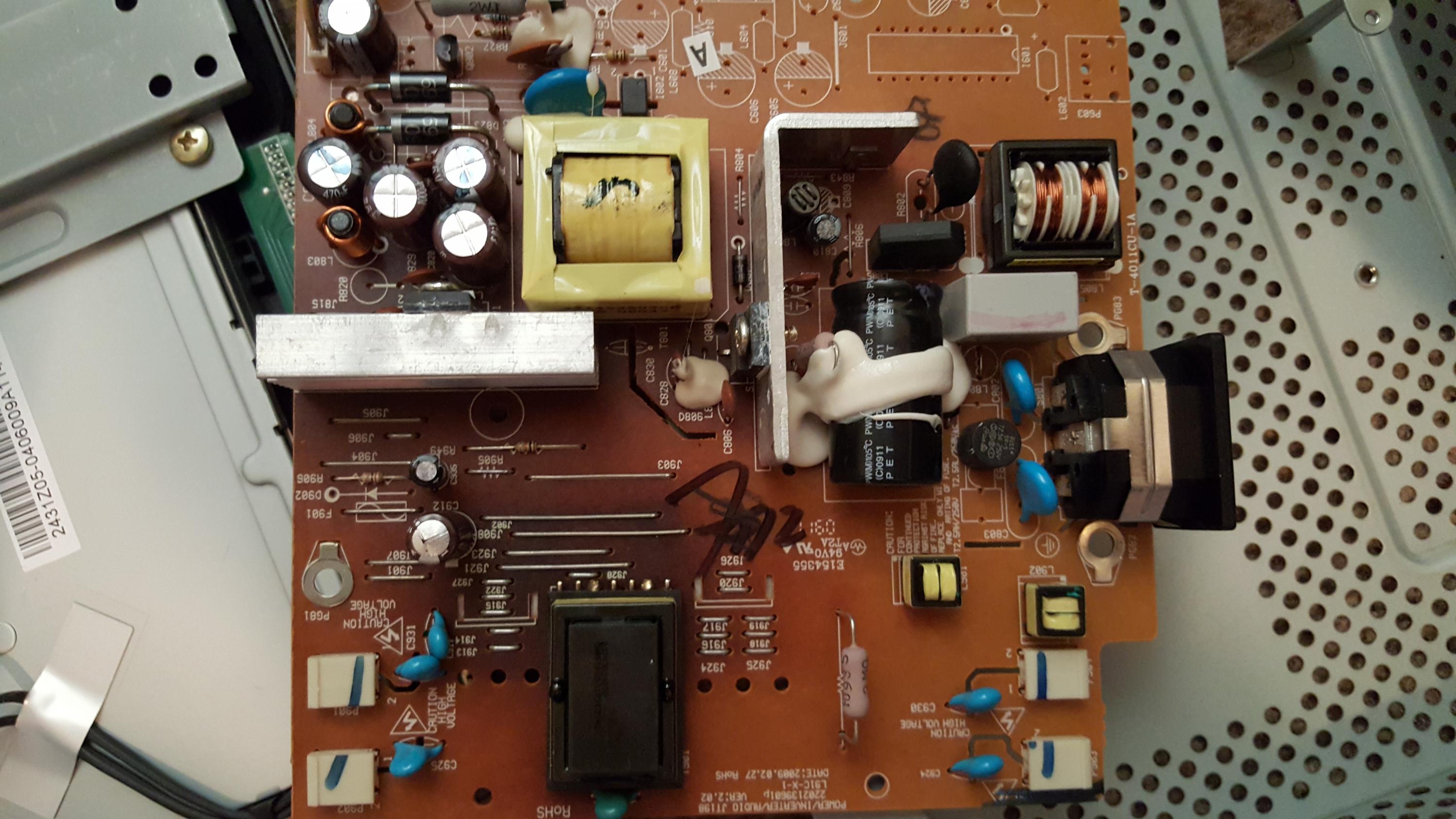

    AOC monitor will not power on. I think (based on the brown scorch mark) that maybe this capacitor C912 blew. Does anyone know if replacing it may fix my issue? I am very new to this, and so before I venture down that road and order a capacitor I'd like to have an idea of if this will work. My fear is that once it blew other parts may have been damaged.
    Any help is greatly appreciated. Thank you!

    You need to replace C912 as you are correct in that it is damaged. If that does not cure the fault then you will need to carry out further checks.

      It's quite brown around that area. Are there any components underneath the board at that point. If not I would freshly solder all the transformer pins. Something looks as though it has got hot.
        Re: AOC SW919-1 No power
        Need to check the SMD Power MOSFETs (they drive the inverter transfoemr) on the bottom side of the board where the dark brown area is.

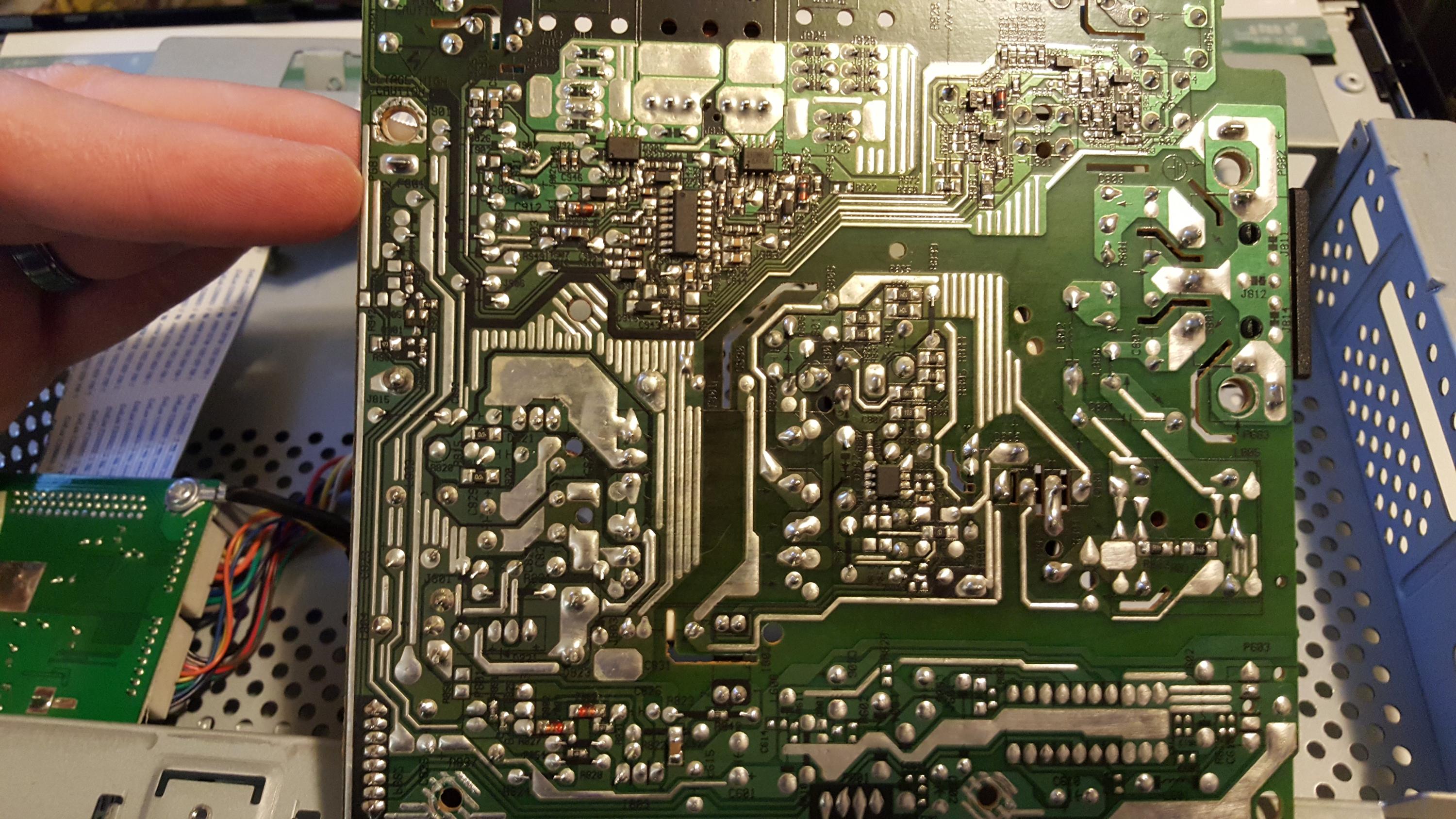

          This is the back of the board. Just to the right of my finger is the back of the capacitor I replaced, mentioned in my original post (notice my poor snip of the wires). The capacitor replacement did not fix the issue by the way. The monitor does not turn on.
          Again, thanks to everyone who's replied so far!
            It looks like the legs of the new cap were not trimmed, were they bent over due to them touching the chassis?
            If you run the power supply board by itself, what are the DCVs between the two legs of the capacitors you replaced?
            What is the DCV between the two legs of C829?
            Also need the resistance reading between the two leg of C829

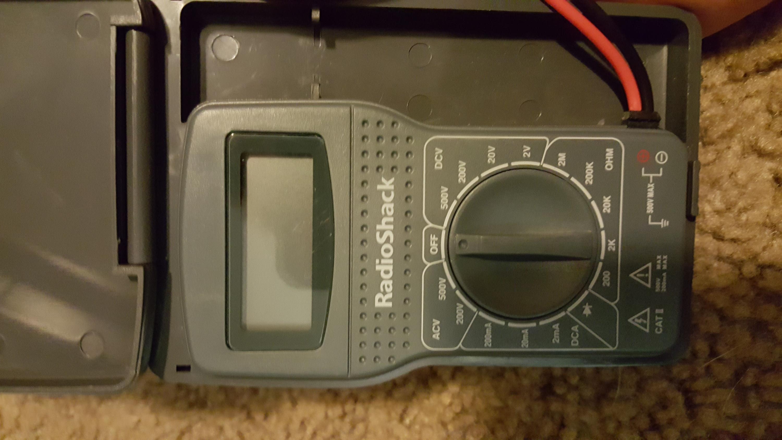

              As for the DCV, I have this multi-meter (attached). Forgive my ignorance, should the monitor be plugged in when I test and also which setting should I have the meter on?
                Set to DCV 20V scale.
                Yes the board will have to be plugged into an AC outlet and you do not need to have any boards connected to the power supply board, the Voltage should be on the caps because the power supply is an always on power supply.
                To be safe you should plug the power cord to a GFCI outlet in case you accidentally touch the hot side of the board.
                BUT if you are not sure what you are doing then you should not be working on it, a mistake can kill you.
