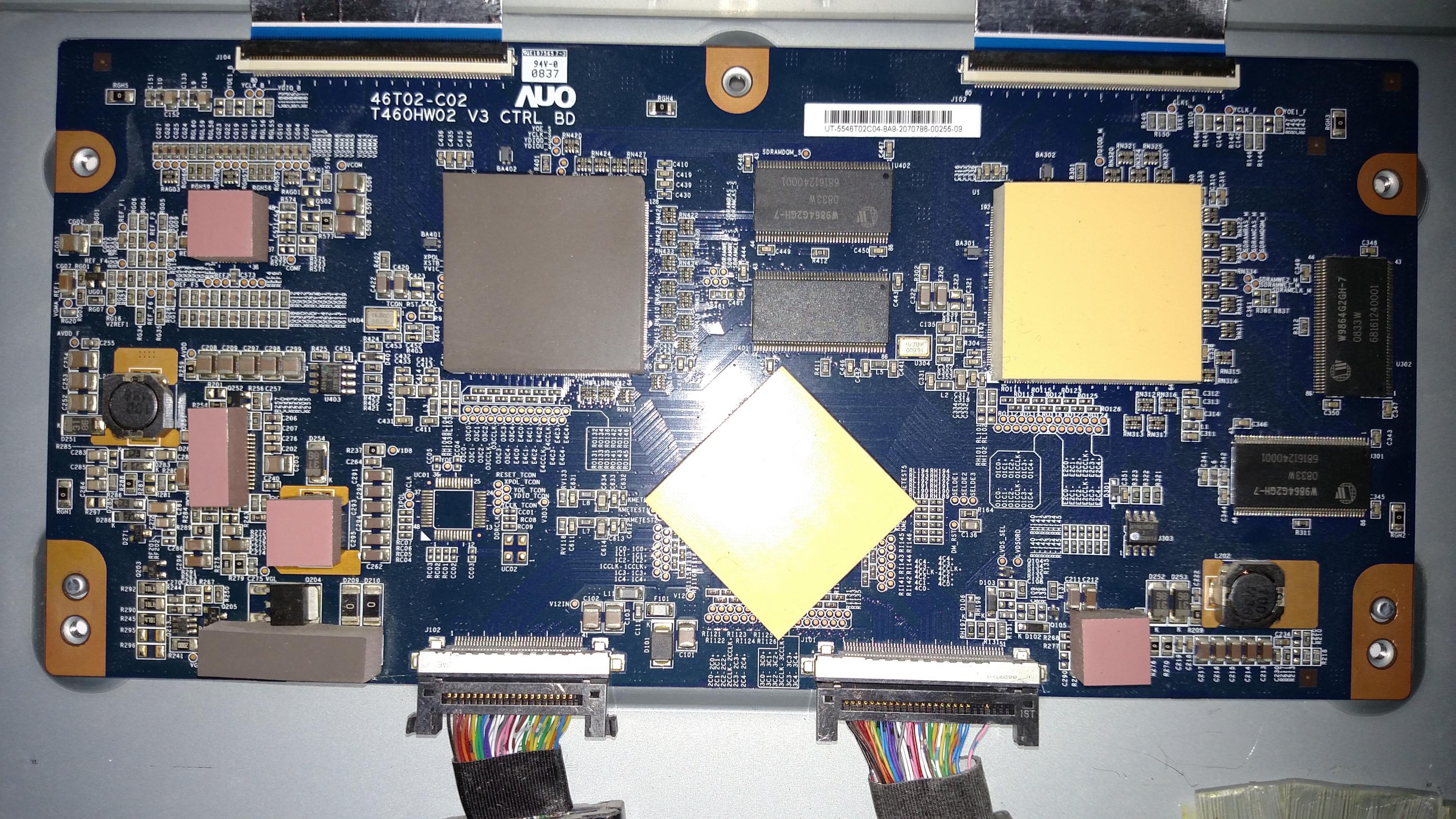

    At least up load the pictures of the T-CON board.

      Thanks, here is a picture of the board.

        You could try heating the Tcon with a hair dryer and see if you can get the picture back. If you can by heating then you do have a Tcon problem.

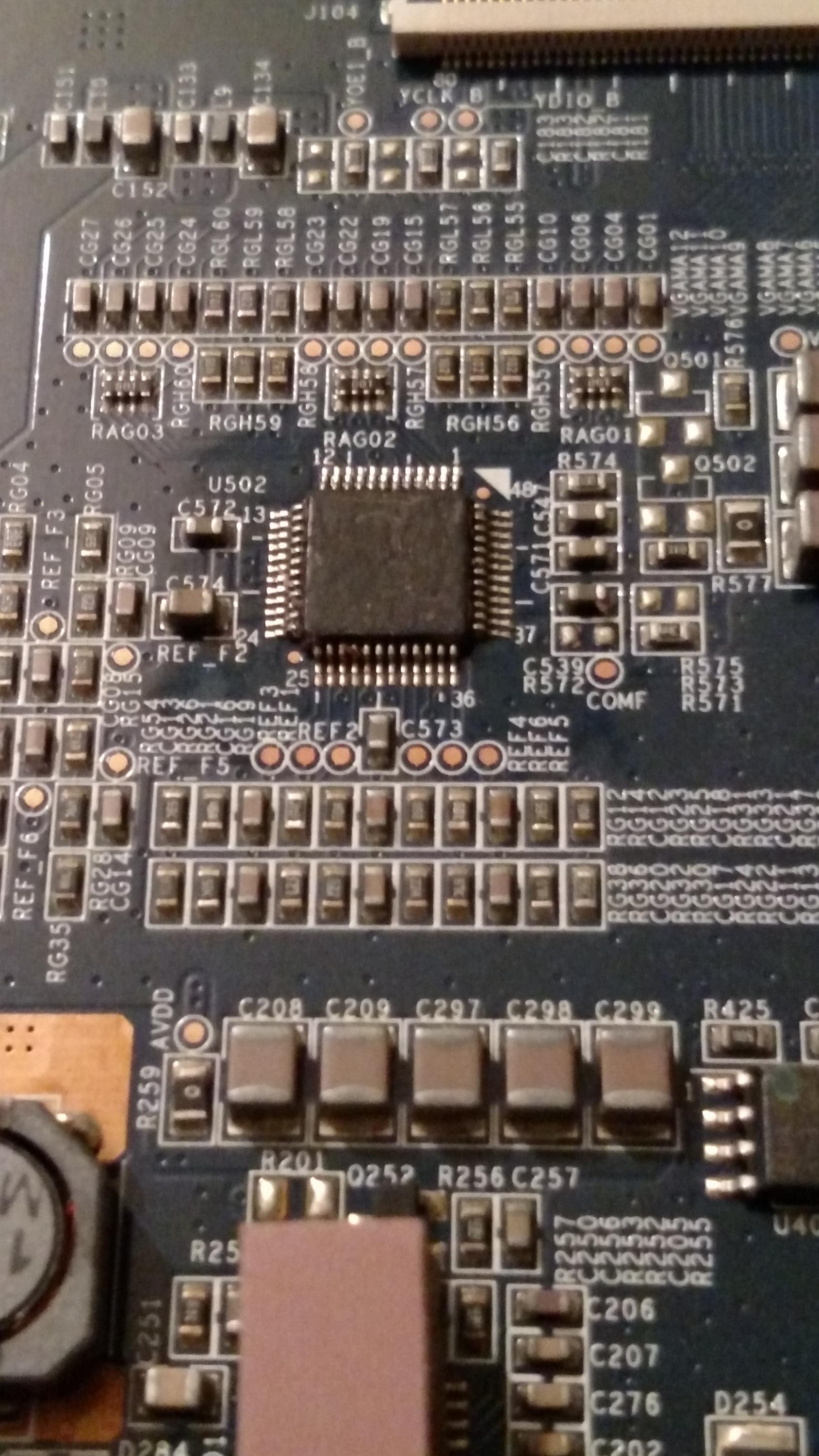

          Please remove the square pink thermal transfer pad from the IC on the top left to see what the P/N is. It is the GAMMA IC, probably AS15/19 chip.

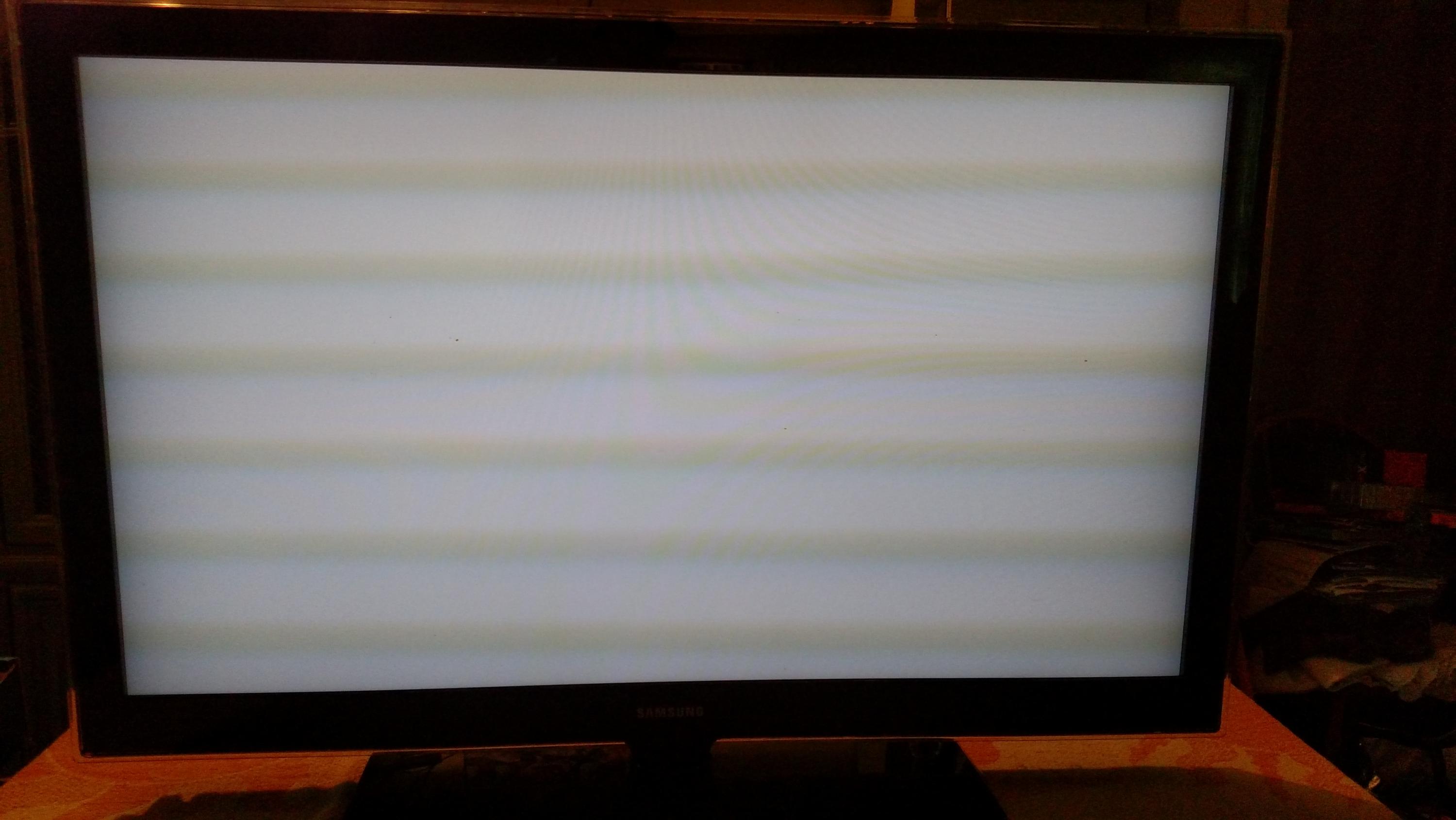

          Also get the screen shot of you see on the screen when it is bad.

            I'm not certain I removed the thermal pad correctly as I do not see any numbering on the chip. Picture attached. I also included the picture of the screen issue when turned on. The lines only show in my cell phone picture.

              You can use Alcohol to clean the top of the IC to see the marking on top of the IC.
              Do you see the exposed copper pad with white circle and it has VCOM printed next to it? Then to the left of that VCOM pad, you can see 12 exposed pads in the row, those are the VGAMA 1~12.
              You will use your dcv meter to check the DCV on each one of those pads and report what you get, You will do that when the TV is on.

                      This is common issue with that T-Con, it's the AS15-G IC.
