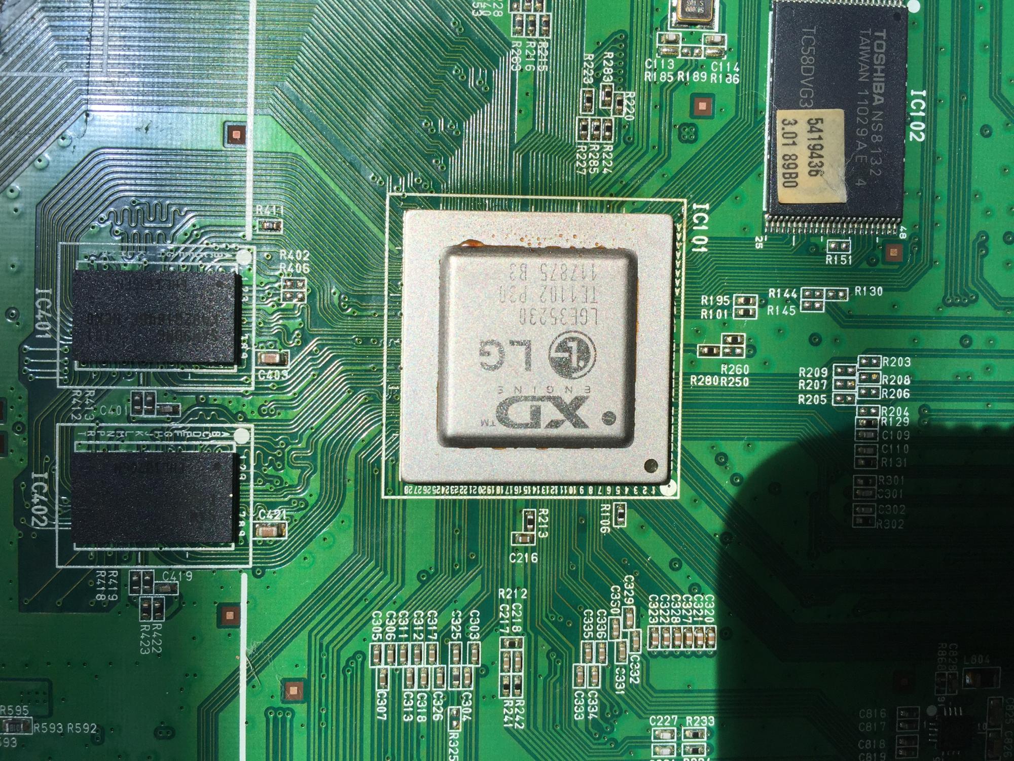

    I already have done my fair amount of pad lifting.
    The problem is that is I mess a board up, there are no others available to replace it with and with most shops having a policy of not working on a board if a repair attemp has been made, I have to room for error.

                        Well I just practiced on a bad board. Using my soldering iron I took an 8 legged IC chip off and put it back on. Taking it off was easier than getting it back on.
                        Have to make sure I don't bridge the pads.
                        In the mean time I've taken my heat gun to the cpu of the main board to this tv. Not sure how long I should have kept it on there. I couldn't see the solder on it as it is covered by the chip I guess.
                        I did about 2 minutes about 2 inches away at low setting. My heat gun has low and high.
                        There is a repair service on eBay for it for $135, I asked and they said the repair doesn't involving changing the eeproom, so I don't really know what they do.

                          everybody does reflows diffrent i tend to add flux too then heat the board from underneath then do the top side.
                          Maybe they do change the eeprom but dont want anyone to know they charge that much for doing it? as if thats all they change its a good profit.

                            It worked for a bit. I got the onscreen display for about a minute then it went off.
                            I did use flux. I didn't hear the bottom as there are tiny capacitors on the opposite side.
                            Maybe I should try the oven method.

                              10 minutes in the oven at 390F didn't fix it either. Now it's stuck on the lg life's good screen.
                              I guess I'll have to send the board out.

                                No no it needs a reflow mate. Give it a proper go with the heatsink removed and use flux and slowly heat and get closer to the chip.

                                  Should I leave the heat gun on low or high?

                                    You want about 220c or 425f to melt lead free solder.

                                      M heat gun only has low or high. I don't wan to damage the cpu or gpu. Not sure what it is exactly.

                                        There really is no place to put the solder. I can't see any of the pins. Do I just put some around the edges? That's what I did the first time.

                                          Yes, put it round the edges, when it gets hot it gets wicked underneath to do the magic on the balls.
