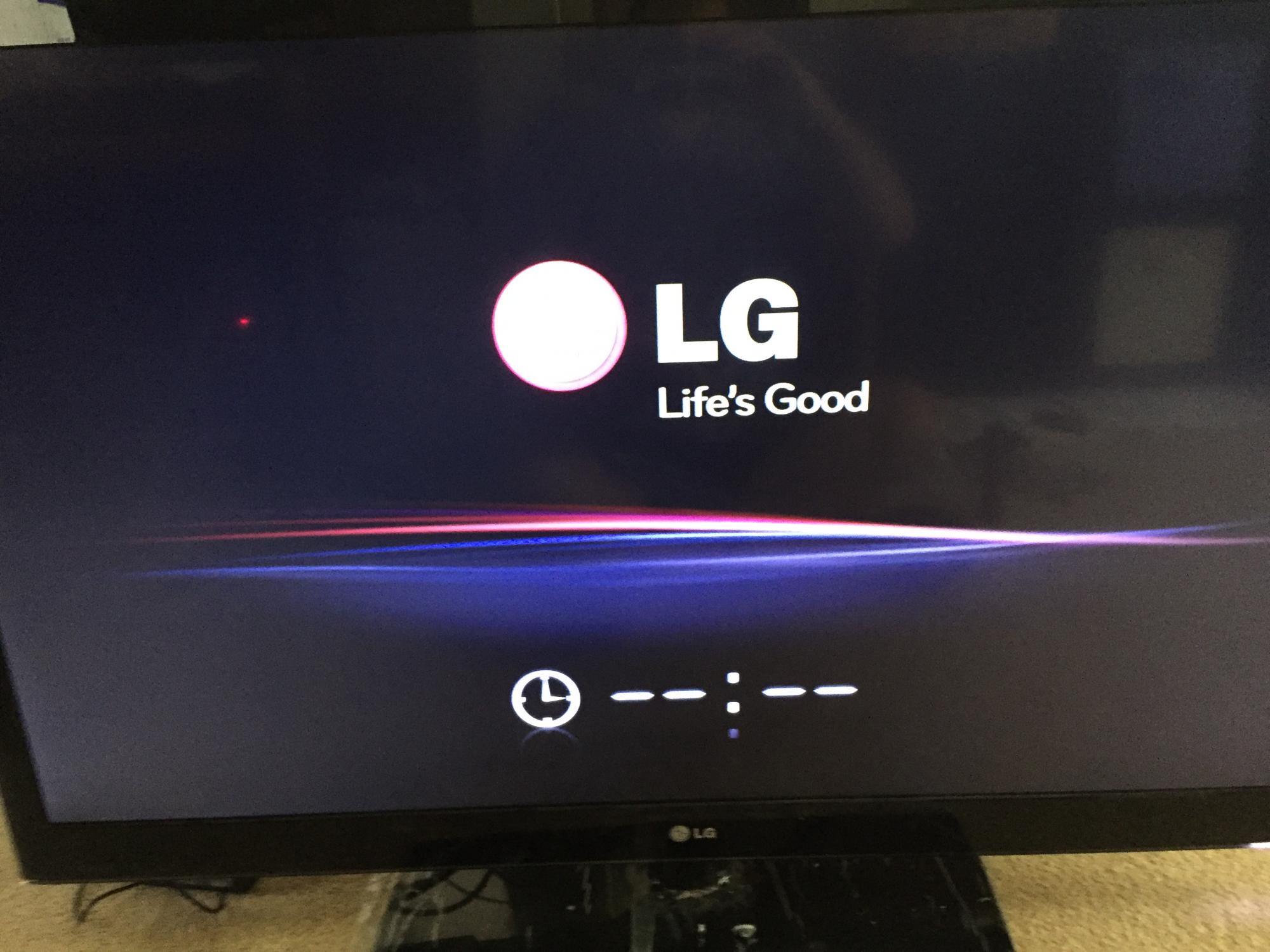

    Just got this today for free. Not sure how to describe the problem.
    The tv will on, LG life is good will splash on the screen then disappear. Back lights stay on.
    Some times the lg life is good message flashes a couple more times other times not.
    Not sure what to check, haven't even taken it apart yet.

    Re: Lg 47LV5500 issues.
    Mainboard issue, probably bga solder on the Cpu or firmware failure.

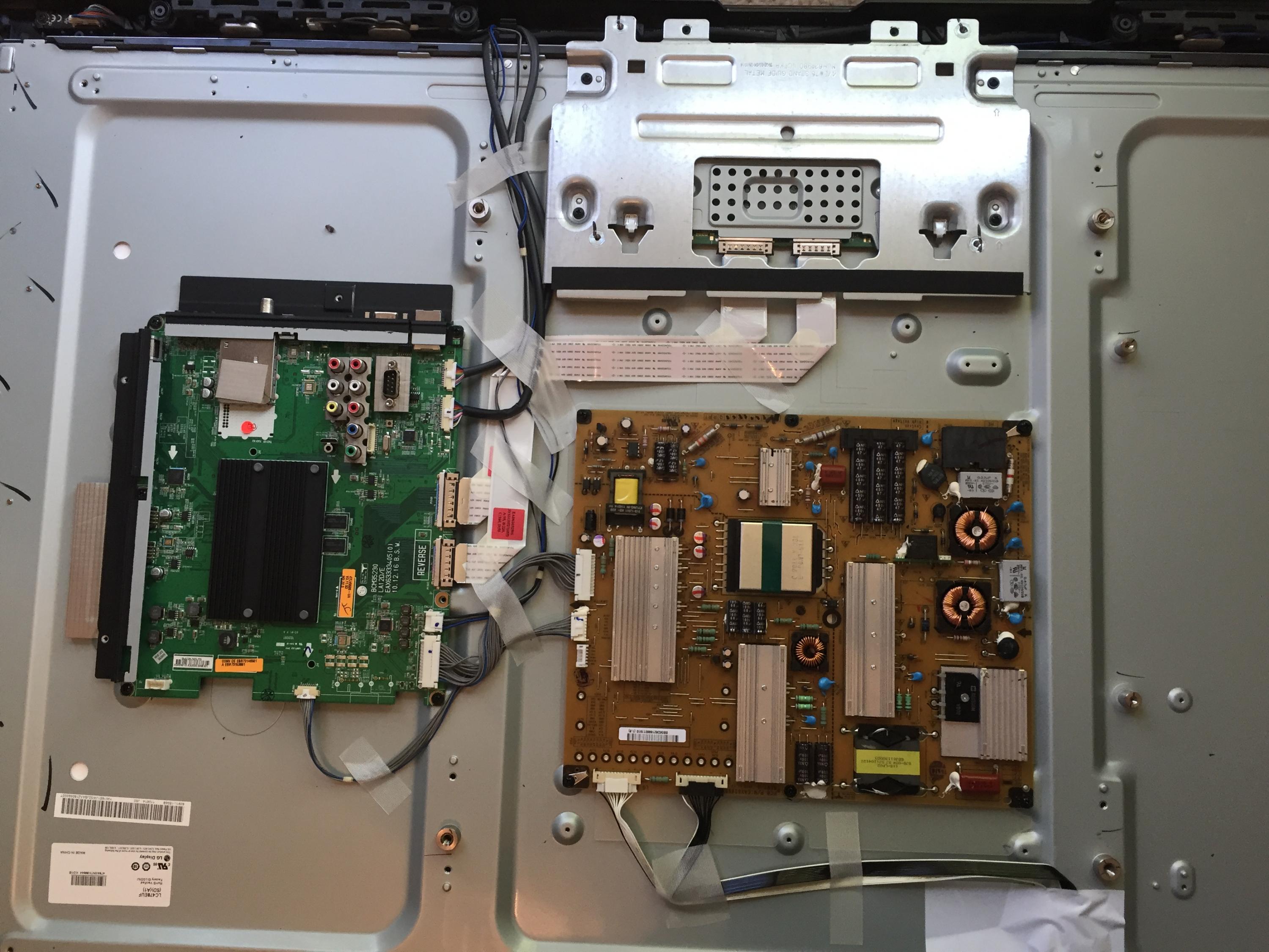

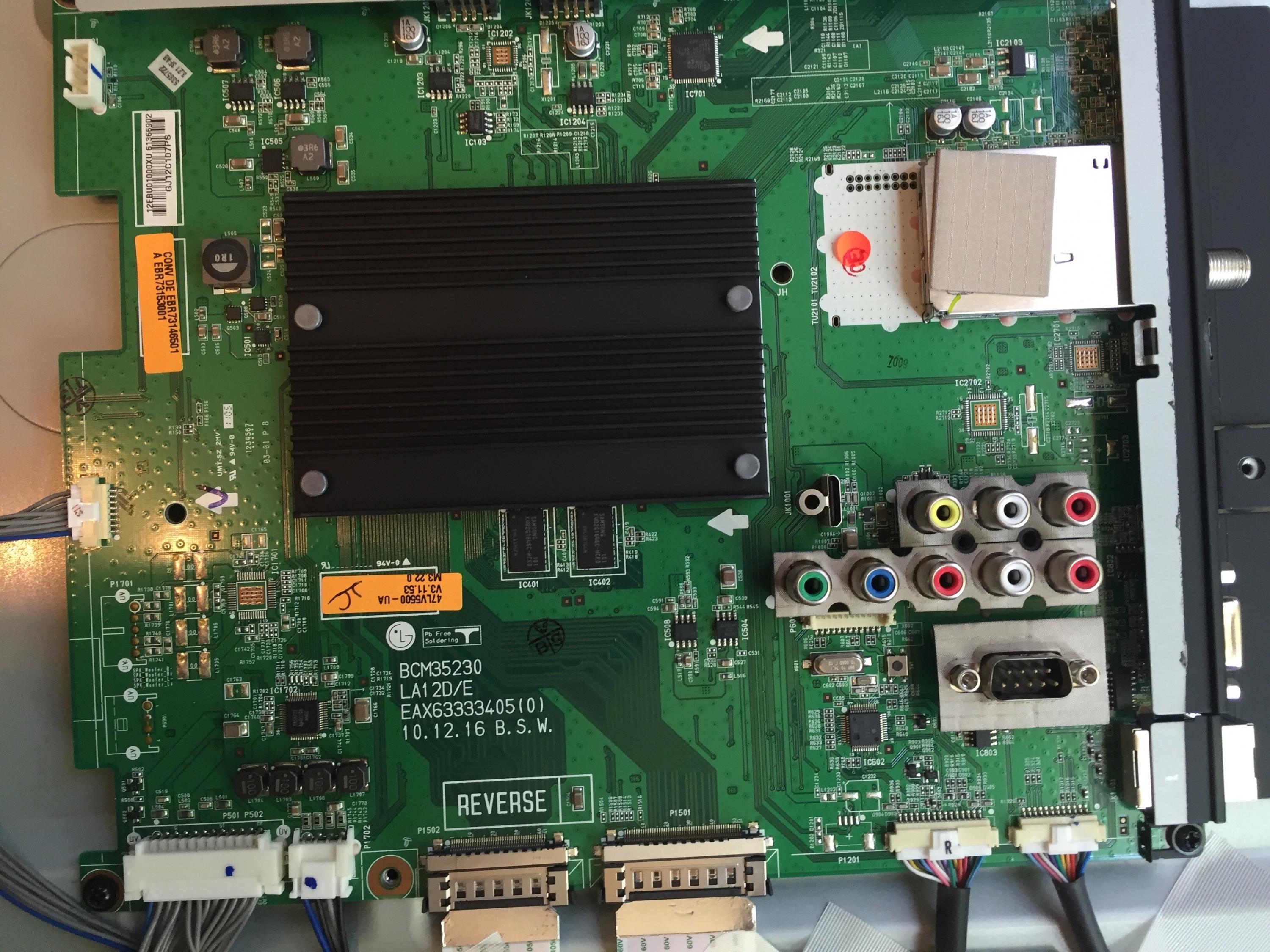

            Well take the back off first and get us an image of the board please.
            • Malachi
              • Dec 2015
              • 1077
              • Usa
              Here you go. never worked on a tv this thin.
