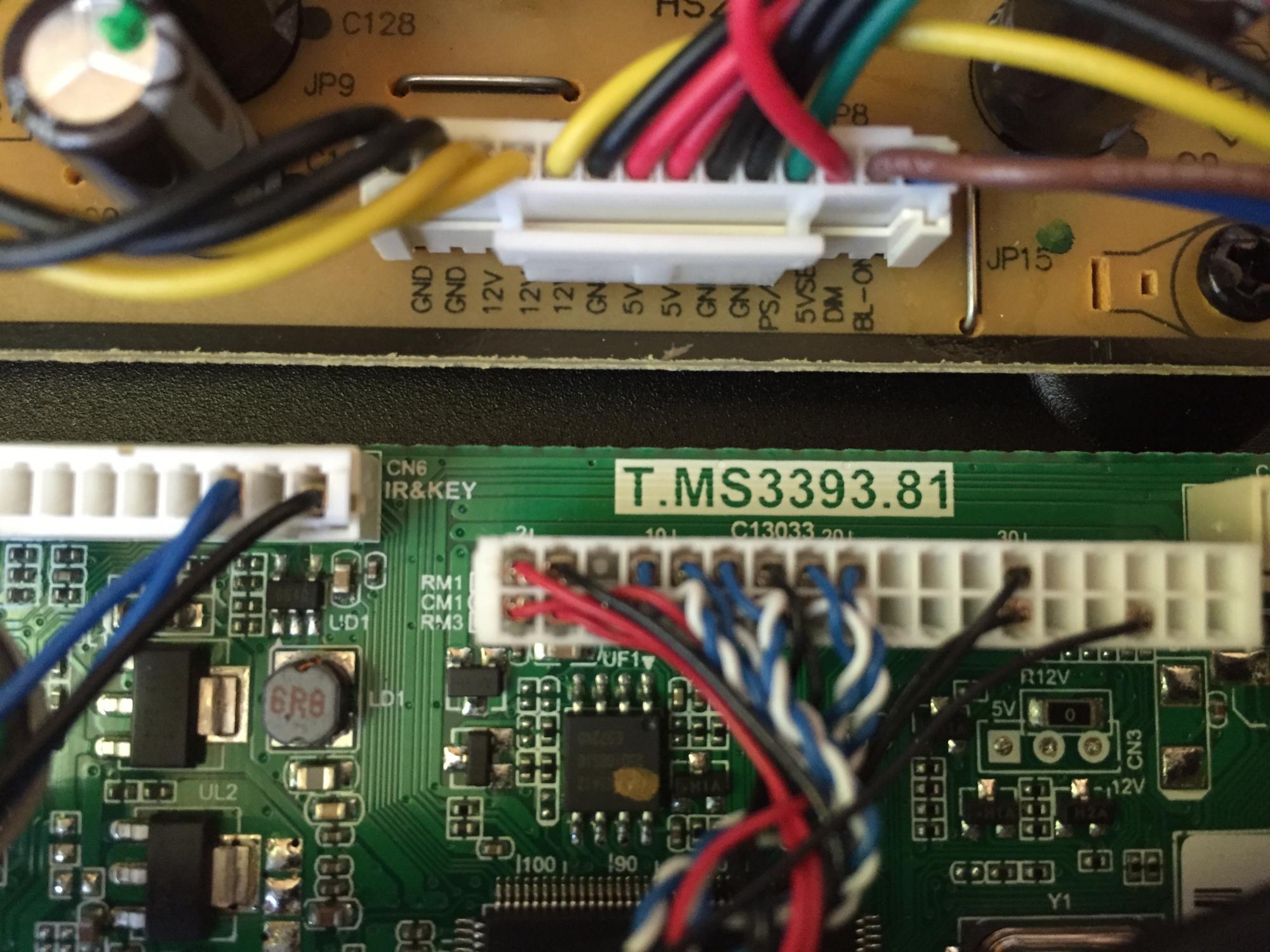

    Just picked this up today, it won't turn on, the front led stays red.
    I measured the voltages on the power supply connector. I've got 12v where it is labeled 12v, 5v where labeled and PSON is 4.5v.
    5VSBY is 5v.
    There is a pin labeled DM that reads 4.7. BL-ON is 0V.
    Measuring between the big cap shows 166V.

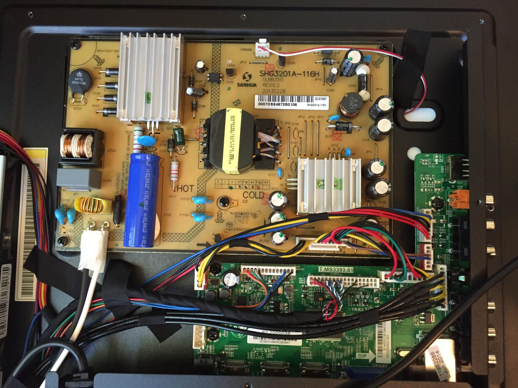

    Well, you do not have BL-ON signal to turn the backlights circuits.

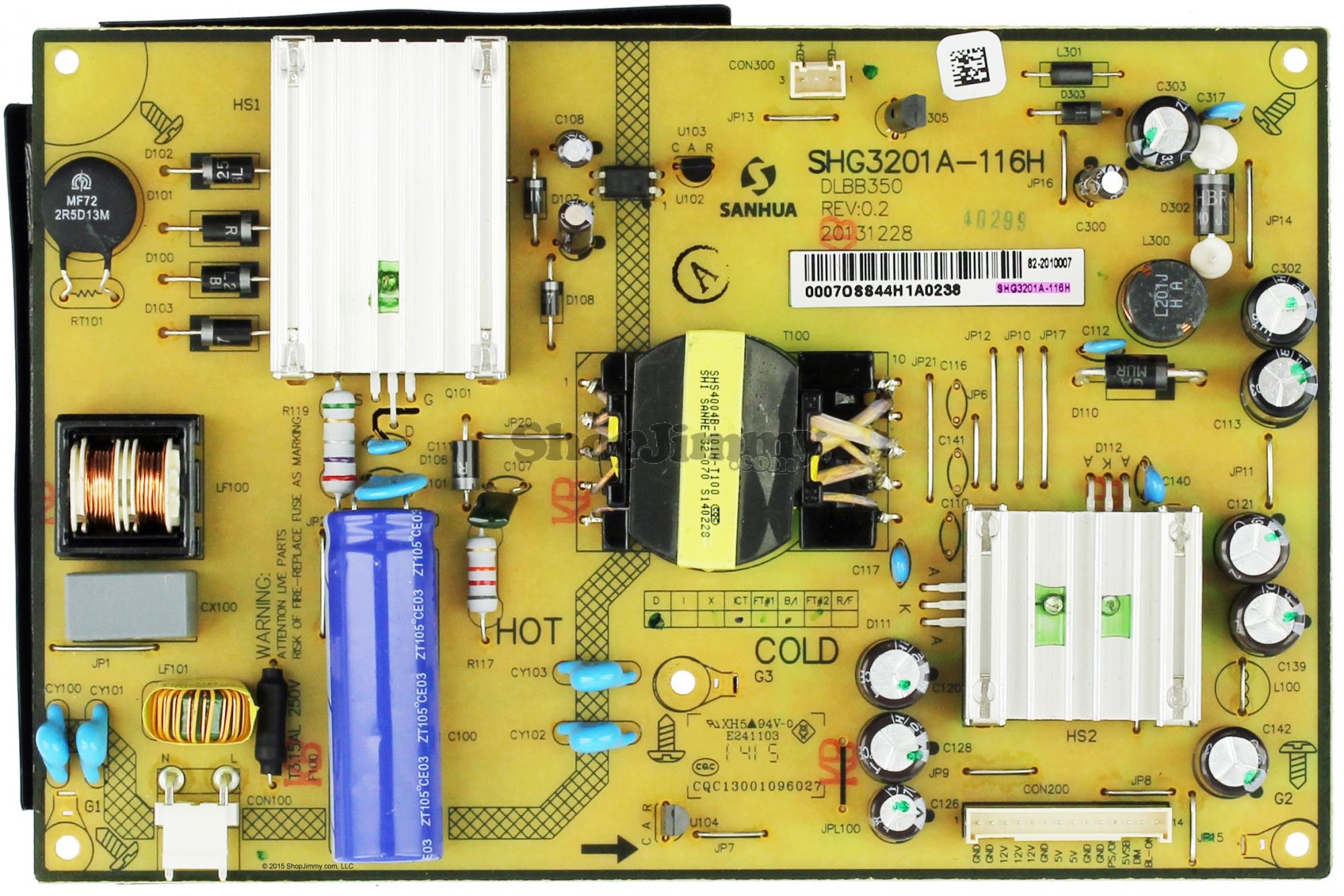

    How about the pictures of the whole power supply to find out if it has PFC Voltage booster circuit or not?
    • Malachi
      • Dec 2015
      • 1077
      • Usa
      Re: JVC LT-32DE74 won't turn on.
      Here you go.
      • Malachi
        • Dec 2015
        • 1077
        • Usa
        Picture from shopjimmy might be clearer.

            Can you jump a resistor from +5V to BL_ON to test if the backlights come on or flash briefly.
            • Malachi
              • Dec 2015
              • 1077
              • Usa
              Tried it, nothing happened. I stuck it in with the connectors still in place. Is that ok?

                    No, you need to disconnect the mainboard. Use a 1K resistor to jump 5VSTY to P_On then check that all the supplies come up.
                    You can use a second jump resistor (1K) to then connect 5V to BL_ON.
                    Two resistors in total.
