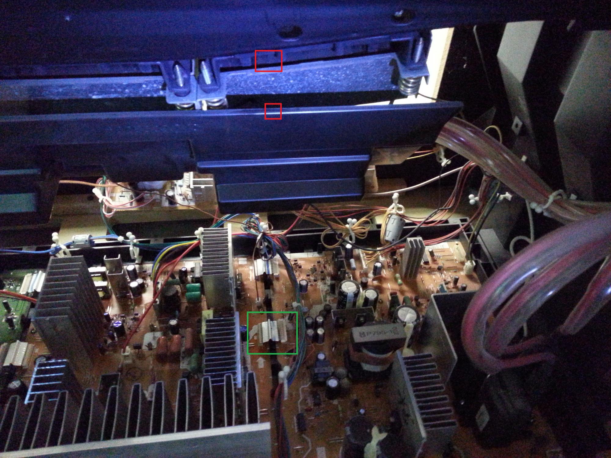

    Yep, got a CRT rear projection HDTV to work on. Basically, after transporting it, fixing the cold solder joints on the convergence ICs, and cleaning the lenses, I got it all put back together and everything worked great for about two days. I had just ascertained a non-malfunctioning Xbox 360 to put this thing through its paces and was all ready to get started, but when I pushed the power button on the set, it just clicked right off and started blinking the power light. Removing and restoring power has not changed the condition and holding "menu" and "input" does not provide any kind of an error code.
    Before I go any further, I need to clarify that this is not one of the digital Mitsubishis with the DM that always breaks down and causes the "blinking green light of death".
    Anyway, I cracked it open this morning and found that coolant had inconveniently dripped from the red tube onto one of the white ribbon connectors going between the mainboard and the power supply (first two pictures). After removing the board and thorougly cleaning it up (third picture showing burnt, but clean, ribbon), I was hoping that it might be fixed, but it is unfortunately still doing the same exact thing. Further inspection of the rest of the set has revealed no other obvious coolant leaks or stains.

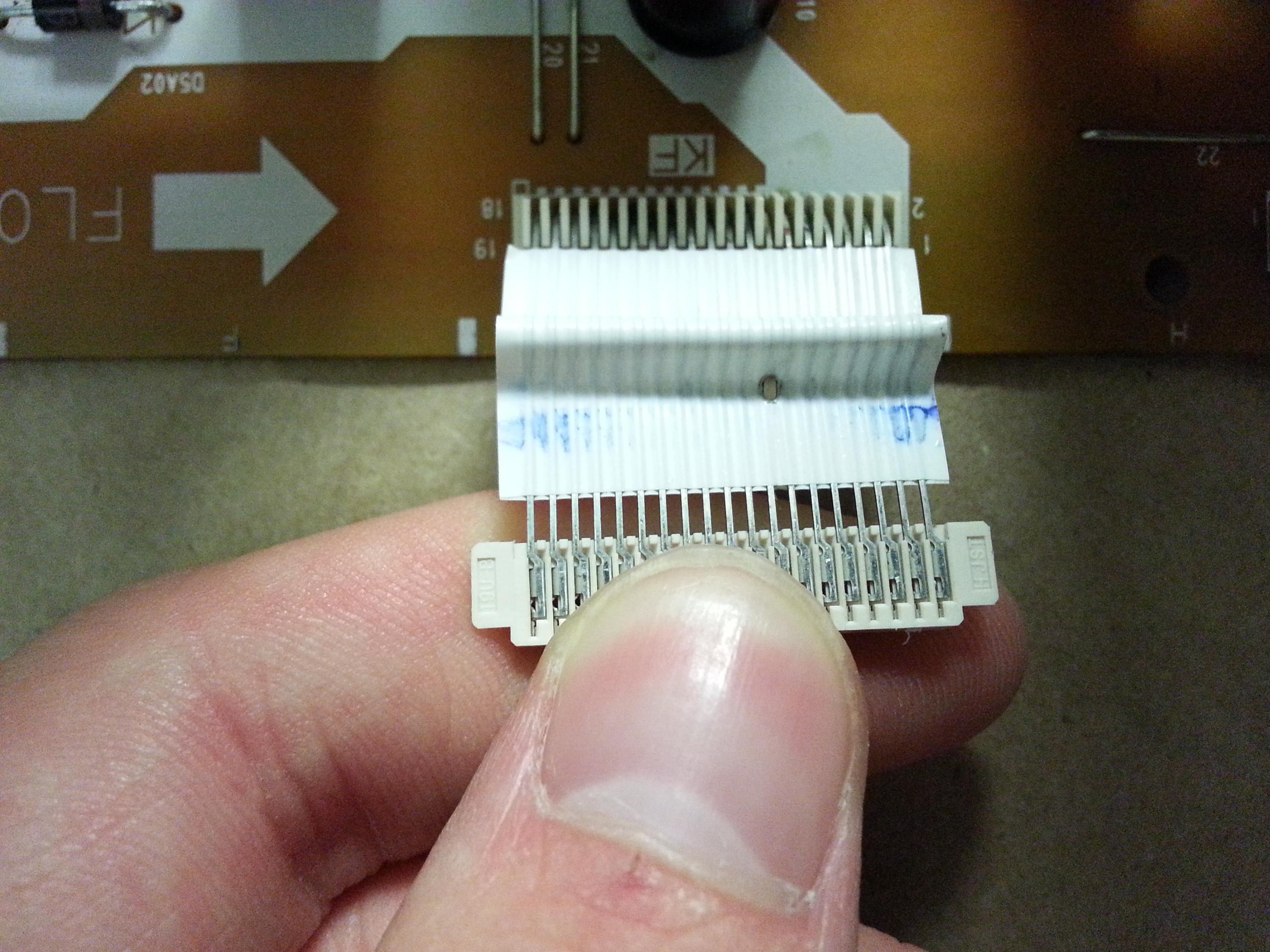

    Has the ribbon continuity where you have the burn mark? Are you sure that the burn mark wasn't already there due to heavy current passing through that connection wire prior to your repair.
      Continuity is good on the pins close to the burn. And looking back at my footage from working on it days ago, the burn definitely wasn't there.

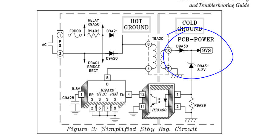

            fluctuating 9 volt standby problems!
            This is weird. With everything plugged up normally, 9VS is fluctuating between 2 and 8.5v randomly. Unplugging the signal board causes it to come up to fluctuating between 24 and 30 volts.
            Specifically, I'm testing across D9A30 (as shown in the attached picture from the service manual), but it looks the same from any other 9VS test point in the set.
            Any ideas?

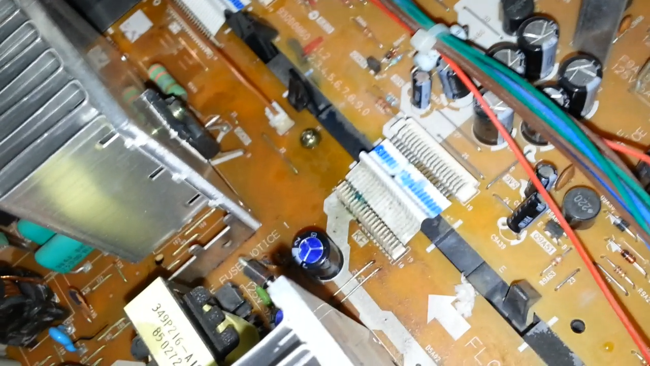

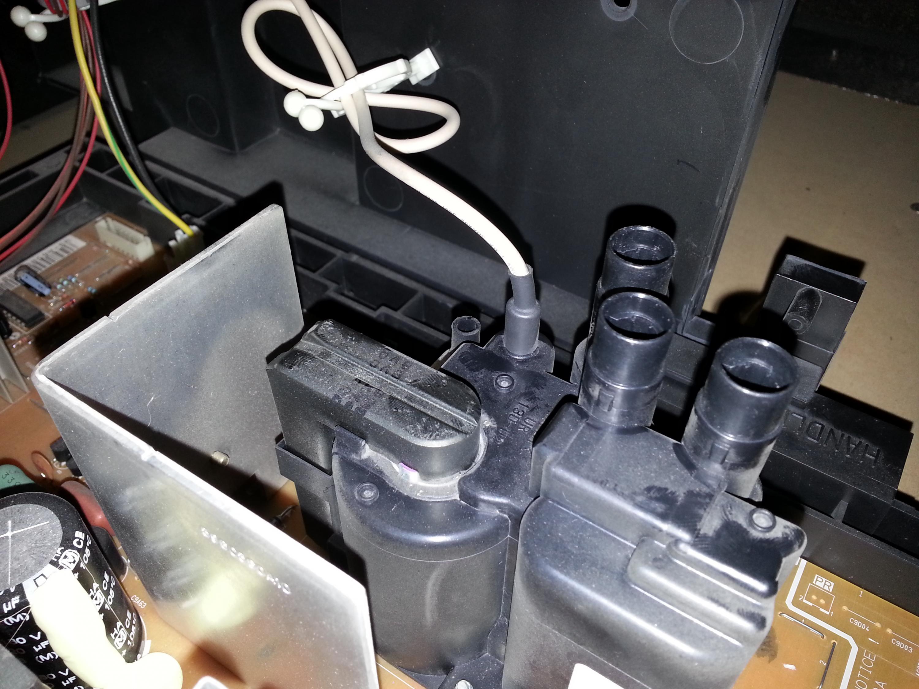

              I decided to remove the power board to get a better look at it, but am having trouble with this one white connector over by the high voltage area. It doesn't seem to want to push, pull, or twist. Any ideas as to how to get it off?

                You mean the white cable right? The white connector is to hold the cable in place!
                I have not seen this before but just looking at that cable im sure it's shrink wire preventing either the cable showing the solder connections or for preventing something to get in/out.
                You can always remove that shrink wire and add a new one later. My bet is that you will see some solder!

                  I believe that Moreno83 is correct and it is probably soldered to the top of the transformer.
                  The schematic in post #6 shows a transformer giving 9Vs but in the photo post #7 it looks like a line output transformer used in CRT sets that provided the 10-30K for the crt tube?
                  Just had a look at the manual
                  Post #7 is the EHT transformer (T5A51)
                  I also believe that Moreno83 is correct and it's a sleeve that should pull upwards.
                  Can you unclip the lead from the other end which fits into the crt tube.

                    Looking at your schematic post #6, D9A31 is an 8.2V zener and assuming you need 1.5V across the led of PC9A50 (pins 1 & 2) then total voltage = 9.7V and the zener should regulate the voltage to that approximate voltage.
                    Have you checked what dc voltage you have across the zener and the diode (pin1-2)
                      I'm getting pretty much nothing across the zener at D9A31 and fluctuating 25-28v on pins 1 and 2 of PC9A50 (this is with the mainboard and signal board disconnected from the power board).

                              white wire goes down into the transformer, you cant desolder it - from that end anyway.
                              it runs at several KV so dont cut it - it's the focus or grid wire.

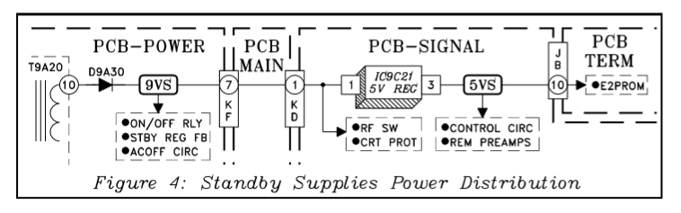

                                I think so. On page 23 of the training manual, it says: (along with figure 4 attached to this post)
                                "D9A30 rectifies AC from a secondary winding of T9A20, generating a 9VS supply. This is the source for all standby supplies in the TV"

                                You're probably right. Closer inspection reveals that it goes to the box with the electrostatic focus controls and is similarly attached to it. I sure hope that this board isn't too far gone that it has to be replaced instead of fixed because that one cable and connection would make the process into a sizable headache.

                                  If its an EHT cable connected to one of the CRT's then it may well be that it can be unclipped from the tube.
                                    If I'm tracing it right, it looks like it's going directly to the back of the box with the screen and electrostatic focus controls, where it is also fixed without an easy means of removal. That said, there's actually a bit of extra slack on it; enough that I could probably flip the board over in the set to do any necessary soldering (hopefully) without having to unplug that pesky cable at all. The position might not be optimal, but it could work. My main concern at this point is finding what is causing this weird fluctuating standby voltage problem.
