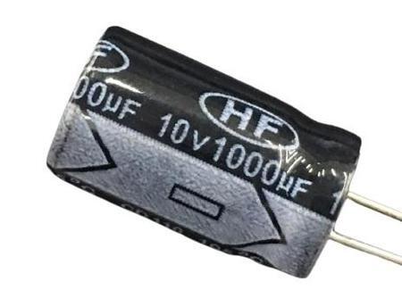

    Electrolytic capacitor leak in storage?
    there a risk of this aluminum electrolytic capacitor of electronic device long term storage opening and leaking acid and corroding the PCB board?

    • 31122
    with cheap rubish caps - yes.
    but it takes years

        No. "protective layers" corroded? Work on your English. It's the rubber bung shrinking, drying out that allows the electrolyte to leak out in storage. It's uncommon unless they are cheap chinese capacitors that use recycled car tire rubber lol, or the reflow was too hot.

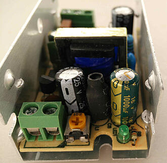

              Just confirming - do caps bulge and then leak although in storage?
              Aliexpress (Xnbada store) power supply, JCPOWER JC-10-5, 5V 2A. Unused although I remember doing a brief load test on it.
              Sits on my shelf for over 2 years and today I see this bulging cap 1,000uF 16V yung Li garbage brand. It's about 145uF and ESR 1.3Ω. IC is ME8115F.
              I'm assuming it made it's own gas, sitting there corroding inside- and then broke the vent.
Name:	JCPOWER JC_10_5 bad cap.jpg

                i have seen lots going bad by not being used . maybe they had started going bad already though as they are on scrap boards .
                • redwire
                  • Dec 2010
                  • 3912
                  The stronger the electrolyte (acid H2SO4) concentration, the more capacitance you get. The corrosion-inhibitors, the missing secret sauce behind the "capacitor plague" I don't think are the problem here.
                  It's just china being cheap. But I didn't expect hydrogen bubbling while no voltage was applied.

                      I think that's a manufacturing defect with the Panasonic FC and it's not enough to make the cap fail or wreck a PCB. Just a little green crud on the leads. Could be the wash, excess electrolyte during assembly on the leads.
                      It's not making enough hydrogen gas to bubble the top and vent and die lol.
