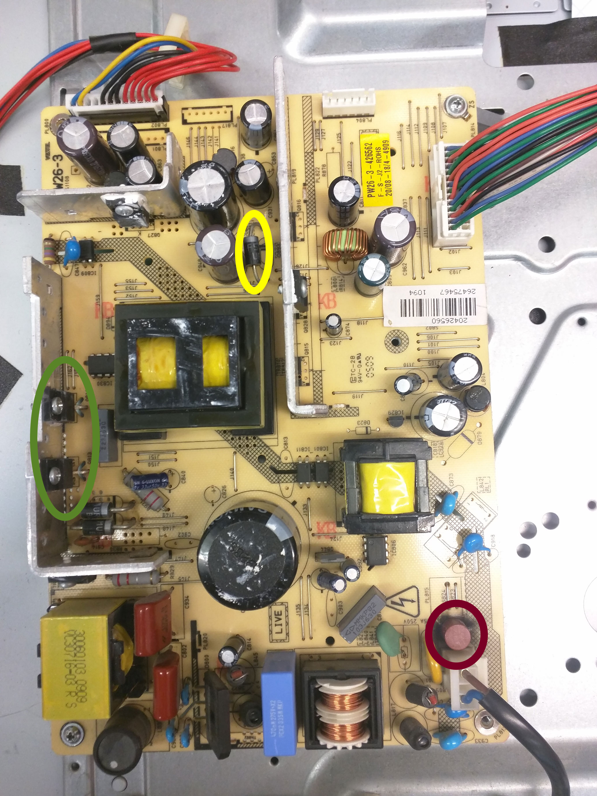

    This board came in with no display. Replaced few caps and was well. About a week later, tv returned dead; no power, nothing. Looked inside and yellow oval (in picture) was shorted. Replaced it and fuse blew (red). Replaced green and fuse stood strong. The new issue is that the blue light on tv just kept blinking/flashing. What is needs replacing?
    I've took the transistors from an old board. Do I need new trans (green oval)?
    The TV: Hitachi 42hxt42u

    Transistors and mosfets are not always interchangable due to their characteristics. What part numbers did you take out and what part numbers did you use to replace them?

        Re: 17PW26-3 Issue: Flashing Blue Light on TV
        Oh!
        Original: p9nk50zfp
        Replaced with: fqpf9n50c
          Originally posted by speedypro
          Oh!
          Original: p9nk50zfp
          That will work fine that part will.

                      Just saw this. Ok, replaced IC806 and BD140, both of which are brand new but same flashing blue light. Would the main av board has anything to do with this?

                        Wait there a second, unolug the Mb from the psu and apply power to the Tv. Check if you get 24v and other voltages like 12v and 5v from the Mb connector first to see if the Psu is working.
                        • speedypro
                          • Feb 2013
                          • 561
                          • United Kingdom
                          Got a service manual to see which pins has what voltage? I've place my multimeter (-) where the black wire goes and probe the rest with (+) and got 5v and 6v. No 12v nor 24v.

                            check also d882 d883 as read these can go sc

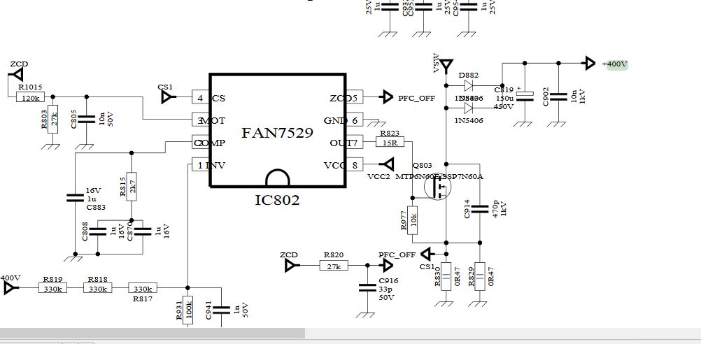

                                    • Mar 2012
                                    • 6714
                                    • uk
                                    Maybe reece has some more ideas is the pfc circuit working ok ? not sure if it needs this too get the missing voltages running etc
                                    • dick_barton
                                      • Aug 2015
                                      • 6643
                                      • Wales
                                      Have you got +400V
                                      • speedypro
                                        • Feb 2013
                                        • 561
                                        • United Kingdom
                                        Have you got +400V
                                        I assume ac? No voltage ac
