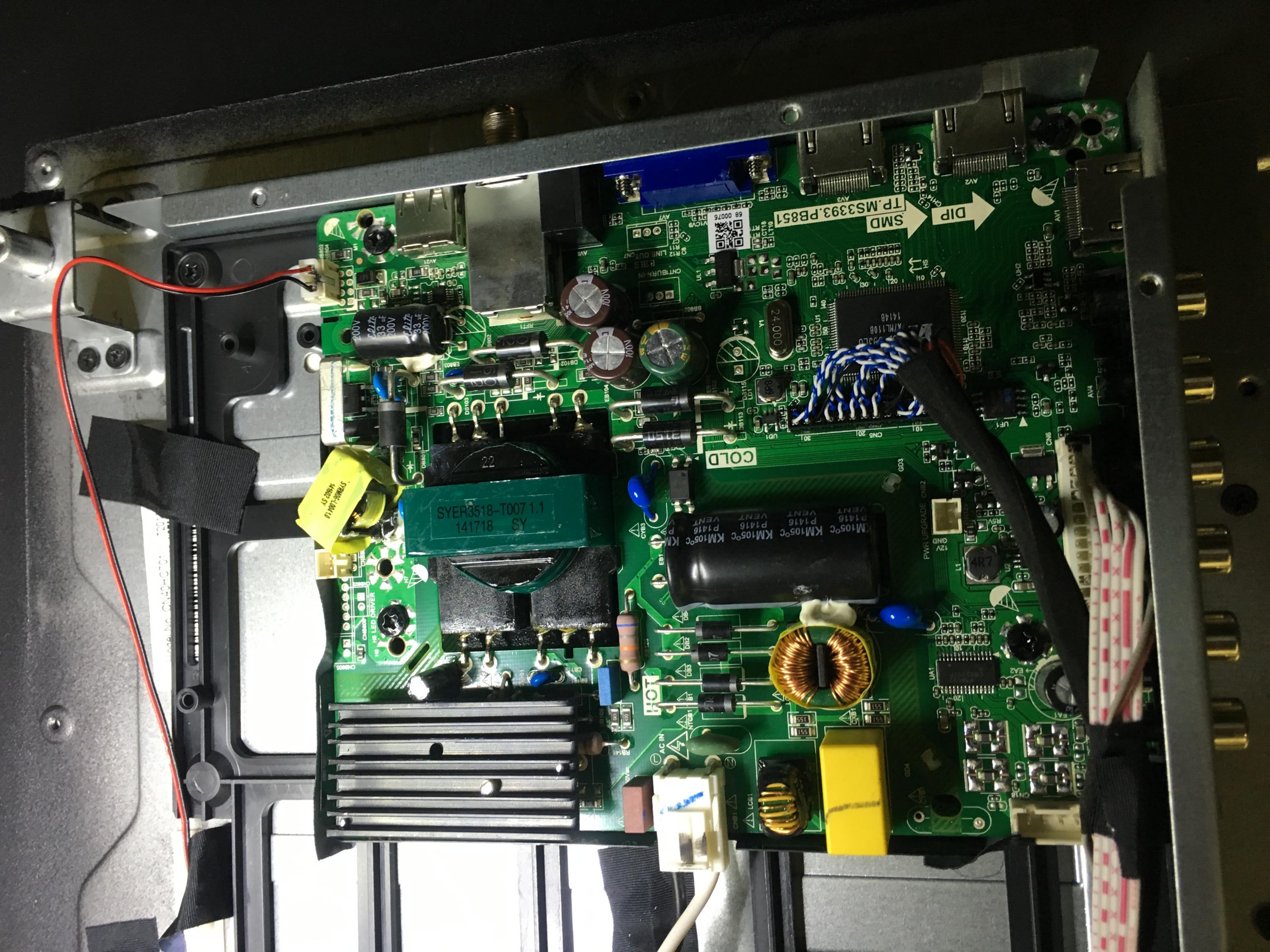

    Hey all. I have an RCA LED tv that will not power up. The standby LED stays red and doesnt do anything when the remote or power button is pressed. I get 60V coming out of the connector from the LED boards to the p/s, main board. Any ideas what to check. There is only 1 board in this tv/power supply/main board combo.
    I tested the IR board to make sure the remote and power button boards were good and they tested normal.
    Any suggestions. I HATE RCA for not providing service manuals.

    Well I can say Epprom/spi flash Ic aka firmware issue here. Check Sj for epprom repair kits for this Tv.

              board. I did find the power supply on eBay, but its for other brand TVs. Would these boards work or not?

                take that board out and post a hi res, straight shot picture of the back of it. There is a connector to the far right of your picture. See if there is a pin out. Also measure the voltage of the main filter capacitor.

                  Some how the TV must get a signal back from the key pad in order to turn the TV on, so see if you can find it.

                    I will do that tomorrow and let you know what I find.
