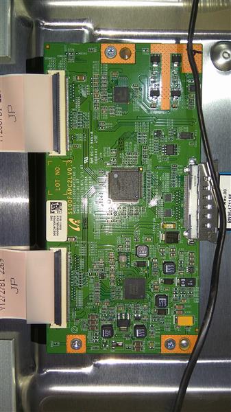

    * disconnected just the T-CON - power cycles

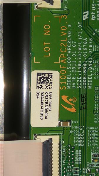

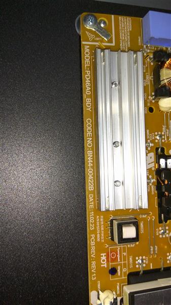

    Re: Samsung 40" LED UA40D5500RMXXY AC03 cyclic reboot loop

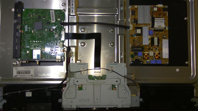

    Lets start by showing us good clear pictures of the whole back side of the TV so we can see all the boards and how they are connected together first.
        Thank you for replying
          Since the backlights come on and stay on when the Mia board is not connected to the power supply board, it means the power supply and the backlights are OK, so the problem is on the main board.

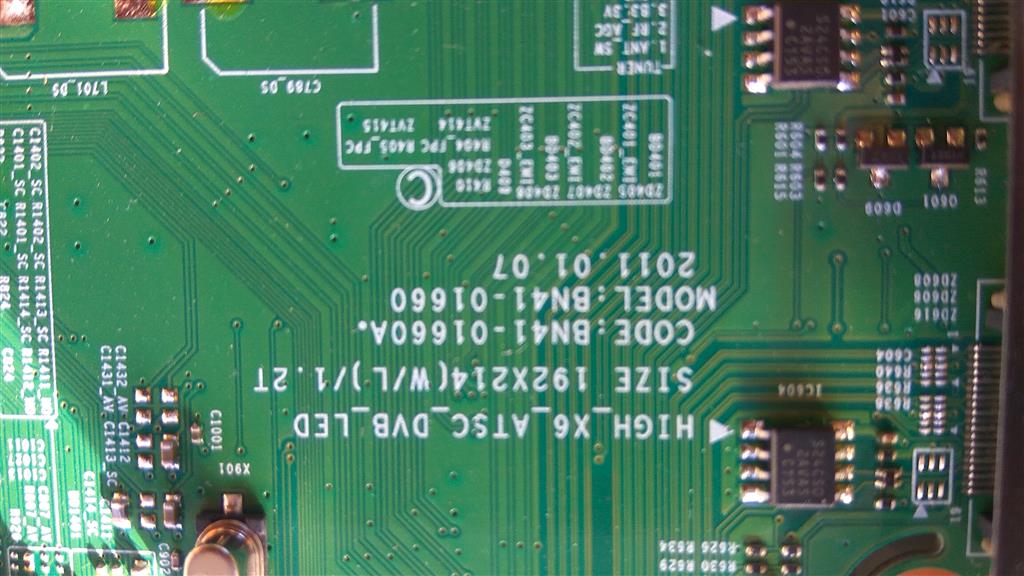

            The current board has the following on it:
            BN94-05012Y PTV4(PM) which I think is the part number, but I'm not 100% sure

                Thank you for the replies. I can't find the UA40D5500RMXXY on the shopjimmy website, and am assuming that it might just be an Australian model(?). If I were to replace the mainboard with an overseas alternative, would it cause issues due to an incompatibility somewhere?
                Also, I have found a mainboard for sale that comes from a SAMSUNG UE40D5520RK/UA40D5500RM, part number BN41-01660B BN9405069D
                What are the chances of this working in my unit as it's a UA40D5500RMXXY?
                The T-CON board numbers are the same for the one for sale and my unit.
                I have no idea about compatibility between models :/

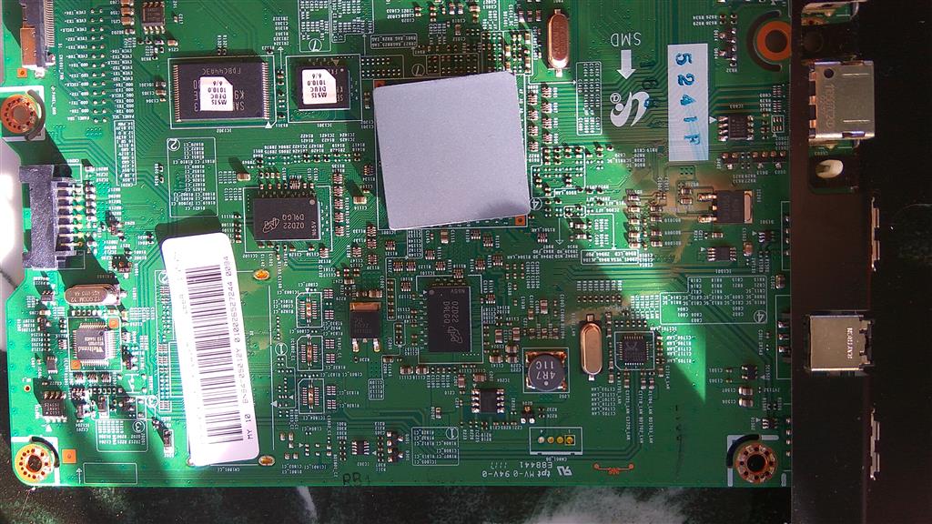

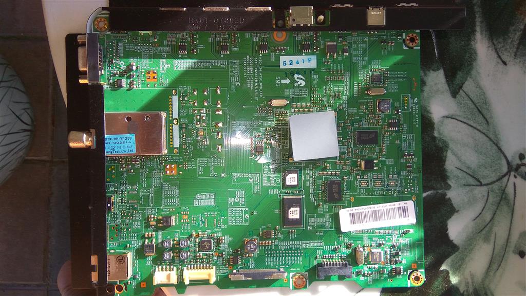

                            Can you post a sharp picture of your main board. The ones above are too small to identify parts on.

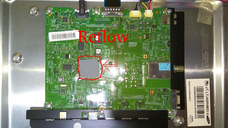

                                  If not the HDMI chip shoted then try this.
                                  [Veteran's Tips] by ReeceyBurger123
                                  Common issue on these boards is bga solder failing on the main processor which is under the heatsink, you could try reflowing it to see if it sorts the issue.....
                                  GPU BGA Reflow (Try this one)

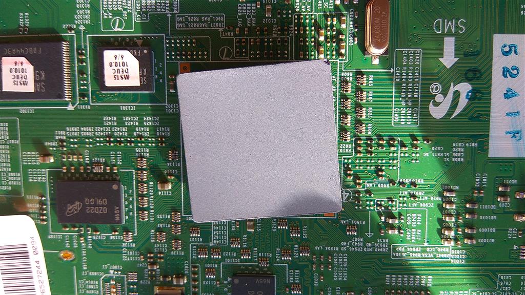

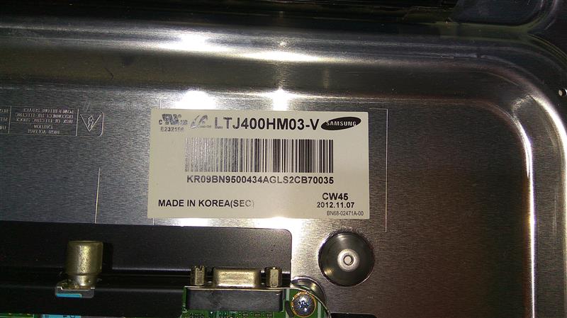

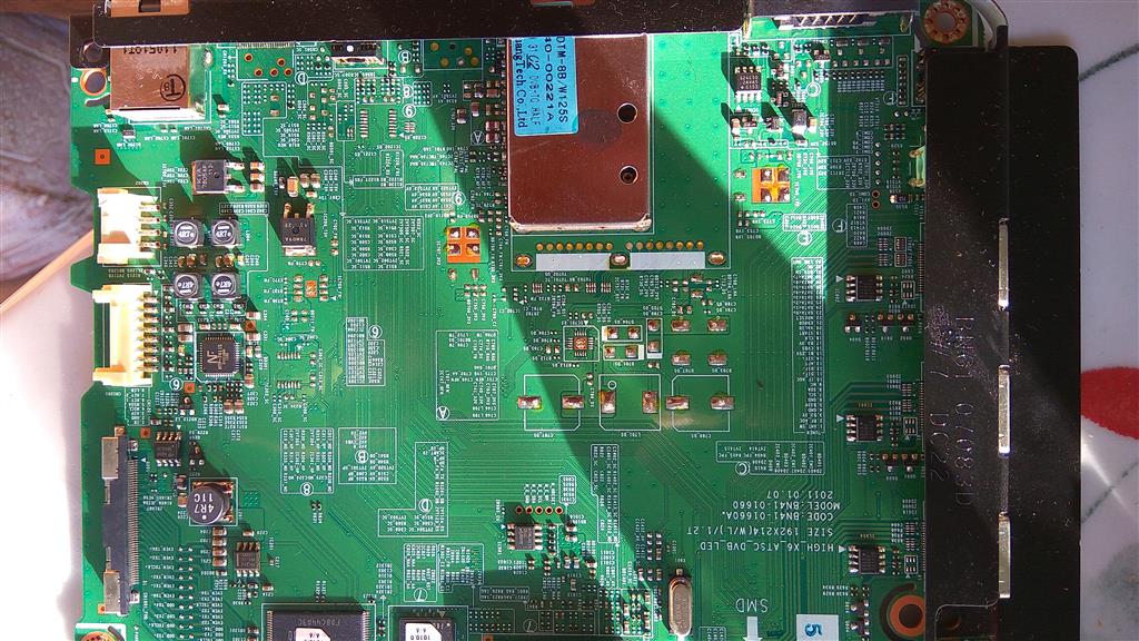

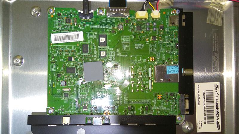

                                    Finally home from work for a few hours and I got a chance to take some more photos.
                                    The main chip seems to have a ceramic looking heatsink attached to it somehow... maybe some sort of thermal glue? Do I need to remove this to reflow the connections to the chip, or should I just heat it up as well?
                                    • Orpheous
                                      • Oct 2010
                                      • 43
                                      Quick update:
                                      So I hit the heatsink with my Hakko clone hot air gun and it popped off. It was held on by some white adhesive tape that I imagine is thermally conductive.
                                      I set the air to 240 celsius and heated it up for a minute, then let it cool off before reconnecting it in the TV.
                                      The problem is still there so I'm going to try again at maybe 260 degrees in a couple of days, and heat it up for maybe 2 minutes next time...

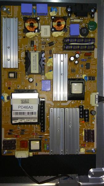

                                        I think I'm going to bite the bullet and buy a new mainboard for it...
                                        I can get one exactly the same as the original for AUD$180, but I want to test the power supply to try and reduce the possibility of frying a relatively expensive fix.
                                        Can someone link me to a noob's guide to testing an LED TV PS board please?
                                        Is there anything in particular that I should be looking out for?
