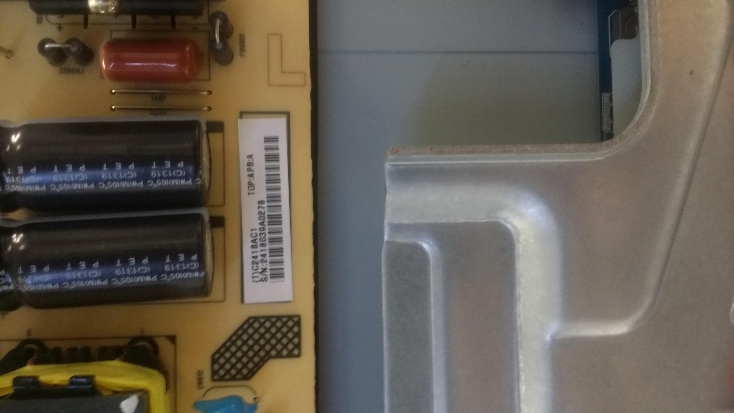

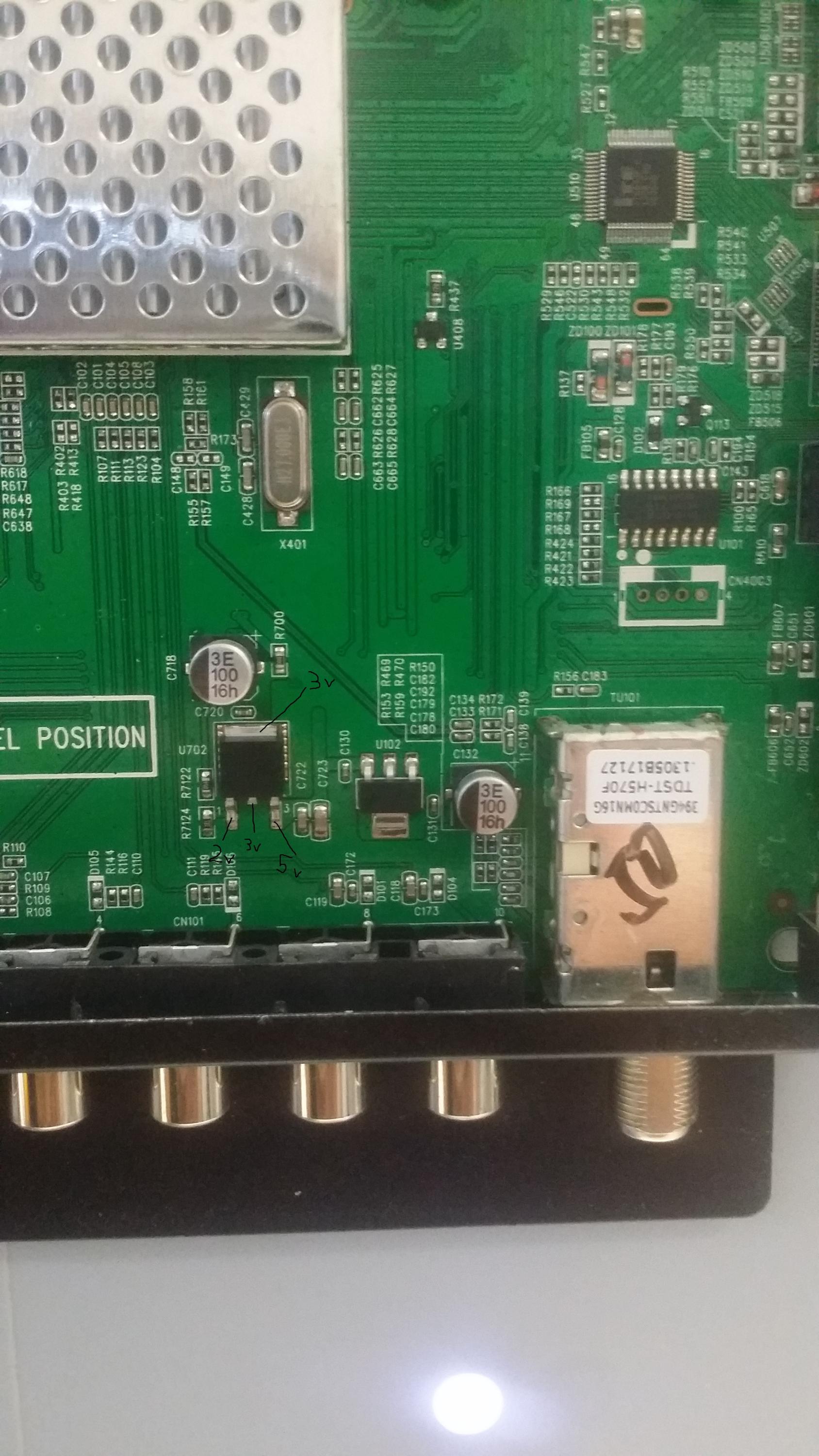

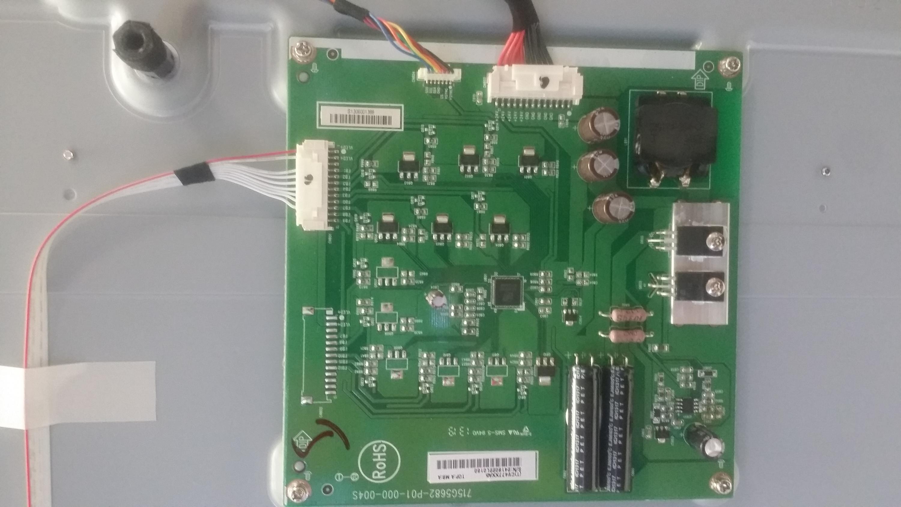

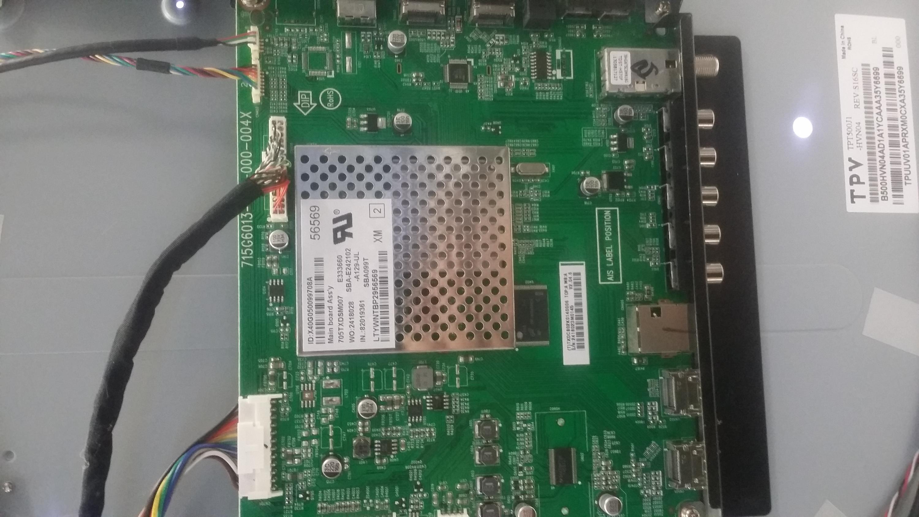

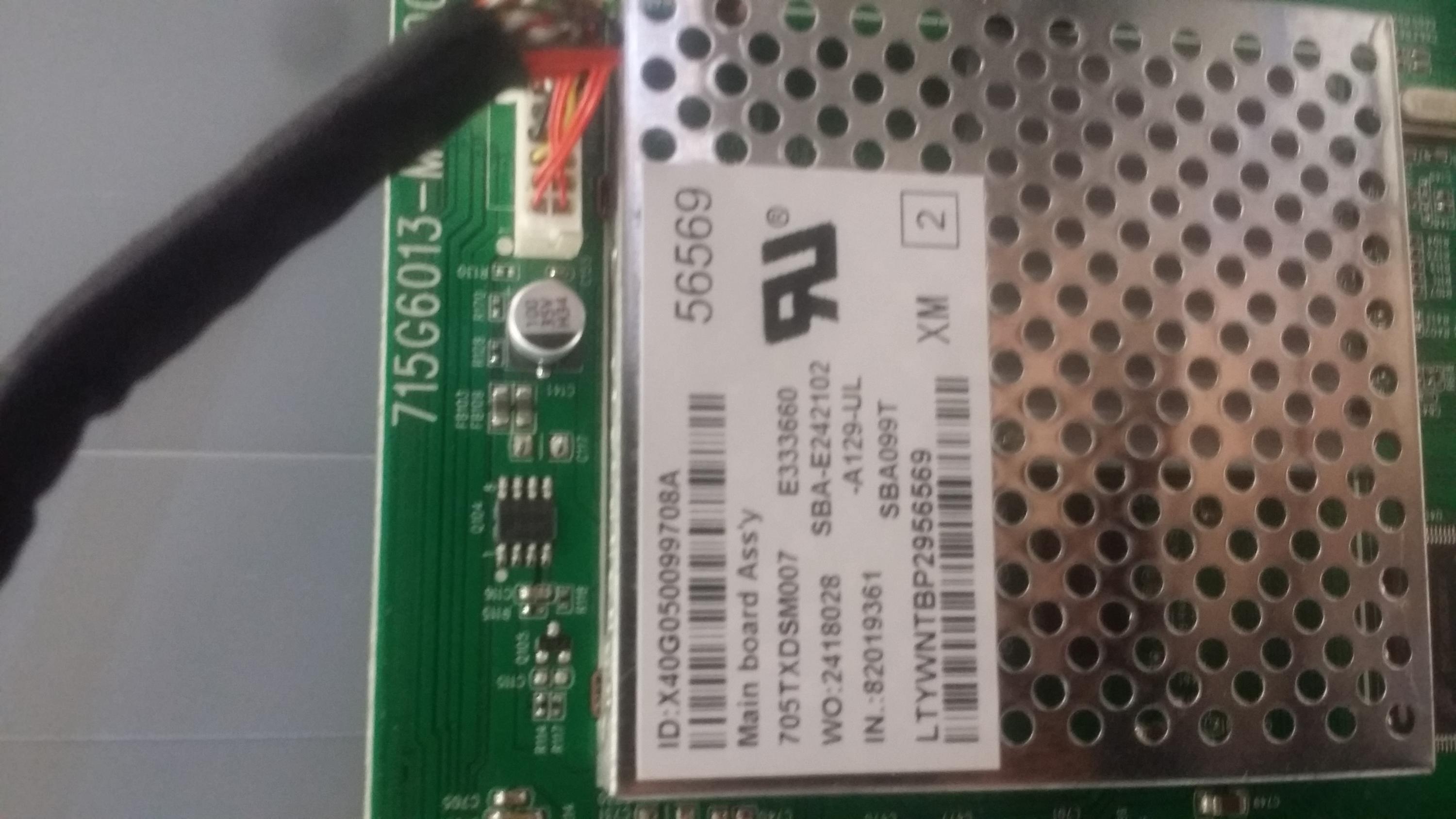

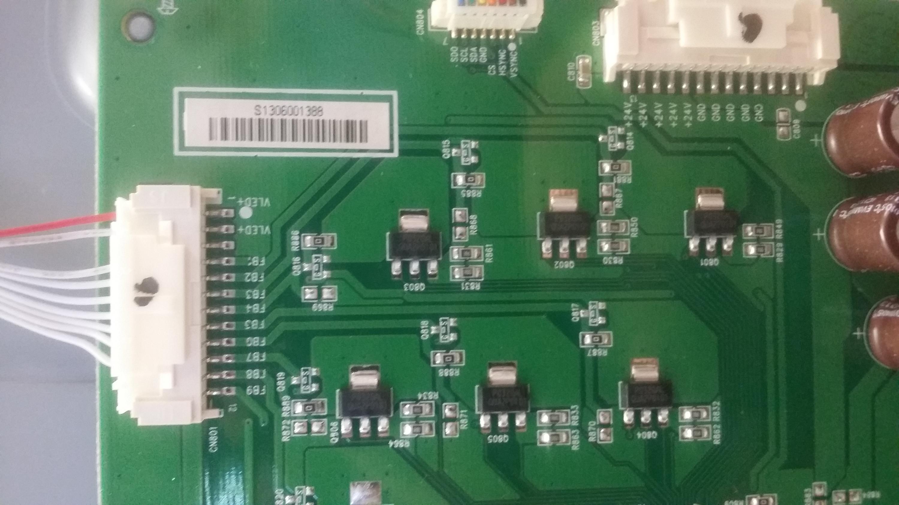

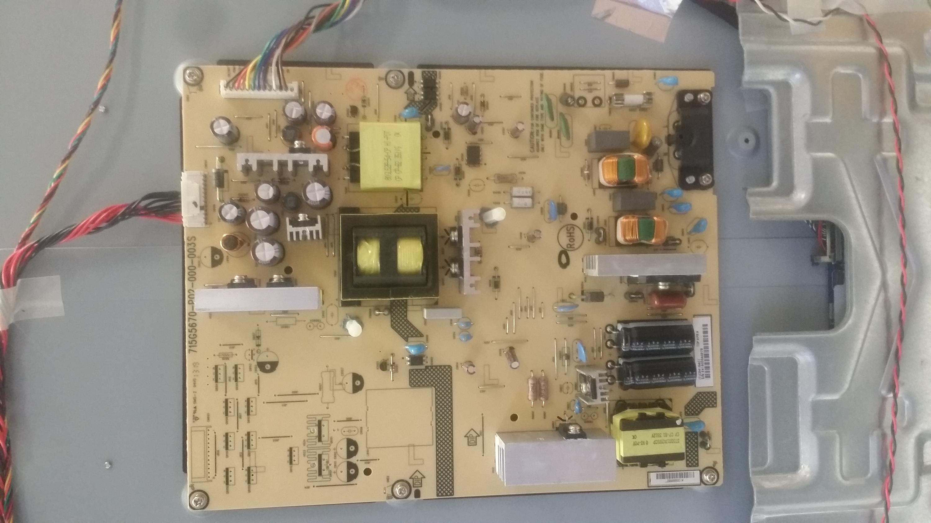

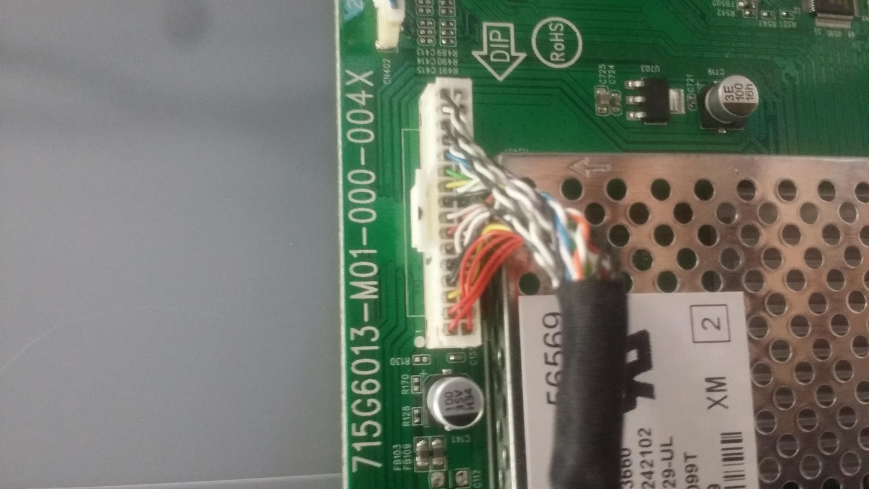

    Vizio E500-A1 Picture shuts down.
    I have a Vizio E500-A1 that will show an image and have audio for a few minutes after turning on. It will then shut down video and audio and will not respond to any panel button pushes. At this time i still have all the correct voltages from power supply to main board. The backlight also remains on when the rest of the tv shuts down. i have found one component i think may be causing the problem due to it overheating. i have listed voltages coming off of it. it is marked DII 1084 1252bg. Number on board u702
    Thank you for the help in advance.
