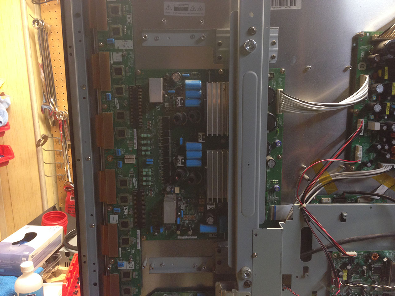

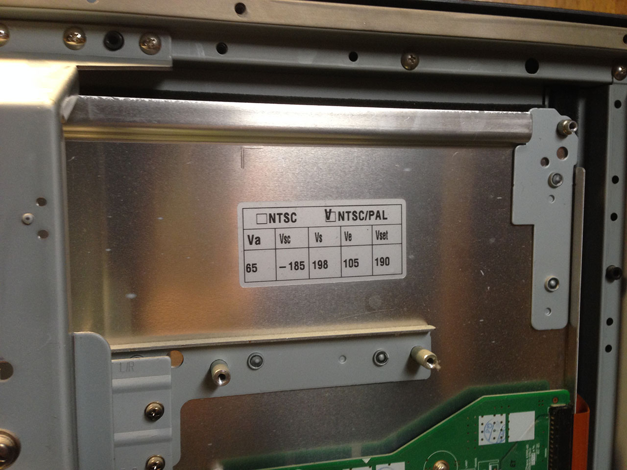

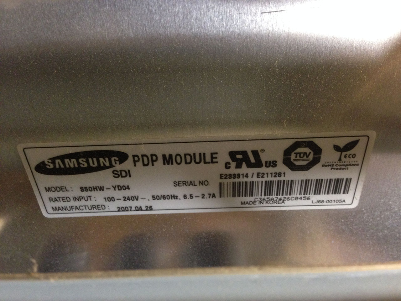

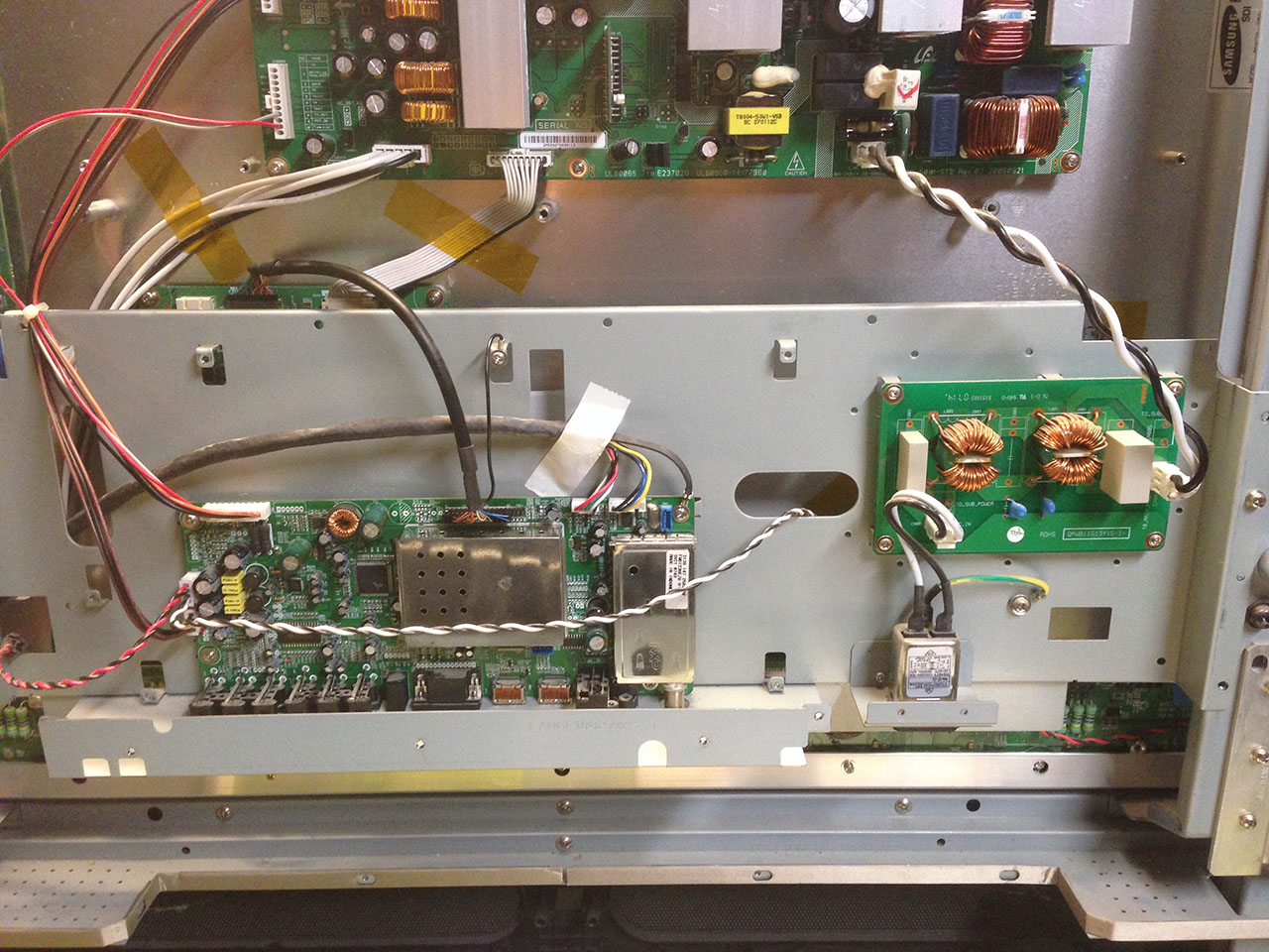

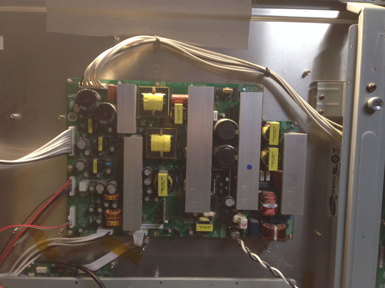

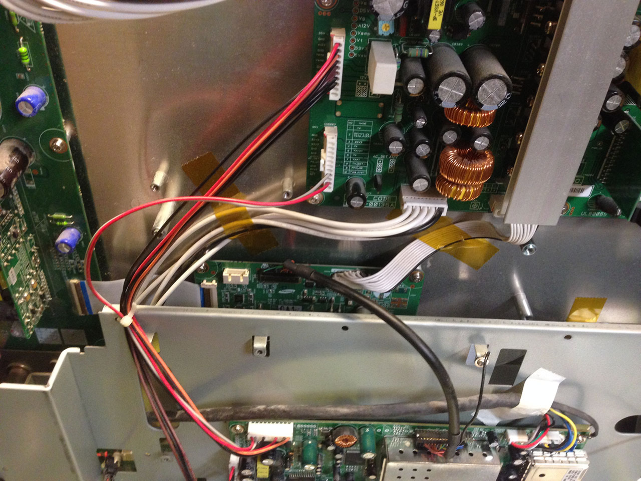

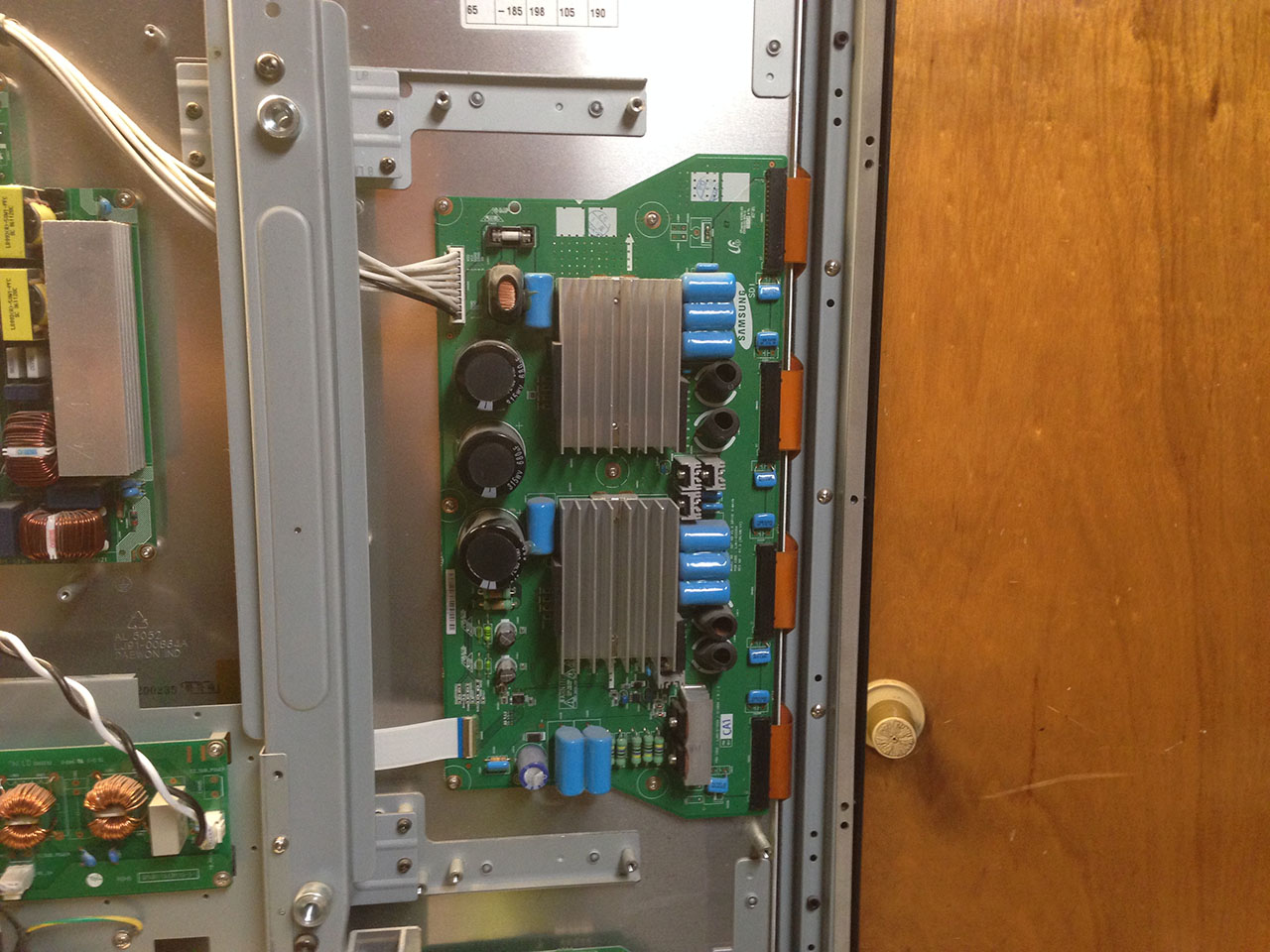

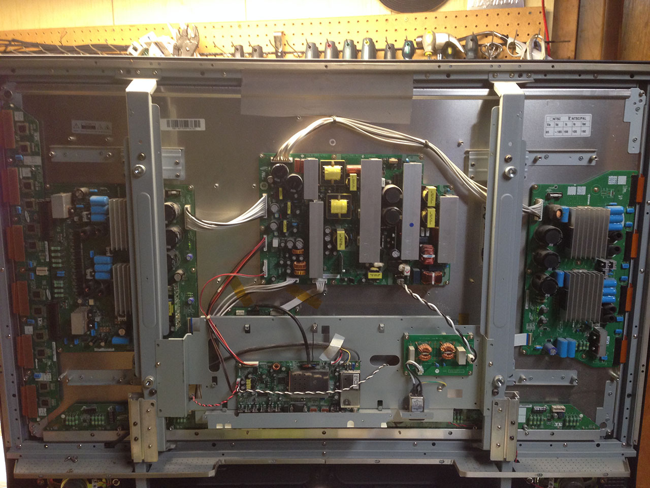

          Do you have clear pictures of your boards and the interconnections.
          • vizi0n
            • Nov 2014
            • 28
            Re: Maxent MX-50HPT52 has a shaky picture (video inside)
            Here, I have attached photos of the boards.
            Sorry if its not very clear, I have a shitty lighting in my home workshop
              The logic control board is half hidden by the metal chassis. Can you see what the part number is.
              • vizi0n
                • Nov 2014
                • 28
                It is the first thing I've changed last week. It is LJ41-03703A
