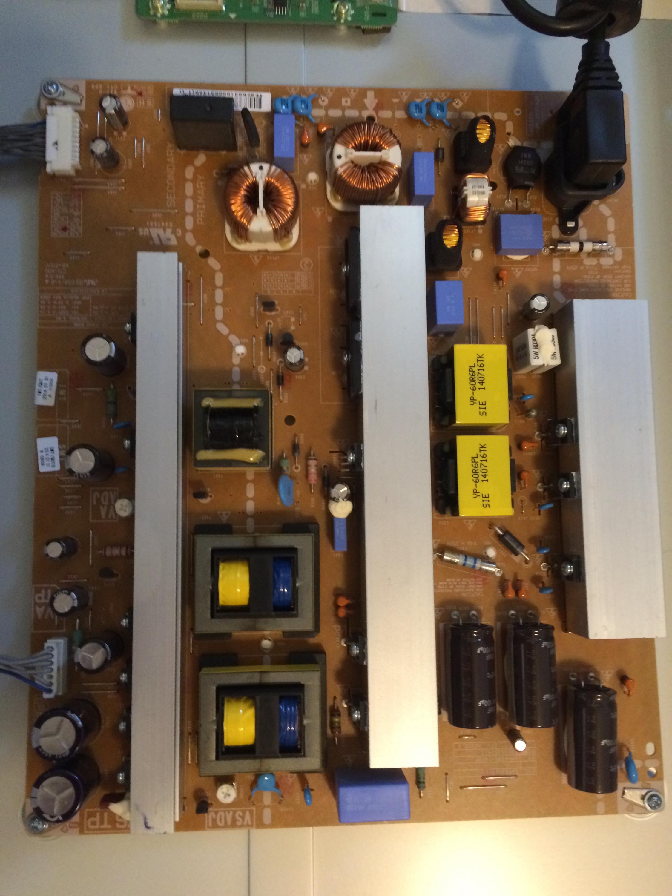

    Reading through the forums, I have so far done the following.
    - Confirmed both fuses on the power board are intact
    - Measured Va voltage on the power board at VA TP initially at ~380V and then drops
    - Measured Vs voltage on the power board at VS TP at 0.0V
    - Searched for replacement Y-Sus boards but everyone is sold out of this board.
    Is there a way to identify which components are bad and replace them on the board?

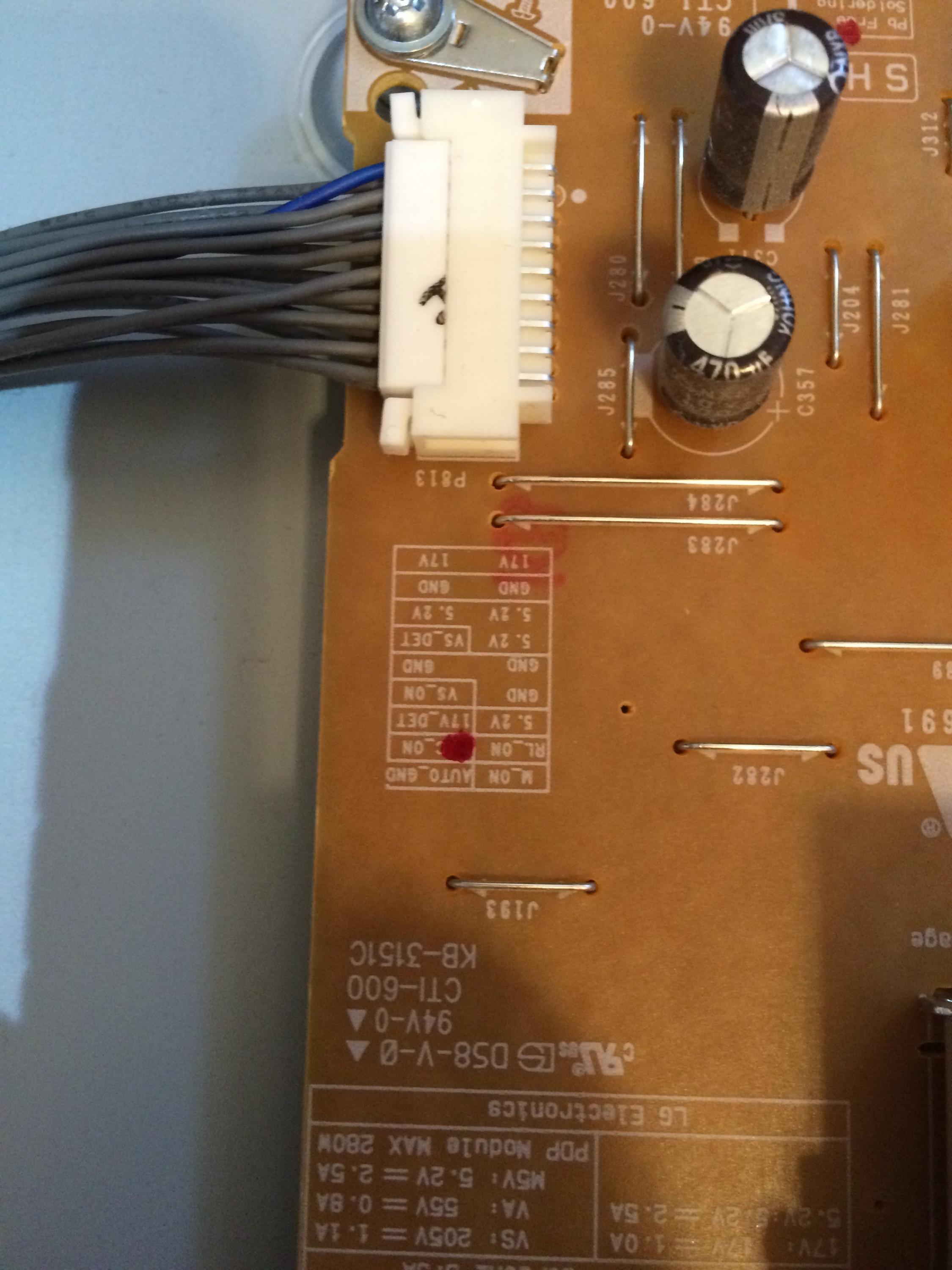

              Could you please show us where the TA test point is an how you are trying to measure with your meter. VA voltage is usually on the average of 60Vdc. 380Vdc would burn up every board in the set!
              • mtb604
                • Jun 2016
                • 39
                Re: LG 60PB5600 - No picture
                Sorry- 380 mv and then drops to 0.1 mv
                I'm measuring it at the TA TP just above the connector on the lower left of the picture

                  Have you checked the fuses on the power supply board. You have 17V, 5.2V, 17V_Det.
                  What voltage do you have for RL_ON, M_ON , VS_ON and VS_Det
                  • mtb604
                    • Jun 2016
                    • 39
                    RL_On: 3V and then a breaker clicks and it goes to 40mv
                    M_On: Same as RL_On
                    VS_On: 0V
                    VS_DET: 5.2 V

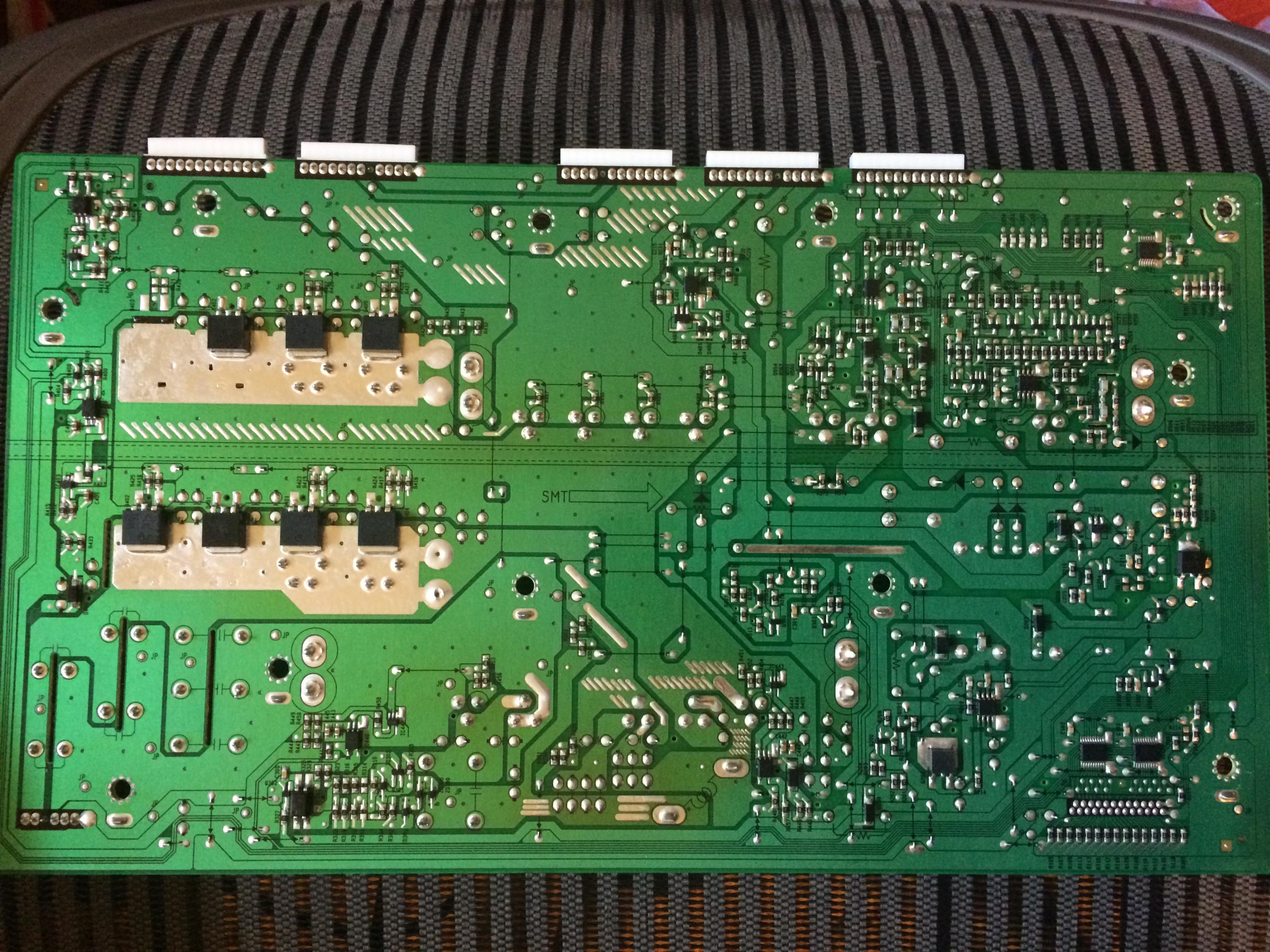

                                      Take photo of the underside of the y-sus.
                                      I've repaired this model a few times and it tends to fail the same way.
                                      • mtb604
                                        • Jun 2016
                                        • 39
                                        Here is the underside of the y-sus board
