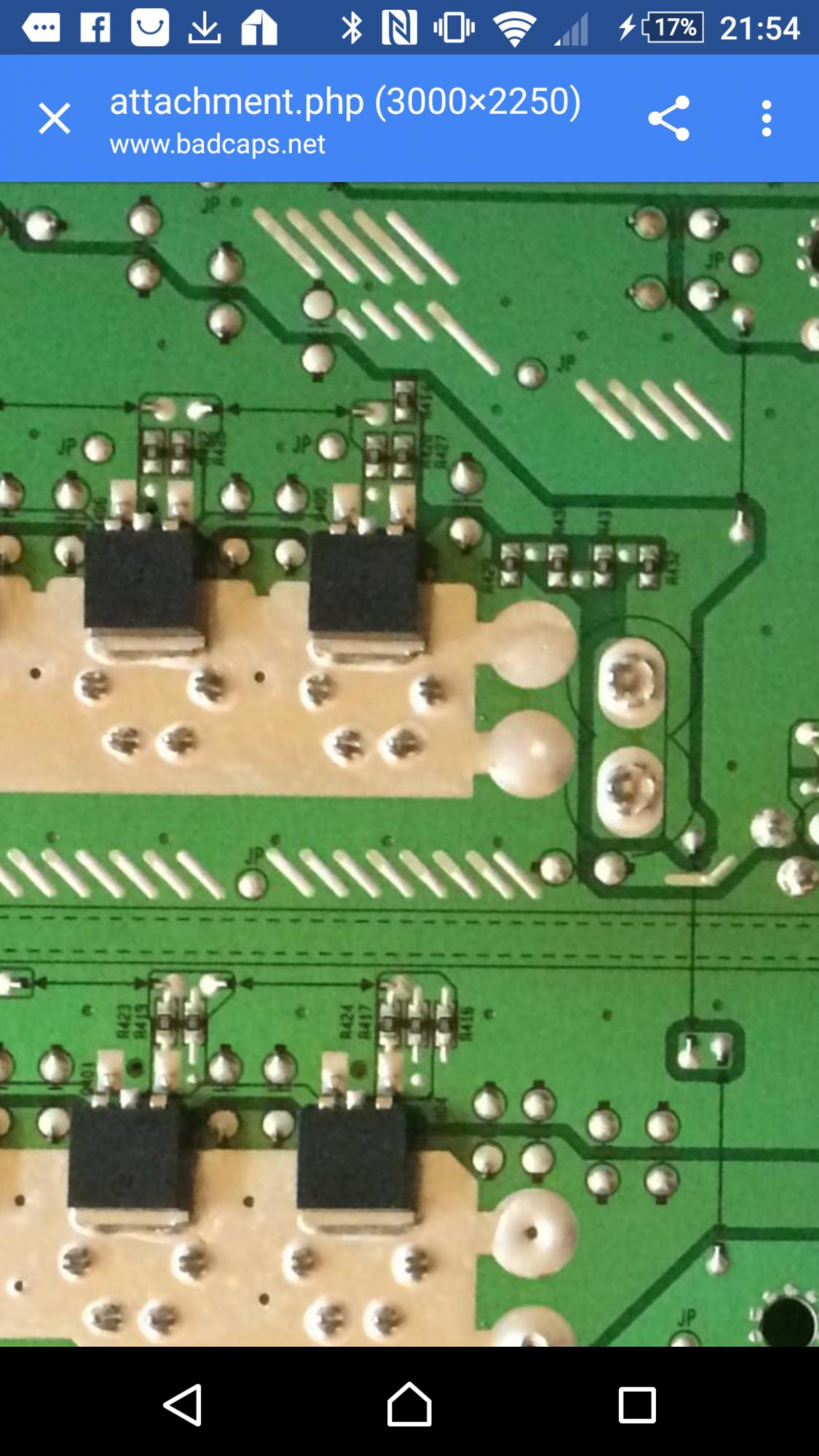

    Let me know if you need a close up of any particular component

      Check these 4 igbts and see if they are shorted.

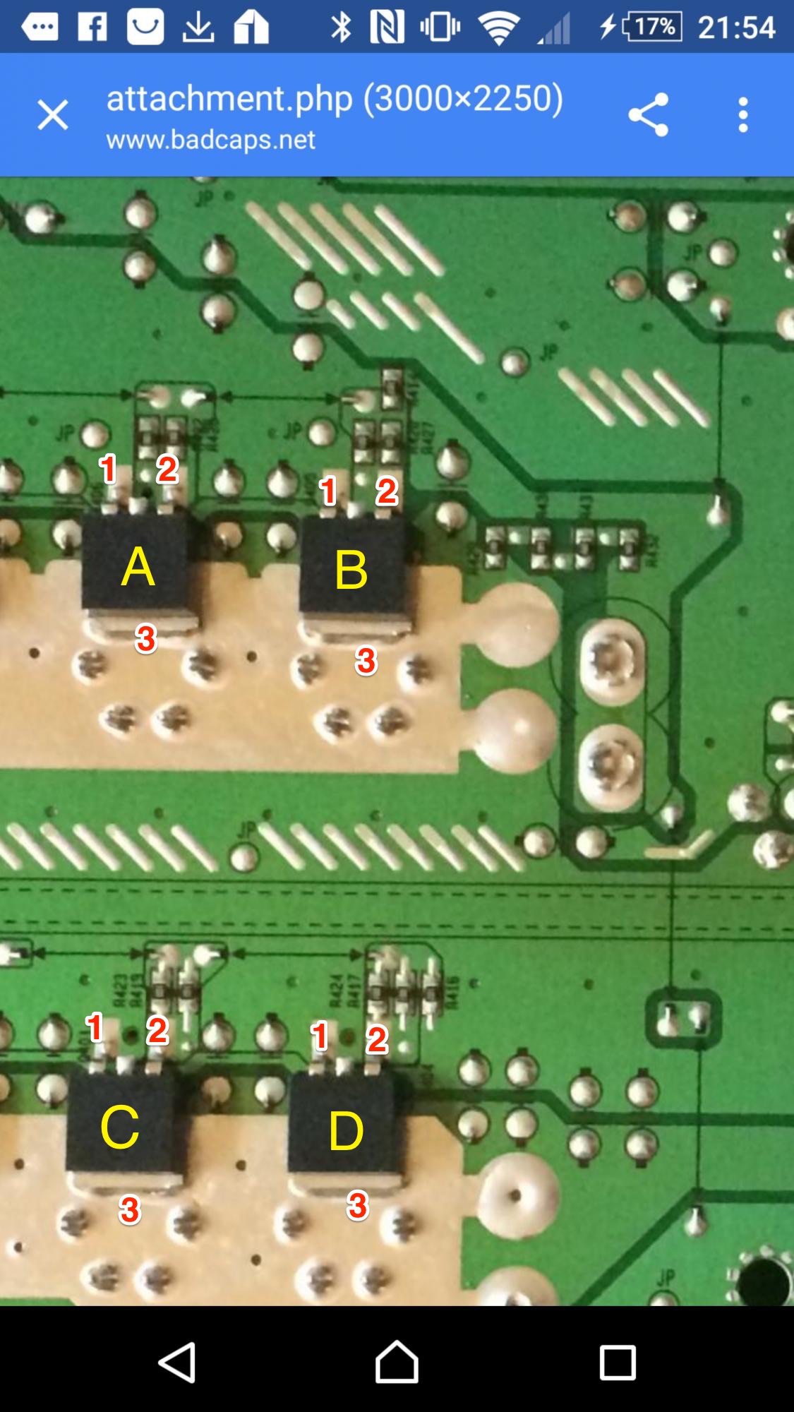

        what is the proper method for testing the igbts?
        Can they be tested while they are still on the board?
        • mtb604
          • Jun 2016
          • 39
          Re: LG 60PB5600 - No picture
          I can't find a pinout for these transistors anywhere. Which pin is which?

            You need a Dmm with diode mode to test them, also yes they can be tested while in circuit.

              You're just checking If they are shorted,
              Put your meter in diode or buzzer mode and see if they beep.

                Just test them across the two pins?

                  Using diode mode on my DMM I get the following. The first pin number is the positive probe.
                  IGBT A
                  1-2 = 0.003V
                  1-3 = 0V
                  2-1 = 0.003V
                  2-3 = 0.003V
                  3-1 = 0V
                  3-2 = 0.003V
                  IGBT B
                  1-2 = 0.005V
                  1-3 = 0V
                  2-1 = 0.005V
                  2-3 = 0.005V
                  3-1 = 0V
                  3-2 = 0.005V
                  IGBT C
                  1-2 = 0.005V
                  1-3 = 0V
                  2-1 = 0.005V
                  2-3 = 0.005V
                  3-1 = 0V
                  3-2 = 0.005V
                  IGBT D
                  1-2 = 0V
                  1-3 = 0V
                  2-1 = 0V
                  2-3 = 0V
                  3-1 = 0V
                  3-2 = 0V

                    Does this indicate I just need to replace the "D" IGBT?

                      Or are all of them bad?

                        They are shorted yes remove and retest see if the short goes.

                            Yes use hot air or a soldering iron.

                              Out of curiosity - what indicates that they are shorted? I could never find a pinout for them.

                                0v drop means dead short across probes.

                                  Across which pins?

                                    You said them all from your reading ?

                                      Okay. I will remove them and test them off-board. Thanks to all for your help- IGBTs are very confusing to me.

                                          After removal, all four of those IGBTs still appear to be shorted. Is it common for all of them to go at the same time?
                                          Also- are there any other components I should check while I have the board out?
