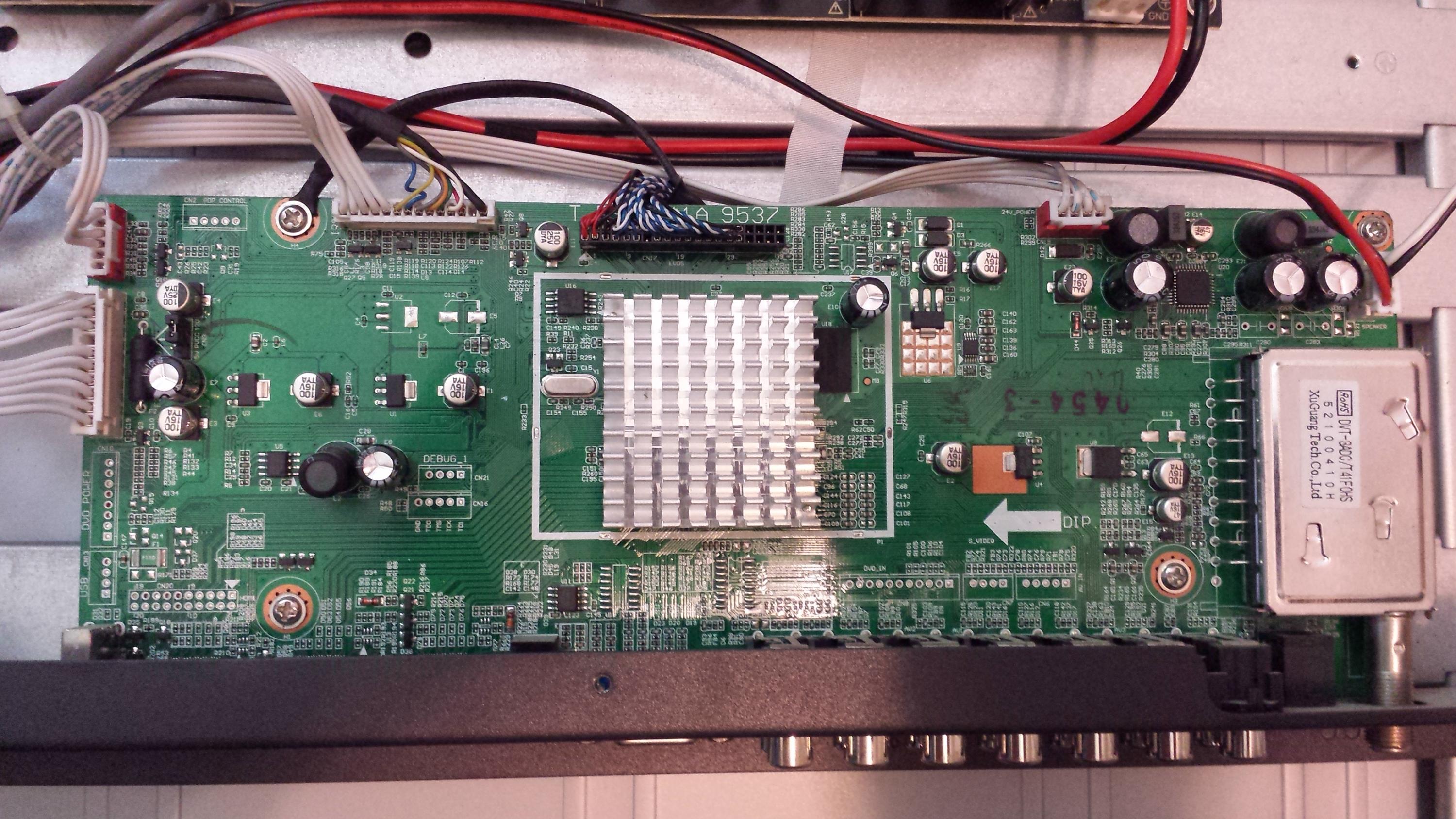

    Shopjimmy sells EEPROM so that may be the problem. Did you try cooling the EEPROM using canned air duster upside down to get the coolant out for cooling?
    http://www.shopjimmy.com/catalogsear...q=RCA+40LA45RQ
    BTW, pictures of the whole back side of the TV to show all the boards will help.

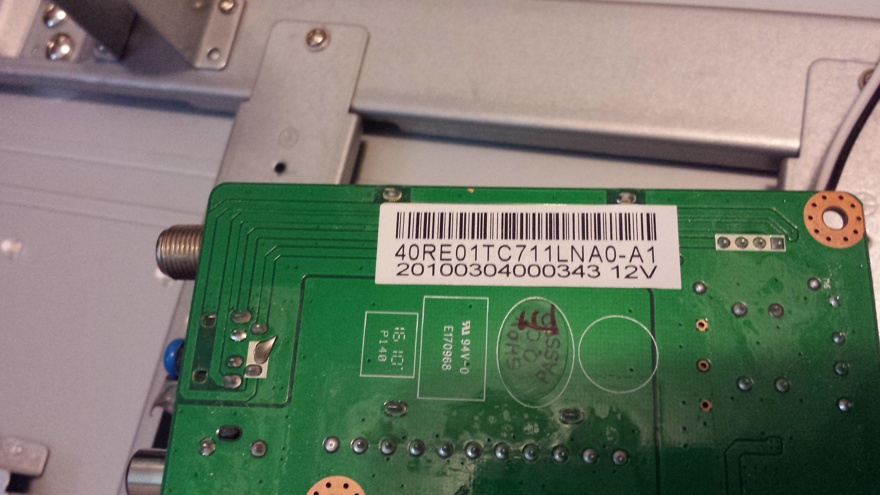

      there are many main boards for that TV. You need to check what mainboard you got and select the correct EEPROM IC. As budm said, SJ has them.

          40RE01TC711LNA0-A1, found several boards and the EEPROM, not confident in my soldering skills so trolling fleabay for the lowest price, thanks guys.

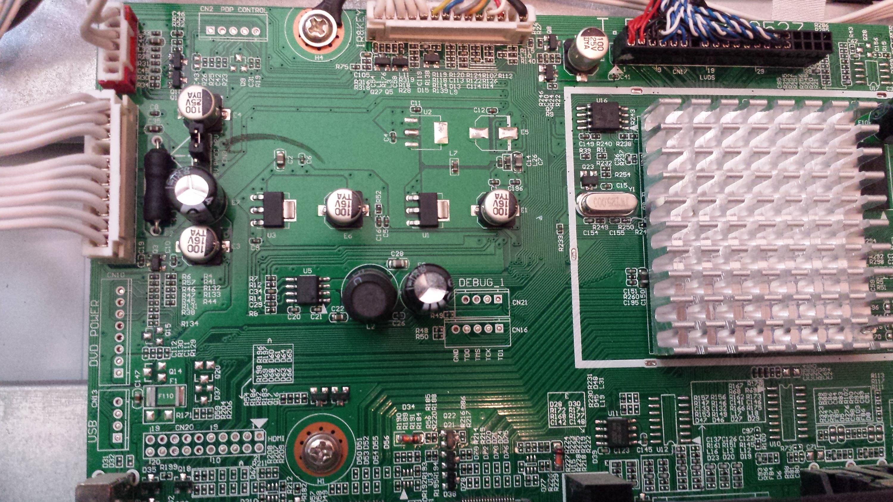

              Absolutely, here are the photos I did take today
