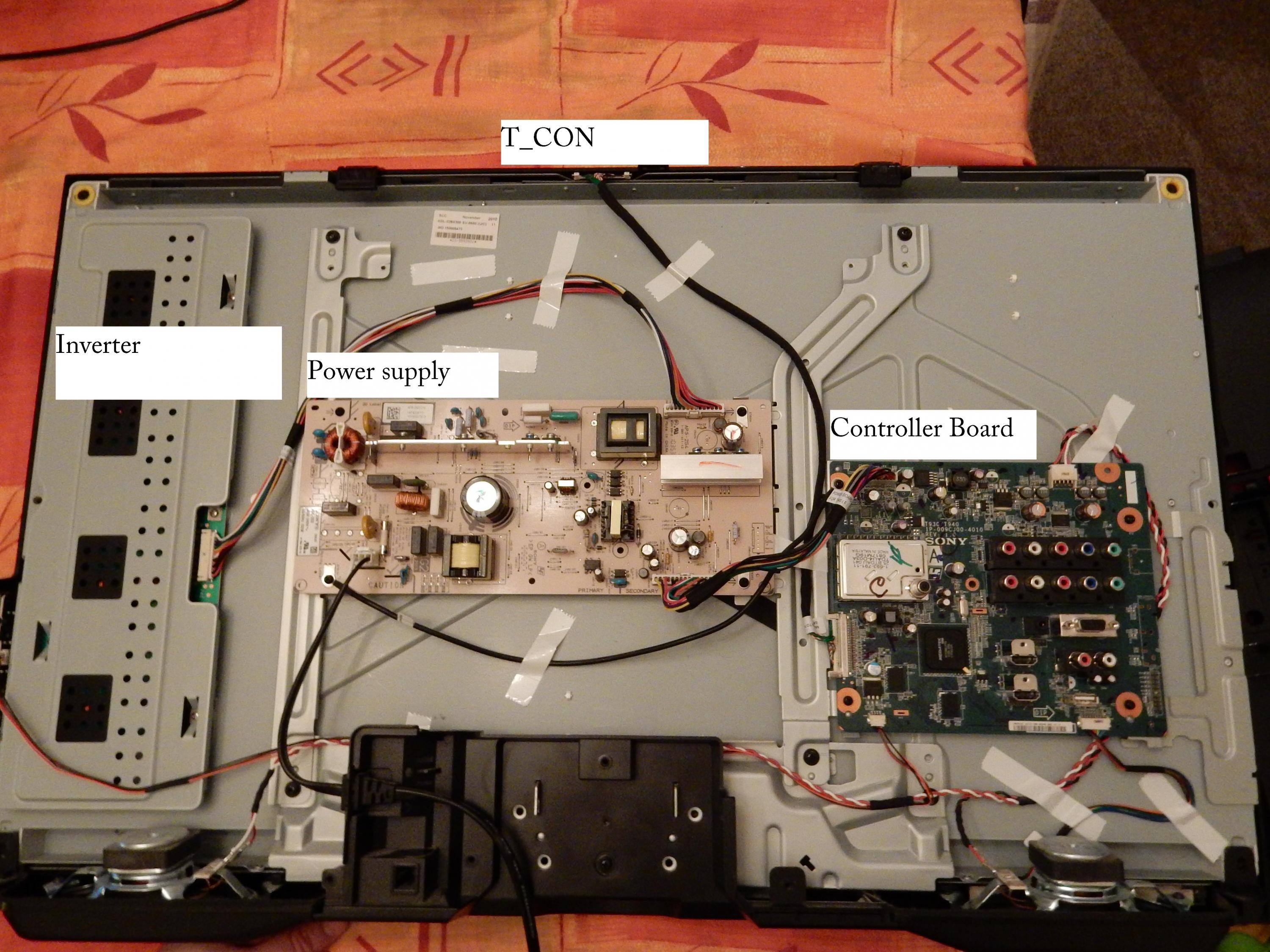

                    Guys, I will post picture, hopefully this night. Now, since my last tests, the TV set will not start up. The POWER_ON stay off.
                    I guess the controller board is dead. Also, the processor get hotter than normal, probably there is a short somewhere that kills it.

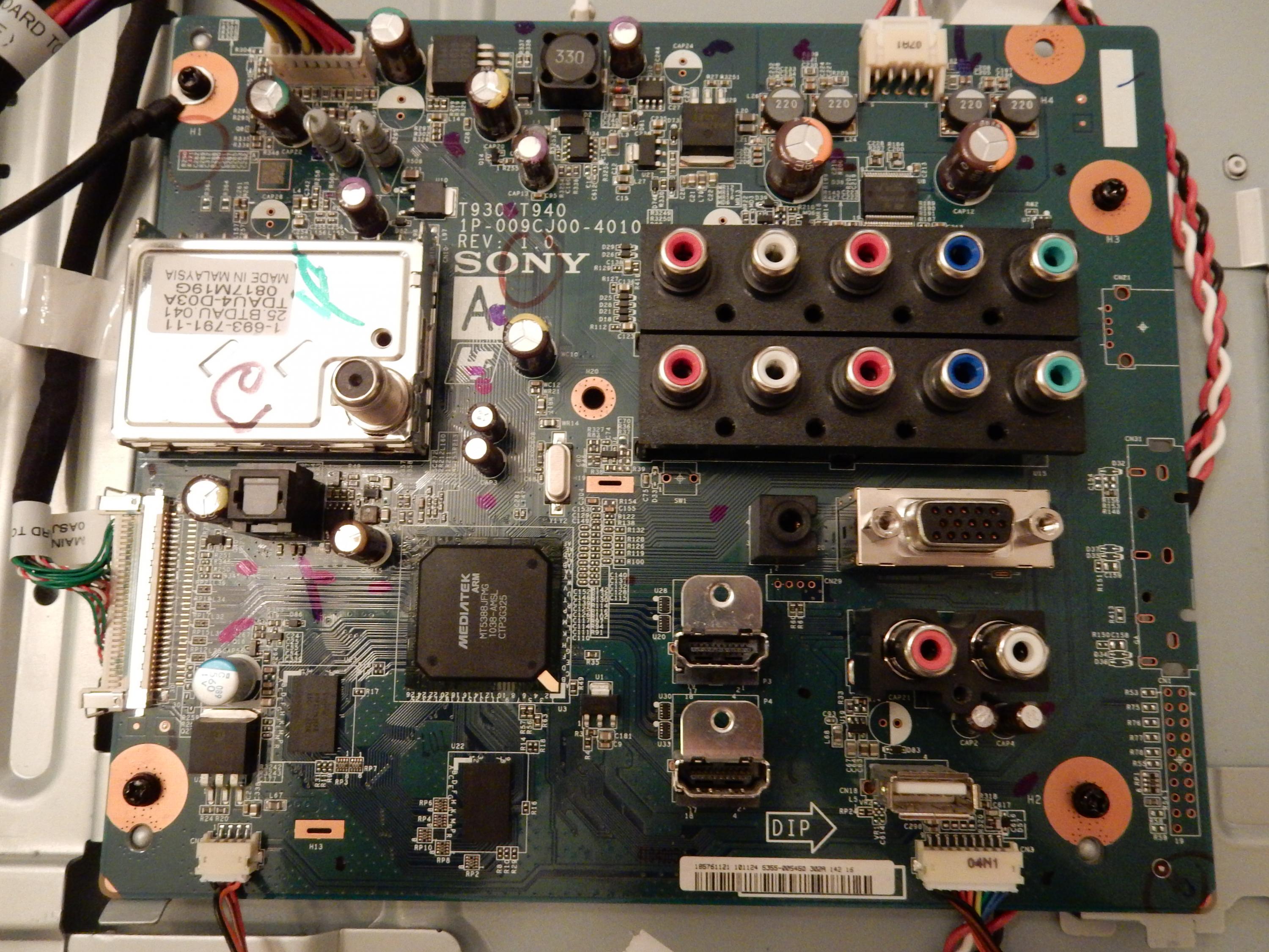

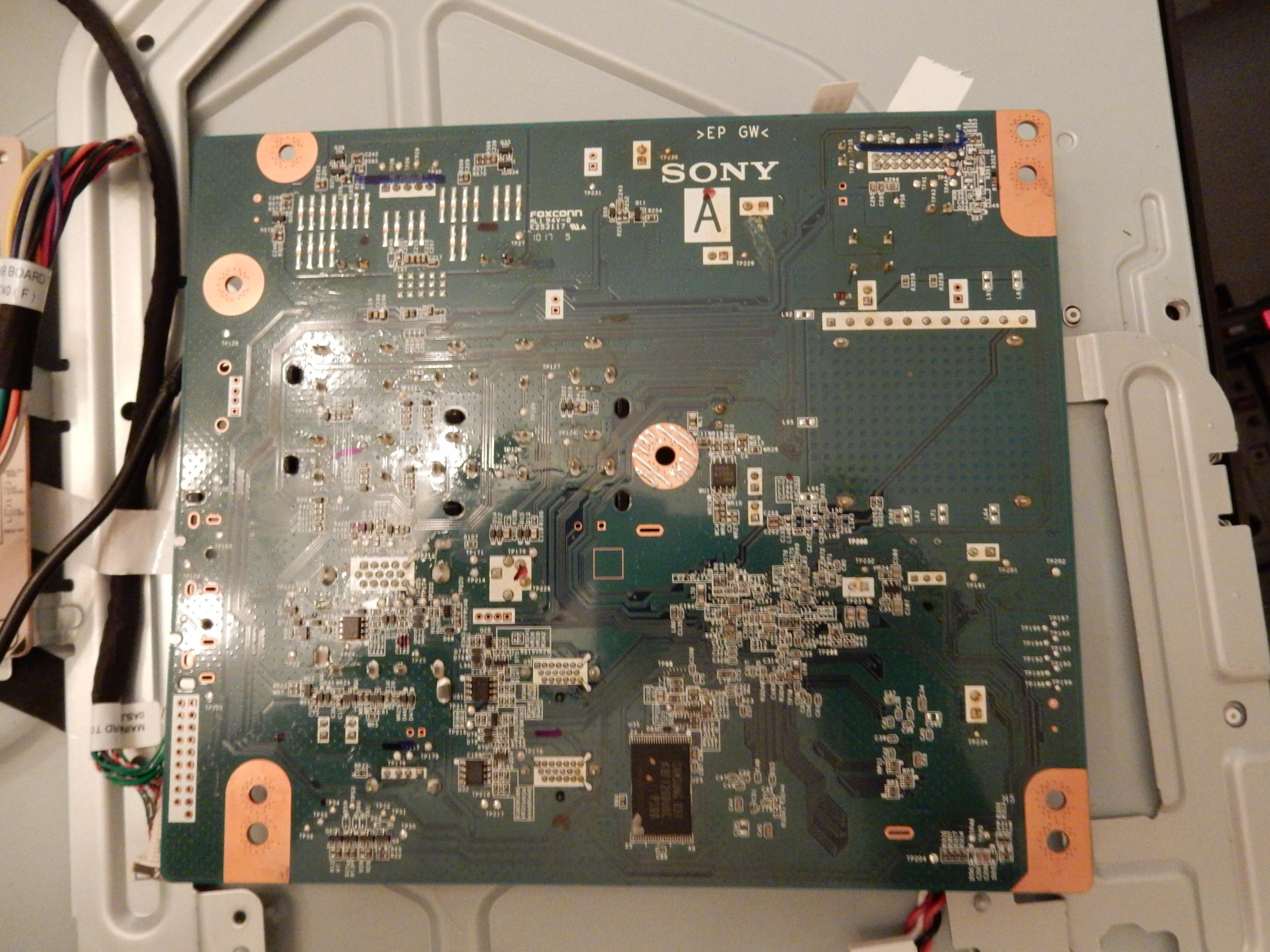

                      Re: sony kdl-32bx300 in undefined state
                      Guys,
                      Attached to this post you can see the picture of the TV.
                      I added picture of the controller board.
                      I can see something strange on the pcb. There is white paint on few components near the power supply output cable (solder side). Anyone knows why they do that ?
                      Thank you
                        I would test the power supply inverter by removing the cable between the power supply and the main board, then use 1K resistor between 3.3VSBY pin and the Power on pin, resistor between 3.3V and the BL-ON pin to see if the backlights will come on, if not, you may also need the resistor between 3.3V and the Dim pin.
                        You should also make sure you do have boosted Voltage close to 400VDC between the two legs of the main filter cap in the Hot side.

                              To recap my problem / findings :
                              1. The power supply is good
                              2. The inverter is OK
                              3. The T-CON is probably working. The same bahavior occur if the T-CON connector is connected or not. Also, there is no sound coming from the TV.
                              4. The TV is always powered on (or not)
                              5. The TV will react to absolutely no user input (key / remote control)
                              6. I have shorted out to GND the line SDA of the main EEPROM, so we can be sure the problem is not from a corrupted eeprom.
                              So, we can be sure the problem is the control board ("A" Board).
                              The model number of the control board is 185761121 REV 1.0 which is not easily available or the price is too much. More than 100$ USD is too much to save a 300$ CDN TV.
                              But, I would like to "refurbish" the controller board.
                              My plan :
                              1st : I will look for bad diode that could short the processor signal lines
                              2nd : I will monitor the i2c bus to see if there is activity
                              3rd : I will monitor Flash to see if there is activity
                              What are you thinking about this plan ? should I look at other component first ? It is my first time trying to debug a TV controller card.
                              Thank you a lot for your help !
