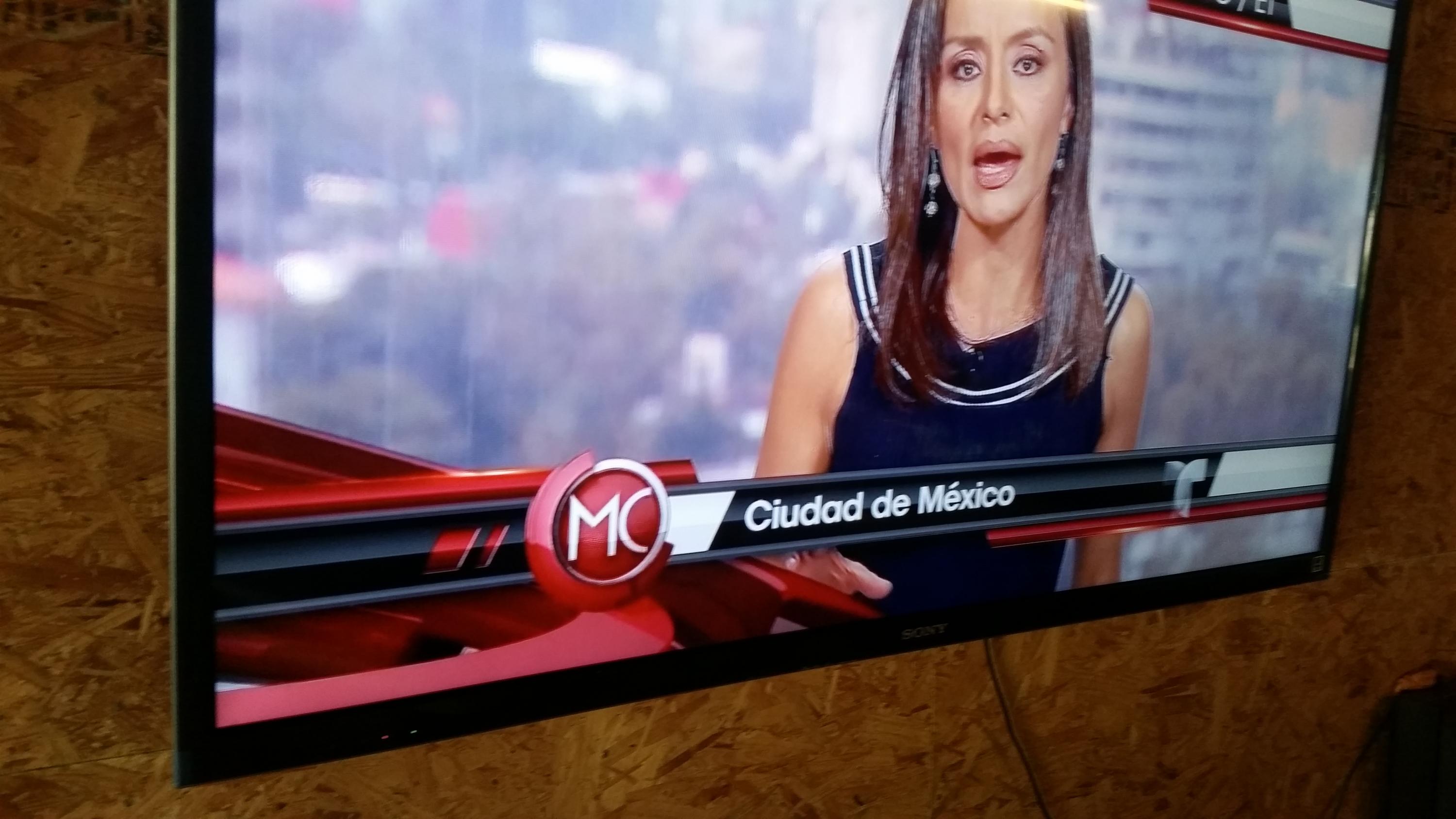

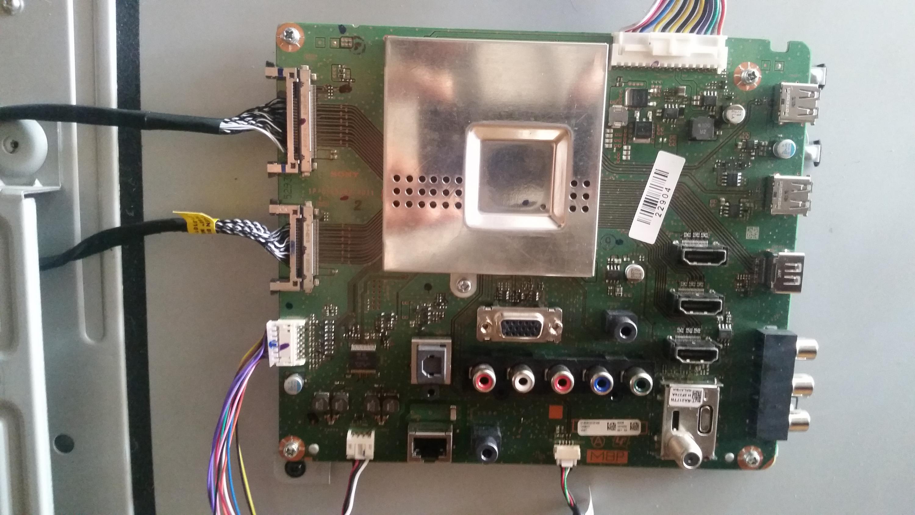

    I have KDL60EX645 THE ORIGINAL MAINBOARD WAS DAMAGE AND SAW THIS KDL-50EX645 MAIN FOR CHEAP AND IT REVEAL THAT IT'S COMPATIBLE WITH THE ORIGINAL ONE. IT STATED IT NEEDS UPGRADE...I ALREADY DID TRY TO UPDATE BUT IT'S THE SAME UPDATE I DOWN LOADED FROM SONY SUPPORT AND THERE'S NO OTHER UPDATE...what can I do...do I get to service mode ?????and yes I got picture with the kdl50ex645 but its not on normal view it's like pixel..

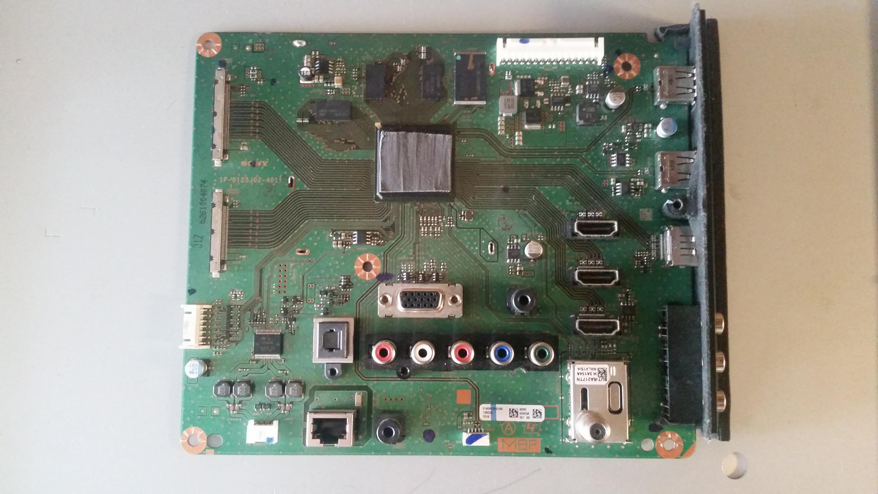

    Swap the eeproms..

      Re: kdl-60ex645 mainboard change to KDl-50ex645 update problem
      But in this sets were the eeprom is located
        Post pictures of the board.
            This is the original board...took the metal off to see were is the eeprom...

              yours original are 60 and the new are 50 just go inside service menu and change panel size, panel serial no, . as well the Model name... you will be fine.
                Yes from 60ex645 to 50ex645....how do I get to service mode....do I need original remote....
                    Well it worked with the display, 5, volume up and power on. I just went down on the menu and change from 50 to 60.....and I notice the change it now have nice picture..is it normal the red and green ligth are on at the same time while the tv is running normal....

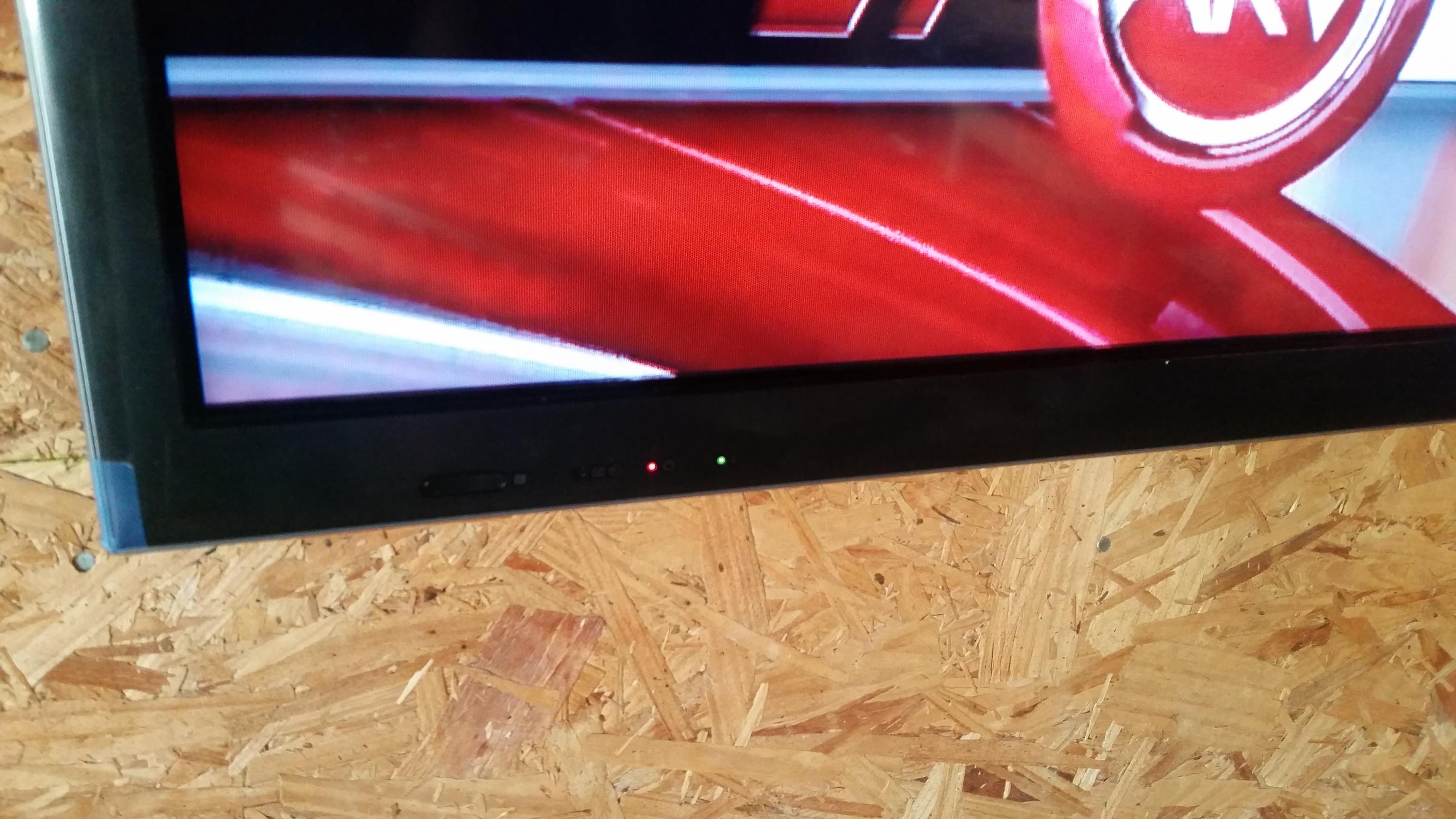

                        good, if you change channel with remote control, which led blinking with the command ?

                            on his photo the stand by LED ON. the timer one / sleep on the left side.
                            it may one caused this that his 50 MB need to write the register of the PSU. as 50 one different .
                            by display, 5, volume down and power on. he can log at self diagnose to read the register ..
                            or he did change one data Value at time he rolling down to change size.
                              When I command the tv the green ligth blinks once every time I press any command.....so what do i do
