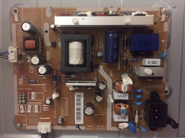

    Problem: No backlight, but flashlight test shows picture.
    Same power supply board (BN44-00667A) and CNL802A connector as in this thread (https://www.badcaps.net/forum/showthread.php?t=50896).

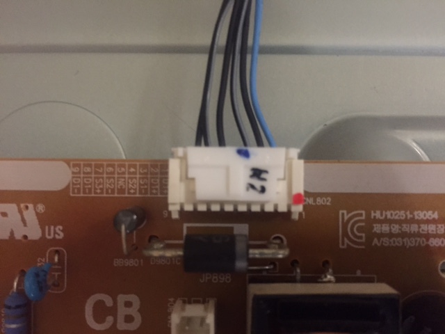

    CNL802A has pins labelled as follows
    D1+ D1+ S1- S2+ N.C. S2- S3+ D1- D1-
    Measured + 226 VDC between D1+ and chassis ground both with and without the plug to the LED strings connected.
    Based on my web searches I believe that a problem with the LEDs is likely, but I would appreciate confirmation from someone in this group.
    I would also like to understand how the LED strips are organized. I know from above-mentioned thread that the backlight consists of 4 strips of 11 LEDs each (6 left and 5 right side per strip), but I am having difficulty figuring out how the LED strips are wired to the CNL802A plug. Are all 4 strips in series? Does pin 1 (D1+) go to the anode of strip 1 (referring to the 4 horizontal strips as 1 to 4 from top to bottom), then to S1- and so on as follows

    I have attached a photo of the power supply board (BN44-00667A) as well as a close-up of the CNL802A connector on that board.
    Does anyone know of a place where I can get a schematic for this power supply board? I am quite good at finding schematics, but this one seems to be very elusive. Any help would be greatly appreciated. I know I do not need this level of detail to troubleshoot, but I would rally like to understand how the board works and what it does when it does not work!

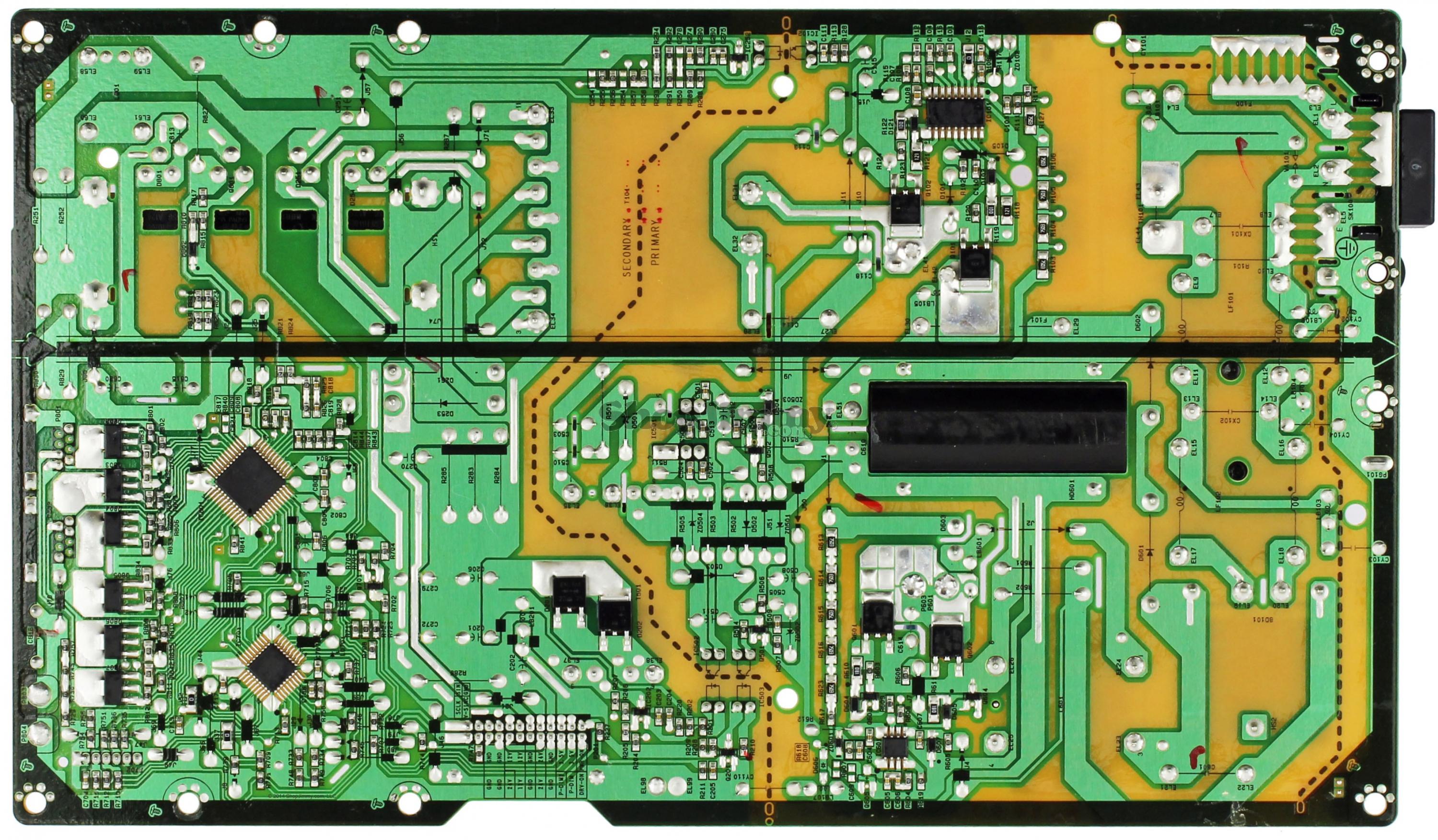

    You have open circuit in the LED string, when it is working, the Voltage should be less than 200V, see the chart printed on the board for the LED voltage when it is load.
    Look at the bottom side of the board to see how the LED connector pins are conencted to each other.

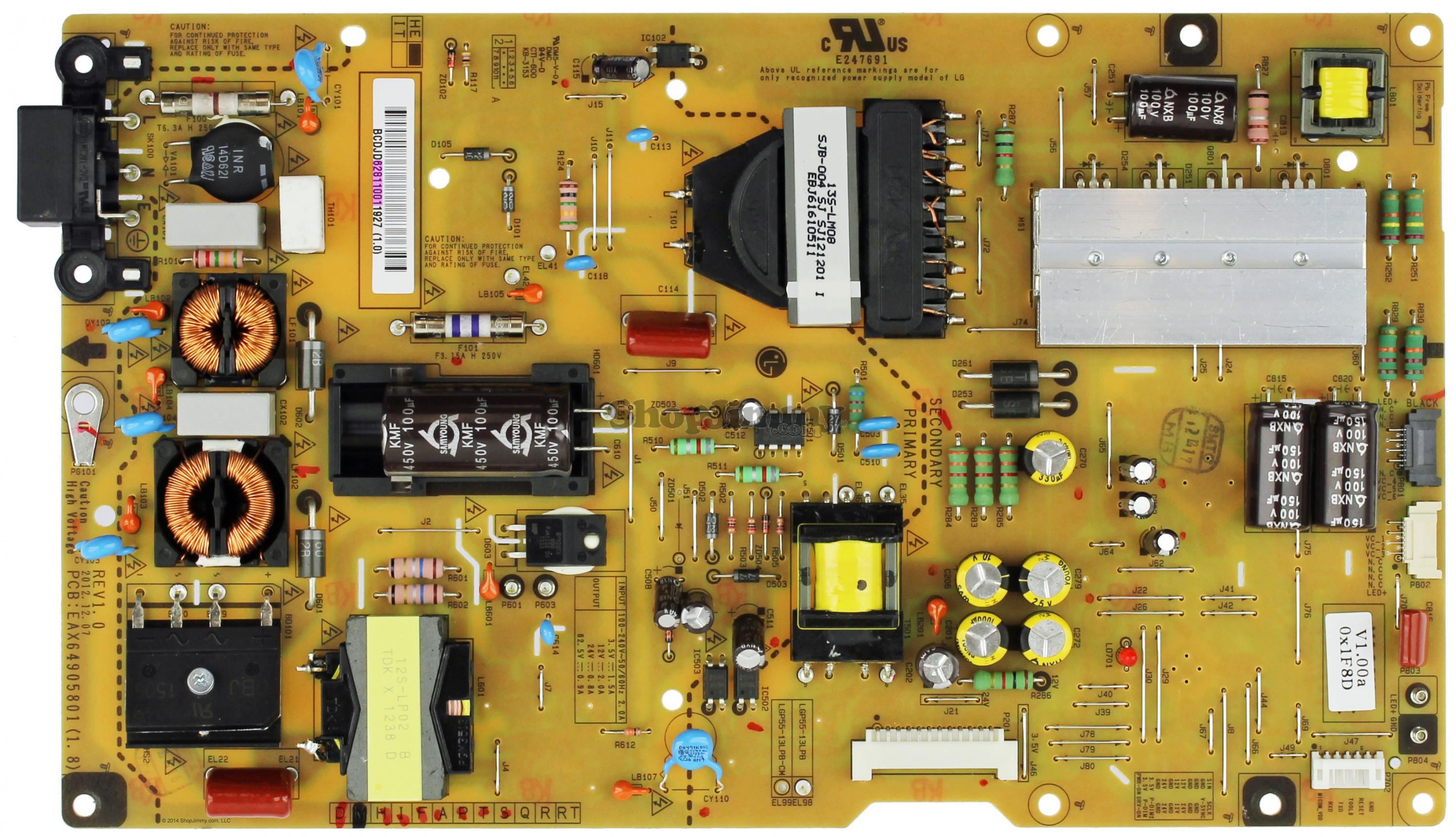

    http://www.shopjimmy.com/samsung-bn4...led-board.htm#
    Pictures provided by shopjimmy.

      I did look at the trace side of the connector and saw that the following were connected:
      Pin 1 &2 (D1+)
      Pin 3&4 (S1- & S+)
      Pin 6&7 (S3+ & S2-)
      pins 8&9 (D1-)
      So I see all strips are in series.
