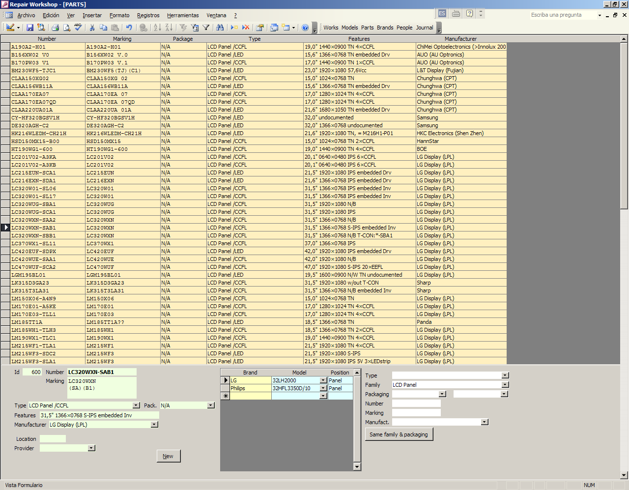

                        But this is no way a practical approach of keeping this information. You can't just add posts saying "this TV model has same panel than that other TV model". You have to keep a list of TV Brand - TV Model - Panel mfg / model. Could be an excel spreadsheet or ideally a database (as I'm doing it locally in MS Access).
                        I attach a Sony spreadsheet with TV key parts, including LCD panels. This was provided by Sony in year 2014. And a screenshot of my database, filtered by LCD panels. Here you can see that this way I can know that LC320WXN-SAB1 is installed on a Philips and a LG tv. Keeping this database is time consuming.
