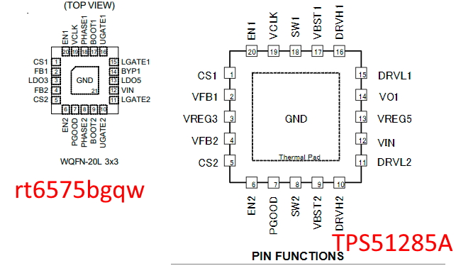

    I try to substitute the RT6575B with TPS51285A,
    it seems to work but it is slightly warmer, the board does not start due to other problems so but not sure if replacement is possible

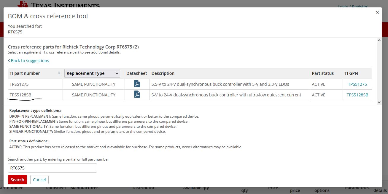

    The TI cross reference website recommends the TPS51285 , (+ TPS51275) ,you still havwe to check the datasheet though for each parts LDO function https://bomcross.ti.com/en/search?searchTerm=RT6575

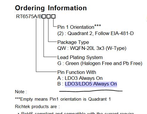

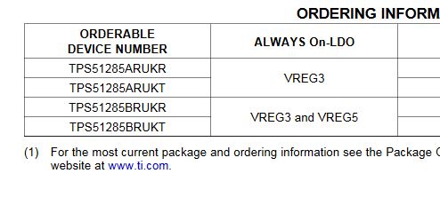

    TPS51285A VREG3 ,TPS51285B VREG3 and VREG5 always on
    The RT6575B has VREG3 and VREG5 always on,so the correct substitute part is the TPS51285B not A
