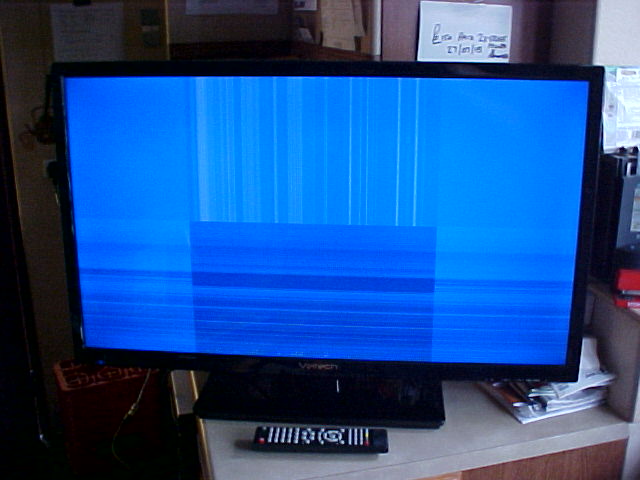

    Seiki SE32HY02UK 50% of picture missing

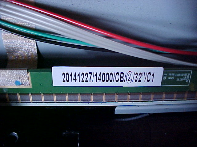

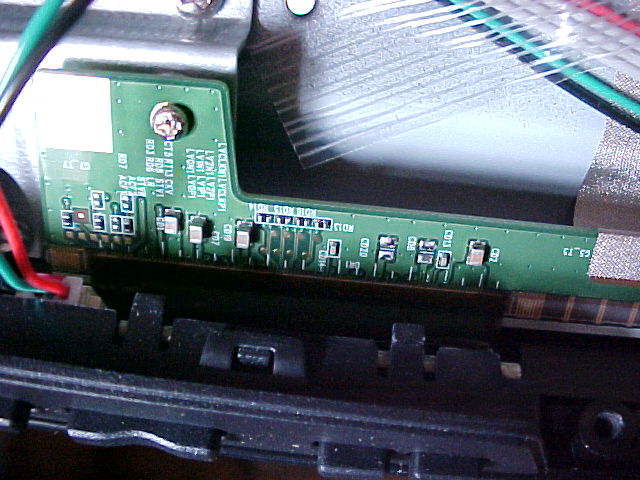

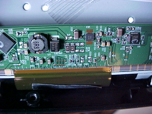

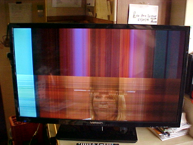

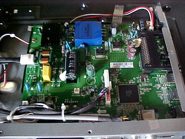

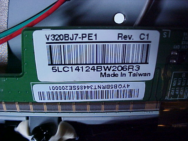

    this is a Seiki 32" LED TV with built in DVD.
    I ended up with this fault on powerup.
    50% of the picture is missing and the top half of the picture is at the bottom half of the screen.I suspect the TCON board but welcome input on this.Cheers

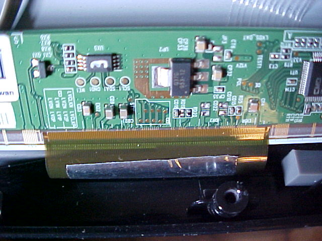

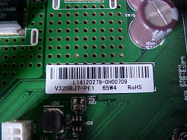

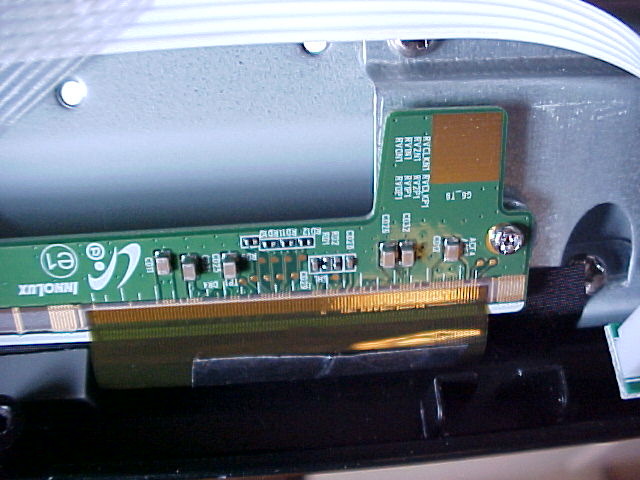

    I attach some photos to show the fault and the boards of which there are only 2,the Main board and Tcon.

    Re: Seiki SE32HY02UK 50% of picture missing
    As the TCON board is bonded to the LCD screen, I will recycle the set as spares for my other 32" SEIKI,its an identical chassis.
    • ReeceyBurger123
      Never Give Up !
      • May 2014
      • 7325
      • Britain
      Lcd panel failure here sorry mate, scrap the horrible thing
