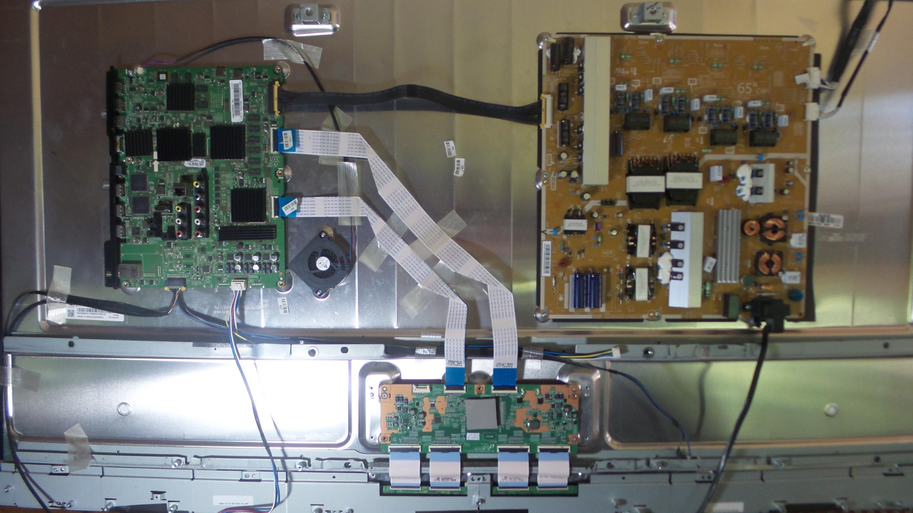

    I got this Samsung 65 inch curved tv which someone else had tried to fix.

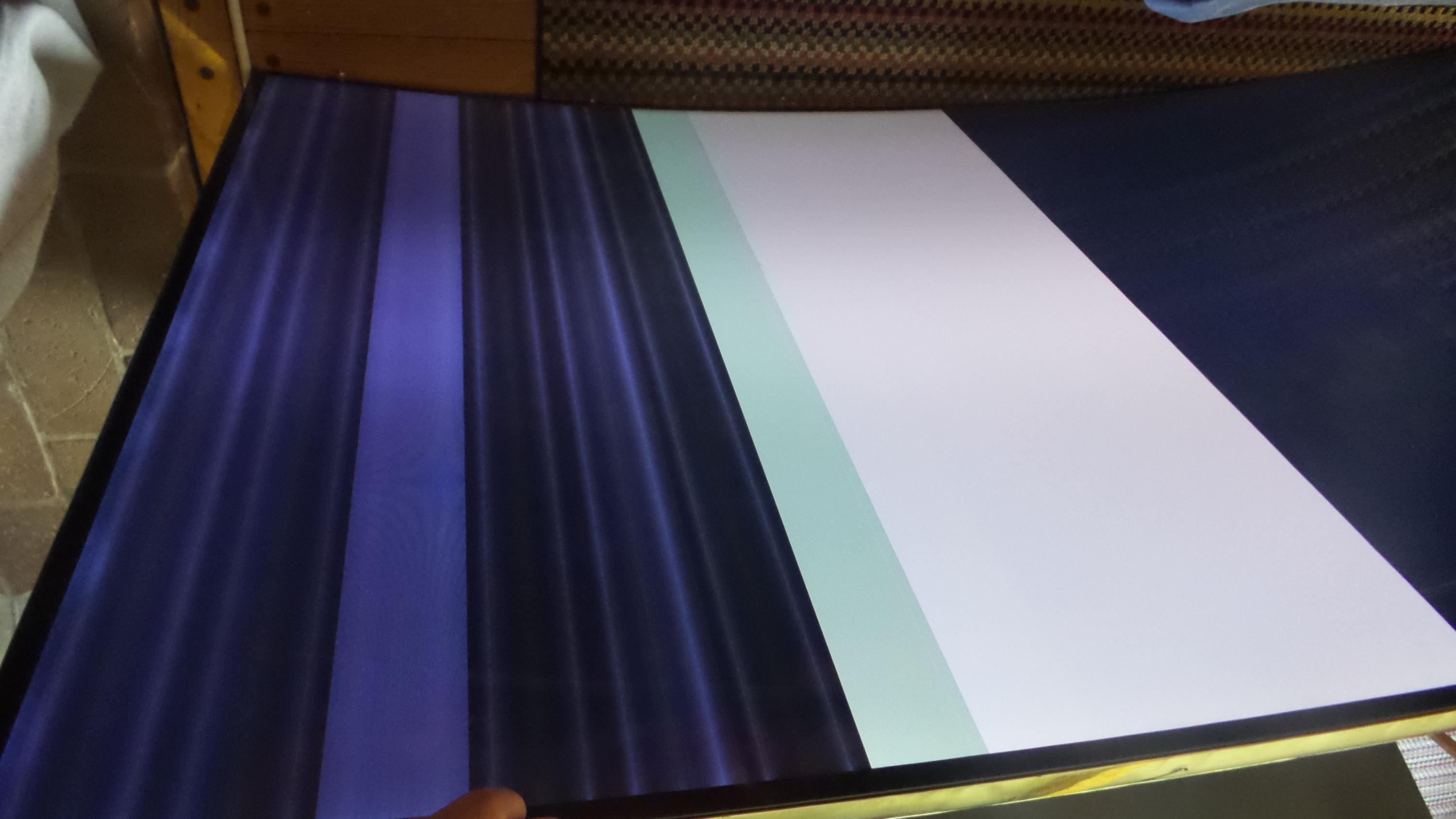

    Black and white lines fade in when power is applied to the tv. They fade out pretty quick and the backlight shuts off. Think its the intro logo for the tv being distorted. Then the backlight turns back on with no image. Also noticed when i remove power from thd tv, the red led flashes on and off for a 10-20 seconds which does not seem normal.

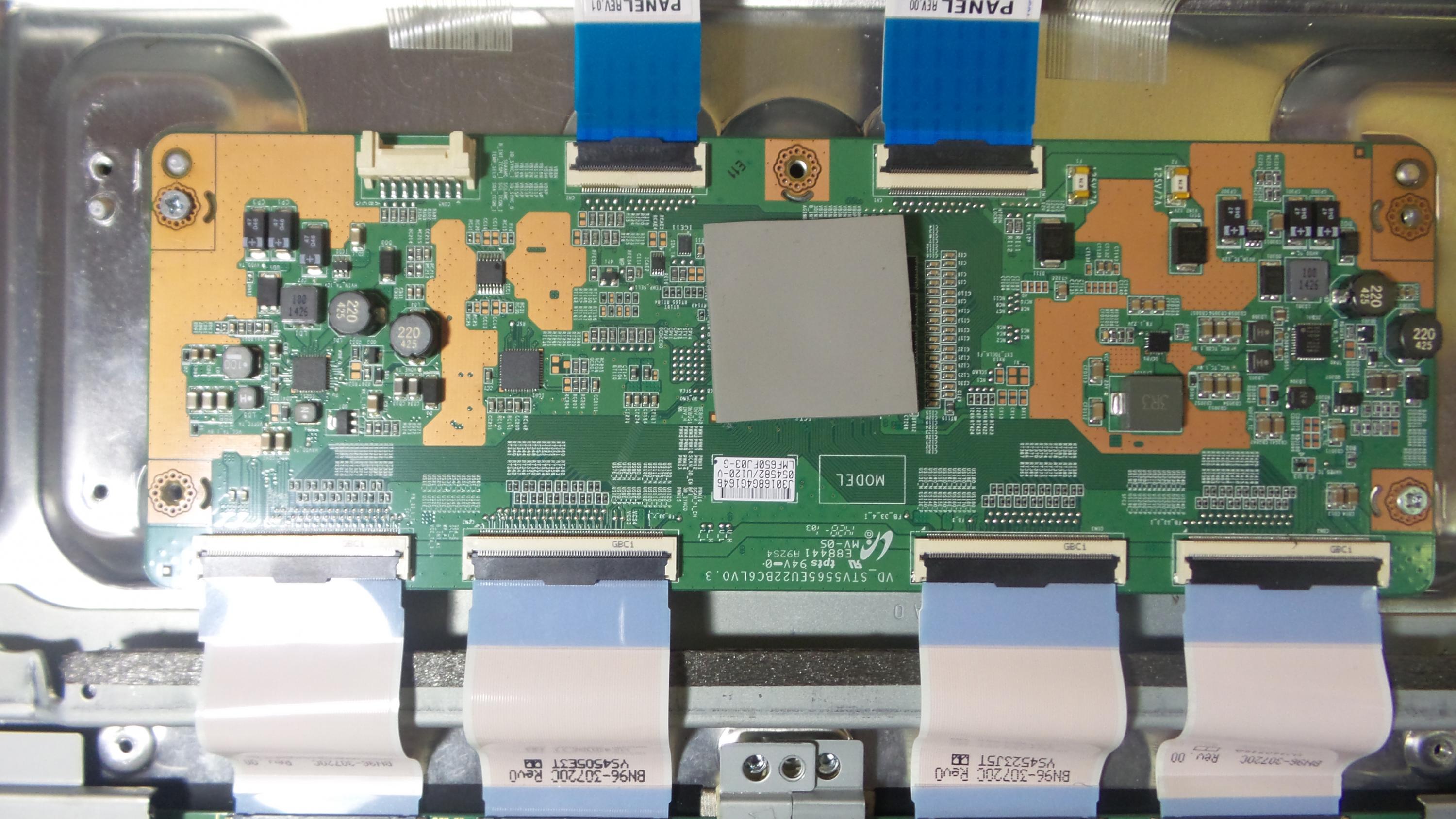

    The first thing I noticed after opening it is that tcon fuse F1 was missing. Not sure if it was blown off or someome removed it. I replaced with a good tcon board and still having the problem. I have reseated all of the buffer board and tcon flst ribbon cables as well.
    Anyone have any suggestions on what i can do next to properly troubleshoot this tv?

    Panel failure IMO not fixable.
