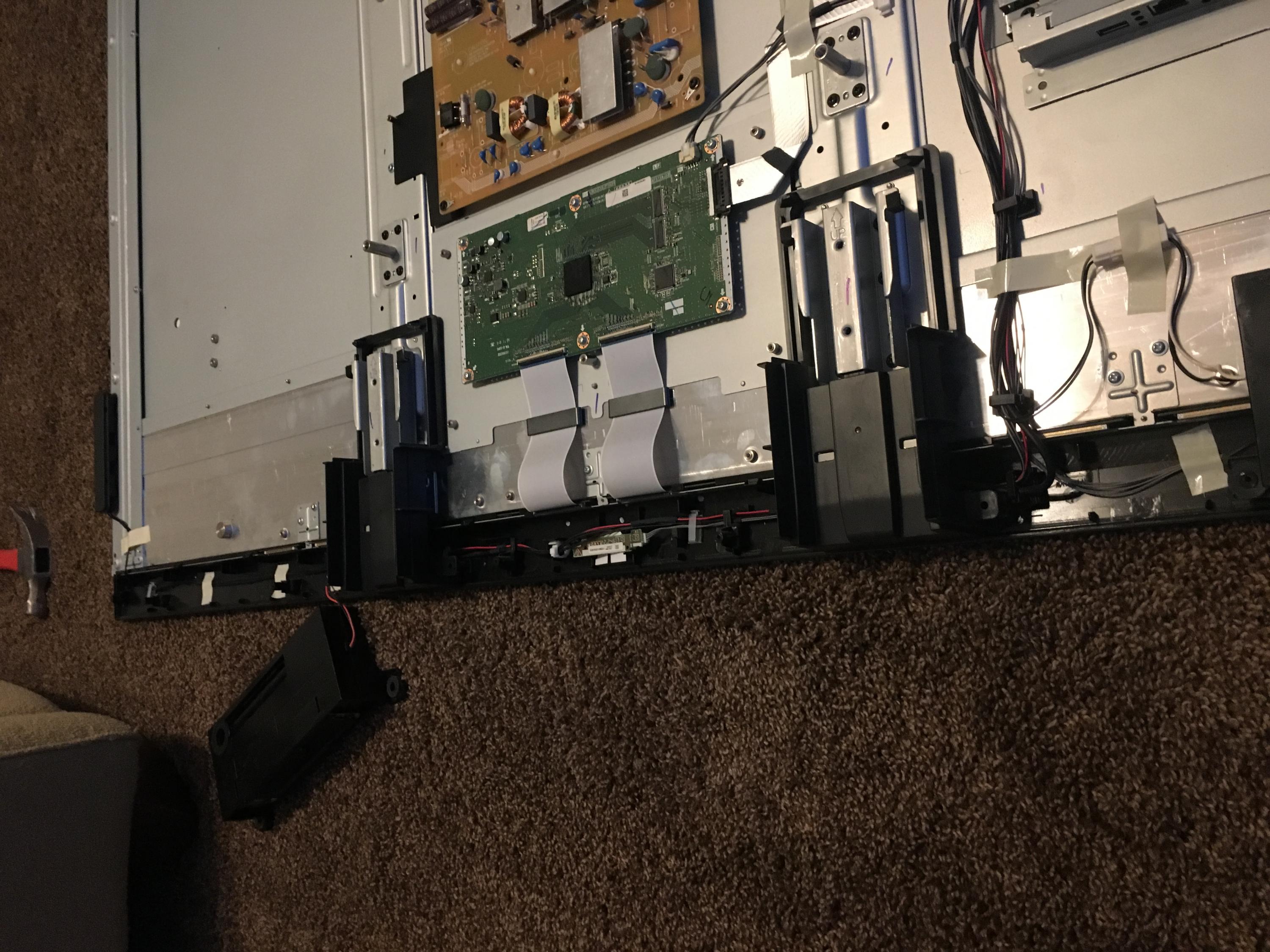

                    I am a new guy here. I have a Sharp Aqous LC-70c7500u with the horizontal line and flickering. It looks like if I remove the tab drivers it might fix my problem.
                    Looking for an easy fix. I am not a TV repair guy
                    Do I cut the ribbons or just pull them off?
                    Thanks in advance for any help you guys can provide
                    I attached a photo .... cut or pull here?

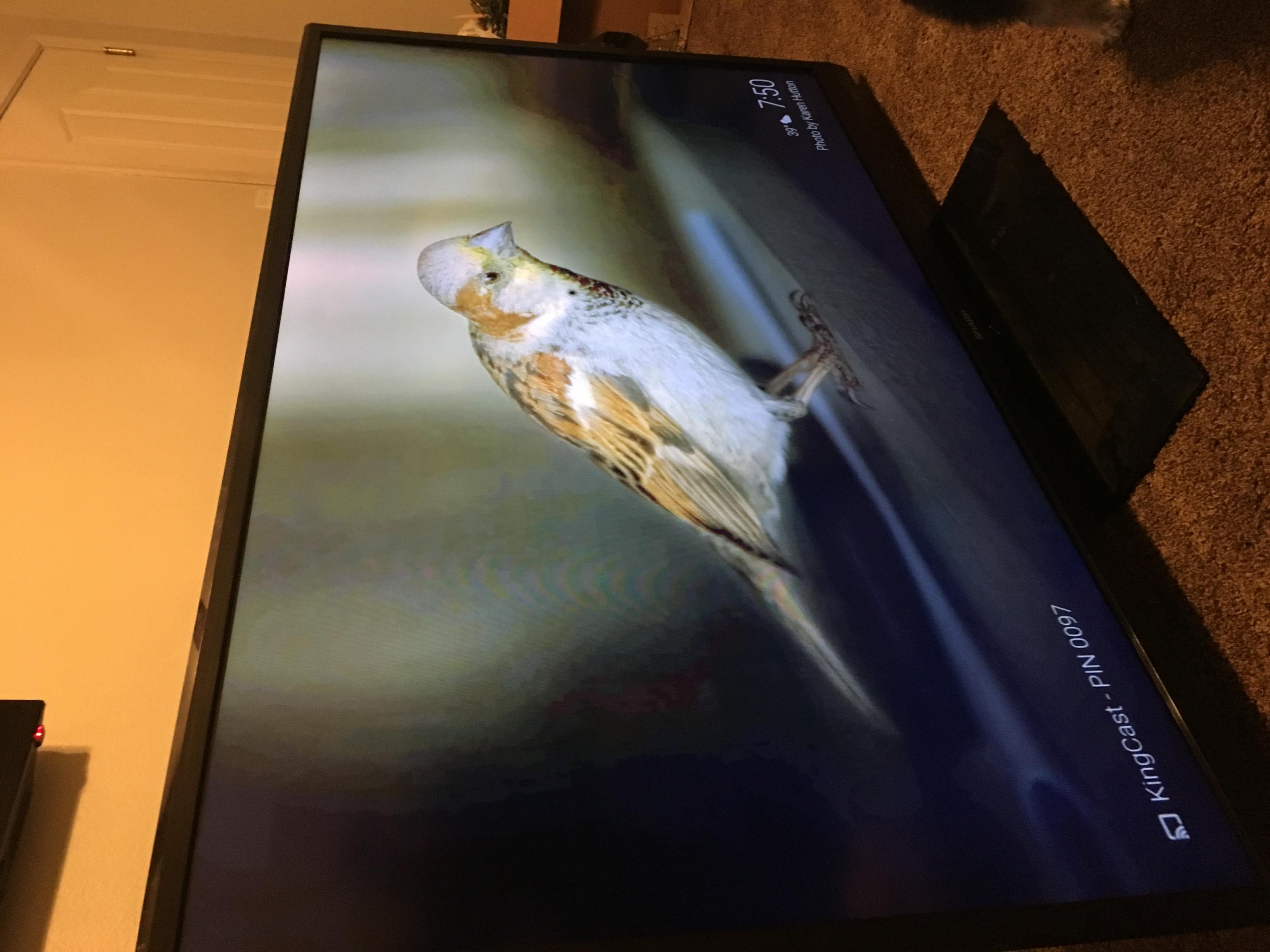

                      Just wanted to let you know that my Sharp LC-70UQ17U was having the flickering. With the help of this thread I was able to fix it! I'm hoping it will last a few more years. Thanks to all that posted.

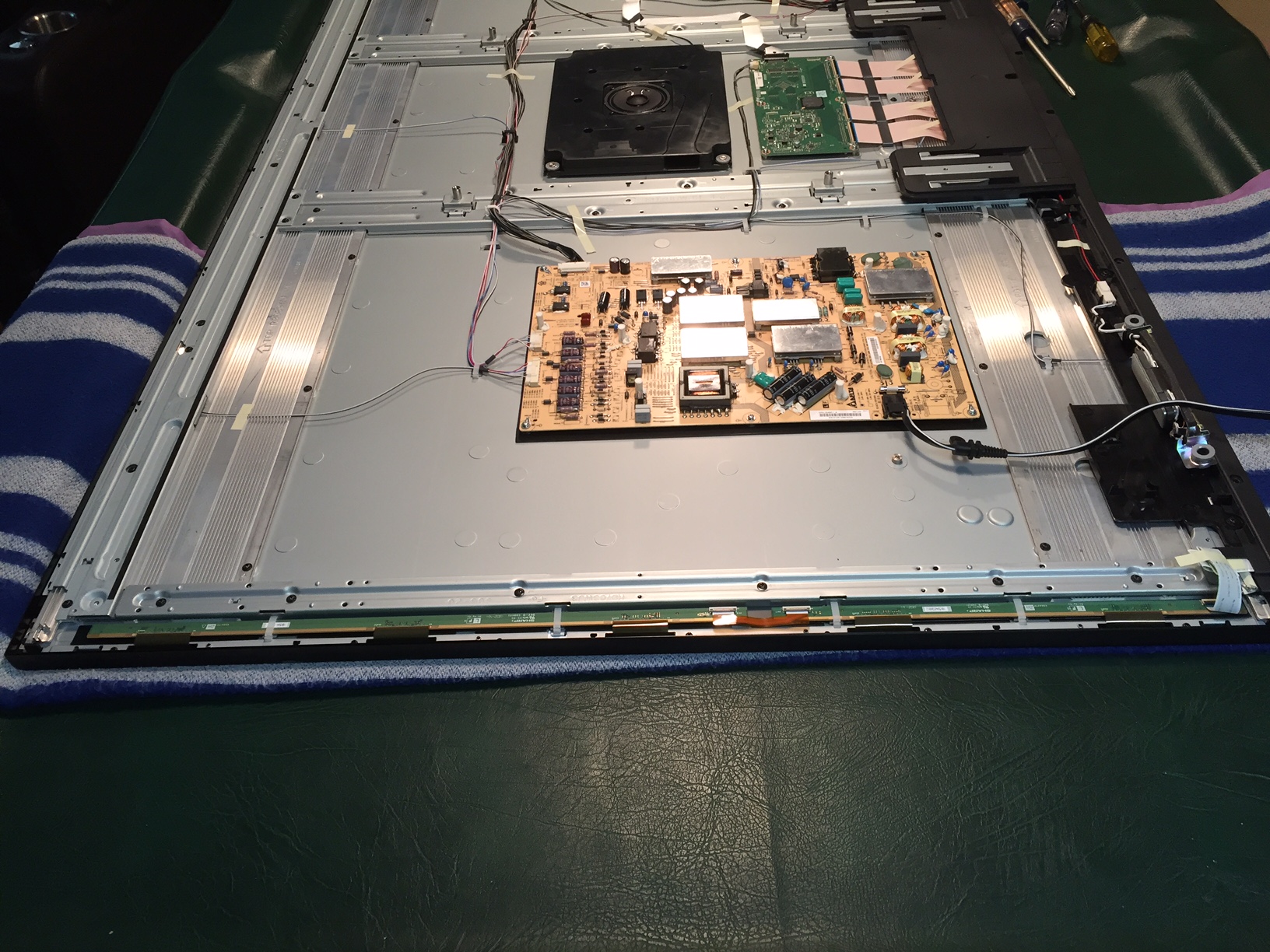

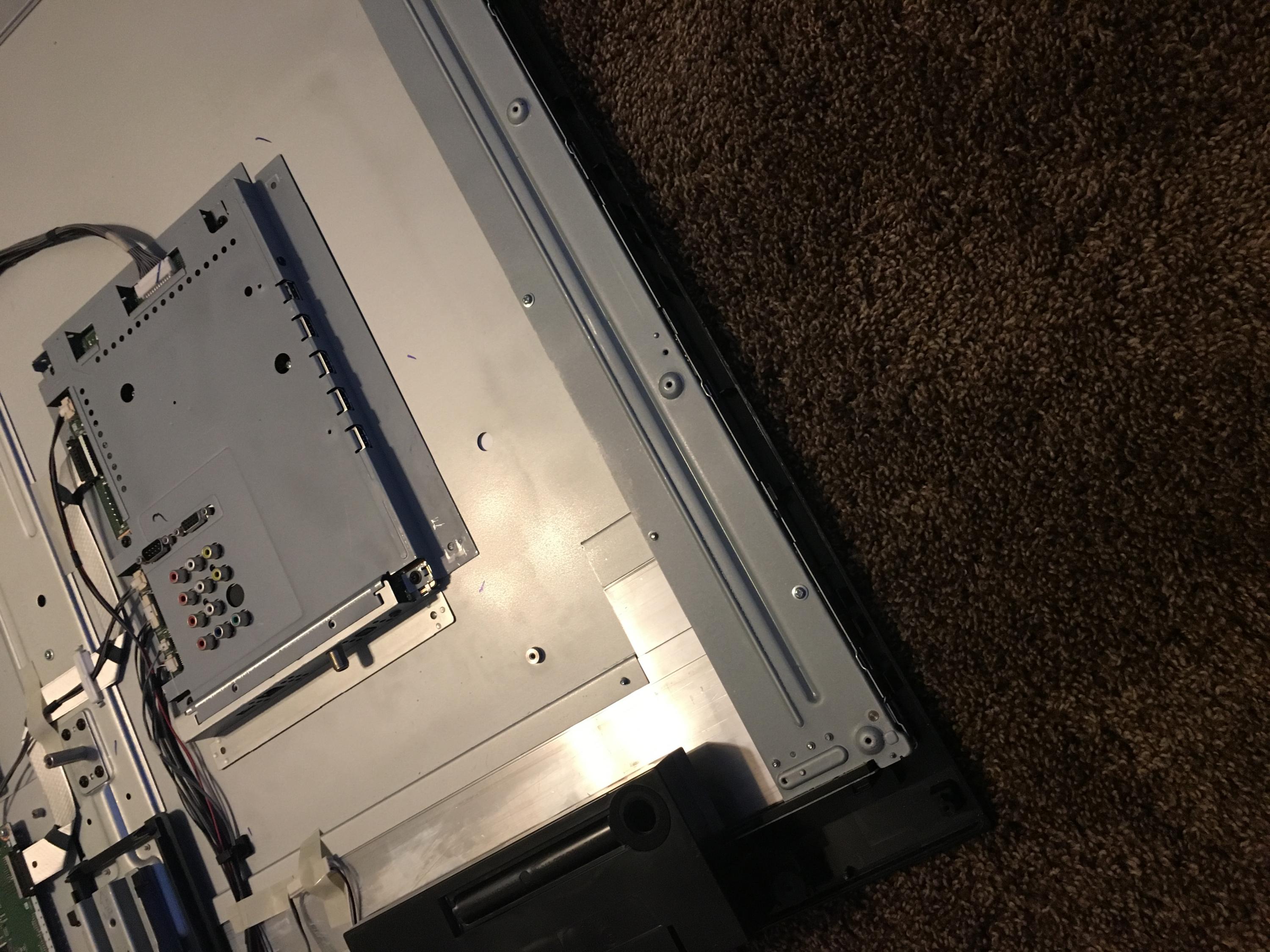

                                  Hi all! This is so helpful and i think I've figured out the problem with my TV. It was blinking 5 short and 2 long and i had a line coming from the bottom left about 2/3 across the screen for a year now, and 4 more started in the last month. Yesterday it started flickering and then the screen just went weird. I want to pull the tabs, but i can't figure out how to take it off. I watched a few videos but that didn't help me much. Can anyone offer advice? I got the plastic backing off, but could not figure out how to get the metal off to get to where i think the tabs are. I have a 60" sharp. Thanks!
                                  • budwich
                                    • Jul 2015
                                    • 3097
                                    #37
                                    Re: Sharp Aquos - Horizontal Line and flickering colors.

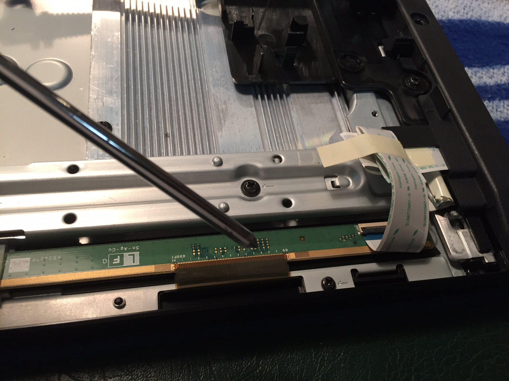

                                    picture of what you are referring to "plastic backing off"? is that the "tape" or the bezel? I do believe the access is from the front not the back... so you need to remove the bezel on the side in question.
                                    • aquoshater
                                      • Nov 2017
                                      • 5
                                      #38
                                      I've gotten this far! I just can't figure out how to find the parts I'm supposed to remove. Does this help?
                                      • aquoshater
                                        • Nov 2017
                                        • 5
                                        #39
                                        Also what is the bezel?
                                        • aquoshater
                                          • Nov 2017
                                          • 5
                                          #40
                                          It worked!!! Took me a bit to figure out how to get to the tabs but i got there! It's good to go! Thanks for all the tips guys!!
