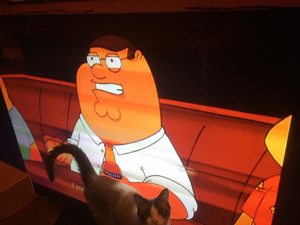

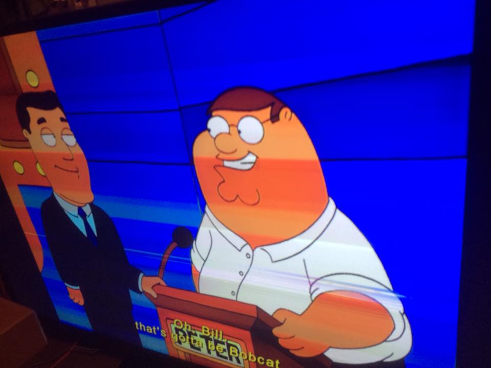

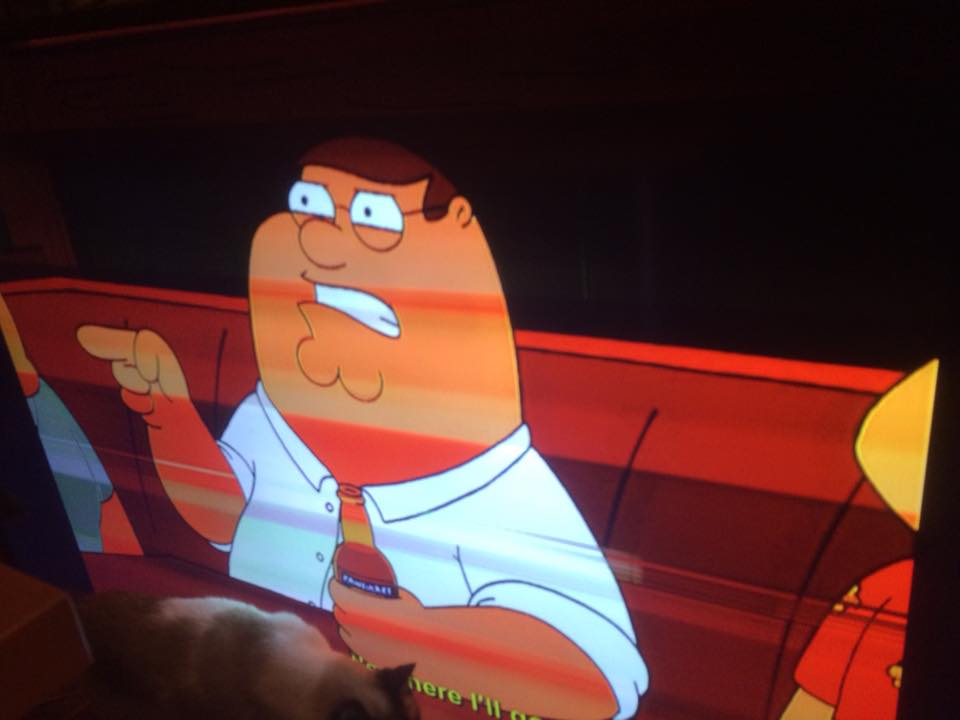

    Hey there guys. So my Sharp LC-70LE650U went haywire the other day with what started at flicking colors and than a horizontal line coming from the right side of the screen.
    I have been reading through this forum for the last few days trying to find a solution and determine the exact problem and from what I gather based on what others have experienced, it looks as if one of the tab drivers have shorted out and I may have to remove the one sides tab drivers. Seeing as this is an irreversible and last option for a TV I was wondering if any of you have any advise or feedback you can offer me to come up with a solution. Any help would be greatly GREATLY appreciated.
    I took a few shots to help determine the problem.
    This is what the screen is looking like after the problem started.

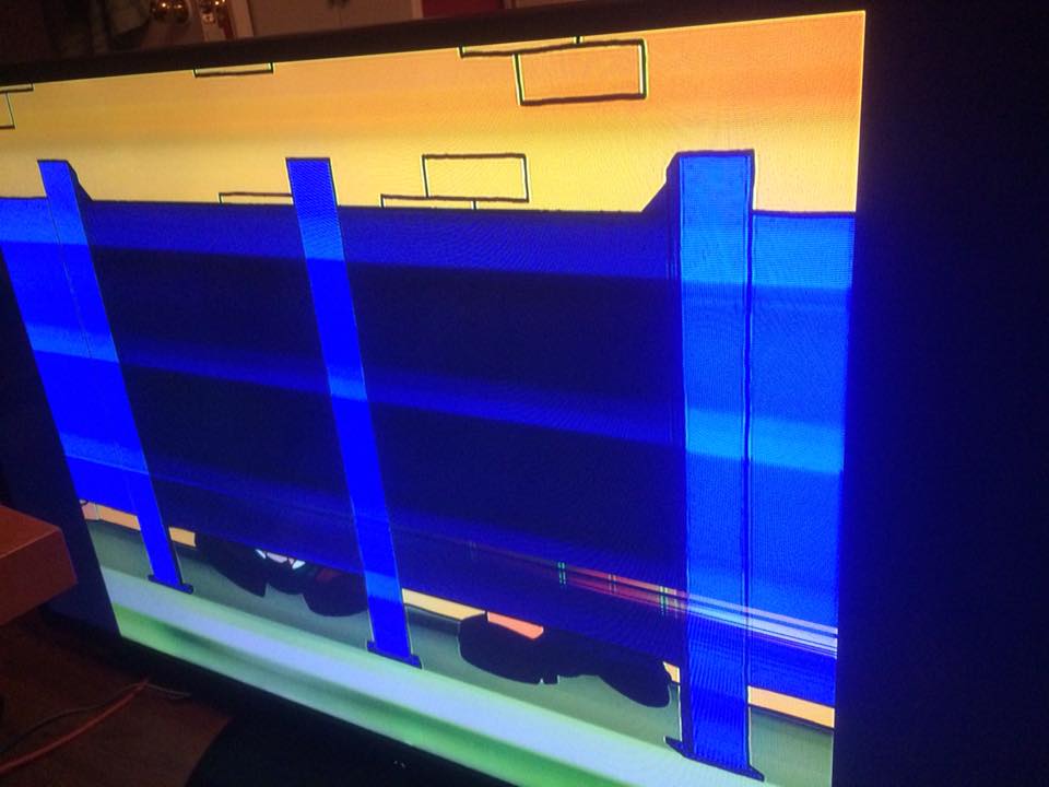

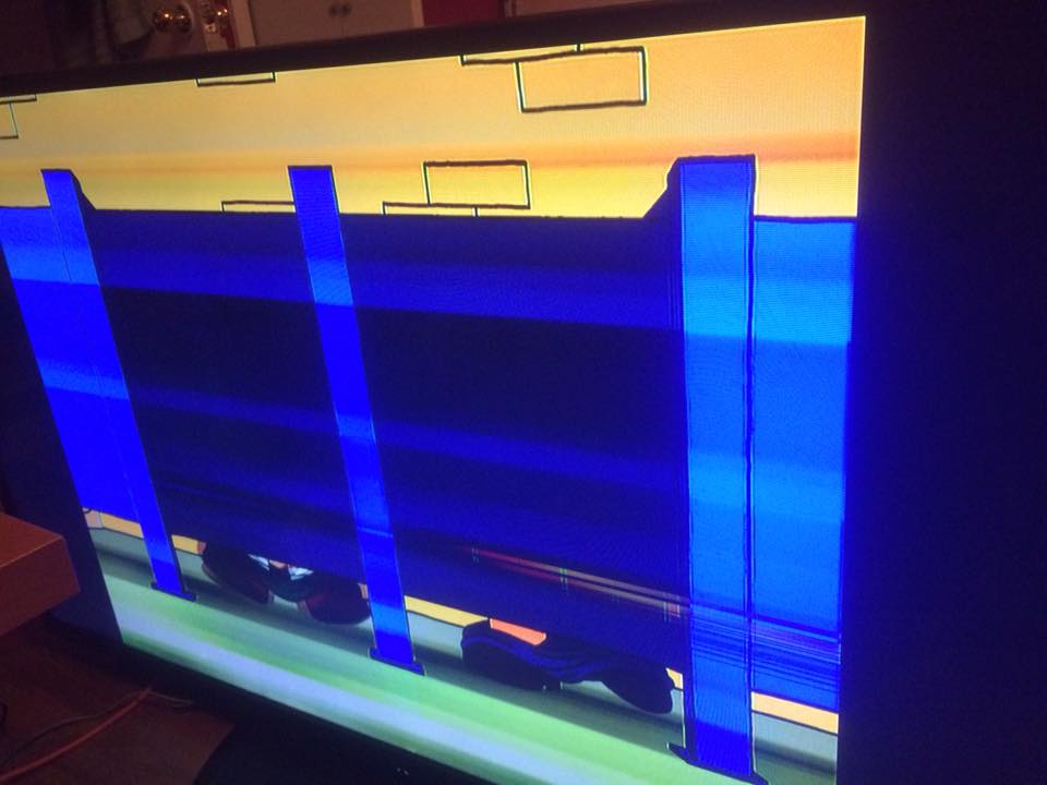

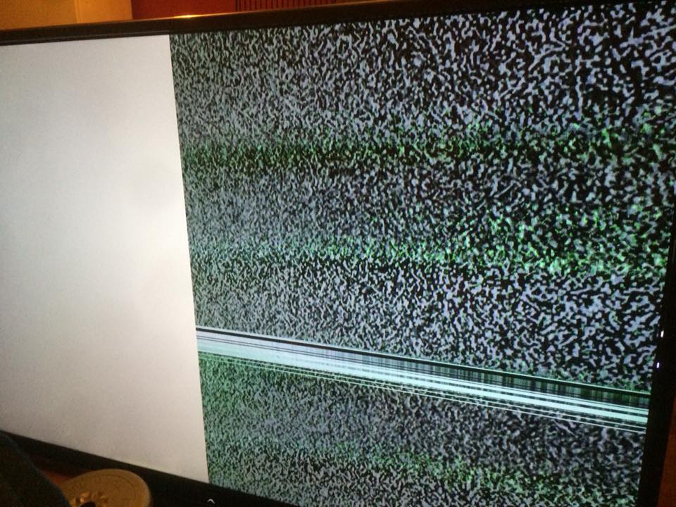

    I have removed the back and attempted a few things that have seen other try out such as unplugging one side of the Tcon and then switching to unplugging the other to see if that was the problem.
    Ride side unplugged of Tcon. (Viewed from back)
    Left side unplugged of tcon. (Viewed from back)
    With the right side unplugged, it is coming up nice and white on that side. But I can see a small part of the line that started from the right side still extending into the left side. (When viewed from the front) Very thin and hard to see in the picture.
    Not sure if that is extending via the bad connection from the right side all the way or not or if that makes an significant change to my situation.
    Again based on what I read it seems as if this problem is not based on the Tcon board itself being faulty and is more looking like a tab driver issue.
    I also than tried removing the metal covering for the side and unplugged the white ribbon at the bottom to see if that would help with the solution and this is how it is coming up.
    As you can see the image is more white and the horizontal line is still there. It is coming up slow with a kind of lag if I bring up the menu or any other images on that side.

    your testing has been pretty good and it appears the right side is in trouble. It would be nice if you could feed in a good signal (from a dvd or such) with a color bar pattern. Then you will get a better view of things... this would be with the lower corner right side cable disconnected.
    IF the "side" is based on "looking at the set"... as pictured in your post. It is "funny" as it looks like the lower left corner cable has been disconnected. Please confirm with some reference what "right" and "left" is for you.

      I updated the first post with (viewed from the front) info ect to make it less confusing, but you were correct. Looking at the TV from the front, the right side ribbon cable was disconnected.

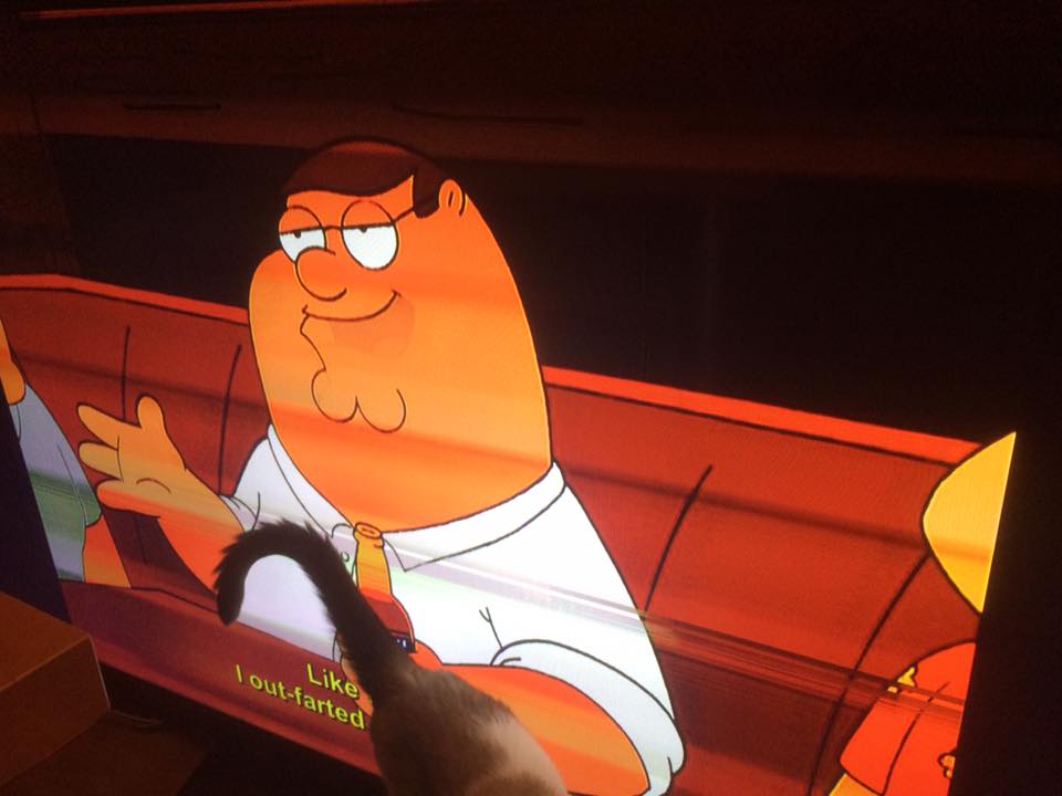

      Since I couldn't bring up the color pattern, I took a few screen shots from booting up netflix on the TV to hopefully help out with an idea.
      As you can see its very flickery and lines are still present.
      Once again, any feedback would be greatly appreciated.

        if you have experience in electronics. open the back cover of tv. here in bad caps are some other guys that removed the driver tabs from the side. on the first picture you added, you removed one tab and it went white one side and the other with lines. am pretty sure thats the bad side of the dirvers, why? because when you try the other side it didnt have lines and no flickering just a perfect picture.

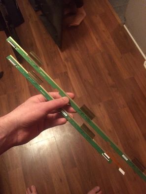

                Question though. How do you go about removing the tab drivers. I keep reading about peeling them off and pull them towards the front of the screen. Are they fairly easy to pull off? I looked at them attached to the panel and they dont look like they are on there too much so is it more of a just pull/ripe them off with some care?
                  Re: Sharp Aquos - Horizontal Line and flickering colors.
                  That was the most scary and RELIEVING thing I have done in a long time.
                  Decided to pull the tab drivers out since I am out of time before tomorrows surgery and it works 100% perfect screen! AMAZING fix. At least for now which mattered most to me.
