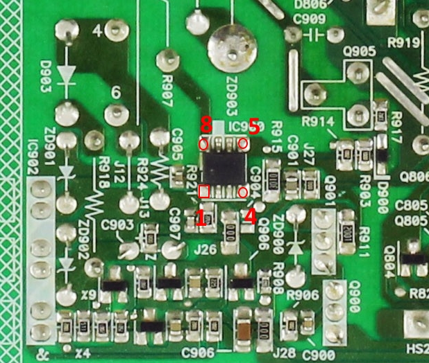

    Pin 8 is connected to resistor R907, pin 5 is connected to R914.
    Caps C915A, 915B, 917 are the filter caps for the STBY 5V.

      Ahh! Ok, thanks budm! I think I have it now. That would make pin #1 the lower right corner of the shopjimmy photo. (next to the descriptor for C904).
        Re: Vizio VW37L TV - no 5v standby voltage
        No, pin 1 is the lower left most pin.
        Look at the spec sheet of the IC.
          8-pin IC, get it?

            Thanks for the drawing budm, and your patience. The spec sheet lists "VH" as pin #8.. which is the upper right. However, and for whatever reason, I was thinking the sequence of the pins had pin #5 across from pin #1... not pin #8 across from pin #1.

              Vdc Measurements of the IC pins with respect to pin 4 yielded the following:
              Pin #1 - 0v
              Pin #2 - 4.94v
              Pin #3 - 8.04v
              Pin #5 - 0v
              Pin #6 - fluctuated between 10.3v - 11.2v
              Pin #7 - 0.02v
              Pin #8 - fluctuated between 54v - 159v

                I replaced start up cap C903. However, there was no change in the output and still no 5v standby power.
                  Pin 8 should not be fluctuationg like that at all since the source Voltage is from the 160VDC of the main filter cap.
                  There should be high resistance resistor R907 connected between pin 8 and the + leg of the main filter cap, check that resistor out.
                  It can be due to internal failure of the charge pump circuit on pin 8 of that IC.
