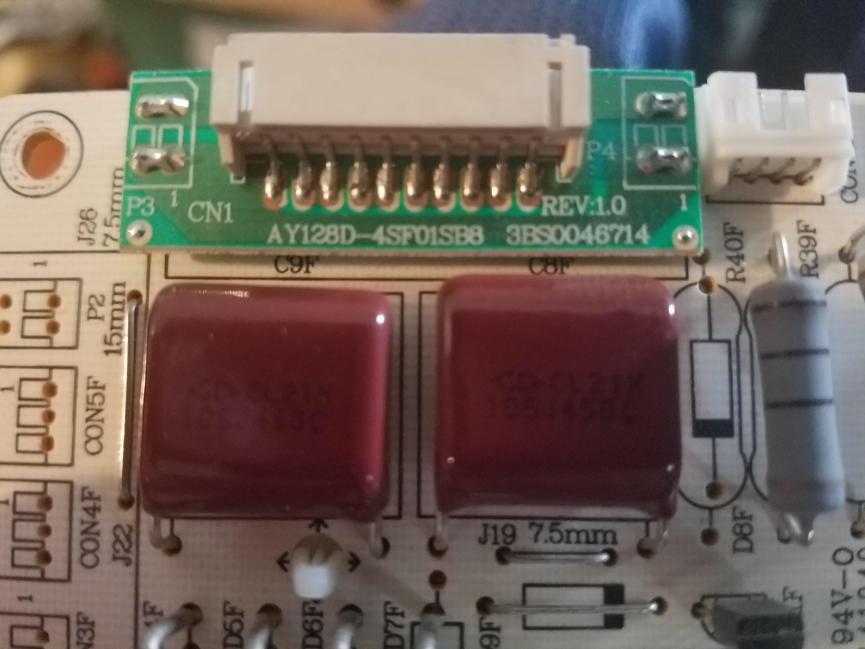

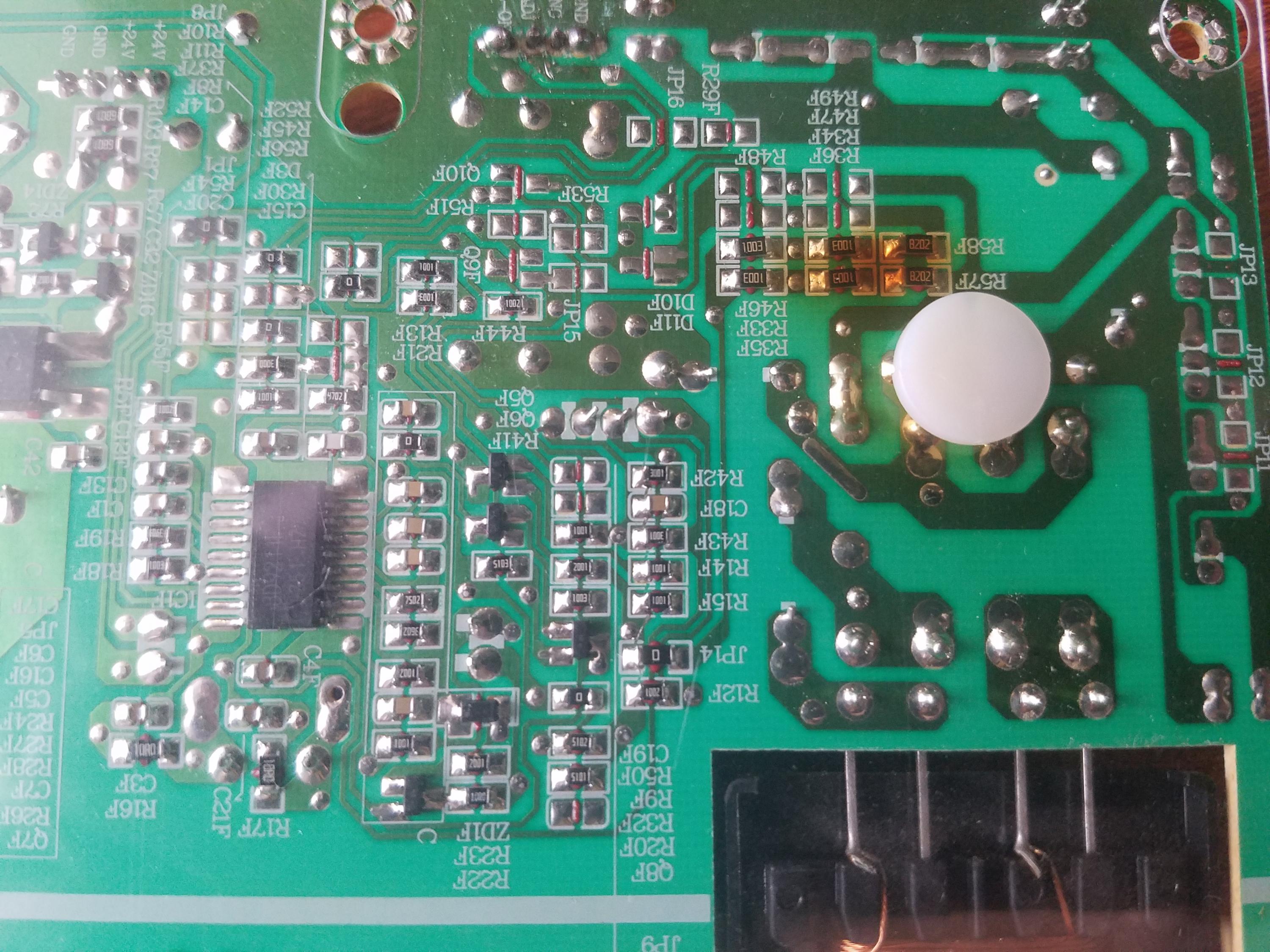

          I did notice this after pulling the power supply out. On the plastic shield on the bottom it looks as though something got real hot underneath C9F and C8f. I will attach pictures and if anyone has an idea of where to go from here please let me know. Thanks
            Re: Westinghouse DWM50F3G1
            Have you measured them to see if similar resistors have the same value.
