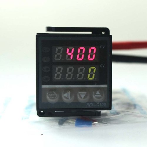

    Does anyone know of a ptc heater that does not burn the LED strip when replacing single LEDs? I'm trying to refurb LED strips and I want my strips to stay as white as possible. On the youtube videos their ptc heaters don't burn the strip at all hardly. Any help or methods would be greatly appreciated.

      you can built a controlled temperature output using ptc and rex100 temp controller.. just follow the rex100 wiring diagram or google it. hope this helps
