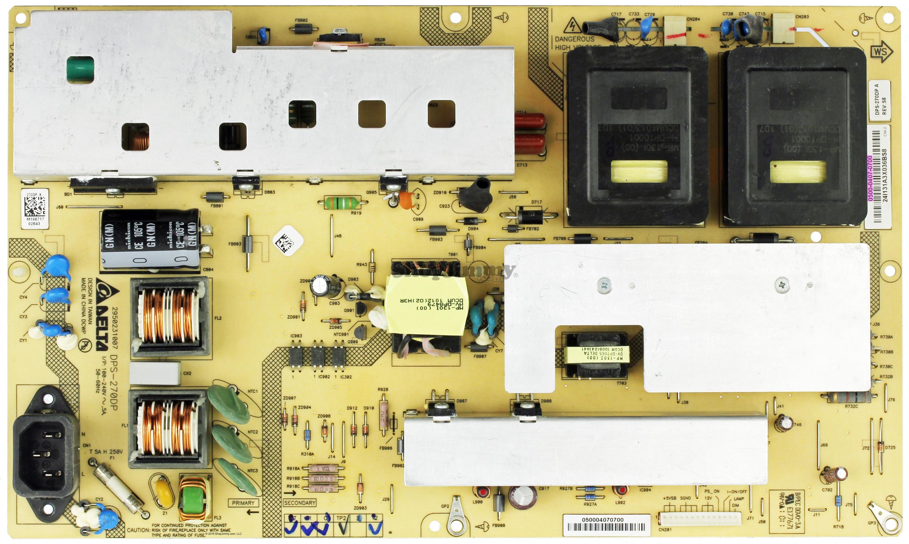

    all pins on u33 are 12.1v except pin 2 and 4 which are 0.02v

                        The 'LAMP ' line input pin on the MB has pull-up resistor to keep it HIGH when there is nothing connected to that 'LAMP' pin, the 'LAMP' pin on the power supply board is connected to a switched Transistor which is turned on if there is LAMP error detected which in turn will keep the 'LAMP' line low. If I am correct the LAMP line should be HIGH when no error detected, right now it is low and it is telling the MB that there is problem with the lamp circuit.

                            So as I asked post #24, again, do the backlights stay on if you leave the LAMP wire not connected to anything but all other wires connected? We need to verify if the LAMP error is the one that causes the main board to shutdown, and also to verify if HIGH is normal and LOW is abnormal.
                            BTW, you should spend some of your times tracing out the LAMP pin 13 of the connector CN201 to see where it goes to, looking at it from the pictures from SJ, it looks like it is connected to the Collector of Q709, hard for me to see where else it goes to.
                            Also, what resistance do you get on the power supply board LAMP pin and GND pin of the connector?
                            http://www.shopjimmy.com/vizio-0500-...pply-unit.htm#
                            Vizio 0500-0407-0700 Power Supply / Backlight Inverter
