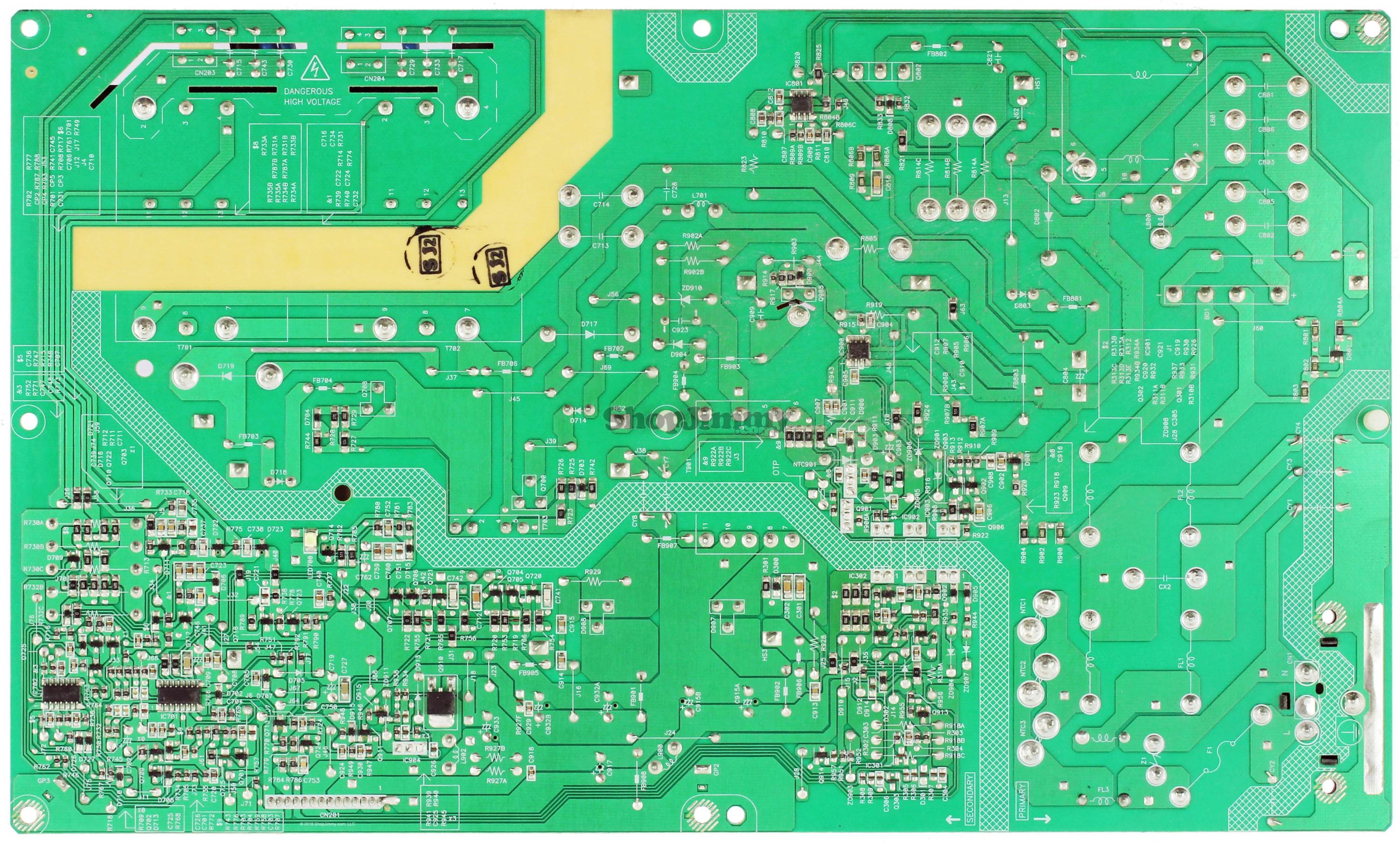

    i have psu board number 0500-0407-0700
    seen here: http://www.shopjimmy.com/vizio-0500-...upply-unit.htm

          Re: Vizio e470vl has 2 seconds to black
          Can we see the whole backside of the TV to see what boards you have in your TV?
          So far the main board is sending the correct signals.

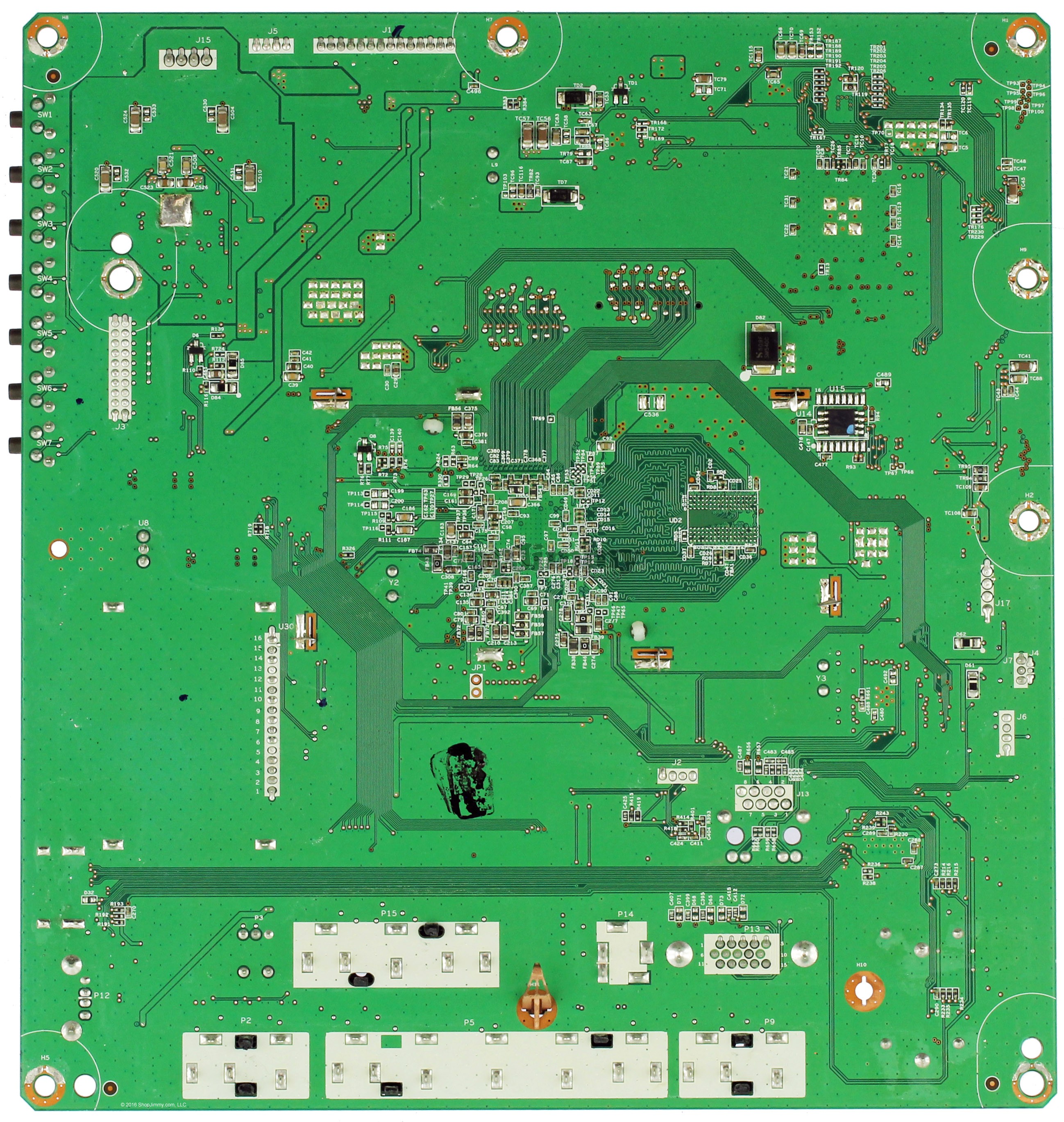

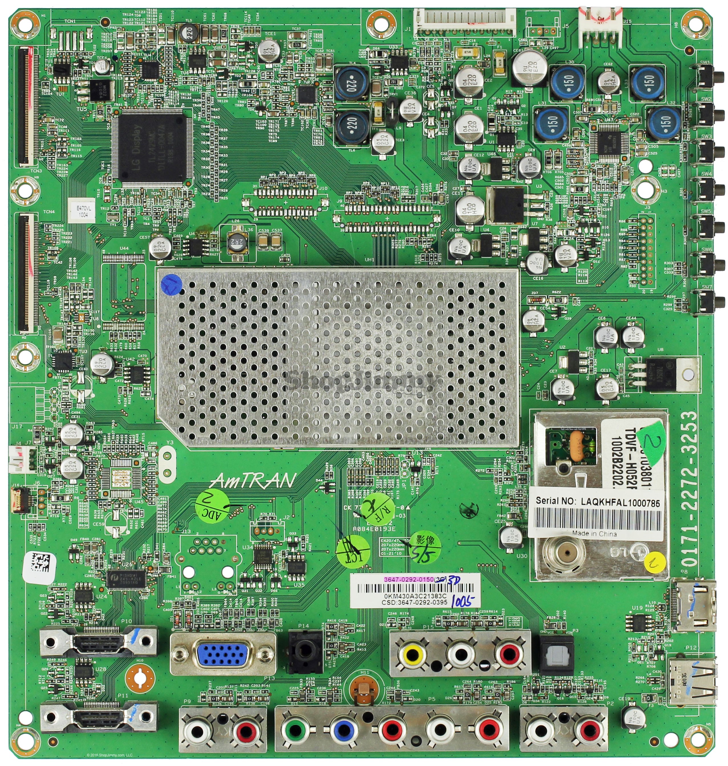

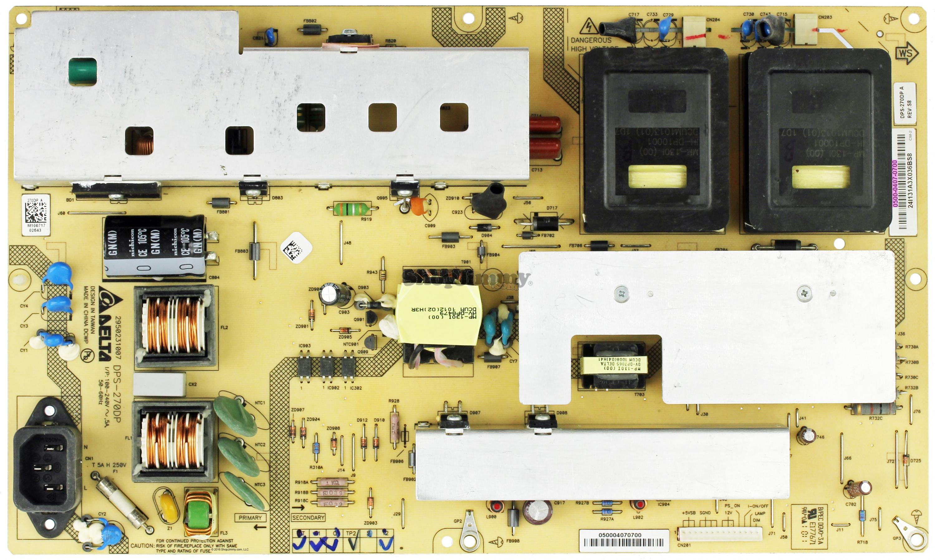

            i listed the psu in the first post:
            0500-0407-0700
            and the motherboard is this one:
            0171-2272-3253
            http://www.shopjimmy.com/vizio-3647-...for-e470vl.htm

              The problem is that lots of Forum users outside of the USA cannot access Shopjimmy having their IP address blocked by Shopjimmy. So the link is useless to many however attaching the pictures is far more useful.
              • triplefour
                • May 2014
                • 1747
                ahh ok gimme a minute to "borrow" the pics from sj

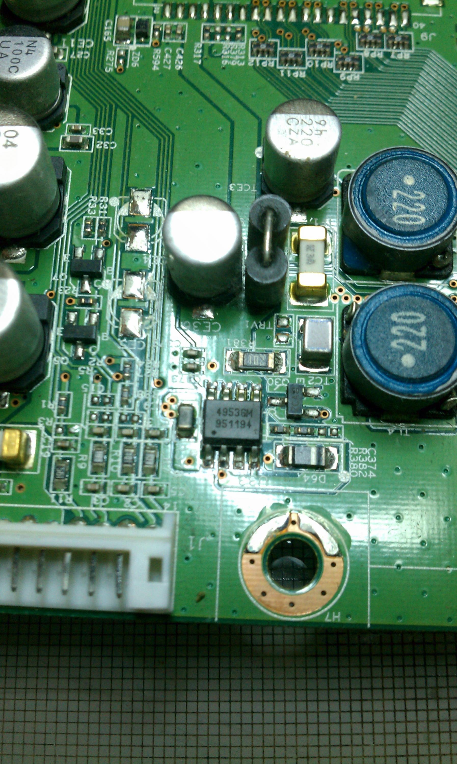

                  • triplefour
                    • May 2014
                    • 1747
                    no way i could ever take pictures these good with what i have

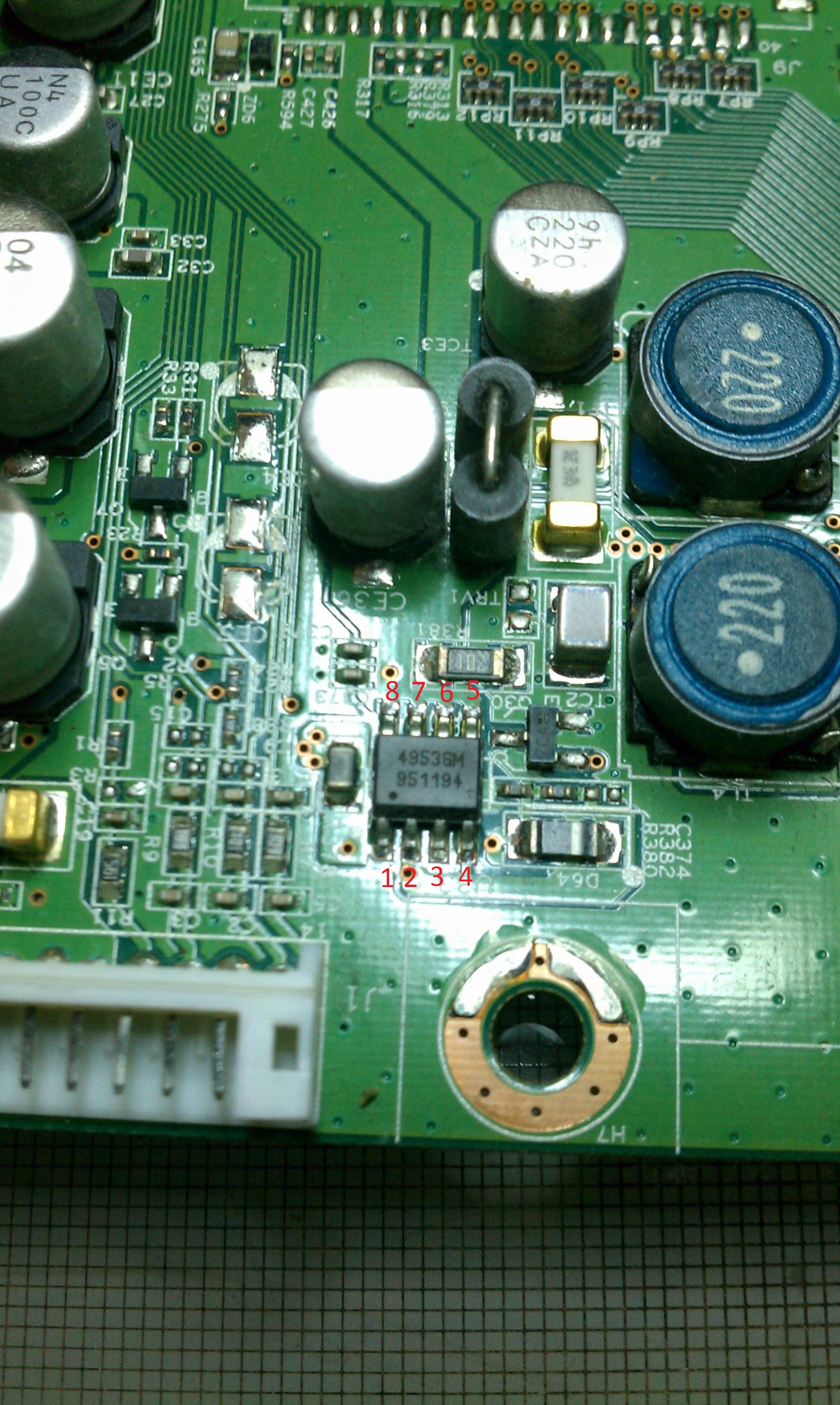

                          What is U33 part number as written on the top of it?
                            u33 part number and data sheet in this thread post 4
                            https://www.badcaps.net/forum/showthread.php?t=33463
                            although after reading the whole thread i dont think u33 will be your issue as that set didnt turn on etc.

                            • triplefour
                              • May 2014
                              • 1747
                              4953gm
                              951194
                              Don't fear the repair...
