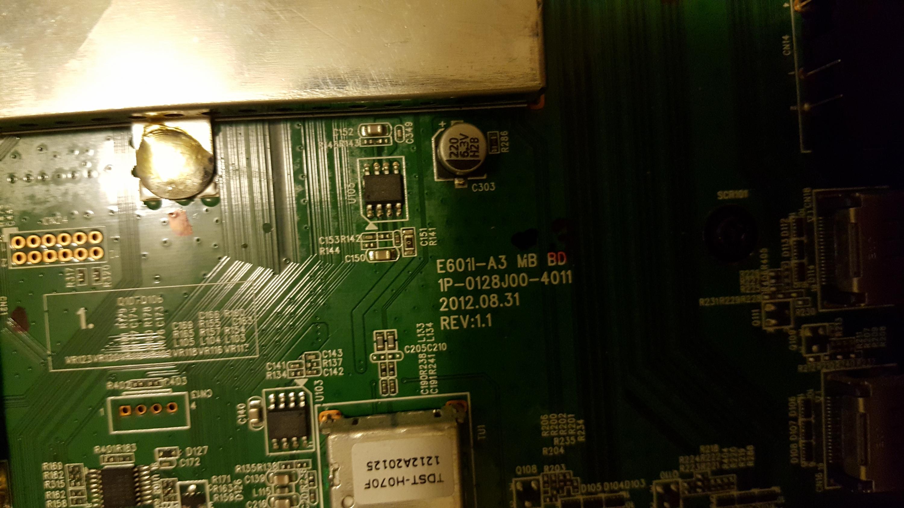

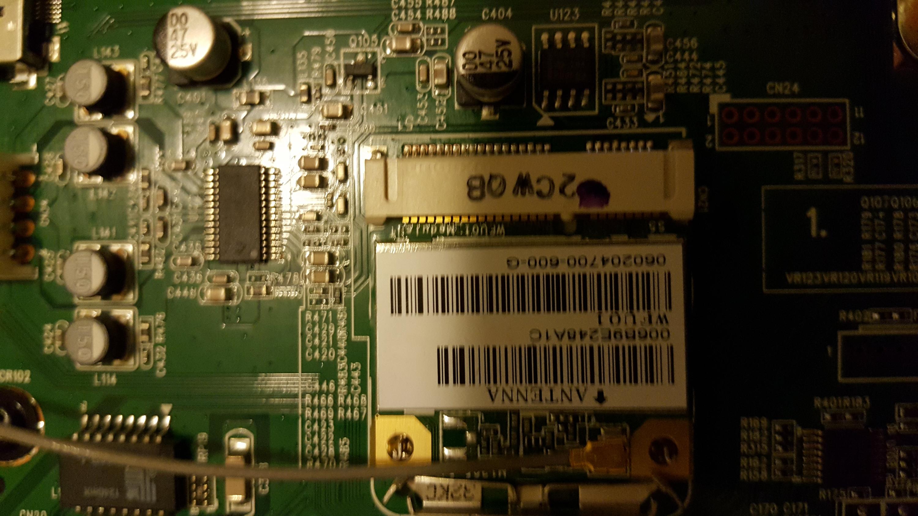

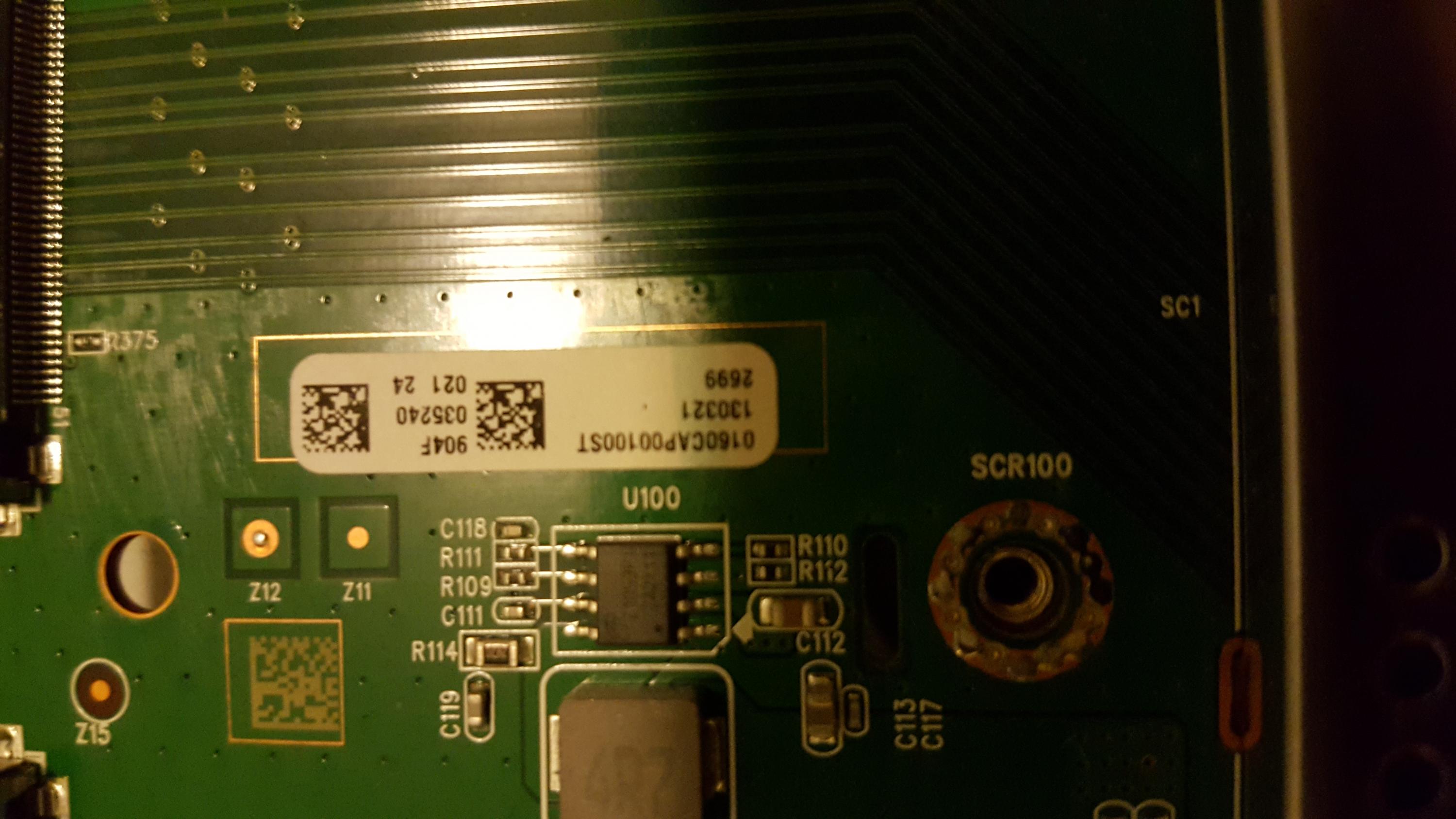

    Ok so im trying to get an issue solved here, or at least get some clarification on a part. The e701ia3 i have has a main board with the model bumber of an e601ia3 on it. Ive searched around and have seen some of the part numbers with a CAP in their number, but then again some have also had CAR in the part number.
    Which is the correct main board that should be associated with my e701ia3?
    Re: Vizio E701Ia3 main board question (pics attached)
    According to shopjimmy that board is for your tv.
      I saw one for an Lftrnxap model and iirc, it was not the same. Also i spoke with a local tv repair shop, and they said the model number printed on the mb should match the model printed on the tv. Vizio replied similarly. Just wanting to rule out all possibilities that it is the drivers on the bottom of the panel in which need removal.
