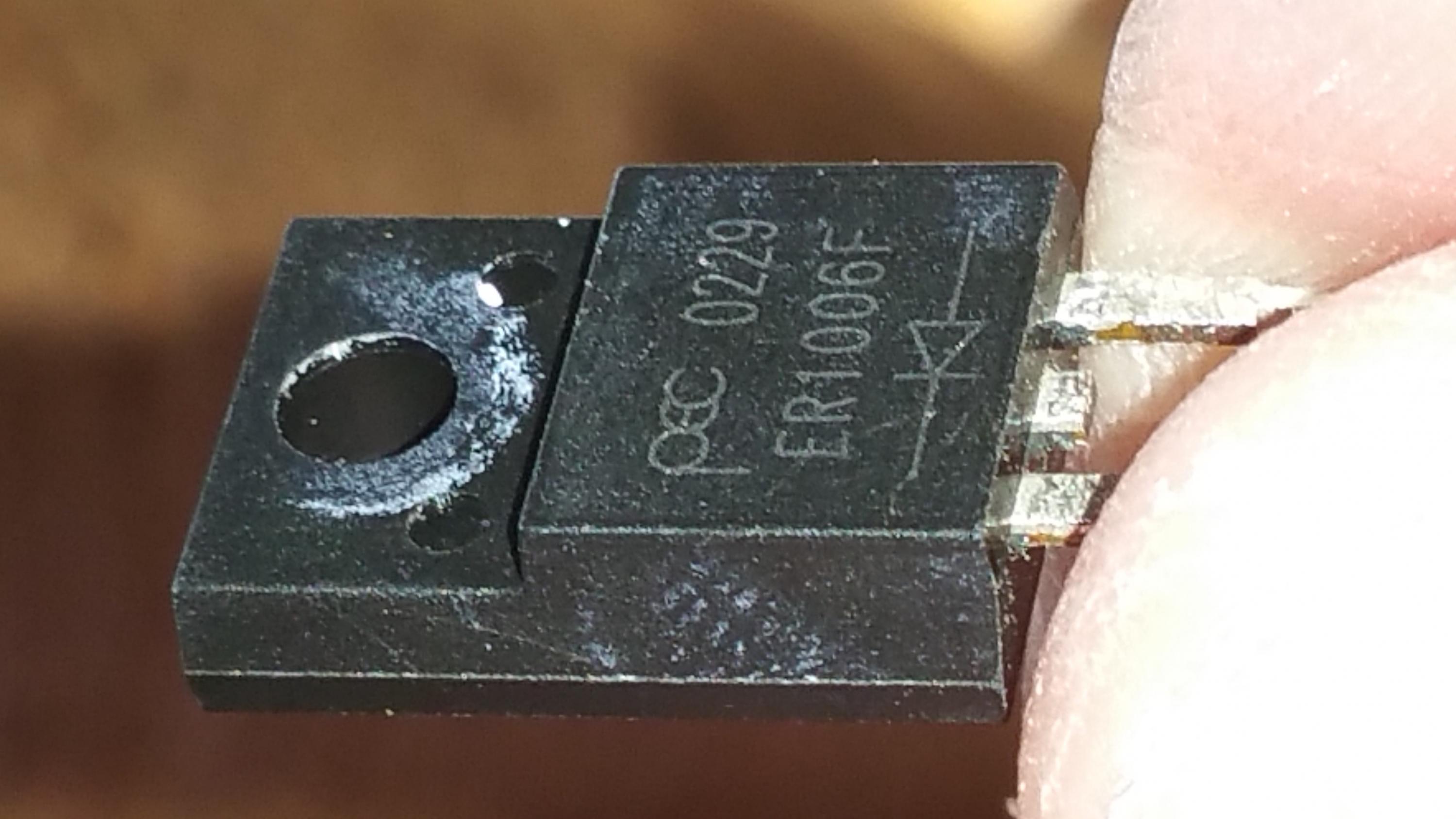

                One question is what is D3 on the board?
                Is it a Mosfet or just plain transistor ? It only has 2 leads ? How do you test it ? Continuity?

                  D usually means a diode test it in diode mode with leads one way and then the other and note the readings the mosfets etc can all be tested in circuit at first any odd readings i usually remove and retest but test the bridge rectifier first as these usually fail short circuit anything your stck on just ask and we will try too advise you.
                    You're correct !
                    I removed the diode from the board and the diode tested ok.
                    Nothing one way and continuity the other.

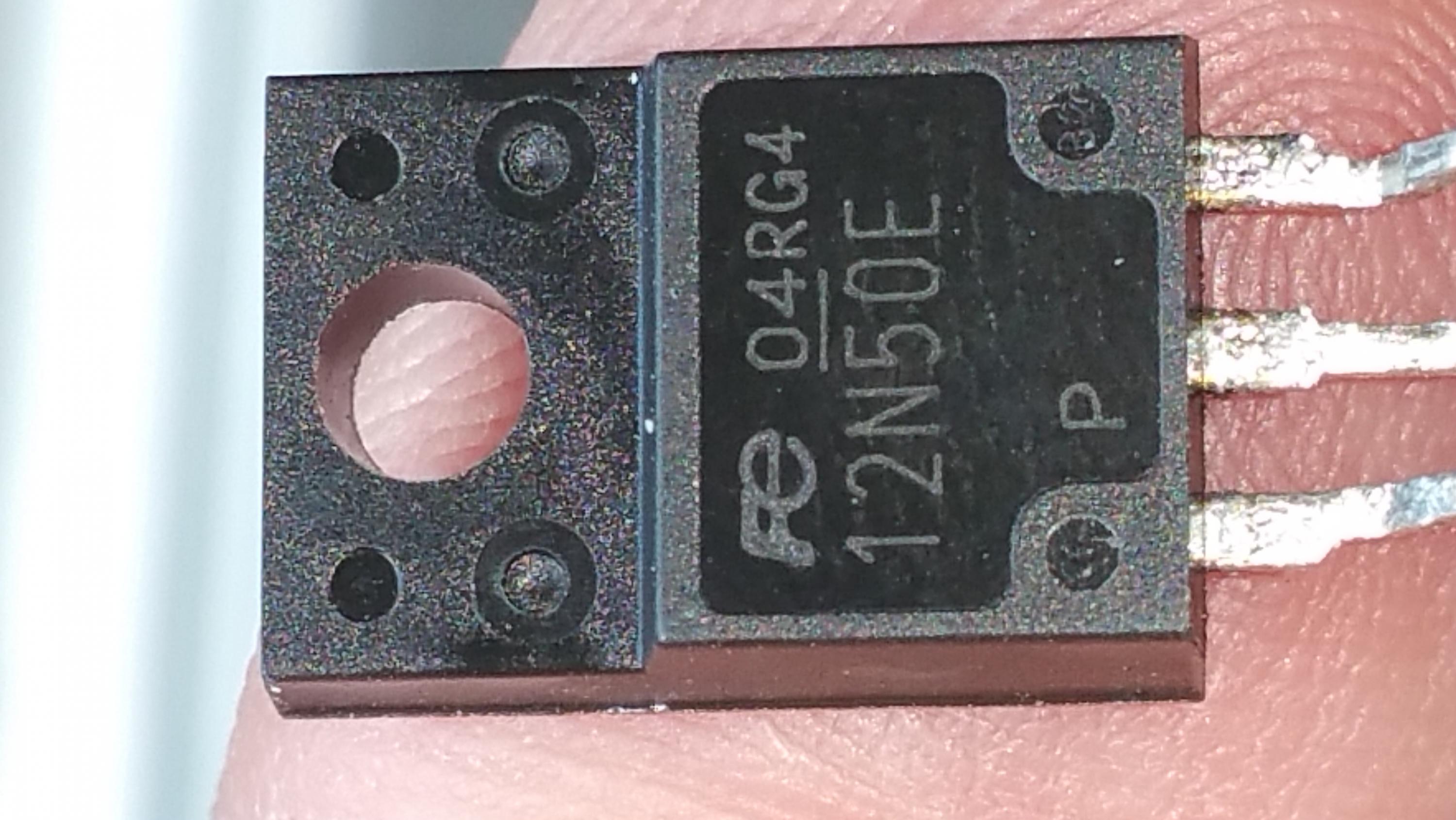

                    I removed the 2 mosfets Q4, Q1 and one of them is bad it didn't pass the test I found a quick and dirty mosfets test on YouTube.
                    Could 1 bad mosfets be causing the fuse to blow ?

                      yes a shoted mosfet can did you test the bridge rectifier too?
                      try re testing both of those and use this method and post the readings for us
                      Mosfets
                      If you have a manual range multimeter, set it to 200 ohms (two hundred). You can test a mosfet (Q, IC designation) "in circuit" by (power off and unplugged)
                      a) black on pin 1- red on pin 2 - record ohms
                      b) black on pin 1- red on pin 3 - record ohms
                      c) black on pin 2- red on pin 3 - record ohms

                            Of the board mosfet
                            a) black on pin 1- red on pin 2 - 120
                            b) black on pin 1- red on pin 3 - 120
                            c) black on pin 2- red on pin 3 - 002
                            Mosfet I think is good on board test
                            all 3 test are open no readings - off the board I passed quick and dirty YouTube Test

                              So it looks like definitely a bad mosfets so far
                              Now to find a cheap one and try it along with a fuse.

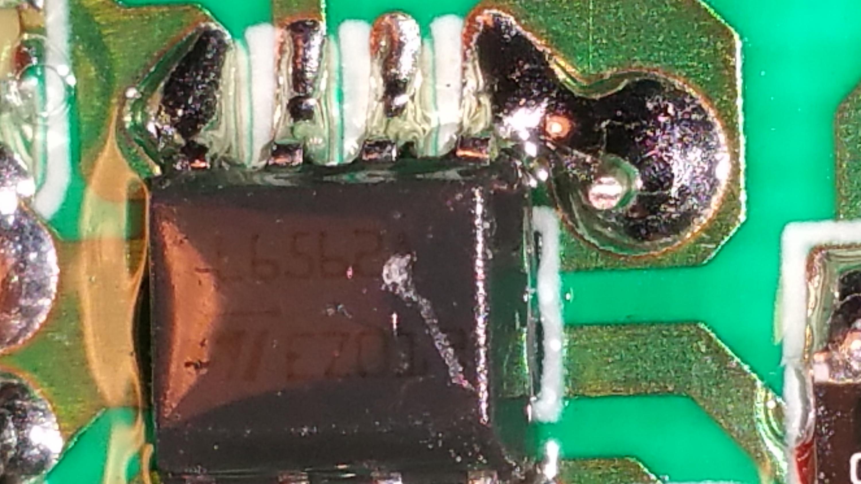

                                    What is the part number of the IC marked IC1 on the underside of the board?
                                    • hackerjoe
                                      • May 2016
                                      • 25
                                      #38
                                      Re: Westinghouse VR-4085DF wont power on & no lights
                                      ok this is the best photo I can get of that chip
                                      There is shellac or something on it so its hard to get a clear shot.
                                      I think its upside down, I am not sure
                                      OK it looks like L6562A 7/EZ012

                                        It looks like 6562x. Can't make out the last number. Can you scrape off the shellac carefully. I'm thinking it may be the IC that controls the blown mosfet so trying to find data on it.
                                        • hackerjoe
                                          • May 2016
                                          • 25
                                          #40
                                          It looks like 6562x. Can't make out the last number. Can you scape off the shellac carefully. I'm thinking it may be the IC that controls the blown mosfet so trying to find data on it.
                                          I did scrape it but I don't have a strong enough magnifying glass.
                                          It looks like L6562a
