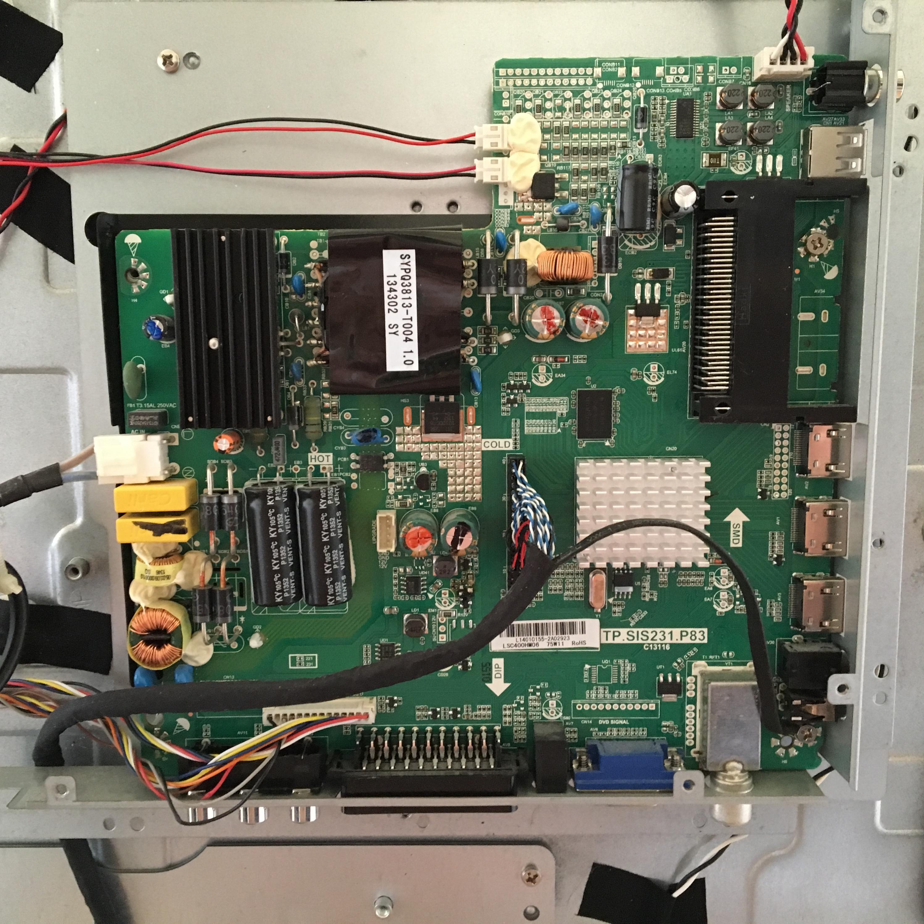

    Hi
    Here I am again with my latest project just bought a dead Bush BMK40 LED TV for a tenner easy problem I thought !!!!!!!!!
    Opened it up NO board fitted no wonder it was dead
    Boards seem to be like rocking horse s*** for this tv but found one on ebay for 15 all i had to go on was bush BMK40
    Got the board a TP.SIS231.P83, only board I could find
    Fitted the board and not working

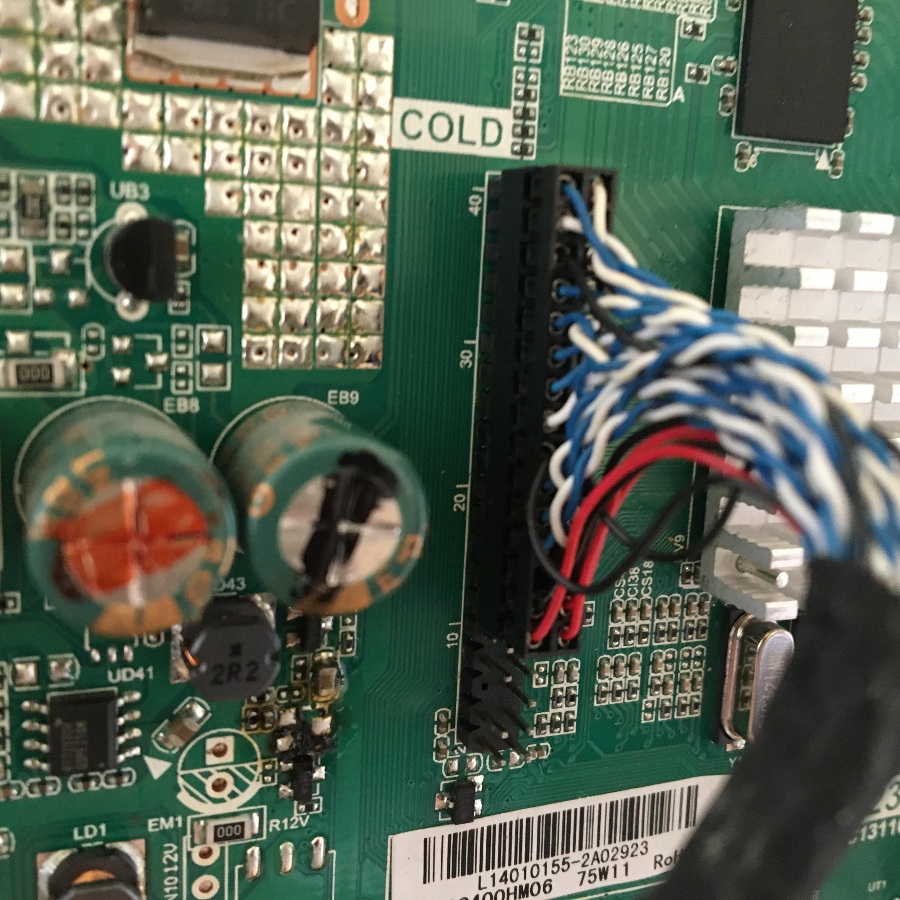

    First problem the LVDS connector on the board has two rows of 20 pins, connector on the TV has two rows of 15 pins so not sure which pins to use, connector seems to go on any combination of the pins.
    However I fitted the connector as in the picture.
    When TV is plugged in red led shows on the front, when power switch is pressed red light turns green and backlights come on but no sound on picture
    Any ideas lcd looks good

    Re: Bush BMK40 no picture/sound
    Bush BMK40 pics

              I would think the red wires on the LVDS cable connect to the fuse on the Tcon board but would need to be verified.
              • london-freddie
                • May 2015
                • 472
                have just moved the LVDS connection down to the bottom ie: the red cables at pin 1 still no voltage at TCON fuse
                  You need to use your meter set to ohms to find if the red wires go to the Tcon fuse.
                  Then find out which pin(s) on the main board LVDS connector (disconnected) has the supply voltage.
                    An ebay picture shows the LVDS connector connected differently on the main board.
                    http://www.ebay.co.uk/itm/BUSH-LED-M...p2047675.l2557

                      ok you are right it is the red wire on the LVDS cable that goes to the TCON fuse.
                      The fuse on the TCON is marked as 125V / 3A
                      Have checked all pins on the mainboard connector no voltage at the pins connected to the red cable, several of the pins have small voltages ie 3.6v 2.5v 1.5v but nothing on the pins that would connect to the red wires to the tcon if that makes sense
                      • london-freddie
                        • May 2015
                        • 472
                        yes thanks for that, that is now how I have got it connected Red to pin 1 at the bottom

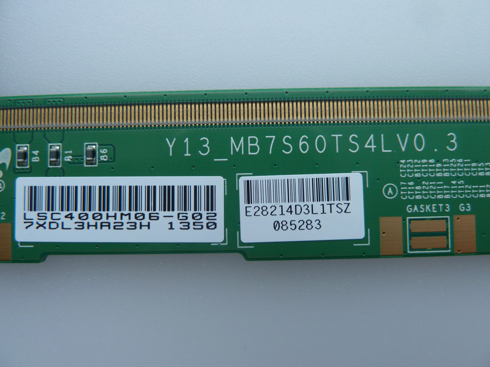

                                  ok that makes sense, this panel has the driver board on the tabs, but cant find any reference anywhere as to what panel it is
                                  • london-freddie
                                    • May 2015
                                    • 472
                                    driver board or tcon as some sellers are calling fitted is Y13_MB7S60TS4LV0.3 but still not sure what panel this is, did find a picture of a LSC400HM06 with this driver fitted
                                    • london-freddie
                                      • May 2015
                                      • 472
                                      driver tab pic on ebay mine does not have the white sticker on
