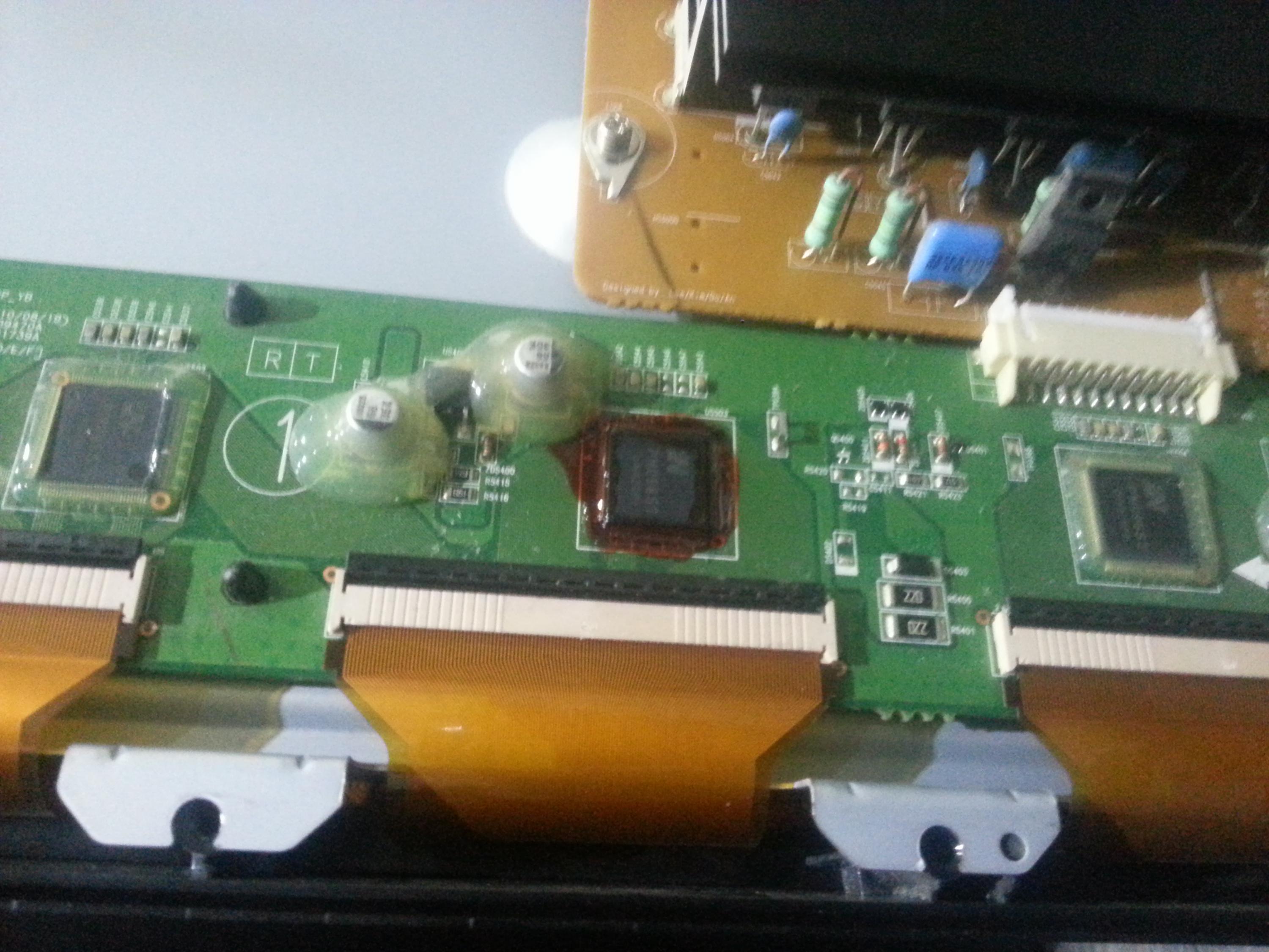

        Can someone help me find a reasonable priced source for R2A20251 buffer chips? I am trying my hand at repairing a TNPA5534 board from a Panasonic TC-P55ST50 plasma set. The nail polish remover work great at breaking down the RTV silicon. I had a tough time removing the heat sink but I found heating the sink first and then slipping a razor blade under the corner works best at removal. Thanks in advance!

          I've bought mine from Aliexpress in the past.
          This is the video I used to check for a failed chip produced by one of the many TV gurus on here. https://www.youtube.com/watch?v=51SZsfH60EY
          The pins need insulating after replacing the chip. I used transformer varnish as recommended by another member on here.
          I practised on a scrap buffer first and carefully cut the pins on the old buffer IC with a sharp blade then removed the pins afterwards with my iron.

            There a quote on toms video regarding buffer ics whats your thoughts regarding this can they cause the odd lines we sometimes see on plasmas and we think there panel faults?
            Buffer chips can be still faulty even if they look immaculate and show no beeping from your ohmmeter. You need to make sure there's no double reading in both ways from so-called floating ground plus they can be defective from the inside causing various types of horizontal lines (in that case reading perfect with your meter)
