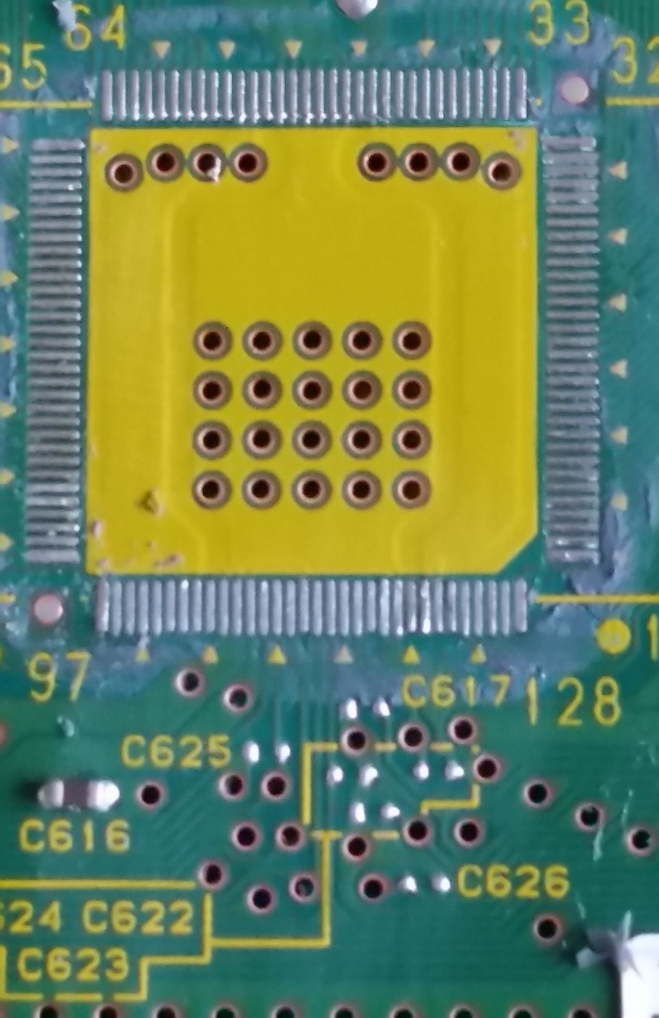

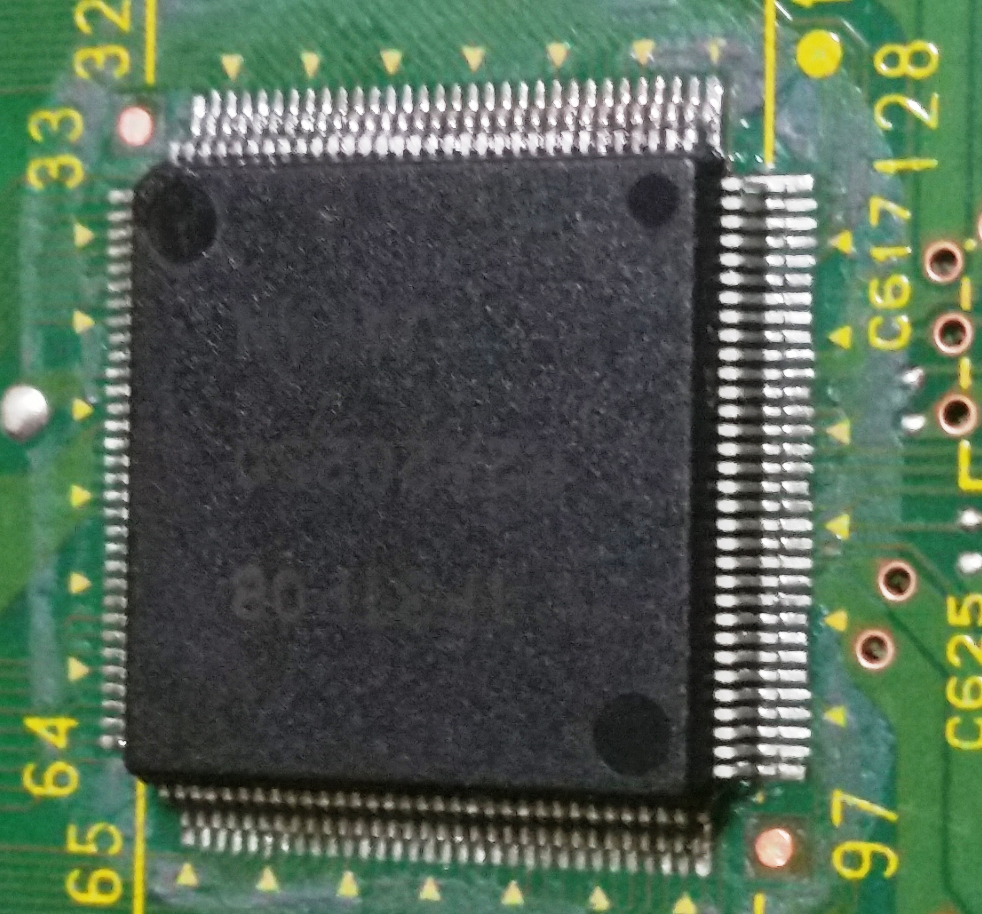

    Just starting a thead hopefully where those who like to have a go and share tips , tricks, info etc to consolidate information on Buffer board repairs for the Panasonic PDP.
    The scarcity of some parts now forcing us to find other solutions like component repair which I've enjoyed, I'm now about to venture into the challenge of replacing these devices.
    I'm sure there's quite a few already doing this and having success so I'l kick this off with a few images of two SU boards awaiting my first ICs to solder in.
    I find acetone, and acetone free nail polish remover helps break up the silicone. It's probably best to remove as much of the silicone first, then cut. I get a blade and cut the pins at the case of the IC, then I like to soften up with the acetane a bit more, then run fresh solder in preparation to desolder those fine pins.
    I have not tried a Hot Air Station and tweezers yet;
    bread packet clip, ice cream sticks, tooth picks to remove and massage that grey silicone away.
    Does not take much heat or effort to tear or lift a pad.
    On one of these, pin 97 which is needed I've lifted but managed to save it.

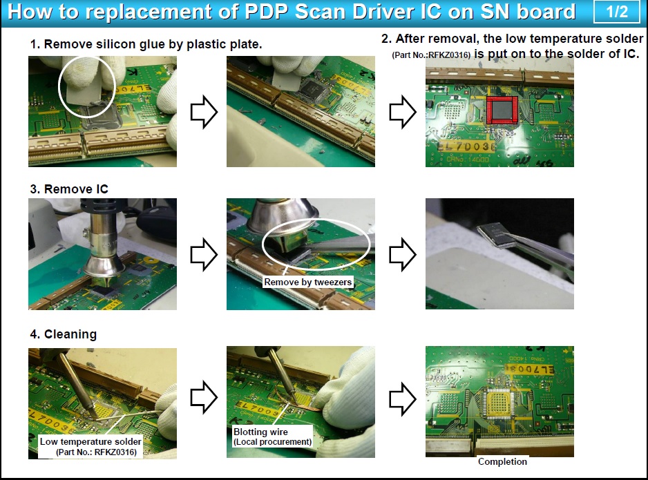

    This is a link to another thread on these buffer ICs.
    https://www.badcaps.net/forum/showth...fer+ic+removal
    Thanks to Kilroys for sharing.

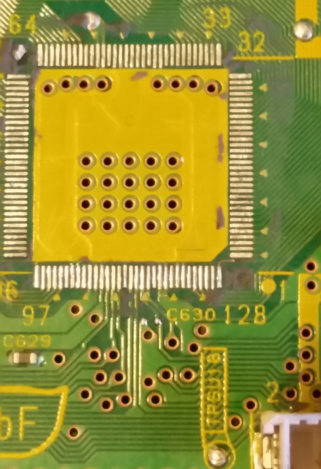

      Well--Last week I changed two on the same SU board for a 50U30B
      I peeled the grey silicone sealer off the pins by finger-nail getting as much off as possible, running my nail along the pins of the chip carefully and avoiding too much pressure at the ends of the rows, its quite easy to bend the first ones in the row.
      Then when it was clear I couldn't get any more off, I cut the pins from the chip body with a good sharp Stanley-knife carefully with a shallow angle and as close to the chip body as possible.
      Before removing the chip body--which is stuck with silicone to the board, I de-soldered the cut pins by flooding with solder, letting the heat do the work, using no pressure, the cut pins float away from the board pads, a bit of braid cleans them and the excess solder away.
      When all are off its pretty easy then to pull the chip body off the board.
      Again the fingernail can be used to remove the silicone that was under the chip. scraping In Line with the pads--Not across them. The pads were all cleaned up carefully-- (Watch your iron temp--Pan. print is Delicate, 320 deg Top.) with fresh solder and braid. Not a pad was damaged...
      Refitting is then just like any other buffer-chip--Use Lots of Home-Made Flux, then cleaned off after you're sure the pins are all soldered correctly, followed by a coating of your favorite gloop--In my case, Ulti-Meg! On this 50U30B, I added some nice heatsinks to the both buffer-boards, kulled from LG sets, stuck with HY-910 heatsink plaster silicone.
      The Grey type silicone is easy to remove. The Black type Panasonic used on later sets--Is Not--Its a much harder plasticy almost hard mastic type stuff...
      I dont believe its possible to remove these chips with hot air, the silicone under the chip stuffs up that idea and the extra heat needed to soften the silicone would bugger the pads....

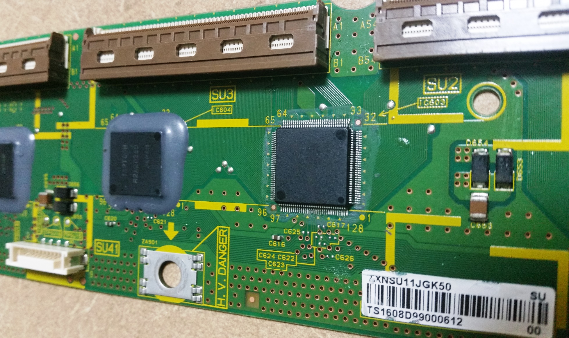

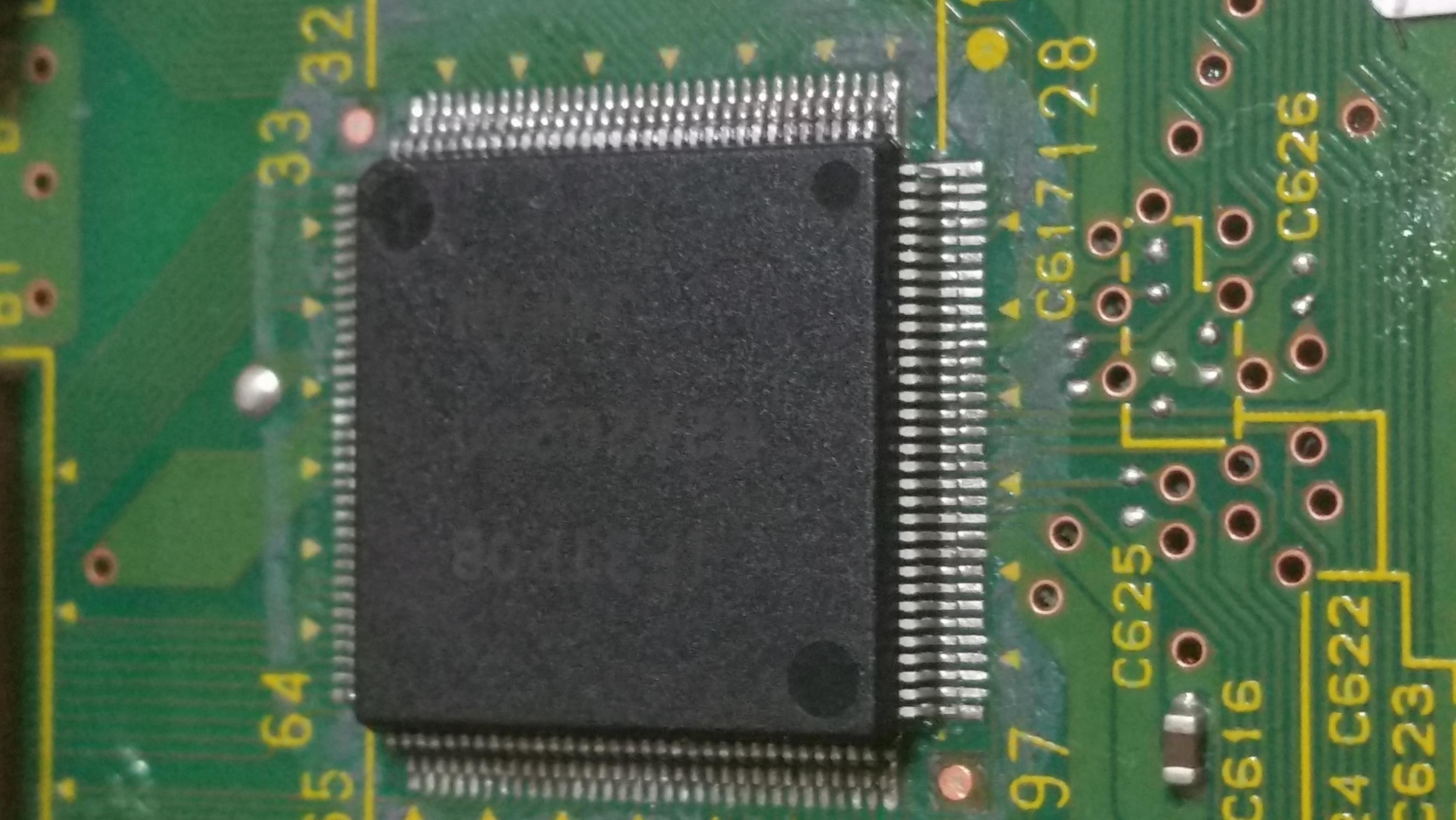

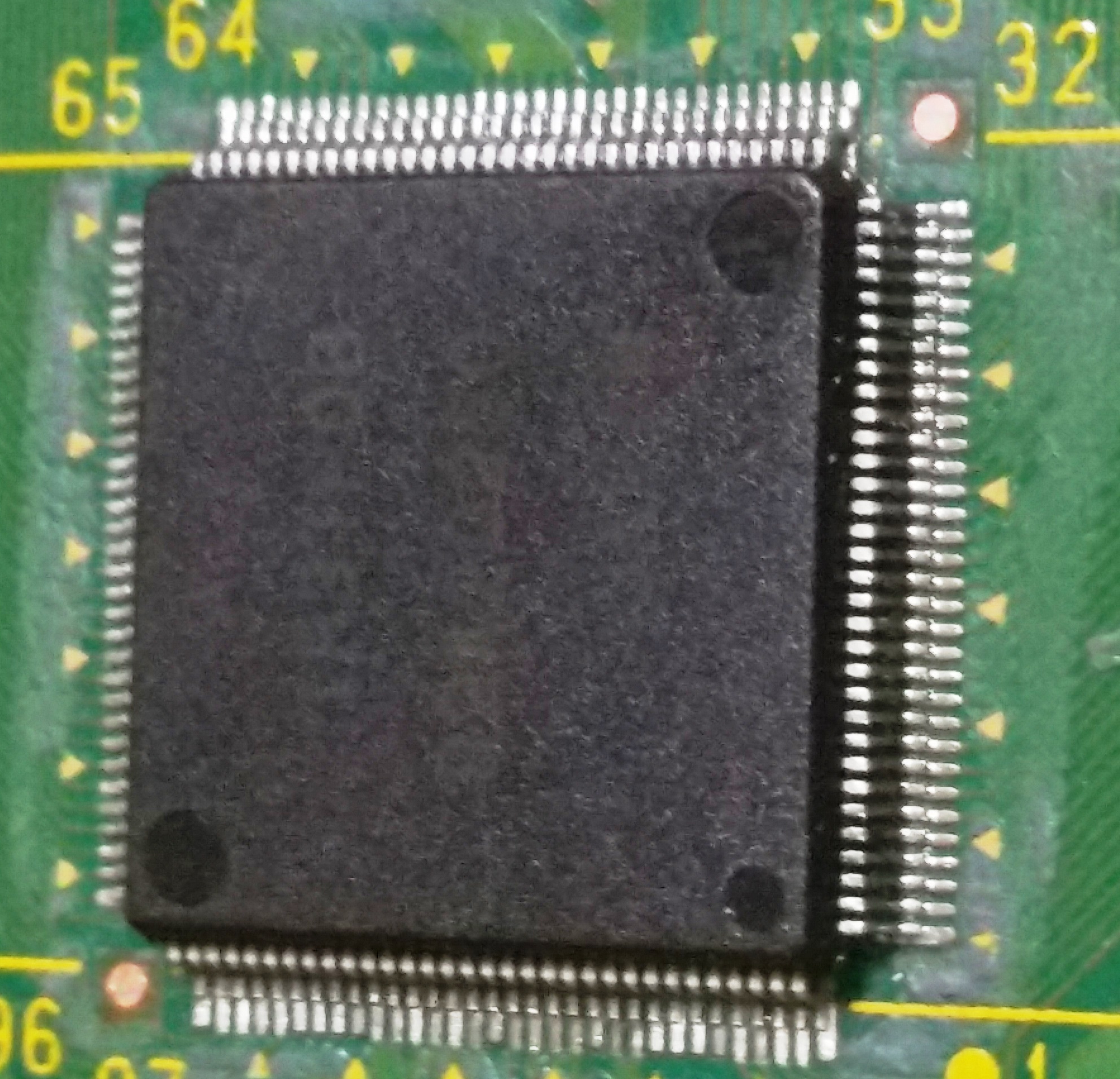

              Well the chips arrived today and I'm a little excited
              The board was pretty clean and ready for these so I got right into it.
              Hand soldered with plenty of flux and then a hit with the Hot Air. Some of the pins a smidge out but pretty good.
              Looked like it was soldered ok, belled out the outputs and all the pins looked good, resistance check was ok.
              time to fire it up, Hmmm. 7 blinks, recheck, 2 more goes, 7 blinks. Noticed the SC LED not lighting
              SC2 lead missing. Forgot I borrowed this for a board test in something else.
              Fixed that blunder, turned it on and running. Sweet!
              Run through the test patterns, perfect, no hint of any issues.
              3 minutes later, CLICK
              7 blinks. Nothing hot, no smoke, the IC replaced is fine but now the very first buffer IC on the SU, Toast, shorted outputs.
              So I know some of you have done some boards, have you had a similar experience?
              Am I about to replace these buffer ICs one by one on the same board?
              Otherwise , very happy getting the chip on.
              Only got 3 of these chips because i was unsure I could do it but I think I'll be getting some more so long as I get this board running.

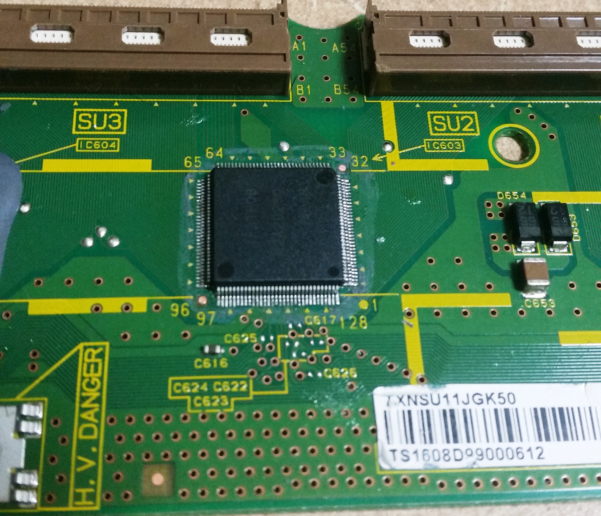

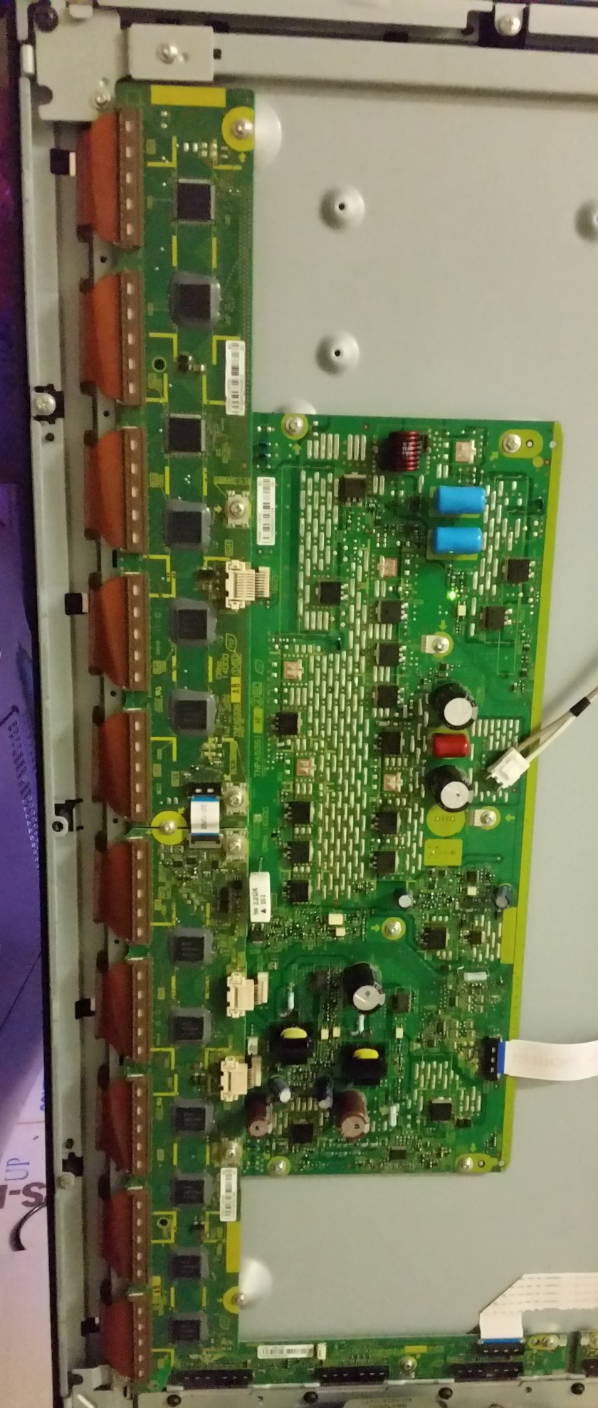

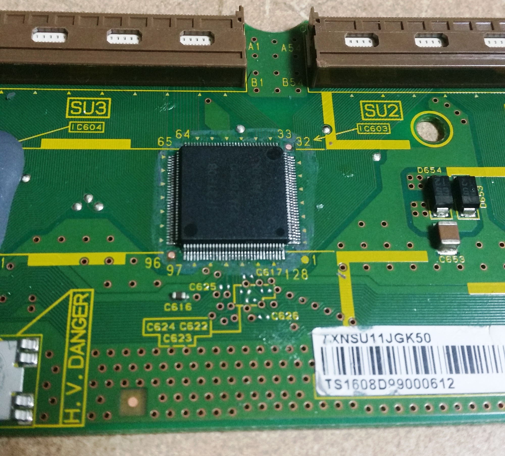

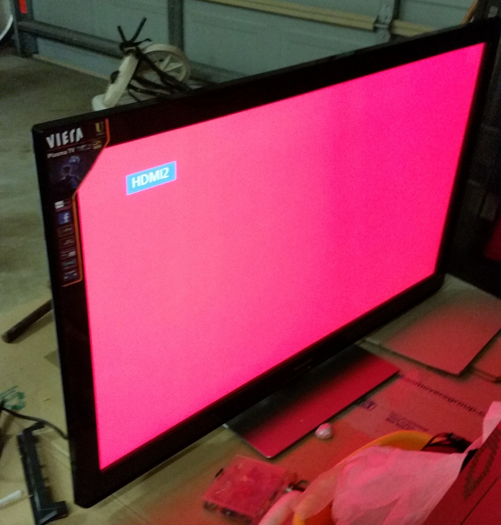

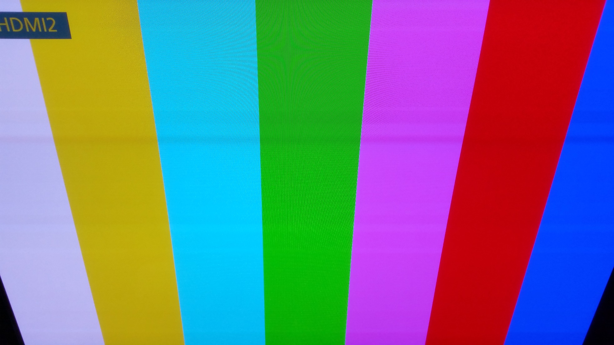

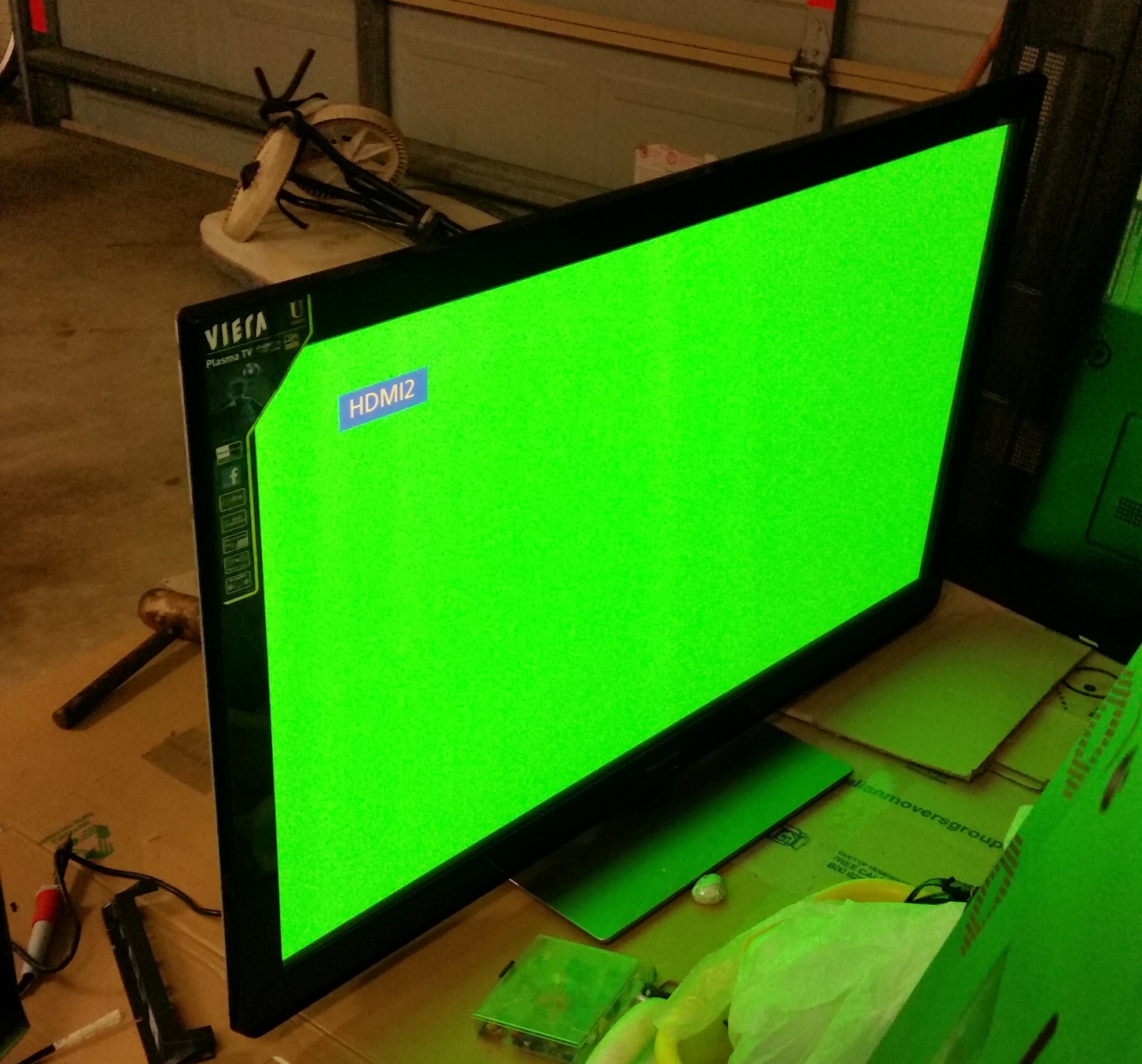

                Chapitre Deux - Panasonic Plasma SD, SU Buffer IC repair

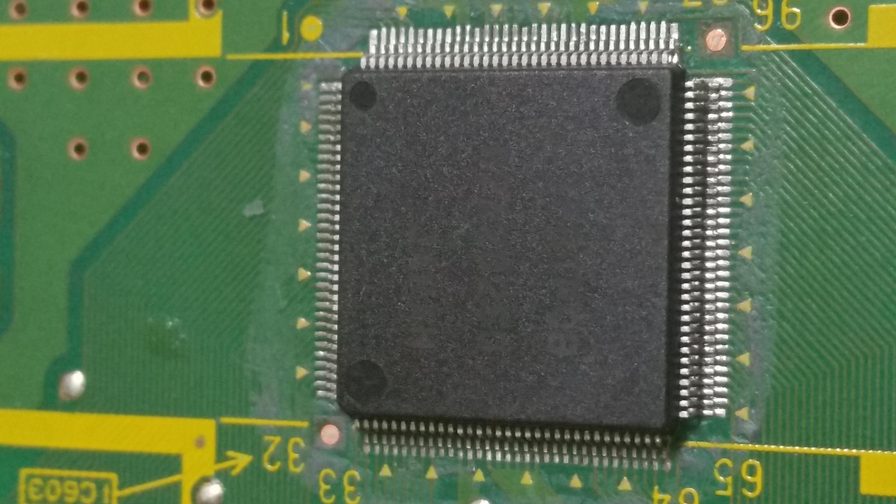

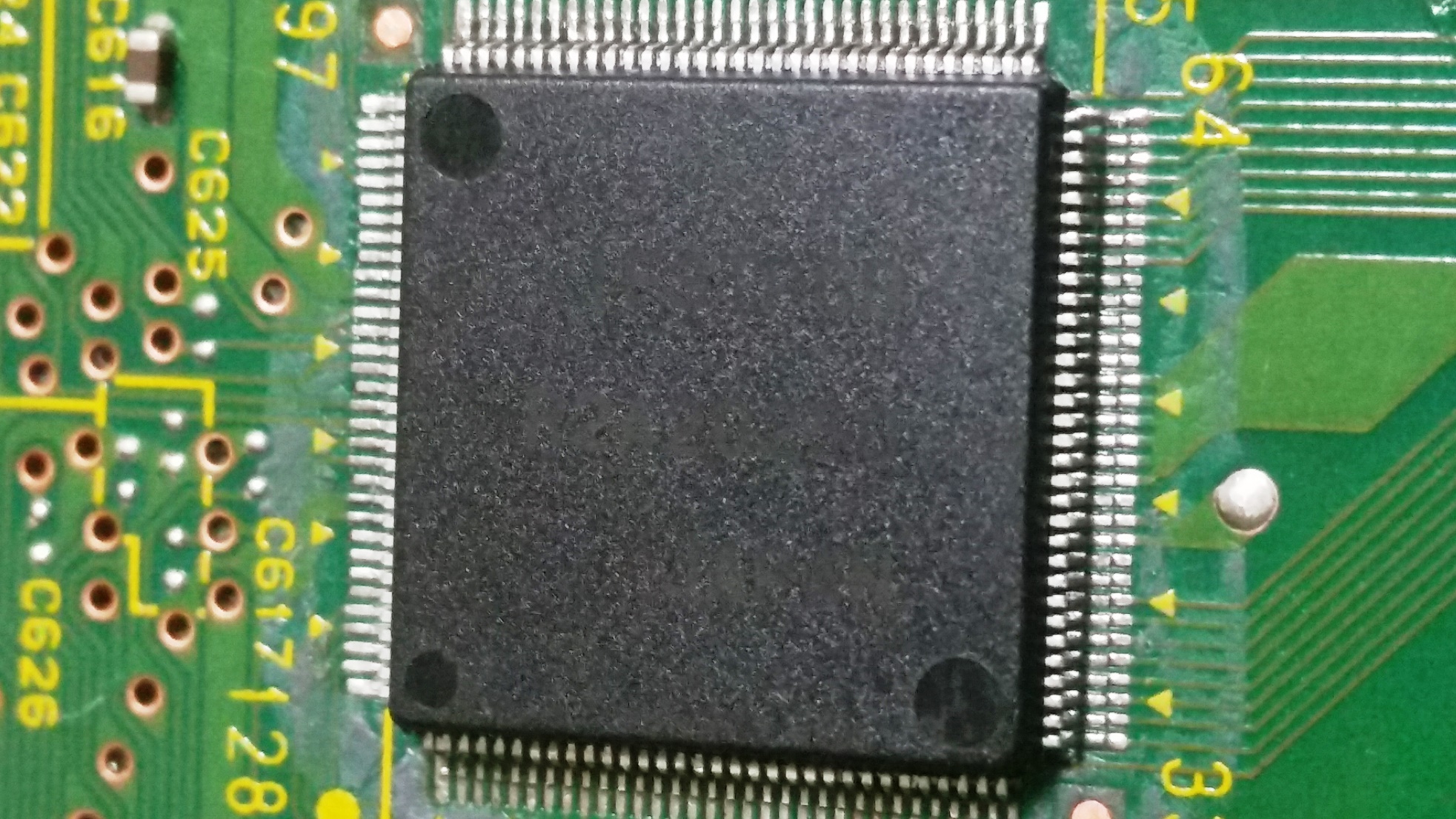

                SU board repair - chapitre deux
                Right then, take two
                These were the images I was about to post 2minutes 55secs into it's first run up.
                It's lasted about an hour now on full white and the only thing I've spotted is a tiny bit of maldischarge in the upper right area. I'll see how it goes and swap a known good board in to see if it's the SU.
                Interestingly the ST30 I recently fixed the SC had the exact same issue and I adjust Vsus down by less than a volt and it's gone. may do the same here.
                I got the ICs from e-best_trade and they look authentic and at this time $4.60 USD so it was about $24 AUD delivered for 3. I went conservative in case it was an epic fail but I think this is viable.
                I'm seeing in some cases $80-90 USD just for the SU board plus freight and exchange rates and for me potentially $200 for a set.

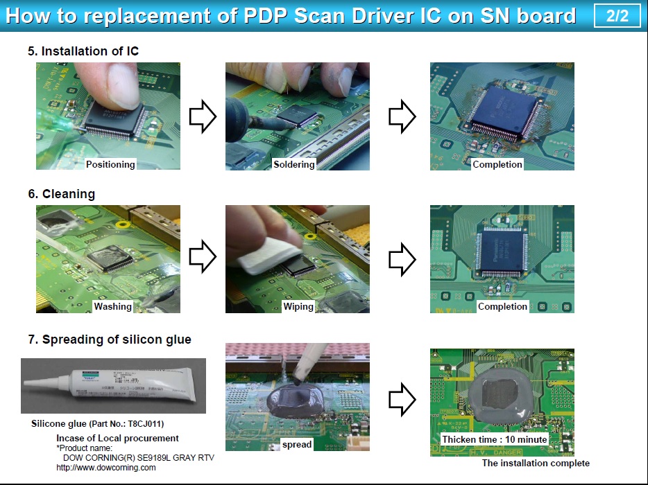

                    I found something in black from ACC silicones in a cartridge AS1821.
                    I'd love to have these looking original but if not then I want flowable self levelling, not paste.
                    I know you suggested RTV Grey auto gasket maker but it's too thick for my liking.
