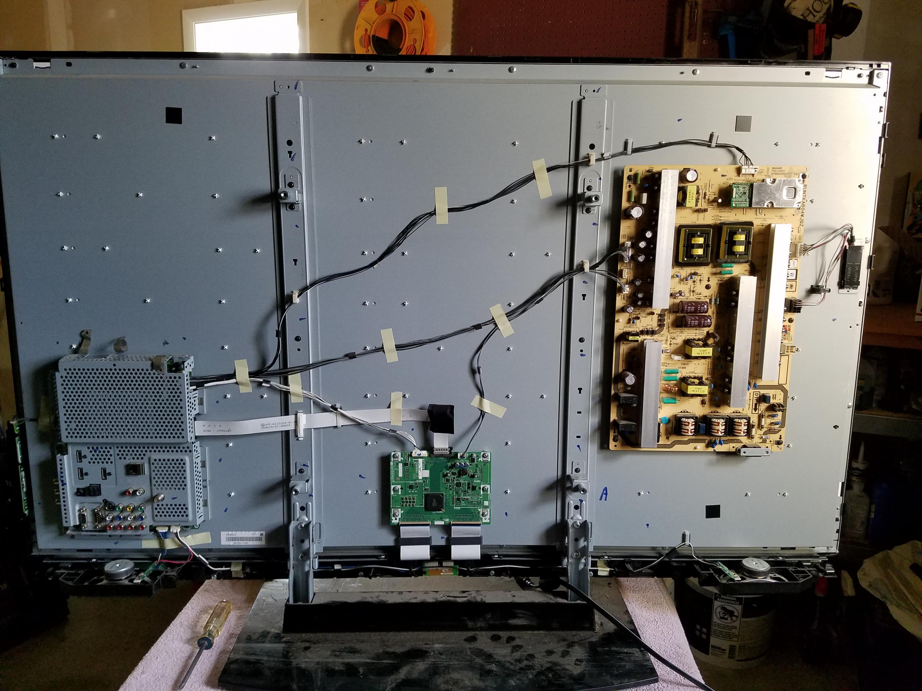

    I received a tv with no history known. The tv will power on and the backlights will turn on. There is no display and no sound. Not even a logo or menu will display. I tried the input and volume down reset. The blue V will turn on at the bottom of the unit, however, there is no other change to the tv. I hooked up a rca cable connected to a controller with built in games to try to get anything. Obviously I can not determine what input I am on. I have tried to move through the inputs but no results. Next, I connected my phone by hdmi cable. With the tv off the phone will recognize all hdmi ports. With the tv on it will not recognize any hdmi ports. I was thinking a bad PCB board or logic lock. I unhooked the ribbon to the t-con board and the power and optical light will flash indicating some self diagnostic is still possible by the tv.
    I have been shocked by TV's. I am a little gun shy about power testing. Any thoughts?

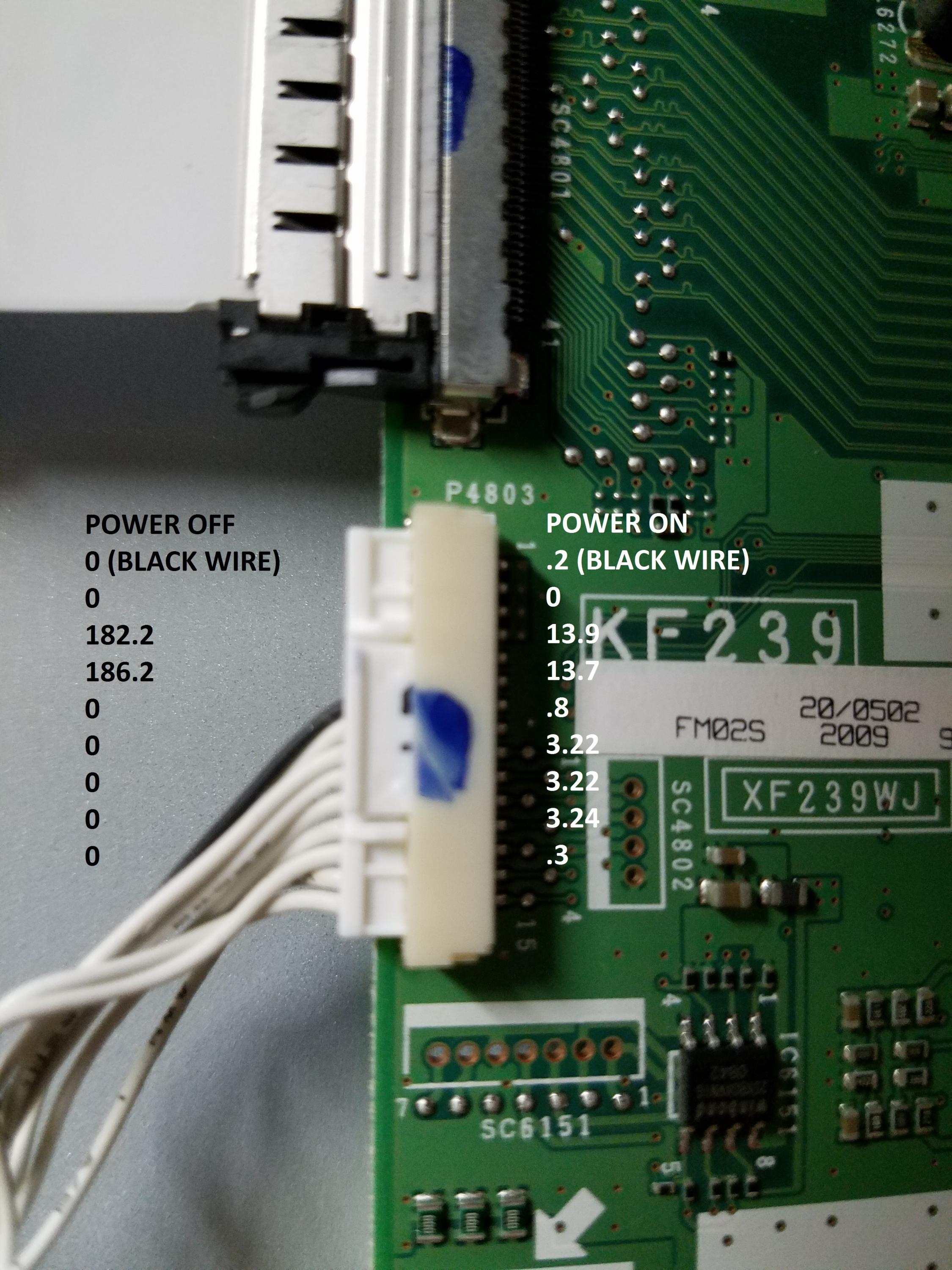

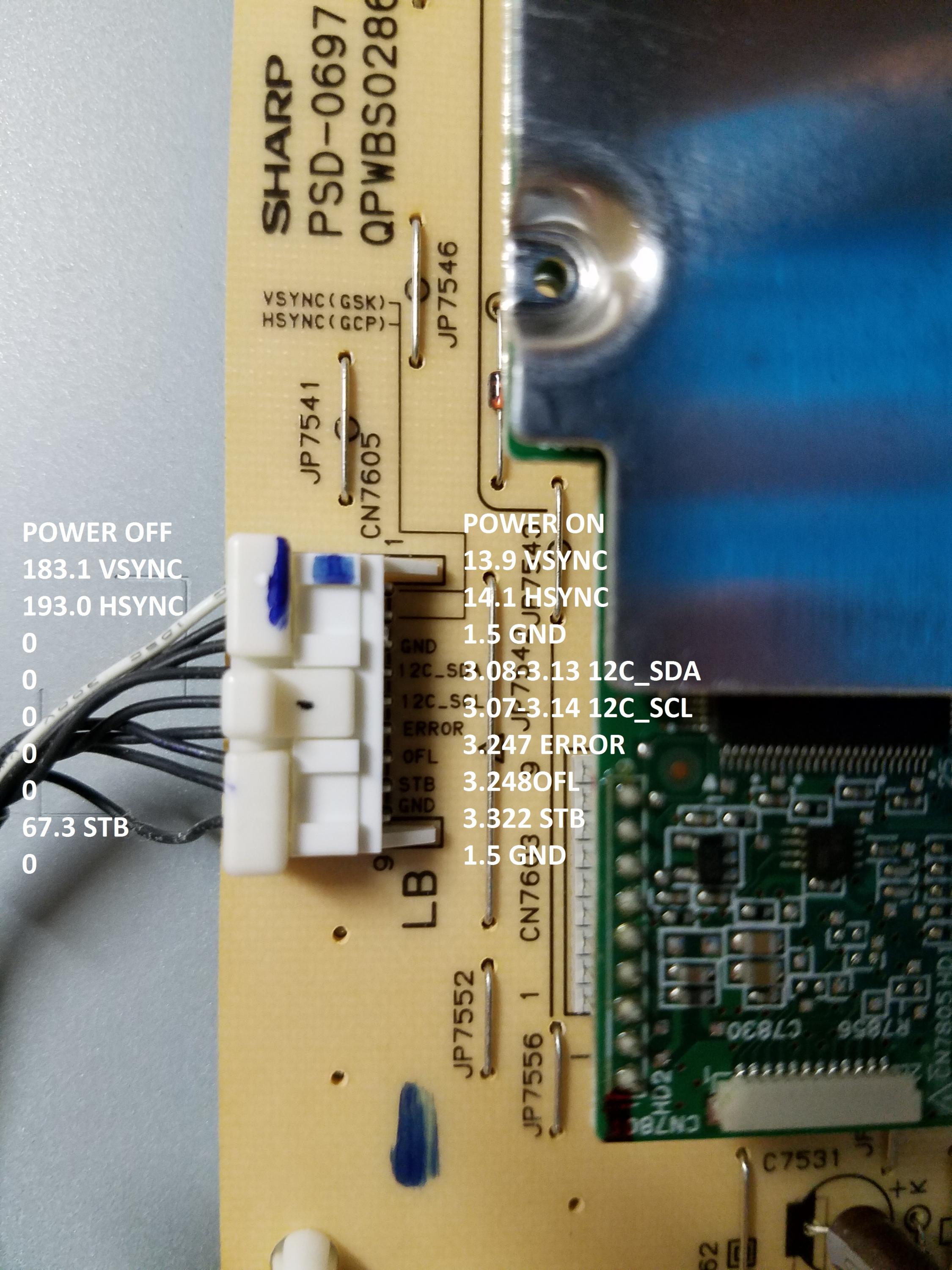

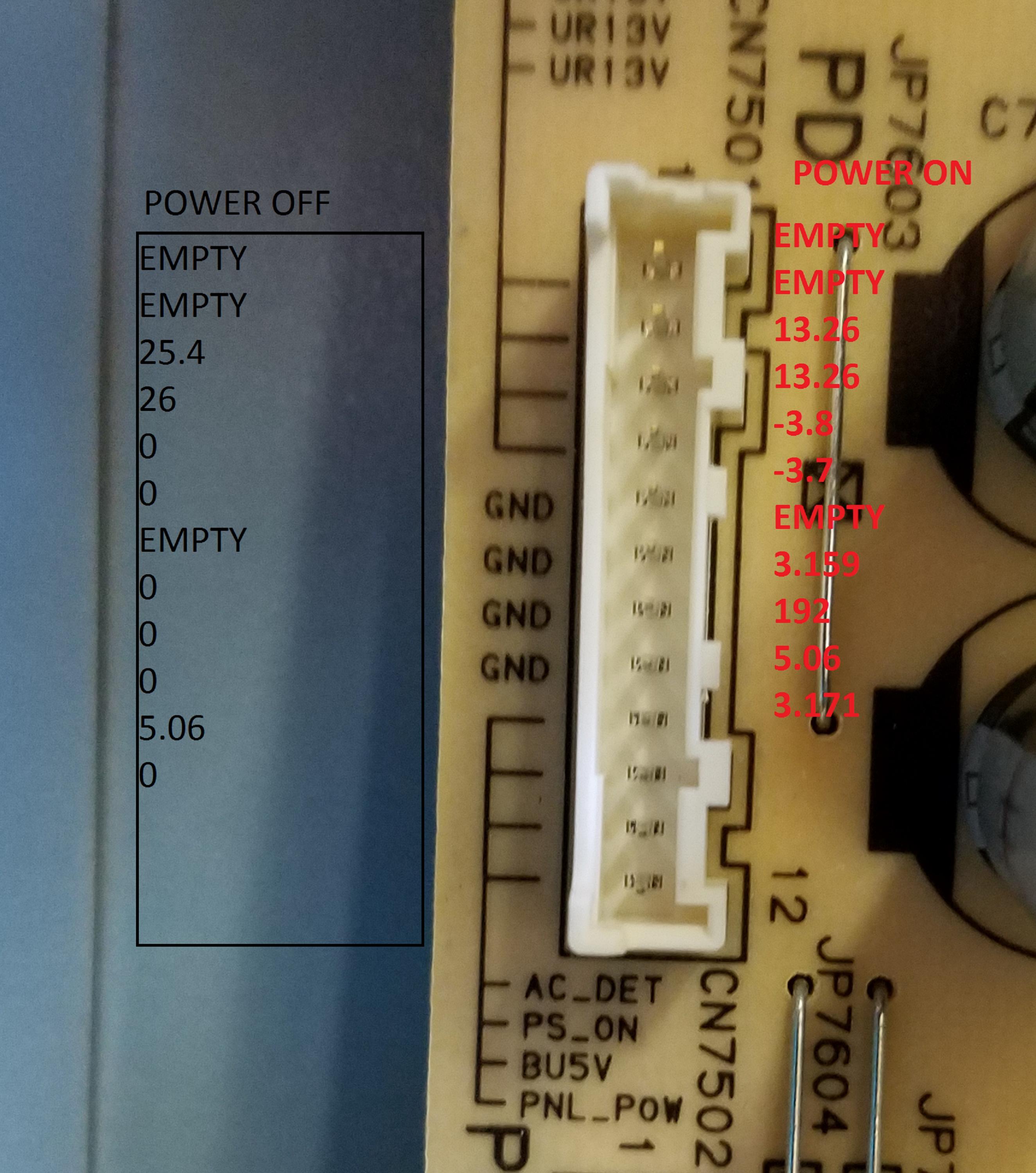

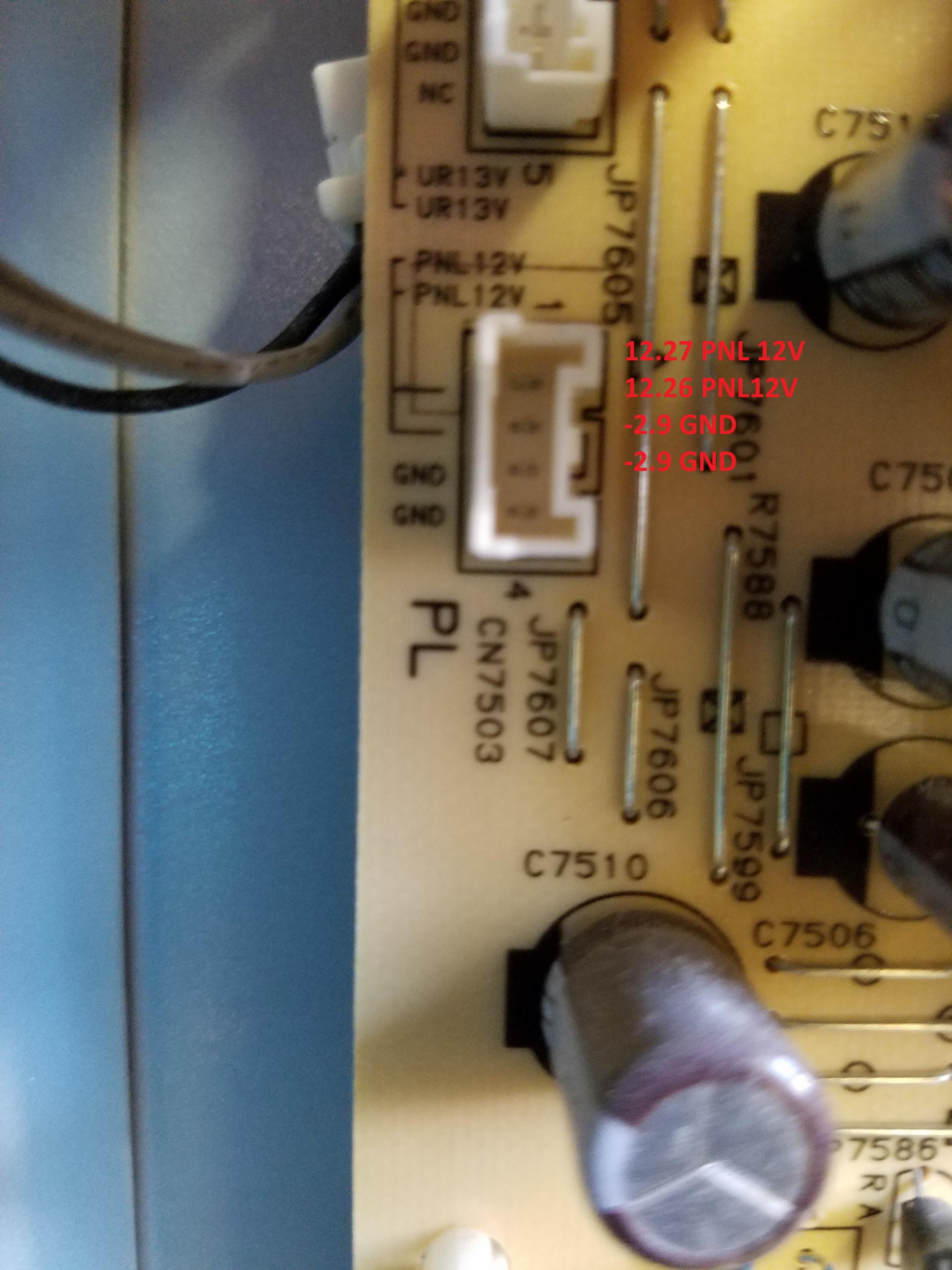

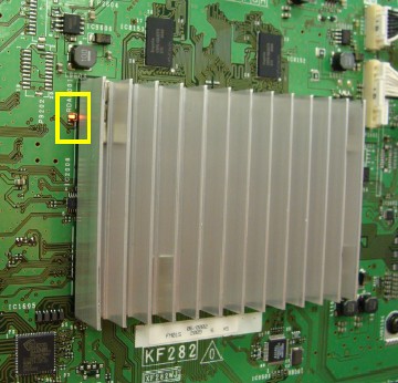

                  Here are the voltages. Picture one should be the power to input board. Picture two should be power to t-con board. Picture 3 is another power to input board. Picture 4 is the connector on the t-con from the input board.

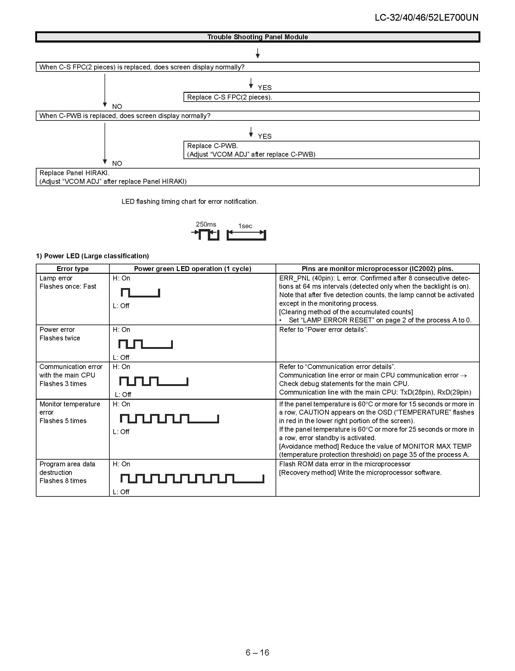

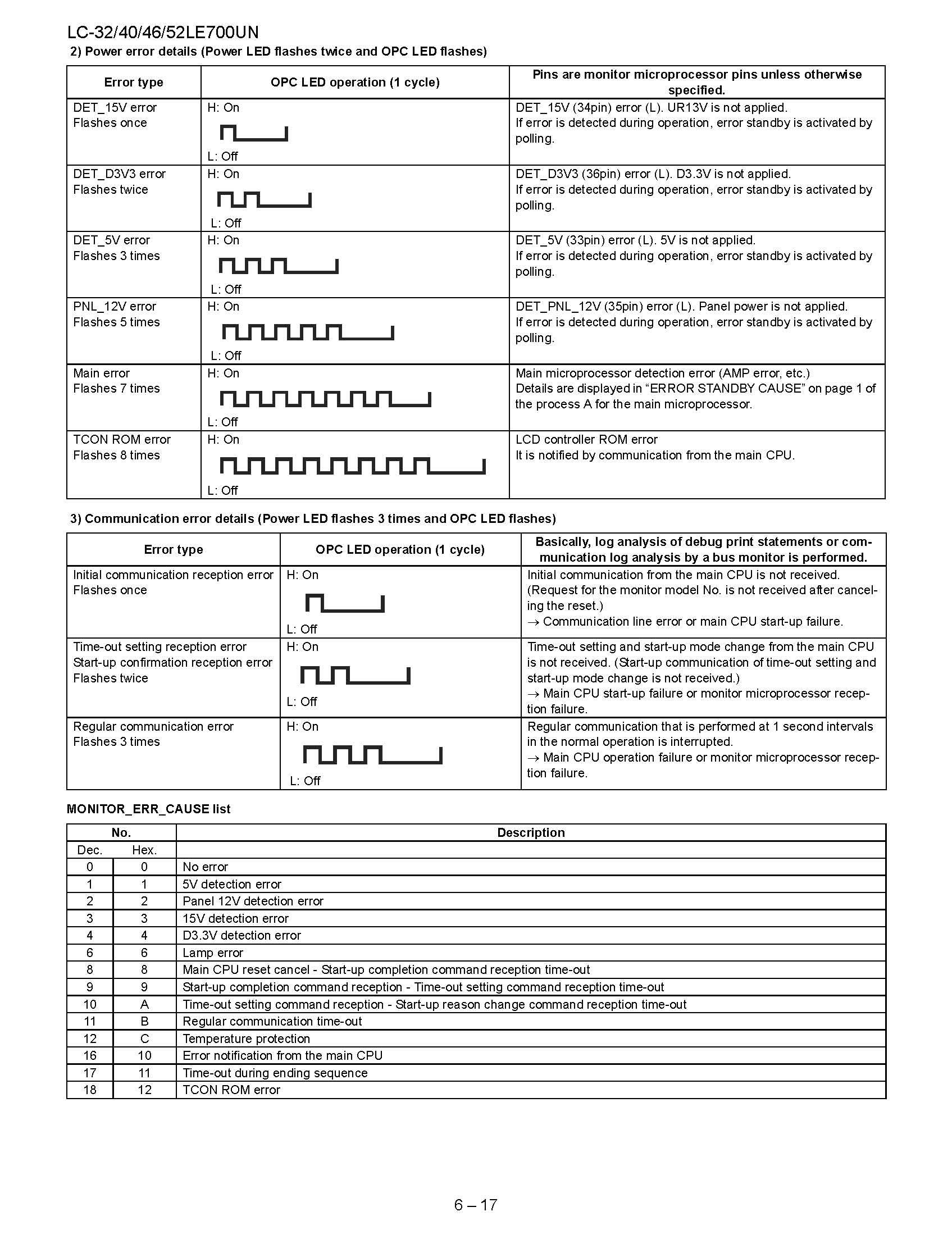

                    This is the most service information I can find but it still doesn't have voltage references.
                    • johns1mj
                      • May 2015
                      • 242
                      Re: Sharp Aquos LC-52LE700UN No Sound No Picture
                      I think I found my voltage references on page 8-2.

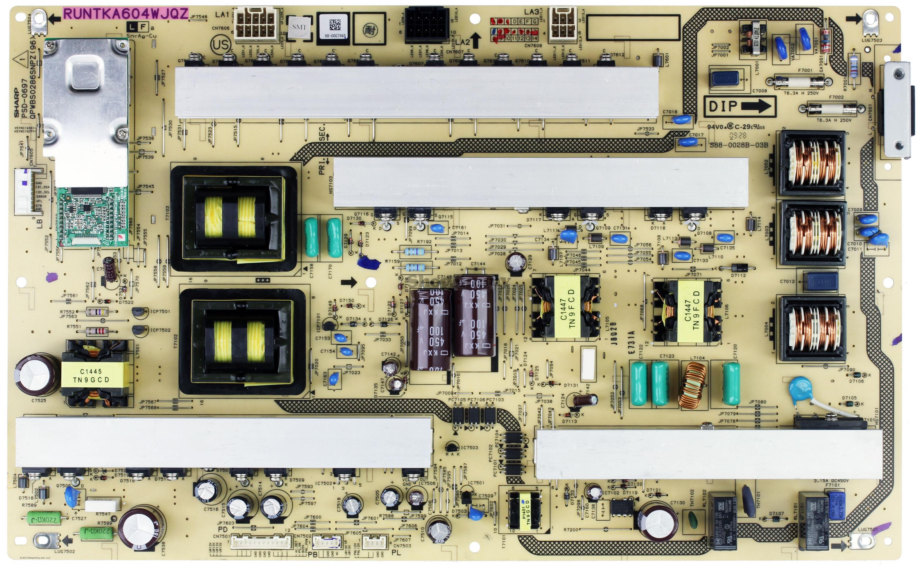

                        What are using for the GND ref point for the meter? Your reports showing Voltages on the GND pins, it has to be measurement error, and some of the readings also show in 100's of Volt! which cannot not be right.
                        For example:
                        https://www.badcaps.net/forum/attach...4&d=1462757515
                        PS-ON pin 10 is shown as 192 Volt?

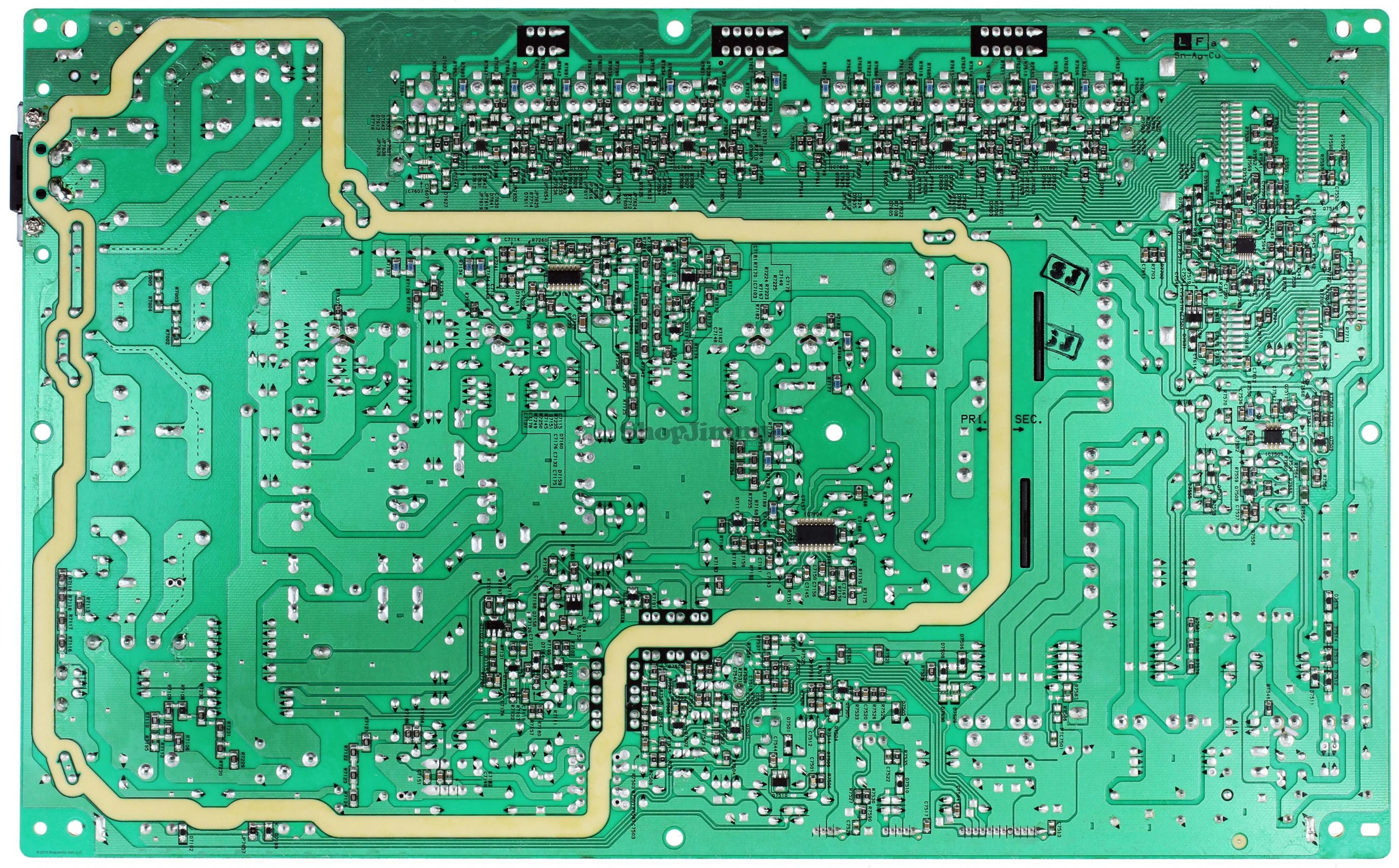

                        Sharp RUNTKA604WJQZ (PSD-0697, QPWBS0286SNPZ(96)) Power Supply
                        http://www.shopjimmy.com/sharp-runtk...er-supply.htm#
                        Pictures provided by shopjimmy.

                            Does the "heart beat indicator" blinks

                              budm
                              I was using the tv chassis with an alligator clip. I was testing on dc with the measurement on auto. After reading your question I suppose it might have been ideal to have written down if it was measuring volts or millivolts. I will need to recheck the voltages in volts only.
                              Also, no there is no error code flashed. It will also time out like when no input is detected.

                                Kilroys
                                Yes, the heart beat indicator blinks just over a second each time.
                                  If you check the resistance between the GND pins of the connector and the chassis, it should all show <1 Ohm, if not you may have loose board mounting screws, or your alligator clips/wire has problem.

                                    • johns1mj
                                      • May 2015
                                      • 242
                                      pin 10 is 1.916 V when I adjust the meter.
                                      it doesn't appear to be a ground issue.
                                        If it blinks it means that the mainboard is ok
                                        You have tried “VOL (–)” and “INPUT” keys at a time,
                                        and plug in the AC cord of the main unit to turn on the power.
                                        Sure you got the right keys on the front ? Nothing.
                                        Try this "channel DOWN and volume UP" and plug in the AC cord of the main unit to turn on the power.
                                        Software problem ?
