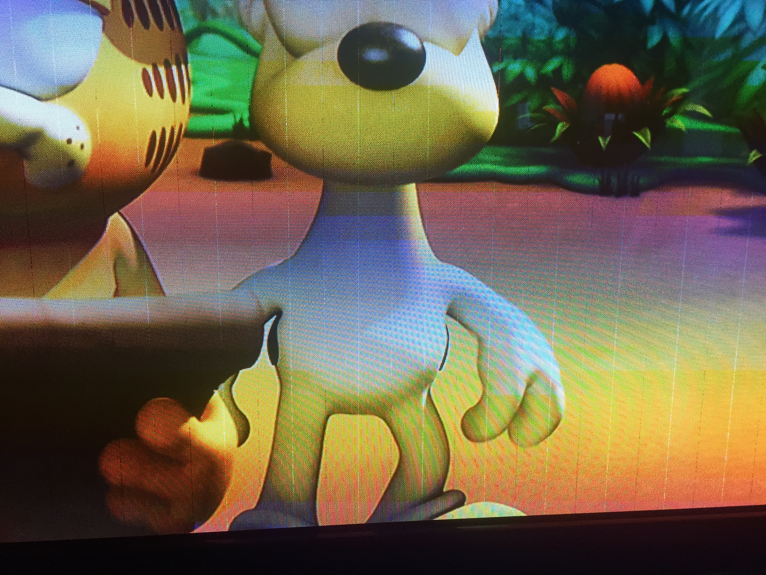

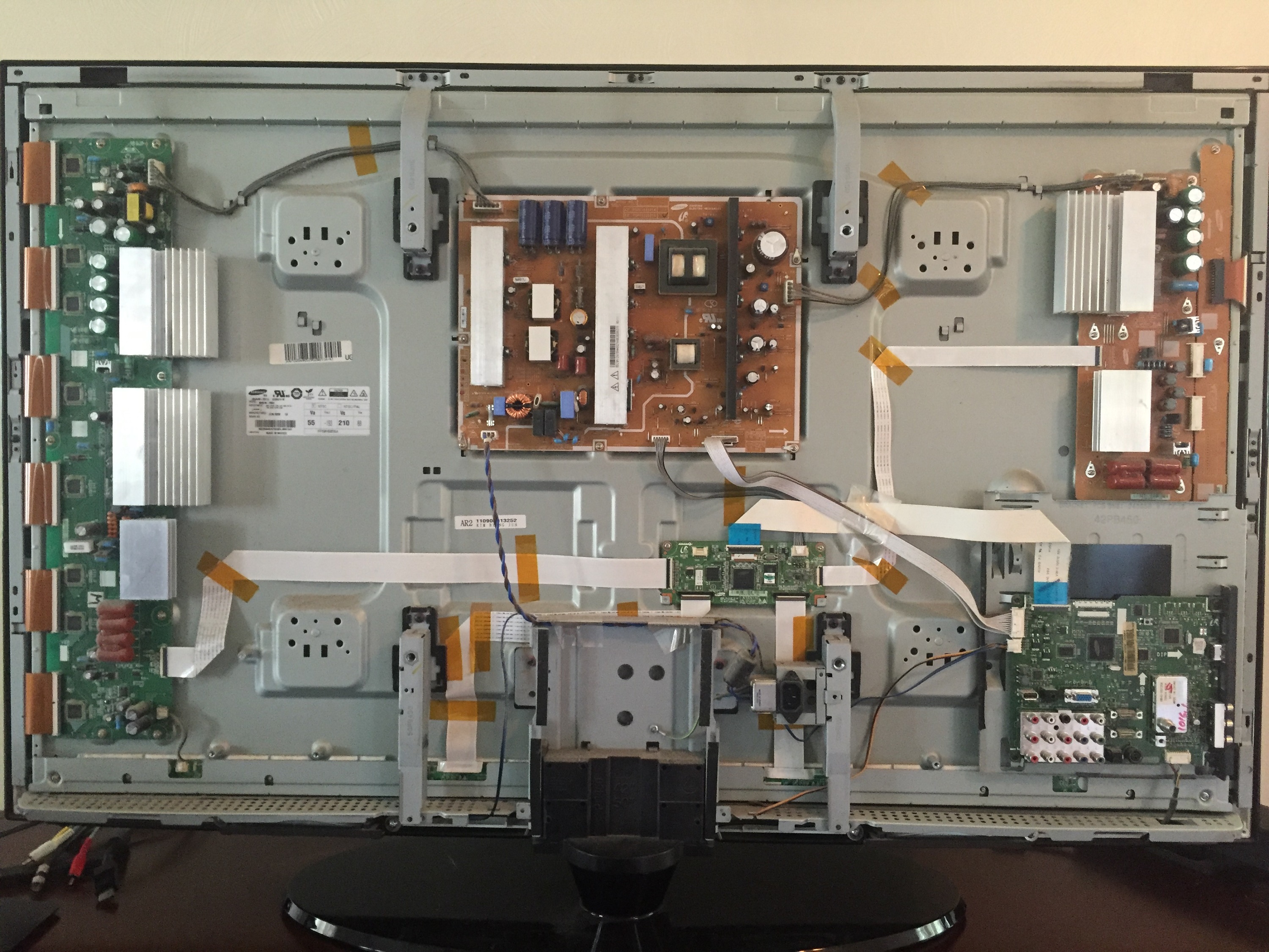

    My TV started showing evenly spaced, vertical lines across the entire width of the display. Just eyeballing it, I would say the lines are about 1 inch apart and 1 pixel wide. They are always in the same place, appear stationary, and appear over the top of the TV menu. They also appear on all inputs. When looked at against a lighter colored background, they alternate between a subtle green and subtle red.

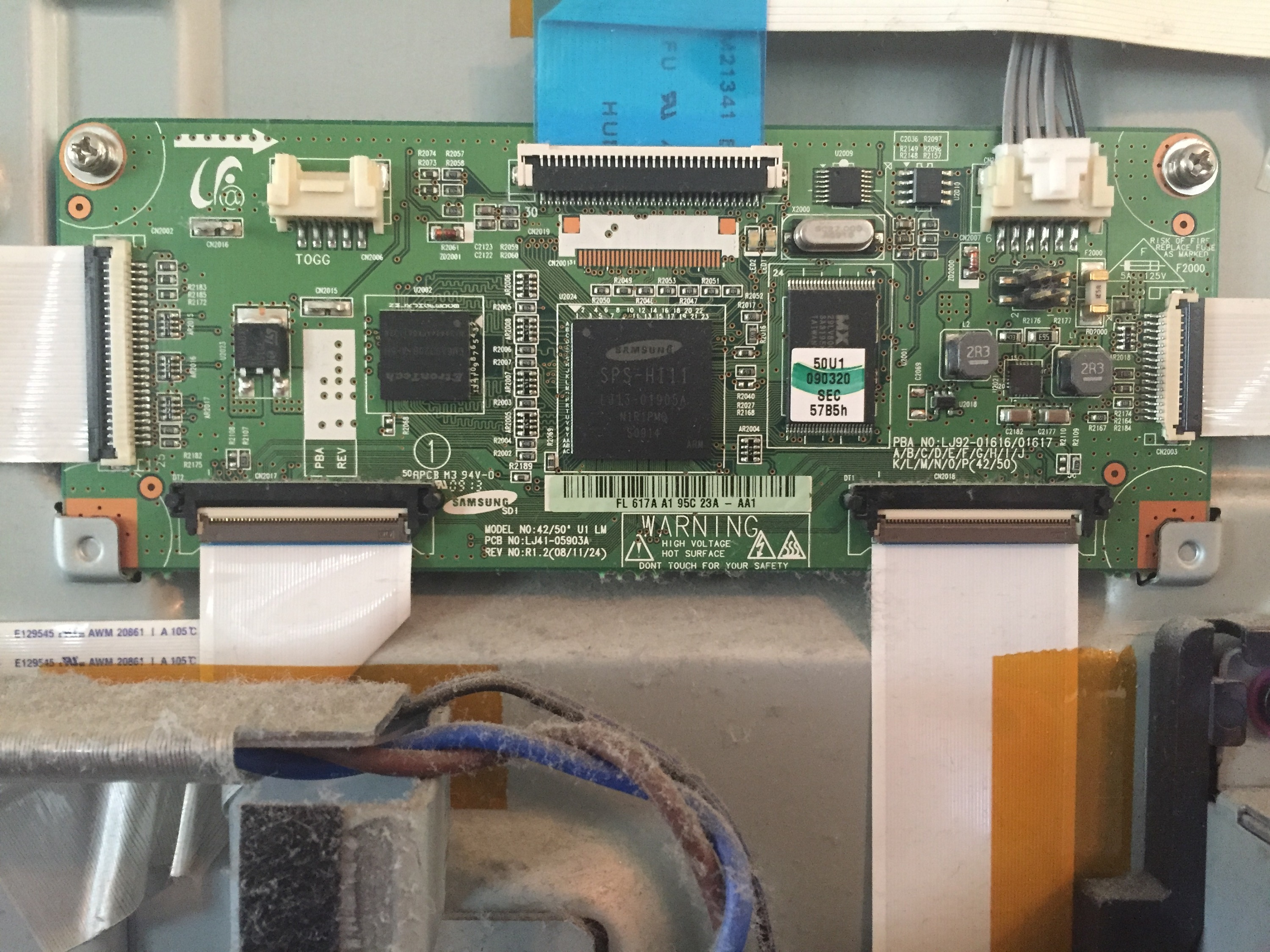

    I've referenced a post from "capkid" that point to the logic control board. I've taken a picture of the TV with the back off and a zoomed in picture of what I think is the logic control board. Any help would be awesome! Thanks!

    I'd be thinking along the same line it sounds like it.
    LJ92-01617A

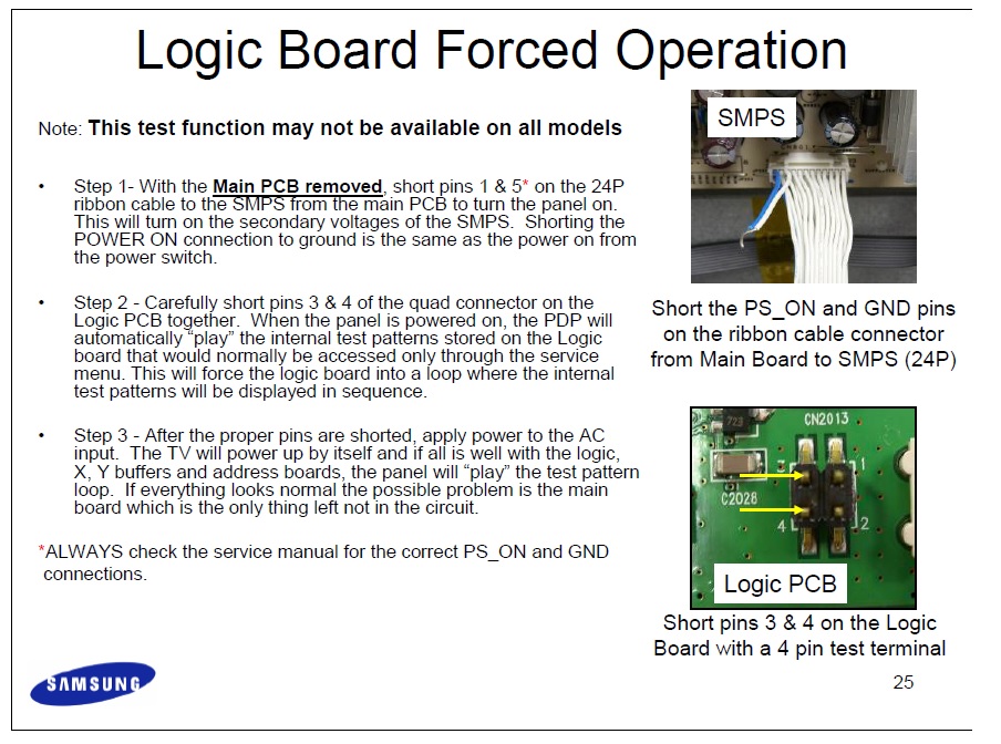

    There is a procedure to isolate the main board, jumper the logic ctrl bd test pattern generator, I think the PSU also needs to be jumpered to turn on at plugin.
    Was there any mention of that in the other thread? If the lines were still there running just off the Logic board that would confirm that's the issue.
      Re: Samsung PN50B450B1D showing evenly spaced vertical lines
      something like this, you don't have to remove the main board, just need to disconnect the power and LVDS cables.

        I've also attached a picture of the image produced on the screen. The lighter colored lines are more apparent, but if you look closely, you'll see the darker (reddish) lines in between each set of lighter colored lines.

          I'll give this a try! As an aside, about how long does it take the capacitors to discharge so I don't end up frying myself?

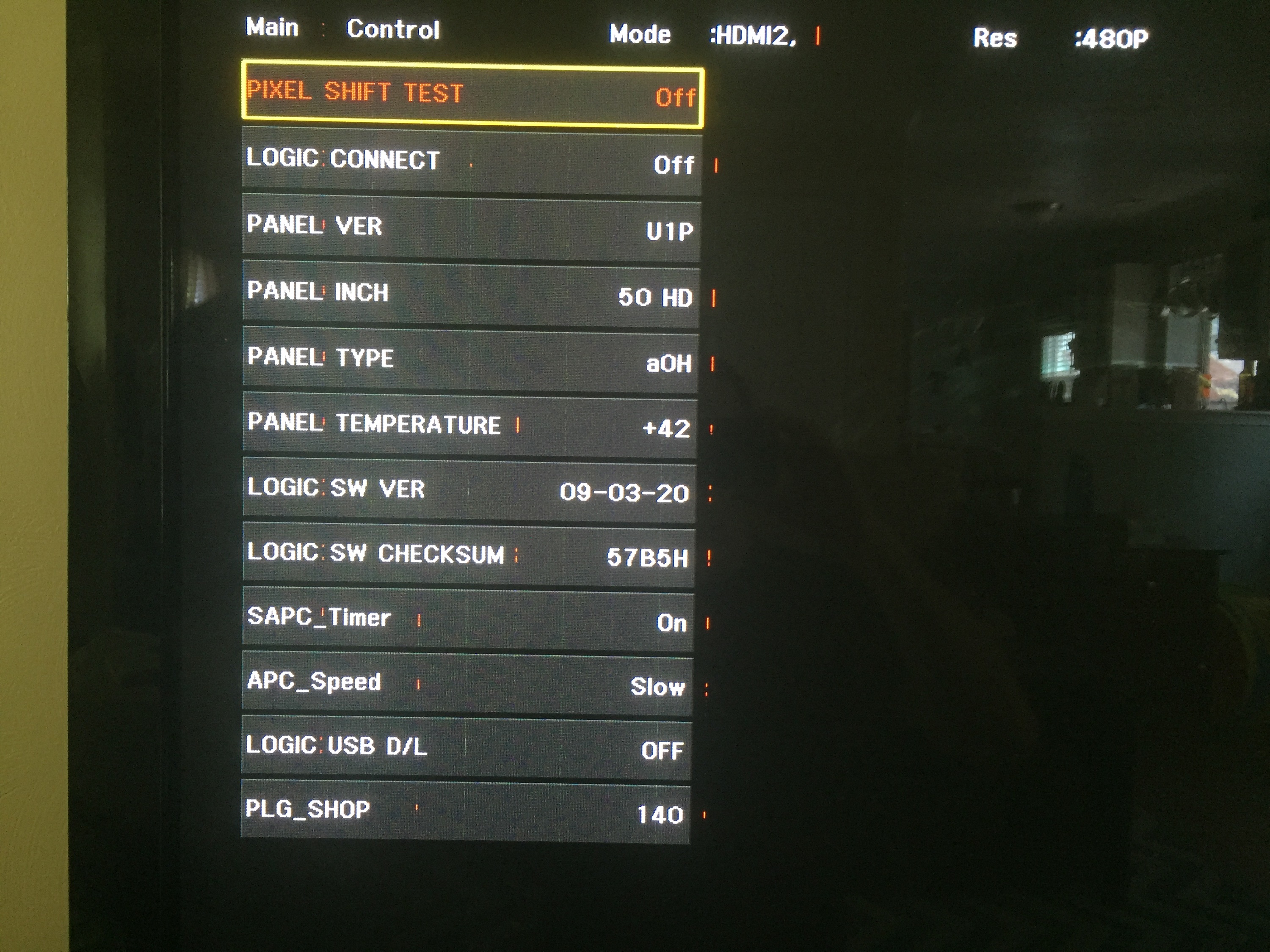

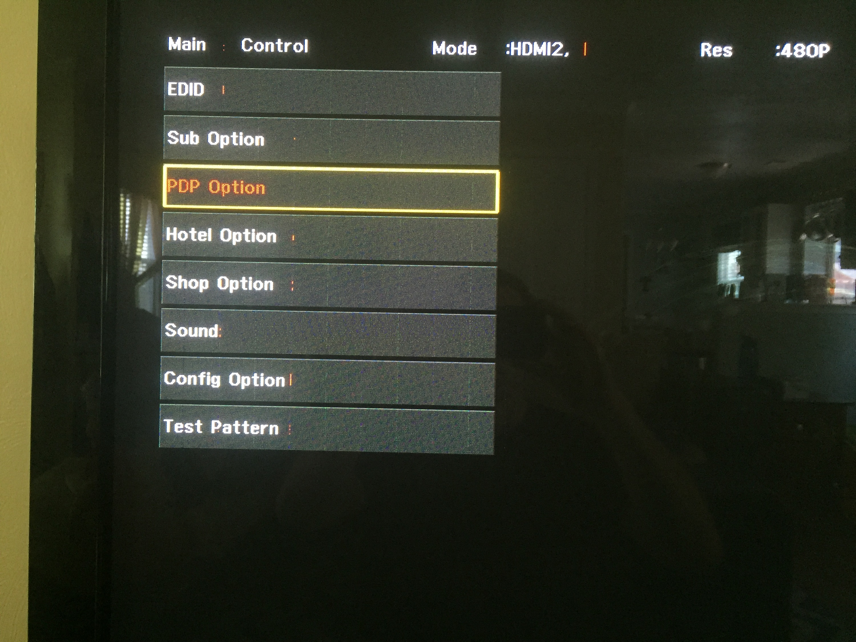

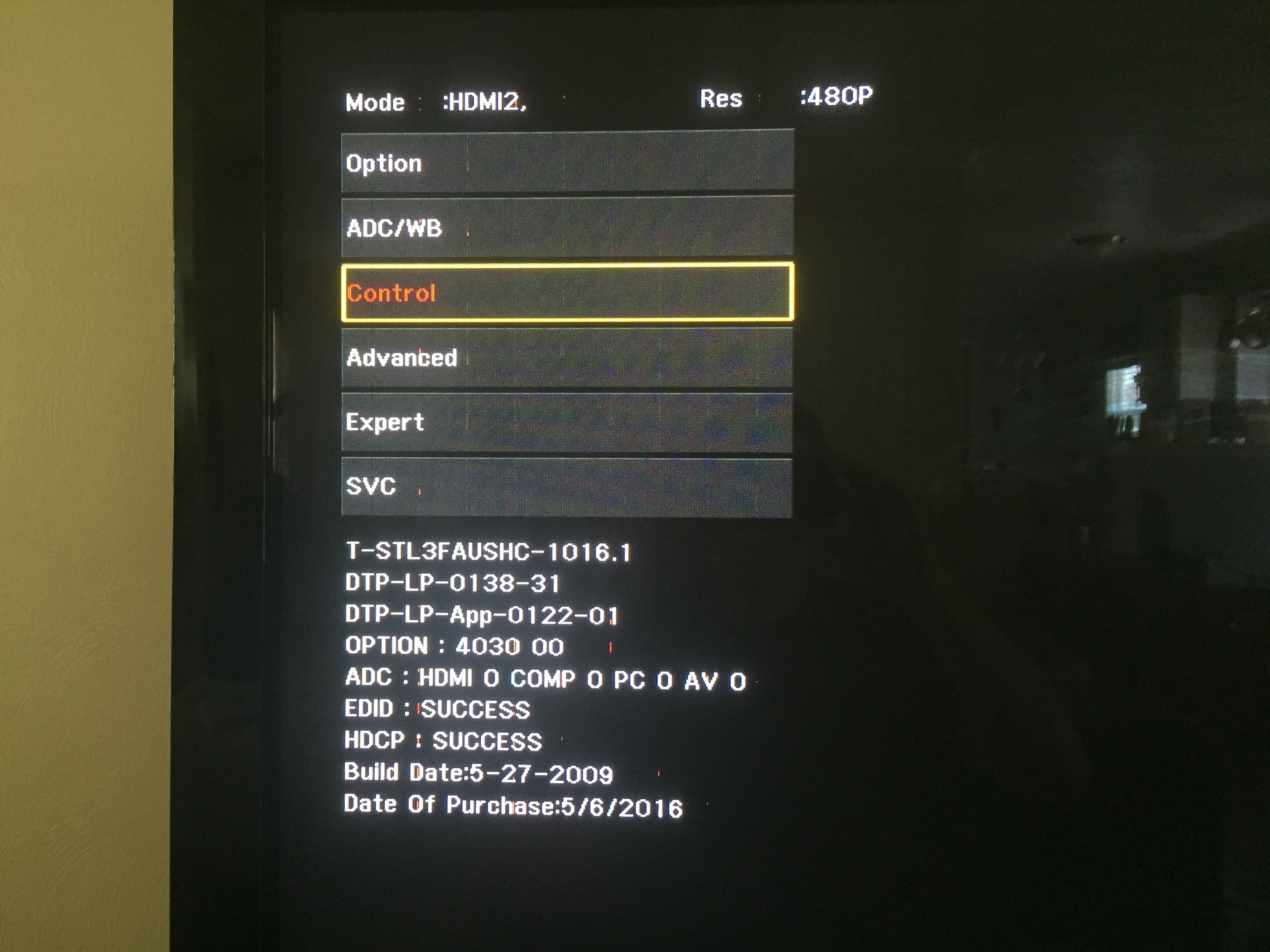

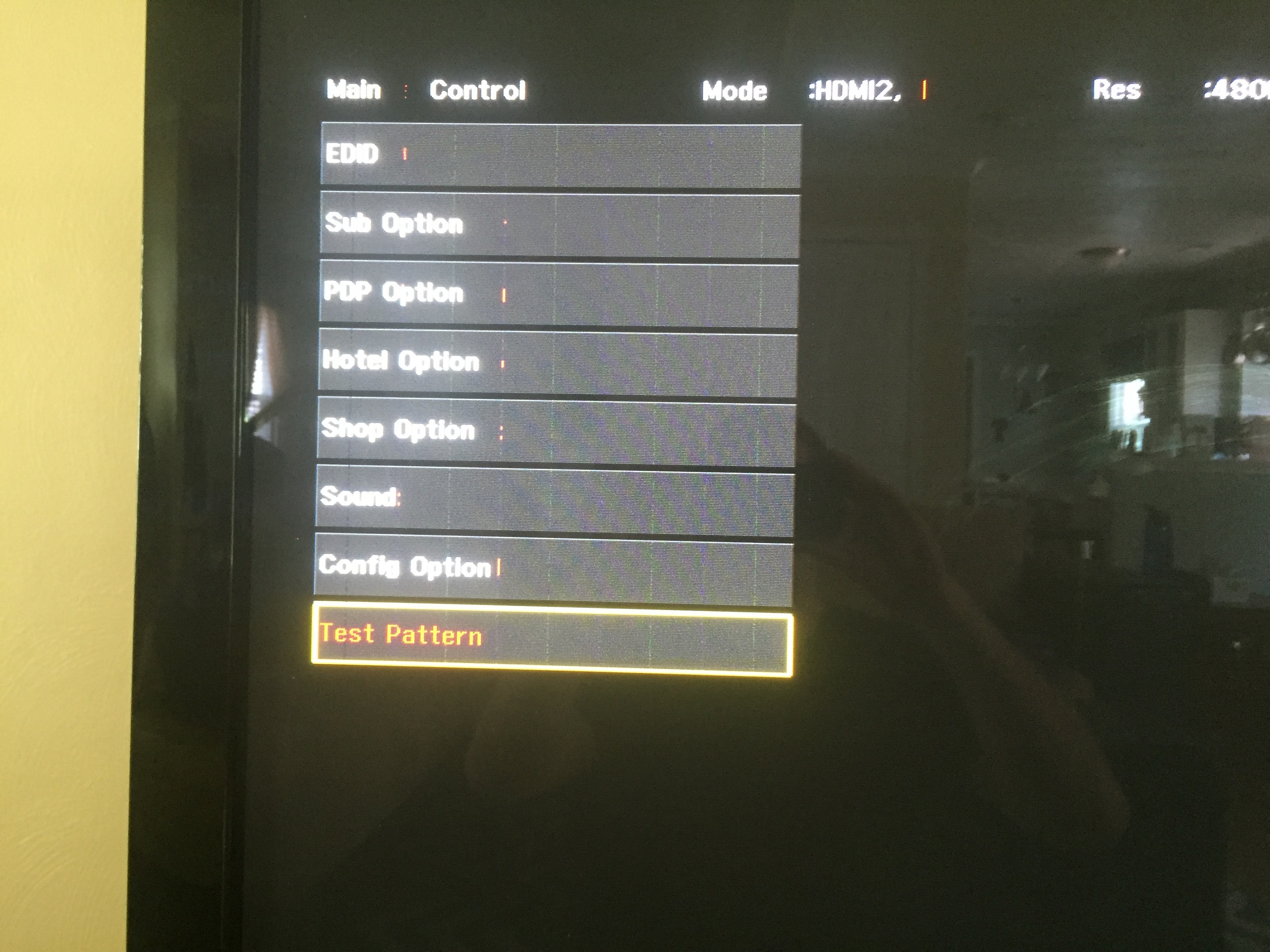

            I followed the instructions in the powerpoint. The menus and options on my TV were different then the powerpoint. Attached is what I found.
            Control -> PDP Option -> and no way to get to the test pattern.

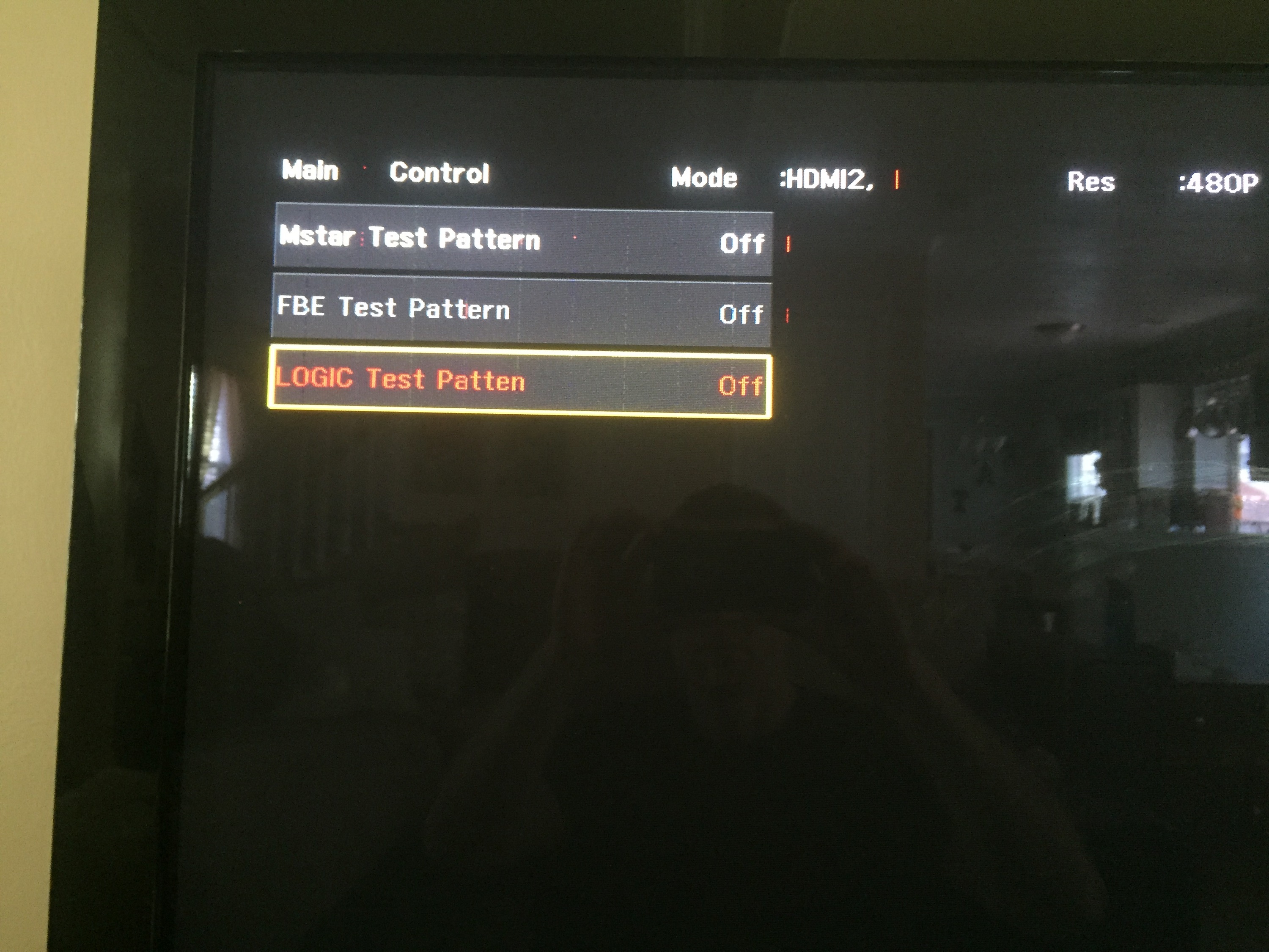

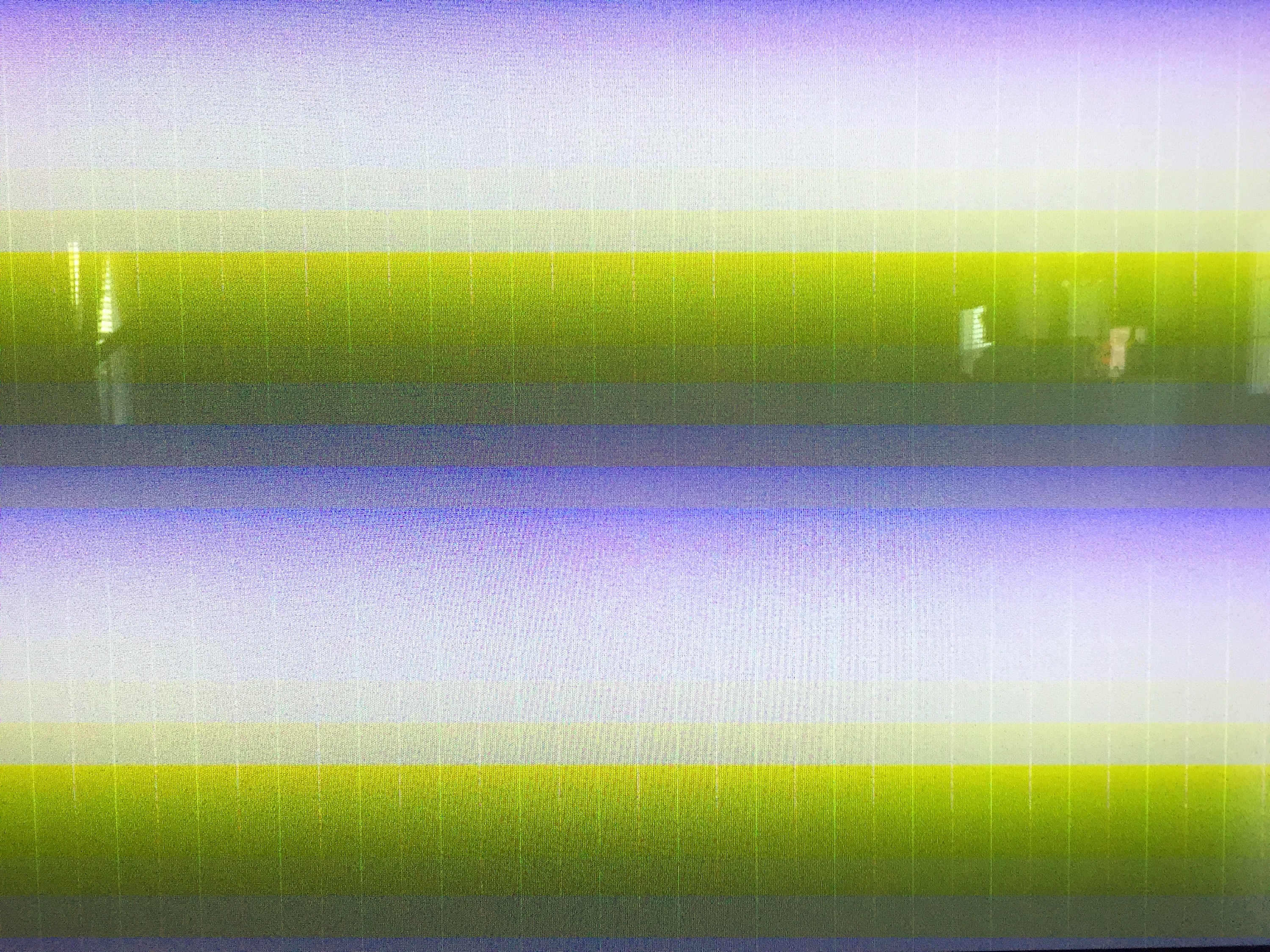

            Going back to Control -> Test Pattern -> I'm able to get either the Master of LOGIC test patterns. The lines appear on both test patterns (I included one from the LOGIC pattern test. The horizontal bars are just distortion from the camera. It actually appears as a solid grey screen with the red and green lines as previously discussed.)
            Since lines are present, does the LOGIC test show there is a problem with the logic control board, or is more troubleshooting required; ie, disconnect power and LVDS cables?

              I'd say logic board BGA chip letting go. Did you try heating the logic board with a hairdryer to see if it chances?
                In case it wasn't clear, the section of my message quoted above should read "I'm able to get either the Master OR LOGIC test patterns.

                  ***FIXED!!*** It was the logic control board...a $15 part! Thanks for all the help.
