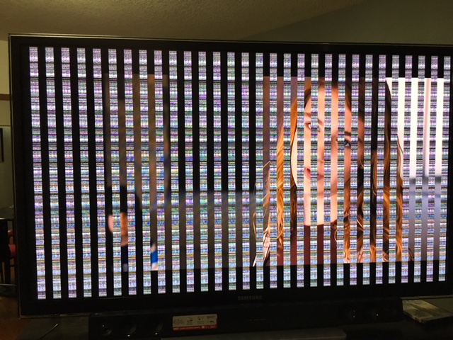

Samsung PN50B450B1D showing evenly spaced vertical lines
  • 205rogers
    • Oct 2018
    • 3

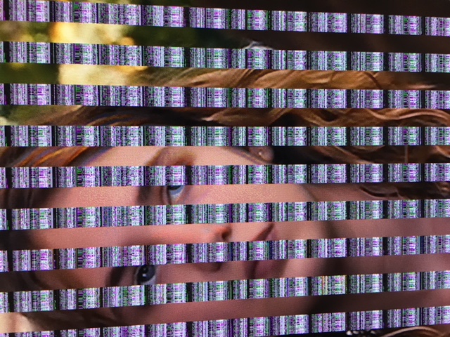

    When I first turn my TV on, it works fine for a few minutes and then the attached vertical lines show up across the screen. If i turn it off and back on same thing, works for a few minutes then the lines come back.
    I have read other posts about the T-con PWB. Not sure if thats the problem with mine or not. Hoping to get some advice. Thanks
  • tvtimmy
    • Mar 2015
    • 1160
    • usa
    Re: Samsung PN50B450B1D showing evenly spaced vertical lines
    Do the lines cut through the menu box when menu button is pressed?
    • 205rogers
      • Oct 2018
      • 3
      Yes. They are always there.
      • tvtimmy
        • Mar 2015
        • 1160
        • usa
        Ok. Remove the ldvs cable that goes from the mainboard to the control board. Its usually a flat wire. On the control board there is 4 pins. Take a harddrive jumper( for choosing master, slave, etc.) and put it on pins 3 and 4. Plug tv in and look at the test patterns on the screen. If they look good your mainboard is bad.
