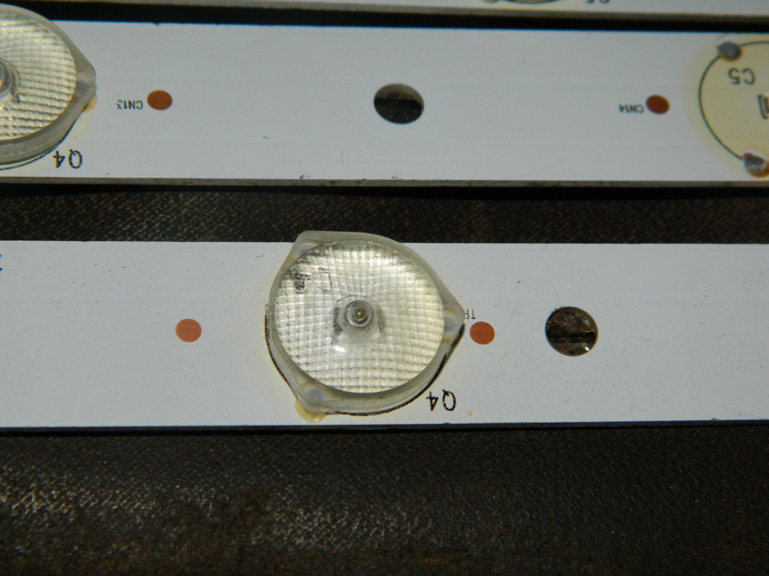

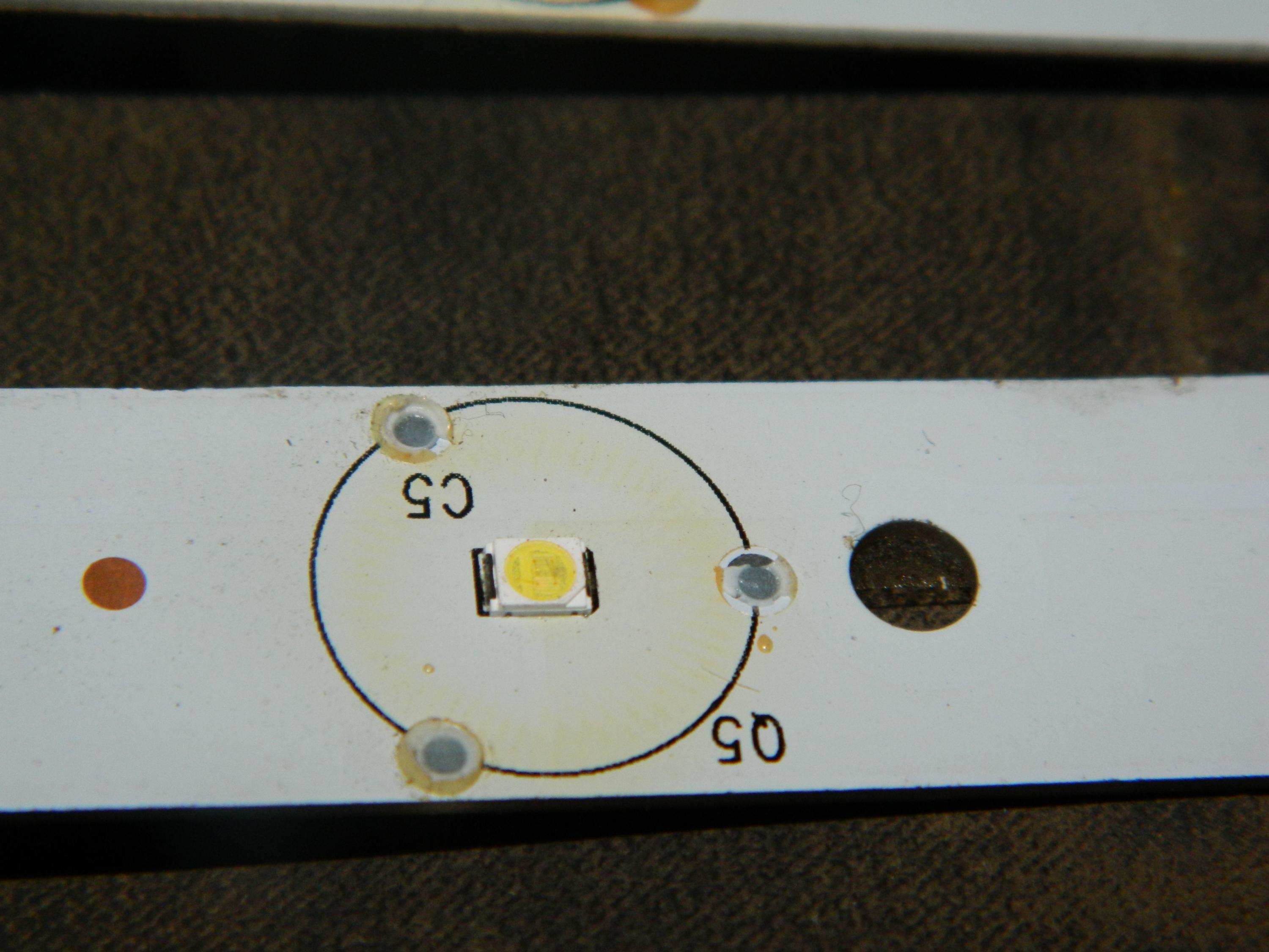

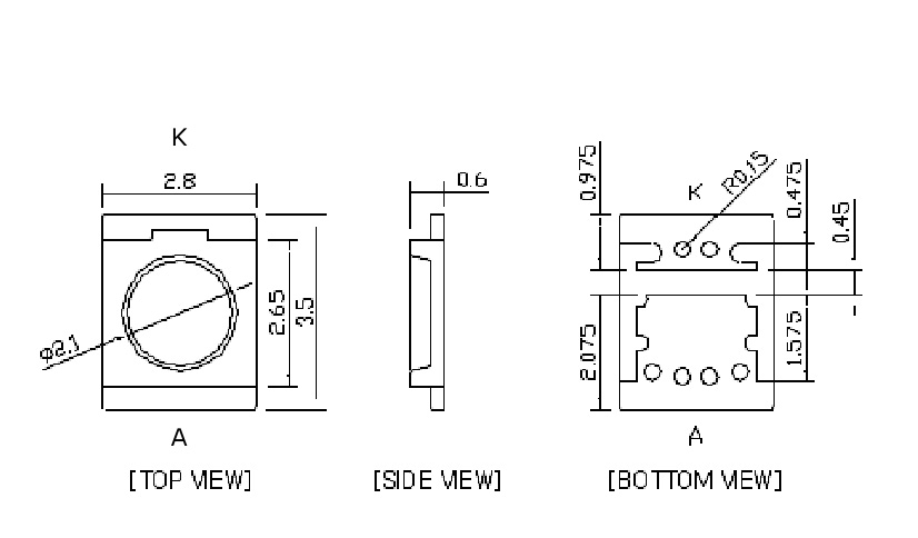

    I have a Vizio E470i-A0 that has two blown LEDs in the backlight strips. I am looking for a source for just the LEDs (not the strips). The size of the LEDs on this panel are ~ 3.5mm X 2.8mm X 0.65mm. They come in a package like that shown here:
    https://www.badcaps.net/forum/attach...1&d=1462581754
    Notice that the larger pad is for the ANODE (+) on this package. Previous panels that I have repaired had the larger pad connected to the CATHODE. I still have a bunch with the larger CATHODE (I salvage them from broken screen TVs), but I cannot locate a source with the larger ANODE in a Vf range of less than 4V.
    Does anyone have a source for these?

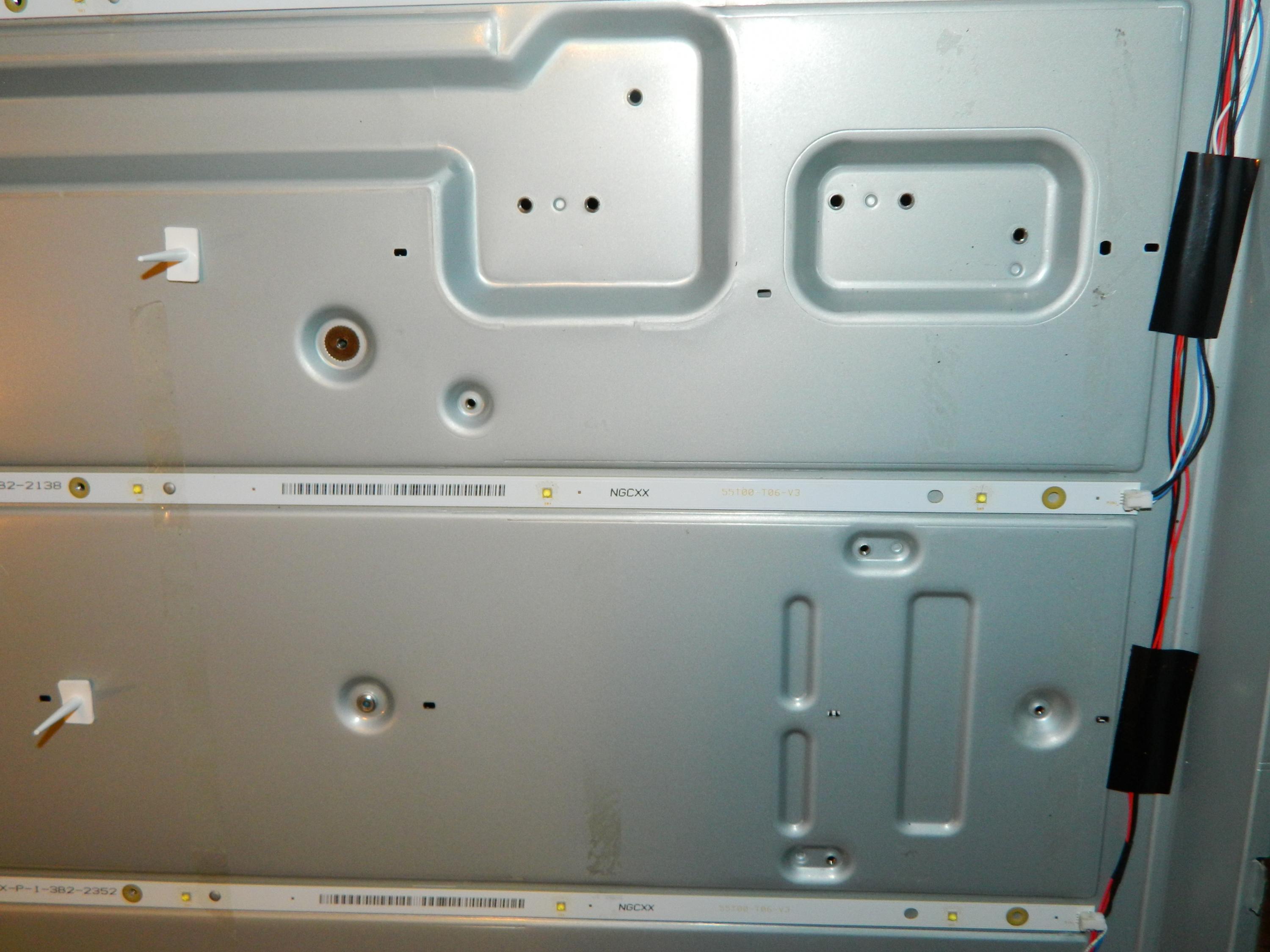

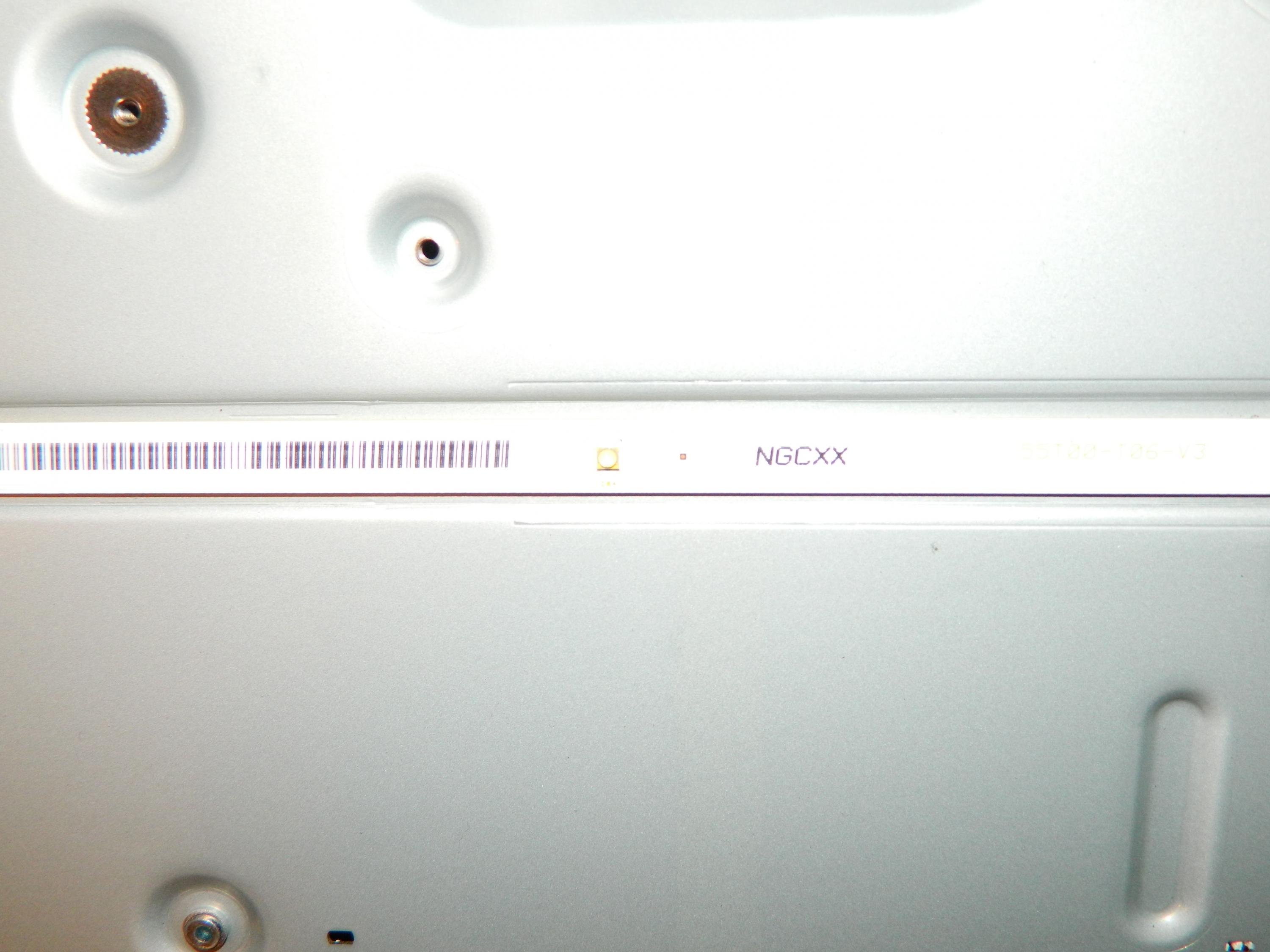

        BTW, does the LED strip has LG or INOTEK printed on the board some where? Most LED strips use LG LEDs.

          Re: Source for VIZIO Backlight LEDs?
          This is the only printing on the strips (a long and a short):
          https://www.badcaps.net/forum/attach...1&d=1462592500

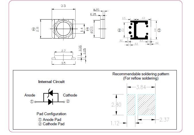

            Would anyone have a datasheet for this LED, or is this another in a long line of unobtainable TV part information.
              It is on that link to ALIEXPRESS LINK, including the footprint.

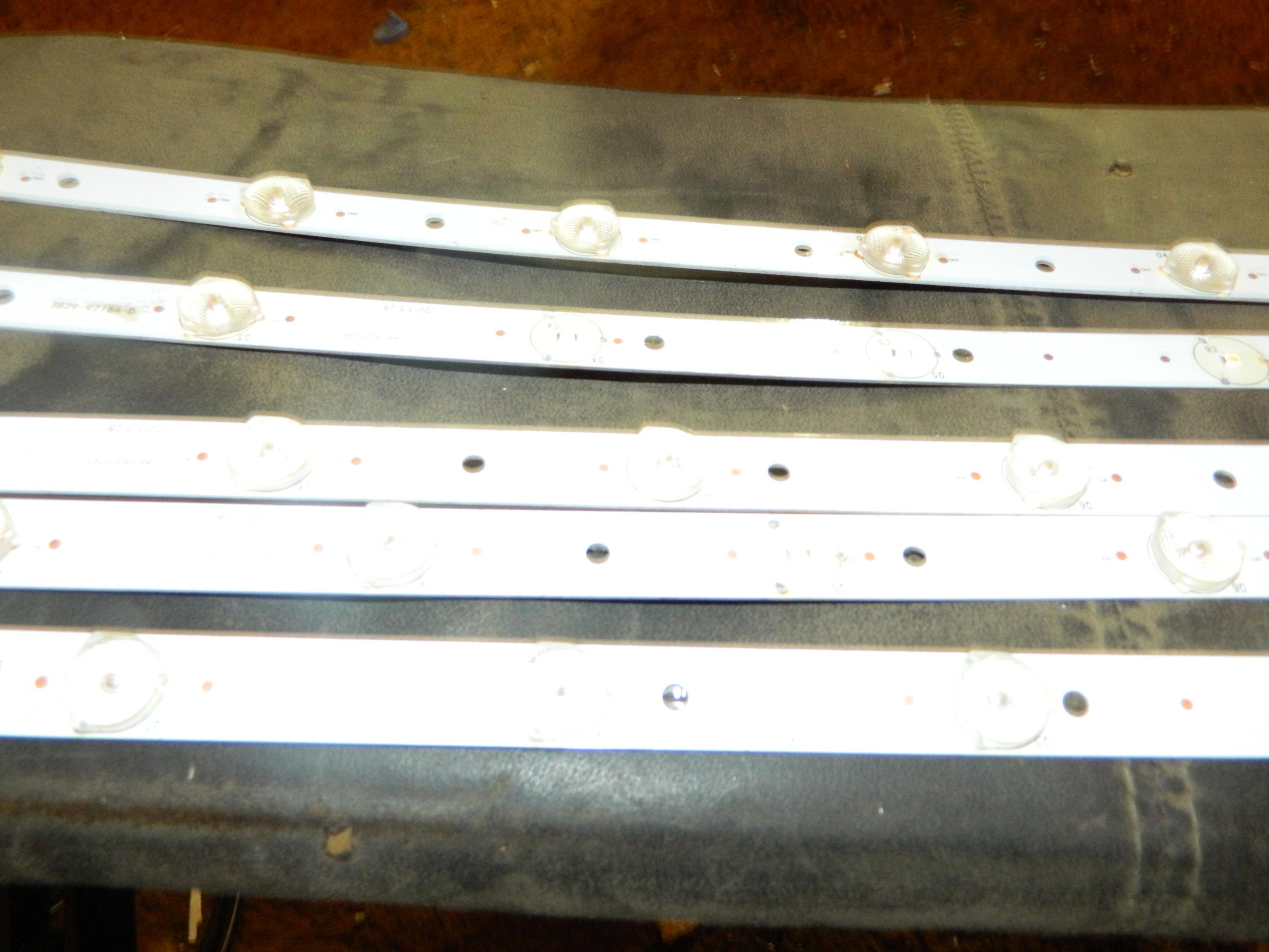

              • ozzy214
                • Nov 2013
                • 319
                • usa

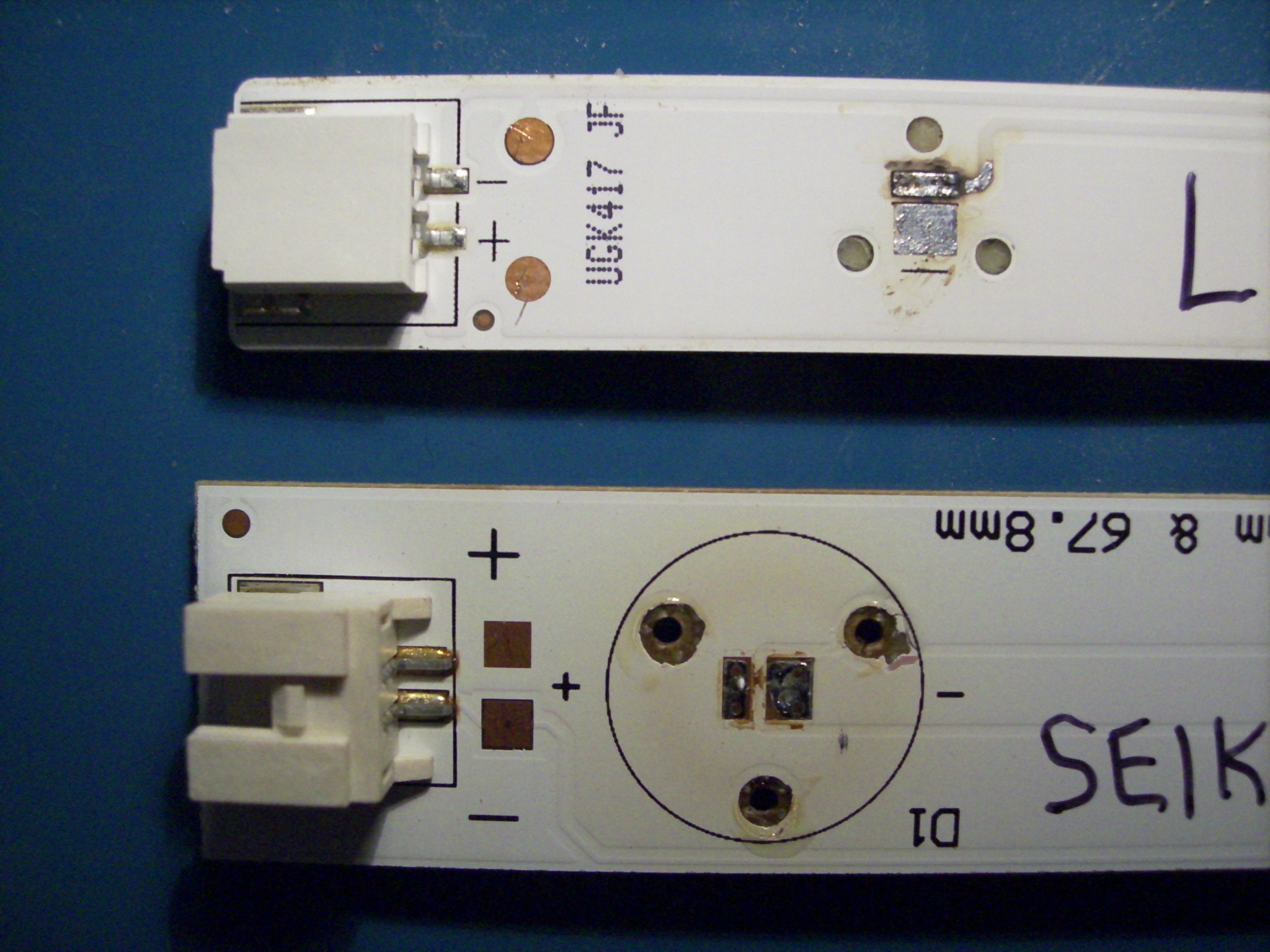

                I got some strips from two different cracked screen leds. Do you want me to take pictures? Maybe you can canabilize the strips and pull the leds off..?
                • SLK001
                  • May 2014
                  • 264
                  I would love to give it a shot.
                  • ozzy214
                    • Nov 2013
                    • 319
                    • usa

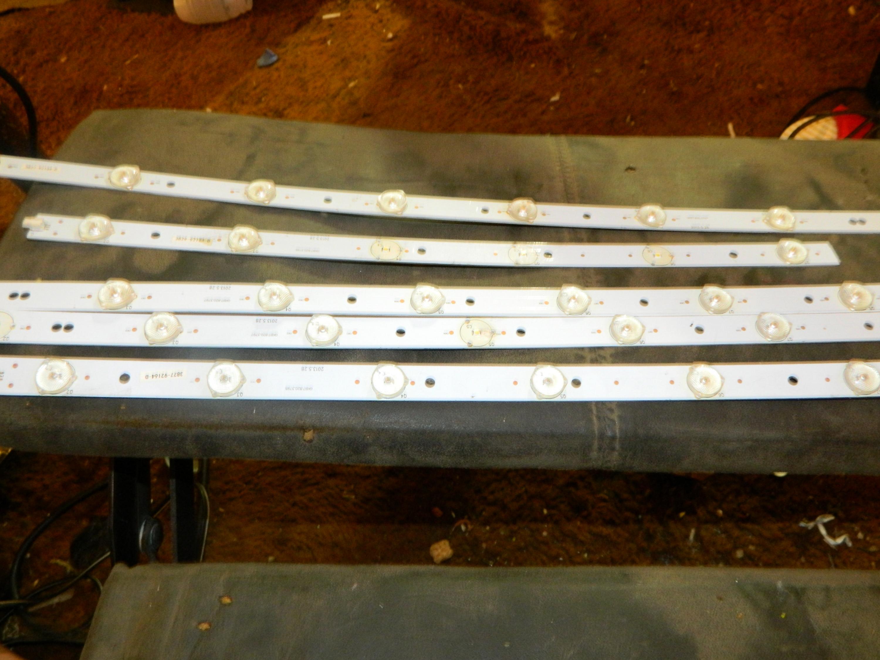

                    See attached pictures and let me know if they will work. These were not pulled from a vizio tv, but I have been noticing the panels use almost the same identical strips. AS my primary business is parting tvs out for ebay.
                    This is not the complete set, got lost as the set was apart for many months and the girlfriend decided to clean my work table lol.
                    I want to say these came from a seiki tv, but not sure. It had a good panel, but bad main board. And I had a hell of a time finding one, so parted it out.
                    If these wont work, I have a emerson 50" in my kitchen that will be coming apart shortly to sell the strips on ebay.
                    I also have a 32" vizio led with good panel and leds that I can possibly pull apart to see if the leds will work for you. Been waiting to find a good ma inboard for that, but doesn't seem to be happening. So probably will part that one soon.
                    Pm me if you want these and we can work out a deal on shipping and what not through PayPal! Or ebay!
                      Yes, those strips look like the ones in my panel. However, the similarity ends there. I'm pretty sure that the Seiki LEDs sink their heat through the cathode side - I've been pulling LEDs from a broken screen Seiki to repair other displays for a while. This LG threw me a curve with its sinking through the anode side.
                      I've included a side-by-side pic of the two strips. As you can see, the pads are nearly identical, but the polarity is flipped between the two. You have to remove one of the LEDs to see the polarity of the mount.
                      If you ever tear down your 32" VIZIO, I might be interested in those strips.
                      • ozzy214
                        • Nov 2013
                        • 319
                        • usa
                        How about these....totally different set up than the other ones. Only downfall is they not only screwed the strips in, but glued them in. So I will need a heat gun to extract. I have no idea at this point what brand of tv, sticker was worn on cover.
                        I also have strips I pulled from a insignia tv last night, but they look similar to others ones i posted.

                                  It is strange that this guy with same P/N LATWT470RELZK has LED ANODE on the big pad:
                                  http://www.aliexpress.com/item/LG-LE...00014.4.d8Pim3
                                  And this guy in your link has LED LATWT470RELZK CATHODE on the big pad:
                                  http://www.aliexpress.com/item/100PC...d-568b936e832f
                                  I am looking for BOTH types, so who has the correct pinout?

                                    Look again at the attached image. The circled 1 on the internal circuit diagram (lower left) corresponds to the circled 1 on the bottom view drawing (upper right).
                                      OK, I see that tiny number 1 (ANODE) now for the big pad.
                                      So that will the LG one I will order.
                                      I am also working on the SAMSUNG LED backlights which has Cathode for the big pad.

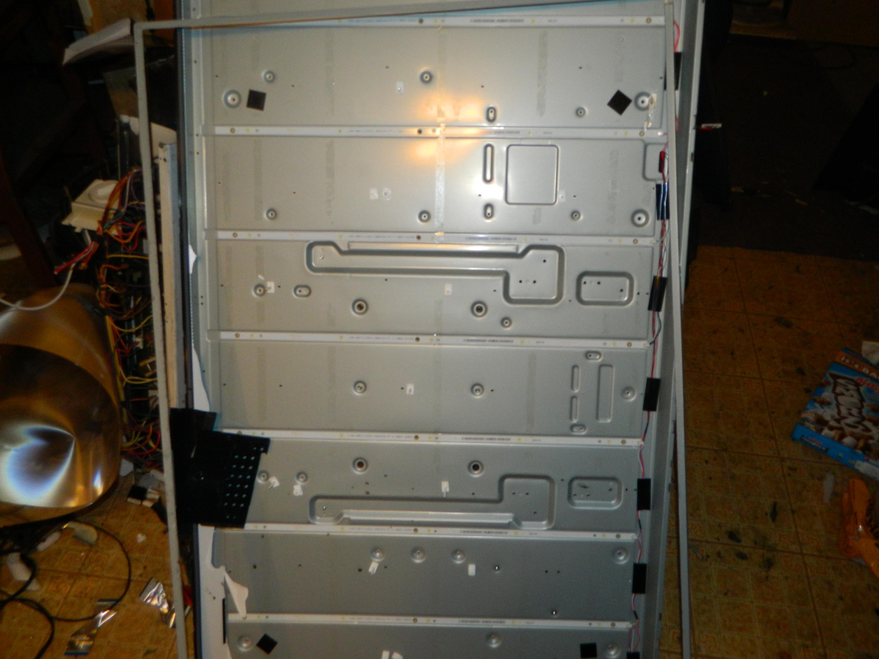

                                        I received an order from Ali for the LG LEDs. I ordered them on May 8th and received them on May 19th. They are just like the originals. The color and the brightness are comparable to the OEM LEDs in the set.
                                        I have the set partially reassembled, up to the "put the LCD panel back on" stage. I'm going to wait until tomorrow to do that - more thought needs to go into it. Hopefully, I'll be successful and not break the glass.
