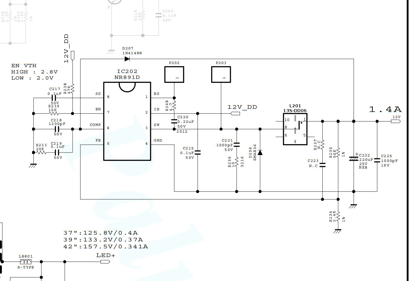

            Update! After a lot more searching, I think I found a better schematic for the Power Supply Board. This is for the LGP42-13PL1 PCB and not my TV's LGP3739-13PL1, but it should be very close to (if not the actual) schematic.
            The important thing to note is the difference from the last schematic I posted (for a 32" LG). From the looks of it, the 12V supply may actually originate before IC202. Unlike the last schematic, this one has 12V going into IC202 instead of 24V (it also has C225 on the far right, which was missing from the last one).
            I've attached a new picture of the IC202 part of the schematic for reference, the full schematic this was taken from is located here.

              Re: LG 39LN5700, TV shuts off immediately after being turned on, no picture
              If you check the resistance between pin 2 of the IC and the 24V pin of the connector, you will find that it should have <1 Ohms between the two point.
              The bottom line is that your measurement in post 24 also confirm that the IC is fed by 24VDC and the circuit is not working to produce the 12V output.
              i suspect that you have bad IC.

                Would it just be IC202 that's bad in this circuit? I did verify a resistance under 1 Ohm between pin 2 and the 24V pin 9 on P201 (18 pin connector), but I also wasn't seeing voltages anywhere close to 12V at R238 as shown on the left side of the schematic.
                  Yes, more likely.
                  'but I also wasn't seeing voltages anywhere close to 12V at R238 as shown on the left side of the schematic'
                  Are you talking about the DCV on pin 7 (EN) PIN? That pin only requires 1.4V (minimum is 0.70V) to turn on the IC per spec sheet on page 44, you have 4.10VDC per post 24.

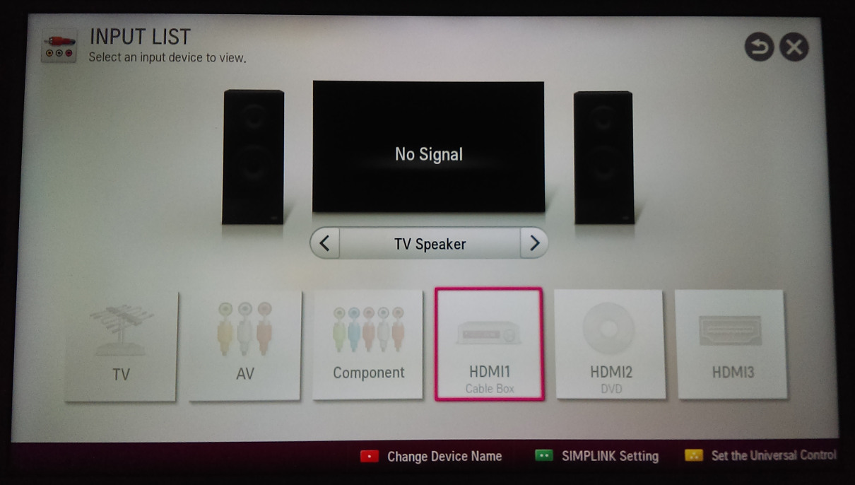

                              Well, just installed new backlights and put the TV back together just enough to get a pitcture and... well... yeah...
                              Vertical lines on half the screen.

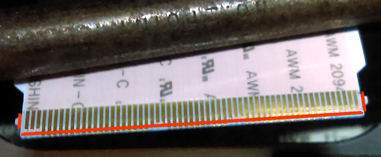

                              I'm guessing it's either a problem with one of the ribbon cables or one of the tab ICs. So frustrating, the panel seemed to be working just fine when I did the flashlight test a few hours ago.
                              edit: Looks like it's the left ribbon cable. Some pins seem to have gotten chipped near the top:
                              Anyone know a "simple fix" that's applicable here or does the cable and/or something else need to be replaced?

                                Okay, so I thought I would try an experiment, I cut the cable just below the damaged pins and clipped off the 2 side tabs (see the red lines in the first photo below). After a very careful re-insertion.... No more lines!!!
                                Anyone know if there would be any problems / side effects with this repair I should worry about or am I in the clear?
                                  This is a normal procedure in such cases . you're fine .
