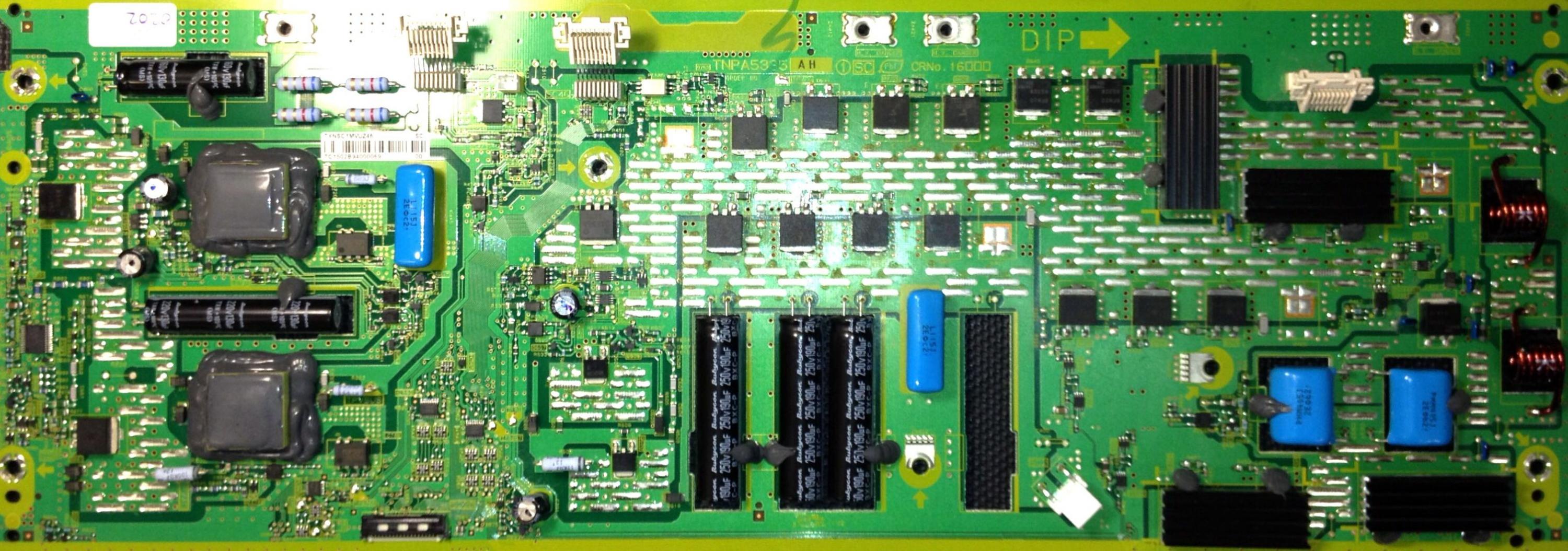

    Hi there;
    I have a Panasonic TH-P46GT30Z that has the dreaded 7 blinks of death.
    This is the second time this has happened in exactly the same way.
    Once I have fixed the loose RF module on the A board then replacing the SC board (TNPA5335) will fix the problem.
    I know because I have done this before.
    But as we know you can't get an SC board for this model any more.
    I have been given a Panasonic TH-P50ST30Z that has a broken panel.
    The SC board looks the same except for an extra 190uF on the 50's bottom edge in a cutout next to the SC2 plug.
    The boards have ID stickers on that say-
    TXNSC1MVUZ46 in the case of the 46-GT30 and an "AH" stamp beside the board #
    TXNSC11GGKB50 in the case of the 50-ST30 and a "BG" stamp
    Is there a possibility that the SC board from the 50" will work in the 46"?
    I can upload some pics if anyone wants to see.

    It will work, just won't be matched to the size panel.
    Capacitors and the inductor coils I would compare, that's generally the difference and the number of transistors used.
    Keep the dead boards as you may find someone who can rebuild them.

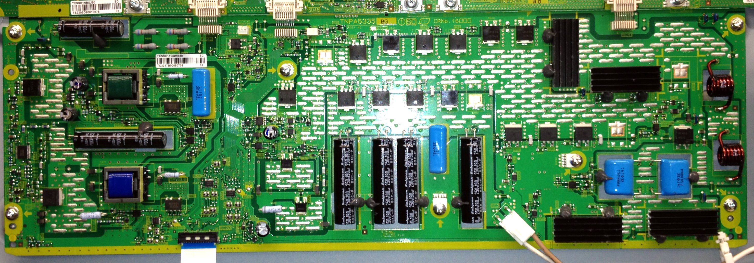

                      • Tranceducer
                        • May 2016
                        • 5
                        • New Zealand
                        Re: Panasonic Plasma 2011 SC board differences?
                        Good work everyone!
                        I can see the big coils on the right have a different letter on them "M" on the 50 & "K" on the 46 but otherwise look identical. If they have the same part # I'm ok with it.
                        The SC board from the 46 is a 2014 build and is covered with grey goo glue on the other coils so no visual clue there. same amount of heat sync.
                        Some of the resistors look a bit more grunty but same value.
                        tw2005 thanks for your work looking into the parts list. Finding anything on the 46" is rare so no surprise that you may not have the list for that.
                        I'll do a grid search when I've got a spare 30mins.
                        Hopefully the photos are good enough for your geeky pleasure if you want a look.
                          Is it me, the photo--or are the coils different diameter on those boards....?

                            may have a point there, was wondering about the different letter stamp myself.
                            Too many versions of this damn board. I have not found an exact manual and the one I looked at I believe had BH version for a 46GT30E.
                            the coils in that matched the 50" and photos looked ok but looking again I think there is difference in the winding diameter
                            Hard to image a different panel being used but all too hard second guessing everything.
