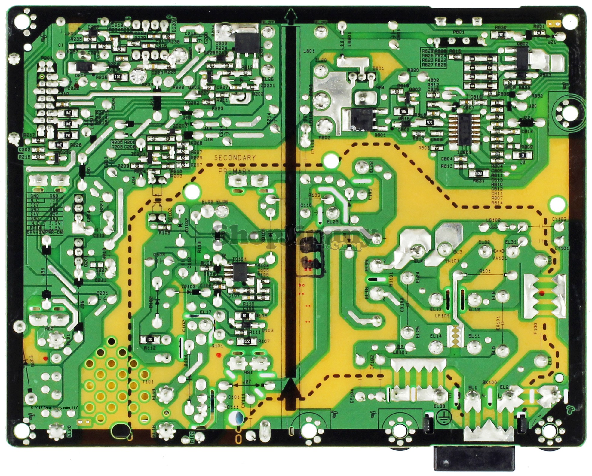

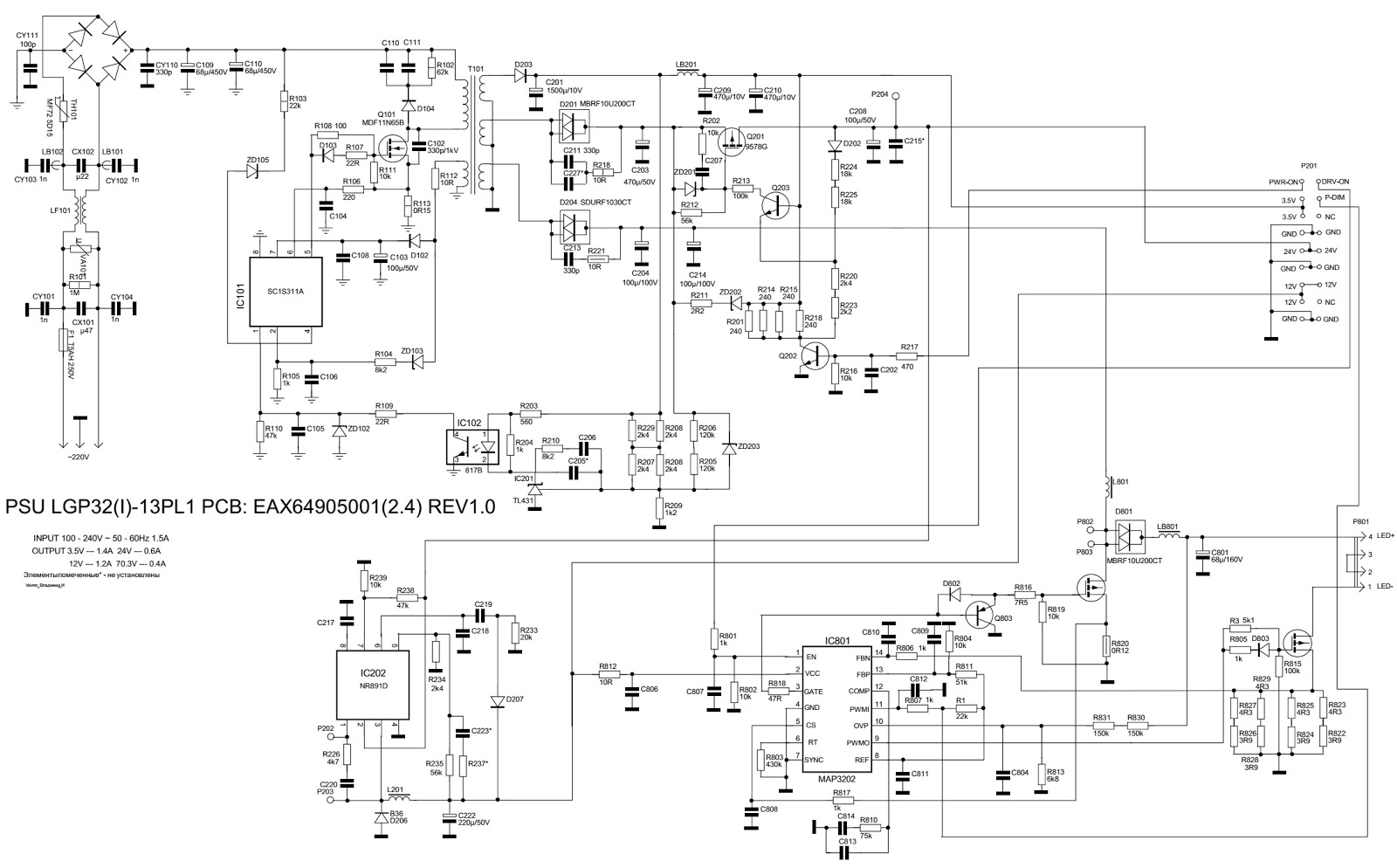

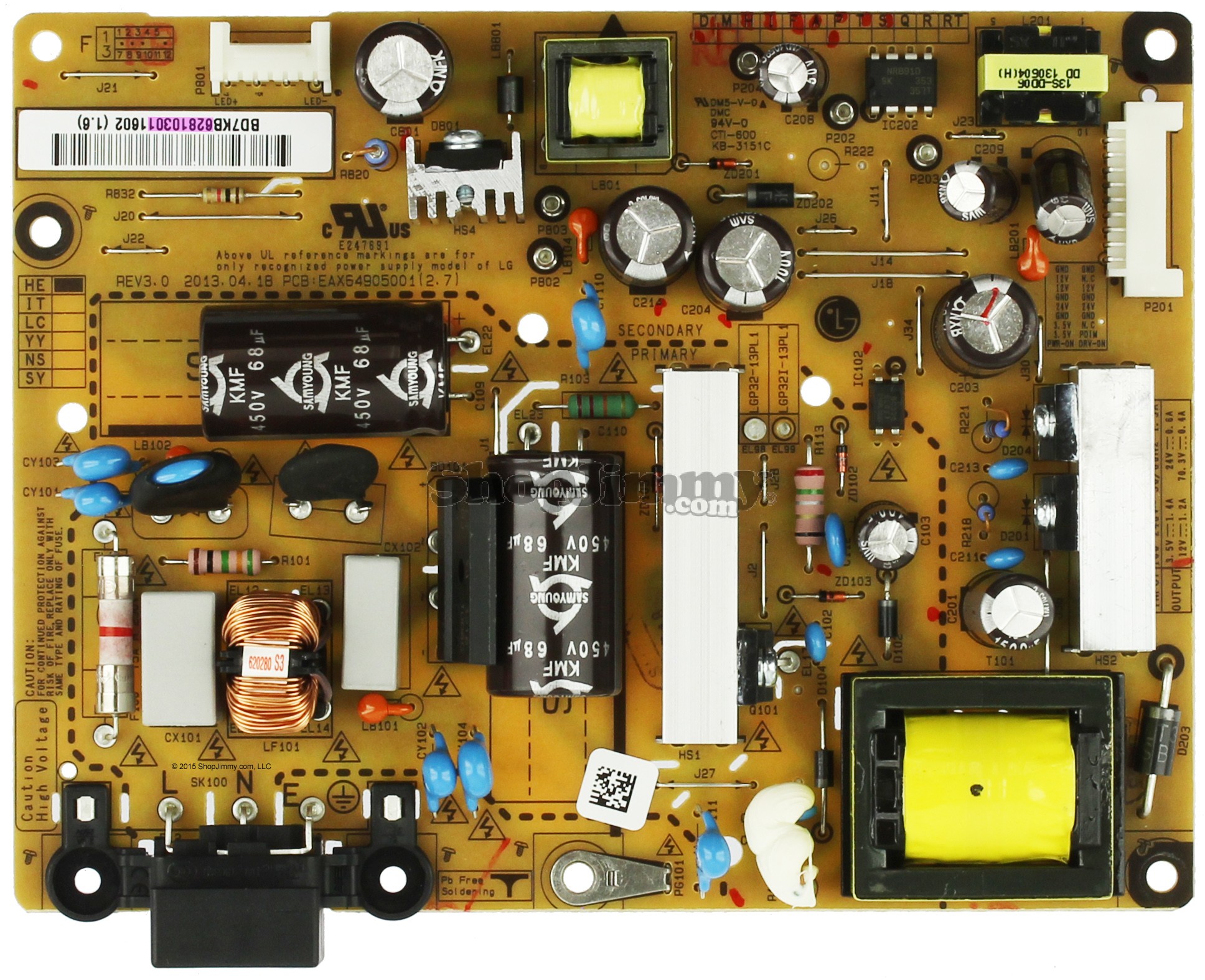

eax64905001 No Pfc Help ?
  • gurug
    replied
    Re: eax64905001 No Pfc Help ?
    Originally posted by ReeceyBurger123
    Can you get us an image of the underside of the Pcb please ?
    PCB is same as listed on first page of this thread, I attached pictures. And also schematics of power supply.
    Leave a comment:
  • ReeceyBurger123
    replied
    Re: eax64905001 No Pfc Help ?
    Can you get us an image of the underside of the Pcb please ?
    Leave a comment:
  • vinceroger69
    replied
    Re: eax64905001 No Pfc Help ?
    S/c means short circuit if you upload a picture of the top and bottom of your power supply im sure we can pont them out too you unless reece knows the location number already
    Leave a comment:
  • gurug
    replied
    Re: eax64905001 No Pfc Help ?
    Originally posted by ReeceyBurger123
    Check the 24v diode and the Led mosfet for S/C that could be pulling the 24v low.
    Can you tell me which diode and mosfet is that? And what diws s/c mean? Voktages on connector to main board are all ok, 24v also.
    Leave a comment:
  • ReeceyBurger123
    replied
    Re: eax64905001 No Pfc Help ?
    Check the 24v diode and the Led mosfet for S/C that could be pulling the 24v low.
    Leave a comment:
  • gurug
    replied
    Re: eax64905001 No Pfc Help ?
    Originally posted by George266
    I have got the same problem here- LG 32LN570R, but the board is the same tan the one mentioned in the comments above.
    The PSU board is eax64905001 ver. 2.4
    I can see the image on the display when I use torch , therefore the Backlight is not getting voltage I believe.
    I have measured the voltage to backlight, which fluctuate between 11V -21V
    Other voltages on PSU board seems to be right 3,3V , 3,47V , 12V and 24V.
    Any ideas which part is causing this ?
    Thanks for any help
    I have exactly same problem, voltage to backlight fluctoates between 11-20V. I replaced MAP3202 - but problem is the same ... can you help me to further diagnose fault?
    Thanks in advance.
    Leave a comment:
  • ReeceyBurger123
    replied
    Re: eax64905001 No Pfc Help ?
    Originally posted by snopy44
    no just the blinking leds and not powering up
    How you a multimeter mate ?
    Leave a comment:
  • ReeceyBurger123
    replied
    Re: eax64905001 No Pfc Help ?
    Originally posted by George266
    I have got the same problem here- LG 32LN570R, but the board is the same tan the one mentioned in the comments above.
    The PSU board is eax64905001 ver. 2.4
    I can see the image on the display when I use torch , therefore the Backlight is not getting voltage I believe.
    I have measured the voltage to backlight, which fluctuate between 11V -21V
    Other voltages on PSU board seems to be right 3,3V , 3,47V , 12V and 24V.
    Any ideas which part is causing this ?
    Thanks for any help
    Led driver Ic imo replace that. Video coming soon.
    Last edited by ReeceyBurger123; 08-04-2016, 07:34 AM.
    Leave a comment:
  • George266
    replied
    Re: eax64905001 No Pfc Help ?
    I have got the same problem here- LG 32LN570R, but the board is the same tan the one mentioned in the comments above.
    The PSU board is eax64905001 ver. 2.4
    I can see the image on the display when I use torch , therefore the Backlight is not getting voltage I believe.
    I have measured the voltage to backlight, which fluctuate between 11V -21V
    Other voltages on PSU board seems to be right 3,3V , 3,47V , 12V and 24V.
    Any ideas which part is causing this ?
    Thanks for any help
    Leave a comment:
  • ReeceyBurger123
    replied
    Re: eax64905001 No Pfc Help ?
    Ok have you checked any voltages yet ?
    Leave a comment:
  • snopy44
    replied
    Re: eax64905001 No Pfc Help ?
    no just the blinking leds and not powering up
    Last edited by snopy44; 08-02-2016, 04:53 PM.
    Leave a comment:
  • ReeceyBurger123
    replied
    Re: eax64905001 No Pfc Help ?
    3 blinking Leds on the standby Led ? If so thats normal, does the backlight not come on though ?
    Leave a comment:
  • snopy44
    replied
    Re: eax64905001 No Pfc Help ?
    yes it is the same powerboard just there is nothing about this board on the net
    Leave a comment:
  • ReeceyBurger123
    replied
    Re: eax64905001 No Pfc Help ?
    Originally posted by snopy44
    hi sorry if I am posting wrong but need help what is the problem when you get the 3 blinking leds on powering up
    Is it on the same Tv ?
    Leave a comment:
  • snopy44
    replied
    Re: eax64905001 No Pfc Help ?
    hi sorry if I am posting wrong but need help what is the problem when you get the 3 blinking leds on powering up
    Leave a comment:
  • ReeceyBurger123
    replied
    Re: eax64905001 No Pfc Help ?
    Just an update chaps, after replacing the Led driver I now have 1.4v Vcc to the mosfets and 70v on the output to the Leds and now have backlight Thanks all video coming soon.
    Image of the replaced driver, unfortunately I lifted a trace so this thing doesn't look factory. Serves me right for not using flux !
    Leave a comment:
  • ReeceyBurger123
    replied
    Re: eax64905001 No Pfc Help ?
    An update chaps, found the I have 0.8v Vcc coming out of the controller which is not high enough to turn on the booster. Got a controller on order
    Leave a comment:
  • dick_barton
    replied
    Re: eax64905001 No Pfc Help ?
    Will this schematic help you?
    http://obrazki.elektroda.pl/1033688300_1436654733.jpg
    Leave a comment:
    replied
    Re: eax64905001 No Pfc Help ?
    Check the Vin to that Boost inductor L801, when the boost is not on, the Vin will be = to Vout.
    Leave a comment:
  • ReeceyBurger123
    replied
    Re: eax64905001 No Pfc Help ?
    Cheers bud, will download and have a play later on or tomorrow
    Leave a comment:
  • Pipolups
    Corsair K70 LUX RGB dying LEDs
    by Pipolups
    Hi there !
    I'm having an issue for several weeks with my quite old K70 LUX RGB keyboard. I haven't used it for few months, and once I setup up again my desktop computer, I got several dead LEDs on that keyboard. I tried the Corsair troubleshooting thing (disabling options in iCUE, ...) but nothing changed so I conclude that for some reason some LEDs went in retirement...😅
    Decision taken to change these LEDs as I have access to desoldering iron and binocular magnifier, I wrote a ticket to tech support, hopping to obtain the LEDs reference and... They refused to tell me 🙄...
    10-08-2024, 11:58 AM
  • THE GTC
    Insignia NS-37D20SNA14 intermittent LEDs
    by THE GTC
    So I use this TV daily as a second monitor for my PC or my Playstation - at one point a few months back I tried to fix the problem - but in the process, I figured out something that works so I haven't posted this for awhile. It is an annoying trick to have to do though, so I decided to post about it to see if anyone could spot what's wrong. It baffles me because it works on it's own half the time.
    When I first got this TV, I was told it wouldn't turn on, and of course I did the flashlight test, and the image was there. Also, the red LED on the front indicated that it had power (it...
    11-03-2020, 02:40 AM
  • pni
    Backlight panel diffuser melt by backlight leds broken
    by pni
    Hi guys, I changed my backlight to a 5g in Samsung but the broken leds burned the thick plastic panel . I give the photo. Do you think if I try to rotate the panel, with the botton on the top I have a good image? Becacause now how u can see, on the light color I sse the leds because of the burned on the plastic diffuser....
    10-12-2025, 12:08 AM
  • VitalComputing
    Replacing Mode Indicator LEDs
    by VitalComputing
    I have what should be a simple job but is causing me issues. There are three LEDs (yellow, green and red) on the indicator panel of a solar PWM controller and these have broken off. I need to replace them but I am unsure of the voltage drop across these. I don't want to replace with random LEDs in case they blow.
    I took one of the LEDs out of circuit, put 19V across it with a 500 ohm resistor in series and there is a drop of about 13V across the LED, and this seems to increase as I increase the input voltage.
    I thought I could just put a resistor...
    09-17-2023, 04:43 PM
  • jimbofz
    just a quick question do all qled leds appear blue when fault finding ?
    by jimbofz
    i have replaced many leds strips that have changed blue when they are worn
    and the new replacements are perfect white
    but when fault finding do quantum leds always look blue?
    08-28-2024, 06:51 AM
