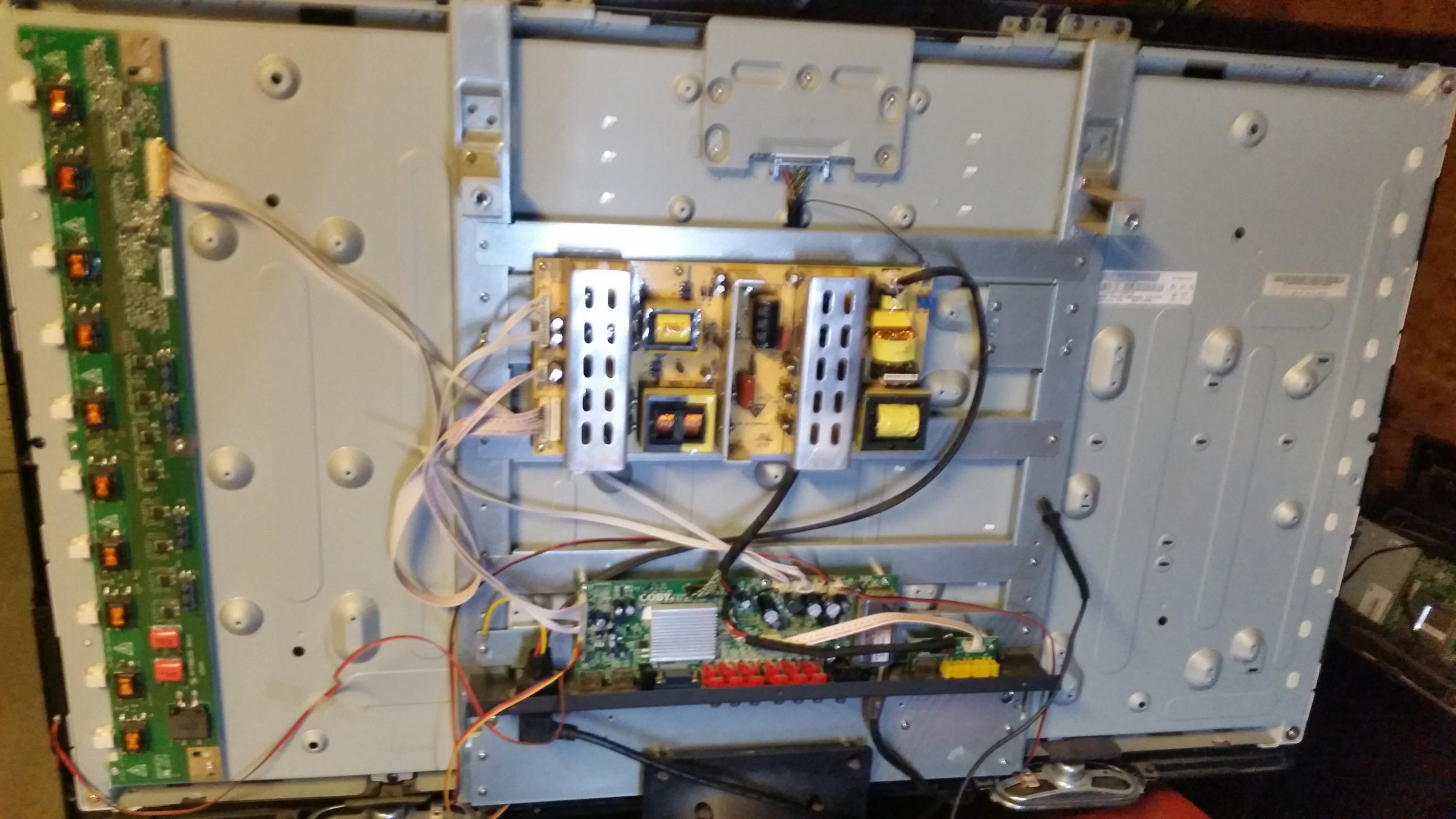

    coby TFTV4028 blue ligth stays on and won't power on
    Coby Tftv4028 I found a problem to that I change one regulator and it turn on good nothing wrong but the thing is when it's unplug the cord it does the same thing blue light lit but won't power on...I check the regulators and they check good... I know the main is good...theres a problem on the turn on switch and there were am lost.....there mp14280dp can be that the problem...

      Re: coby TFTV4028 blue ligth stays on and won't power on
      what kind of voltages do you get out of the power supply? When you press the power button, does the button ASSy change the voltage being sent to the main board or do all the voltage lines going to and from the buttons stay the same no matter what button you press?
              When I press the power nothing does, but when I plug the tv the blue light comes on like tv was on check the power and I have 24v for the inverter..and 5v for stanby....

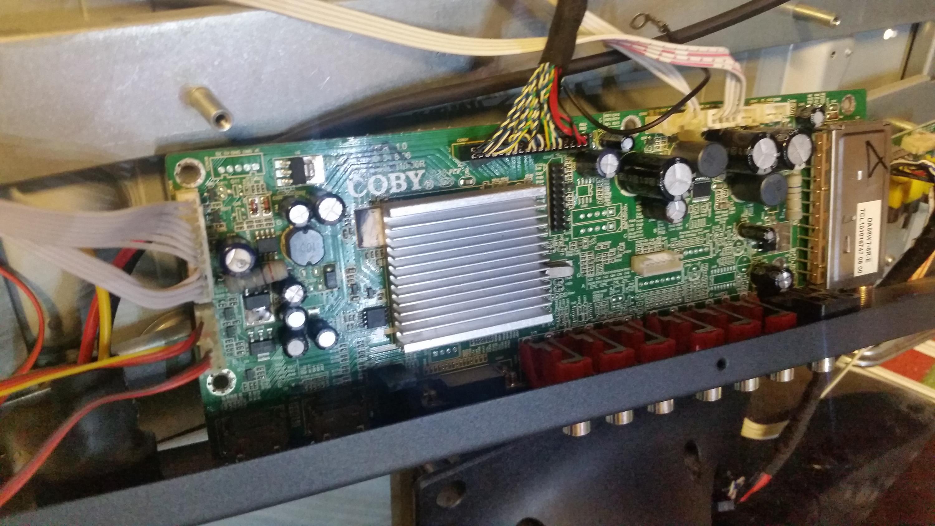

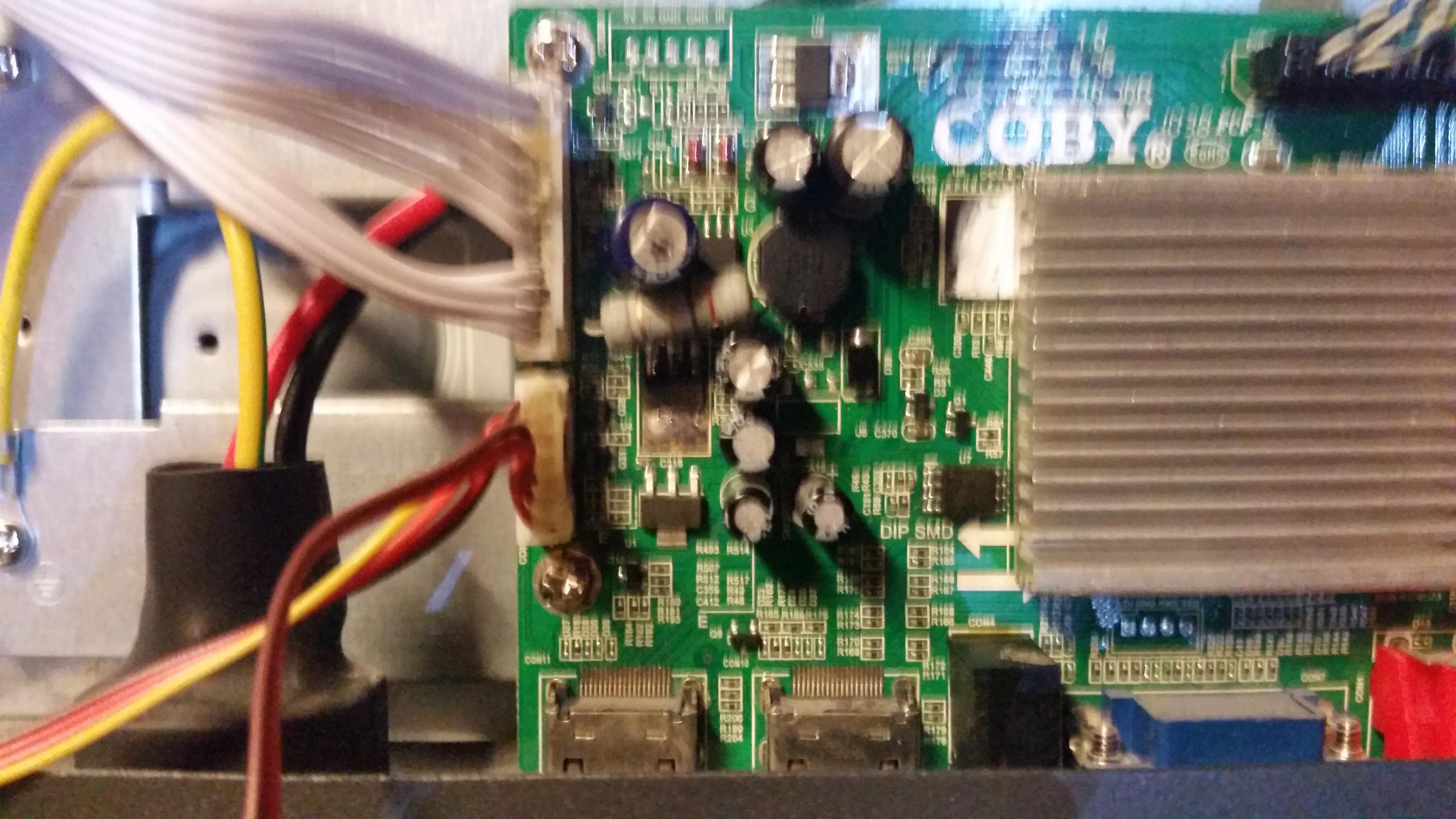

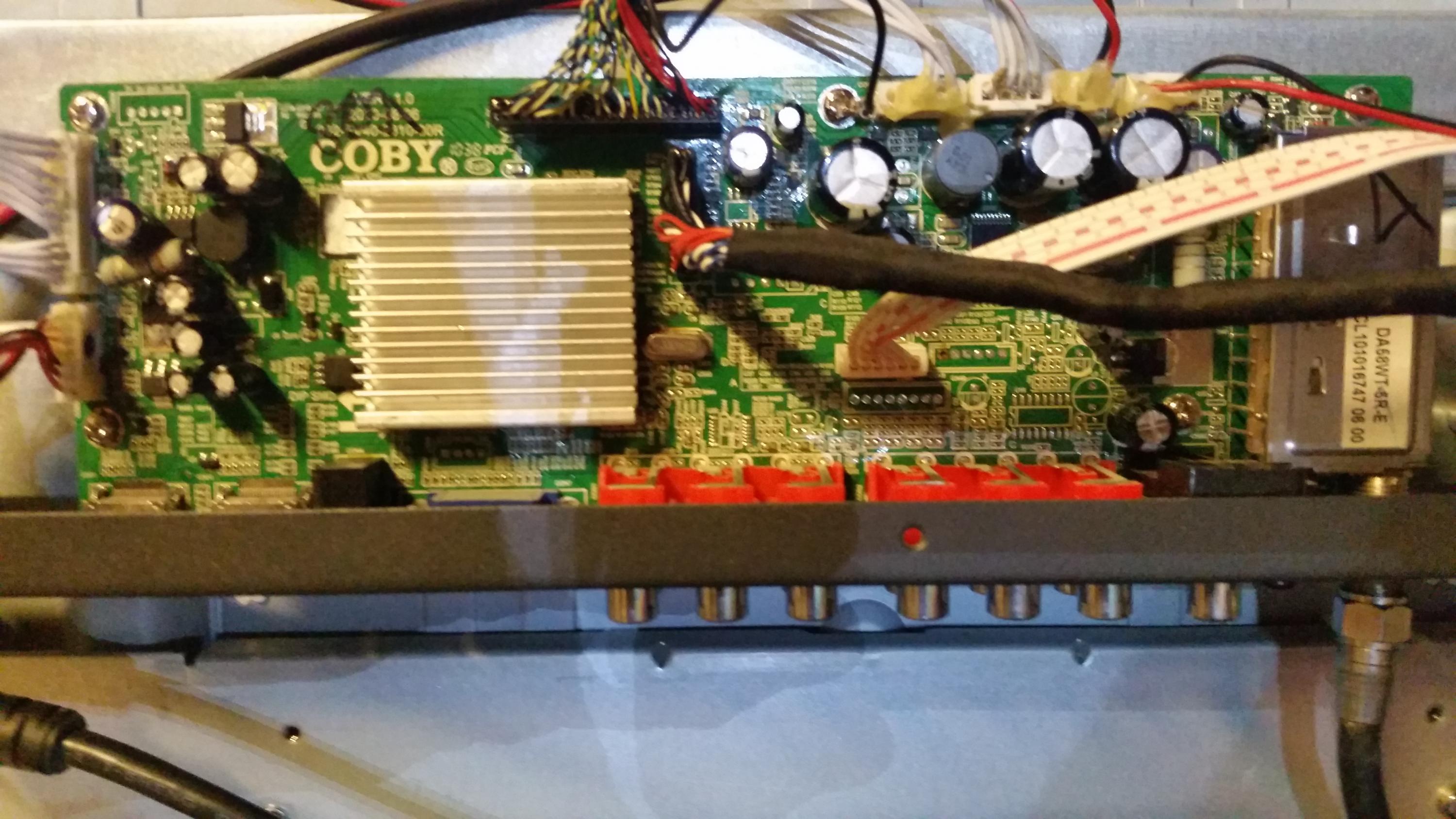

                        But the main board when I move parts or change a cap it work fine even if a press on and off..once it is unplug u won't able to turn on again blue light keep lit again
                          this voltage regulator I change it and work with on and off ...just right away when I unplug the cord it wont power the cap above the grey resistor change it and work again.....just work until I unplug the cord.

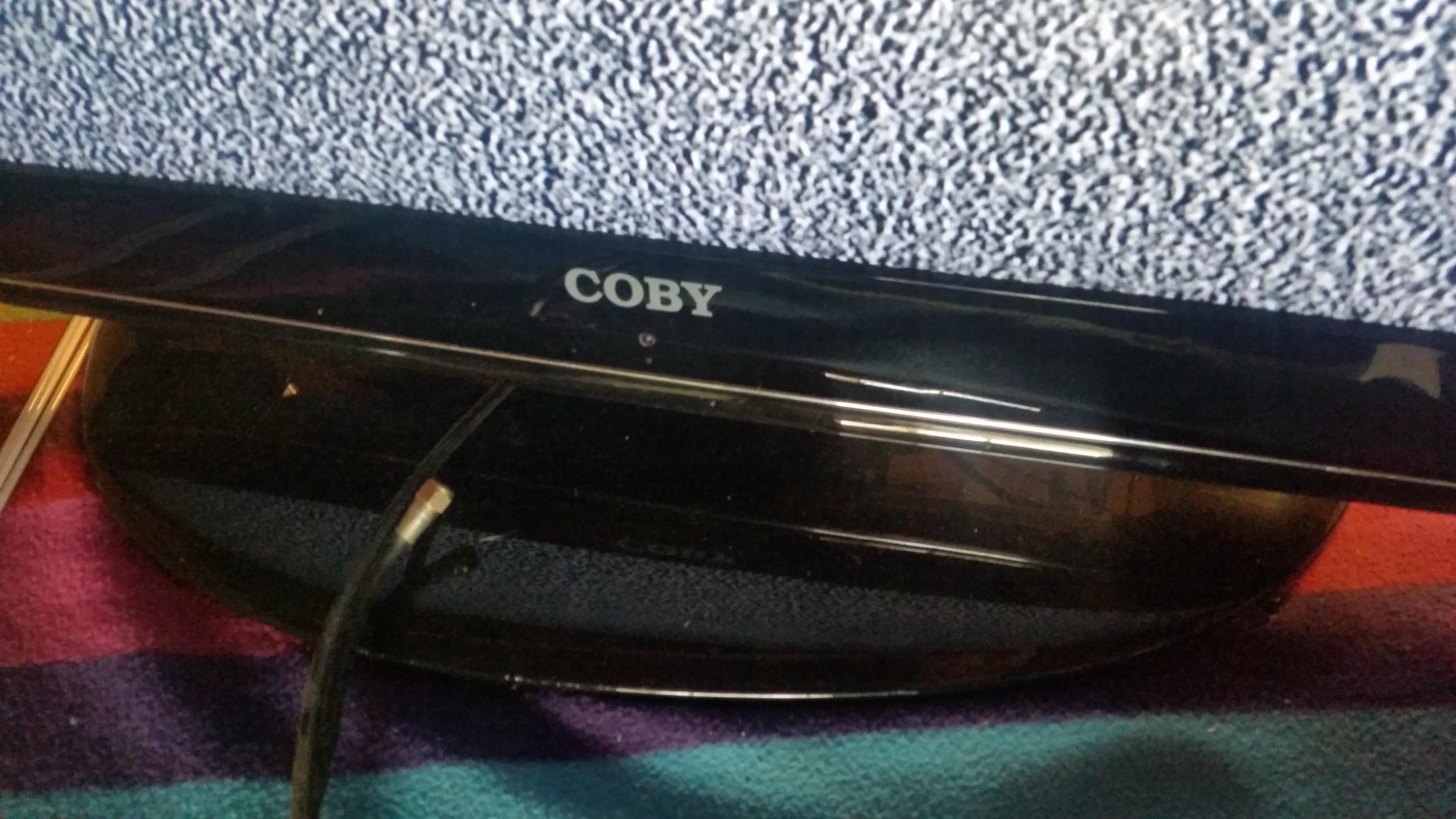

                              the last picture is when I unplug it and blue light comes and won't come on
