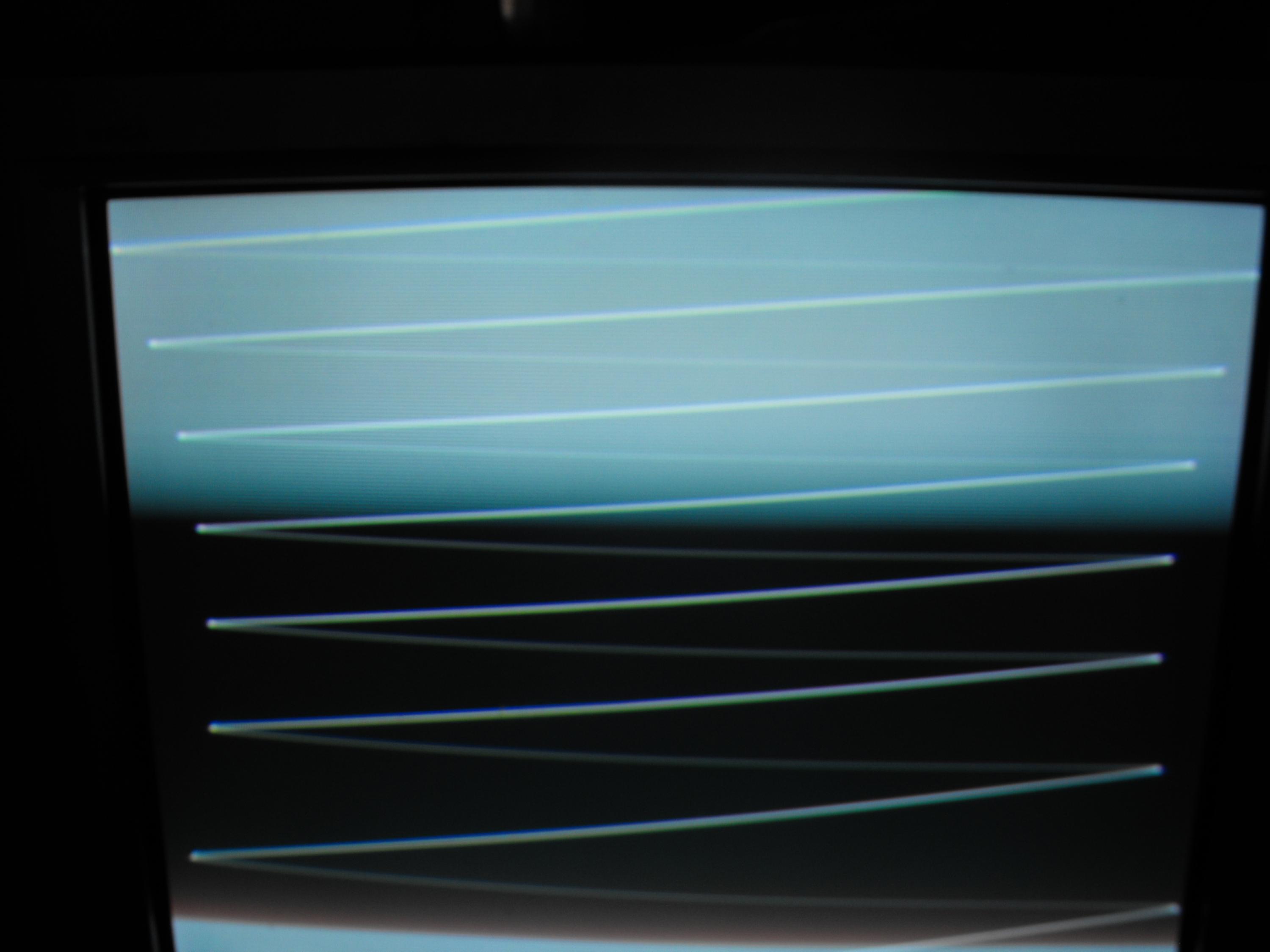

    I have a Sony KV25fs150 which has retrace lines no video but there is sound.
    When the television is switched on there are retrace lines with a bright screen
    and then the television shuts down and the stand by light flashes 2 times.
    The voltage supply which goes up to the CRT board is low and I have tested the
    capacitor which is on that supply line and it is ok.I have also changed the video
    amp IC on the CRT board .When I tested the supply which goes up to the CRT
    board on the A board,it is very high before the television shuts down.

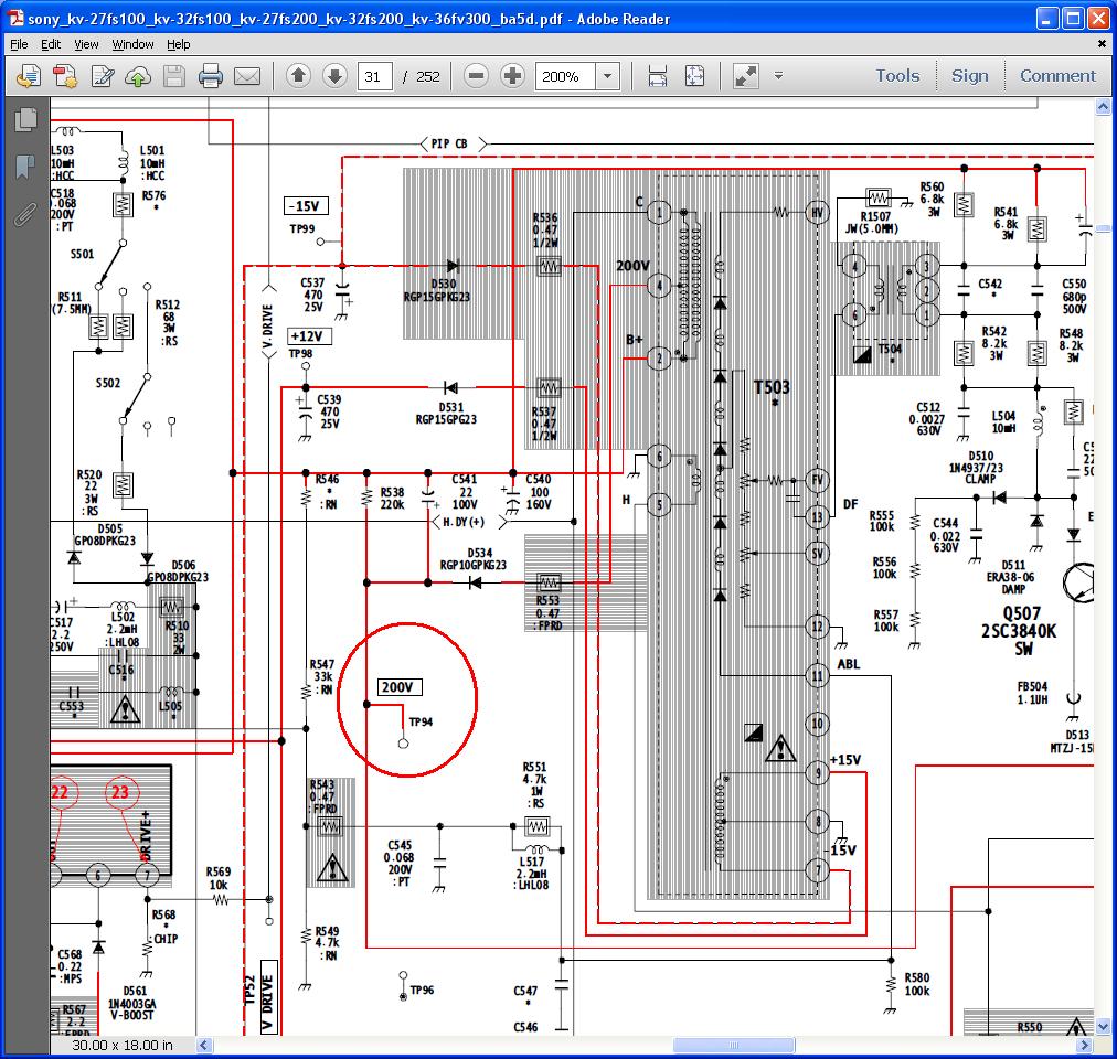

                                  You must be using a different service manual than me, do you get +200 on tp94?

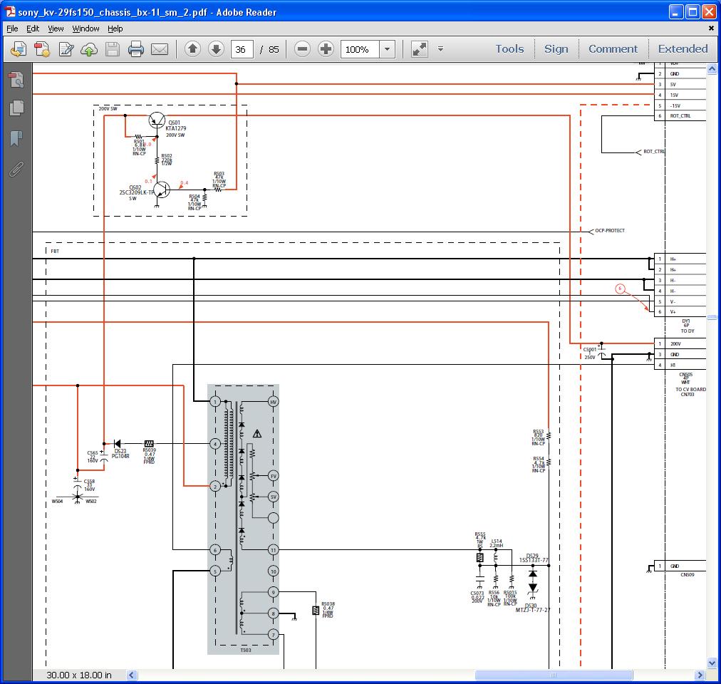

                                        I did not have that exact diagram but I think I have it now, is this the same? if it is, when you disconnect cn703 from the cv board does the voltage +200 volts come back on D523 (K) on the "A" board, and does the error go away?

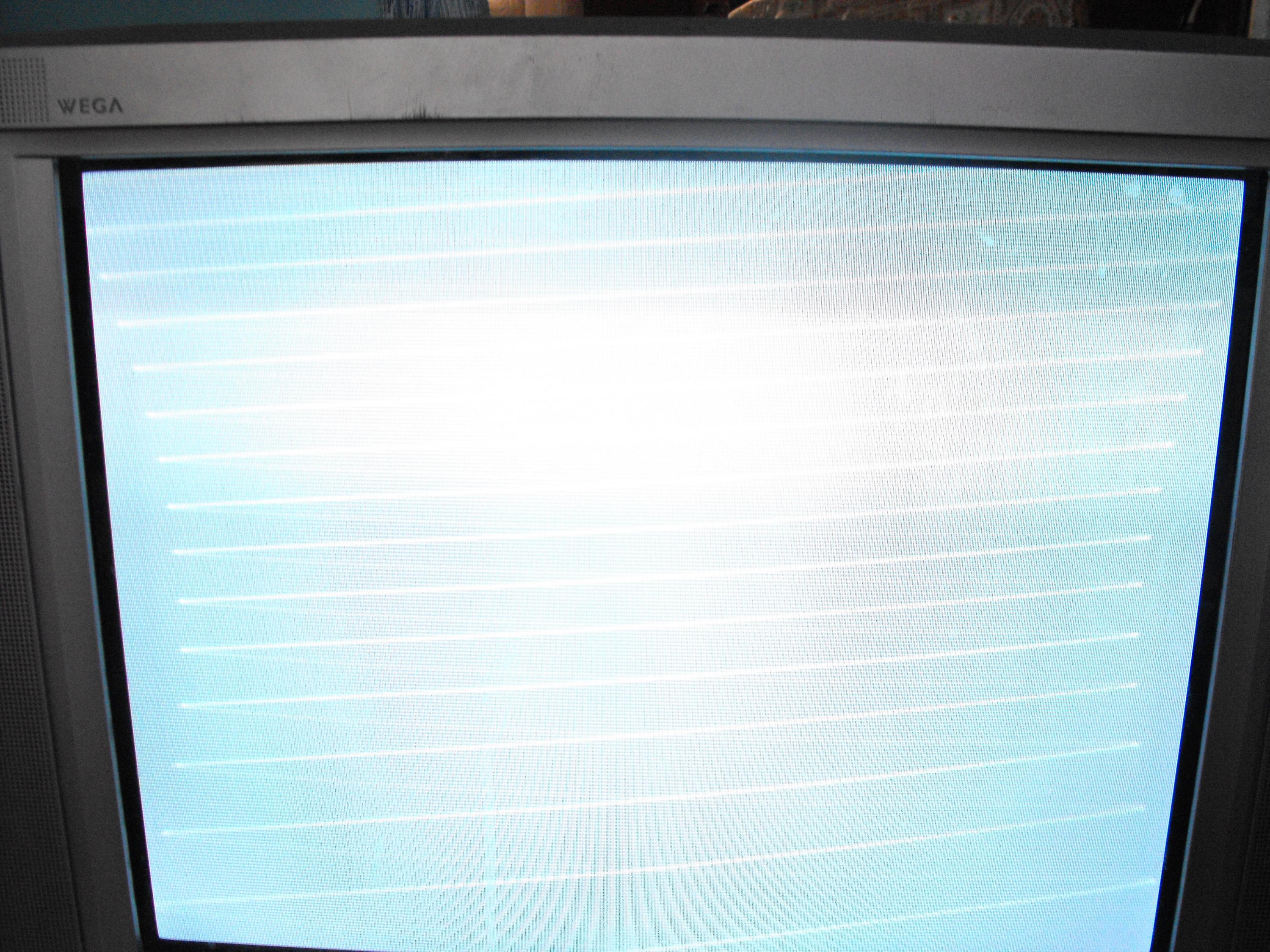

                                          Hi, I am trying to save my old monitor once I was so proud of. I hope there are still some people around with experience.
                                          Symptoms: overbrightness and visible retrace lines. When full white image is displayed, the monitors shuts off with flashing yellow.
                                          I have read previous threads and posts with similar issue, but none of the solutions can be applied to my monitor. According to them I need to suspect the G2 voltage as the issue.
                                          I attached the page of the A board schematic. In my case the G2 voltage supply coming from the flyback transformer is supposed...
