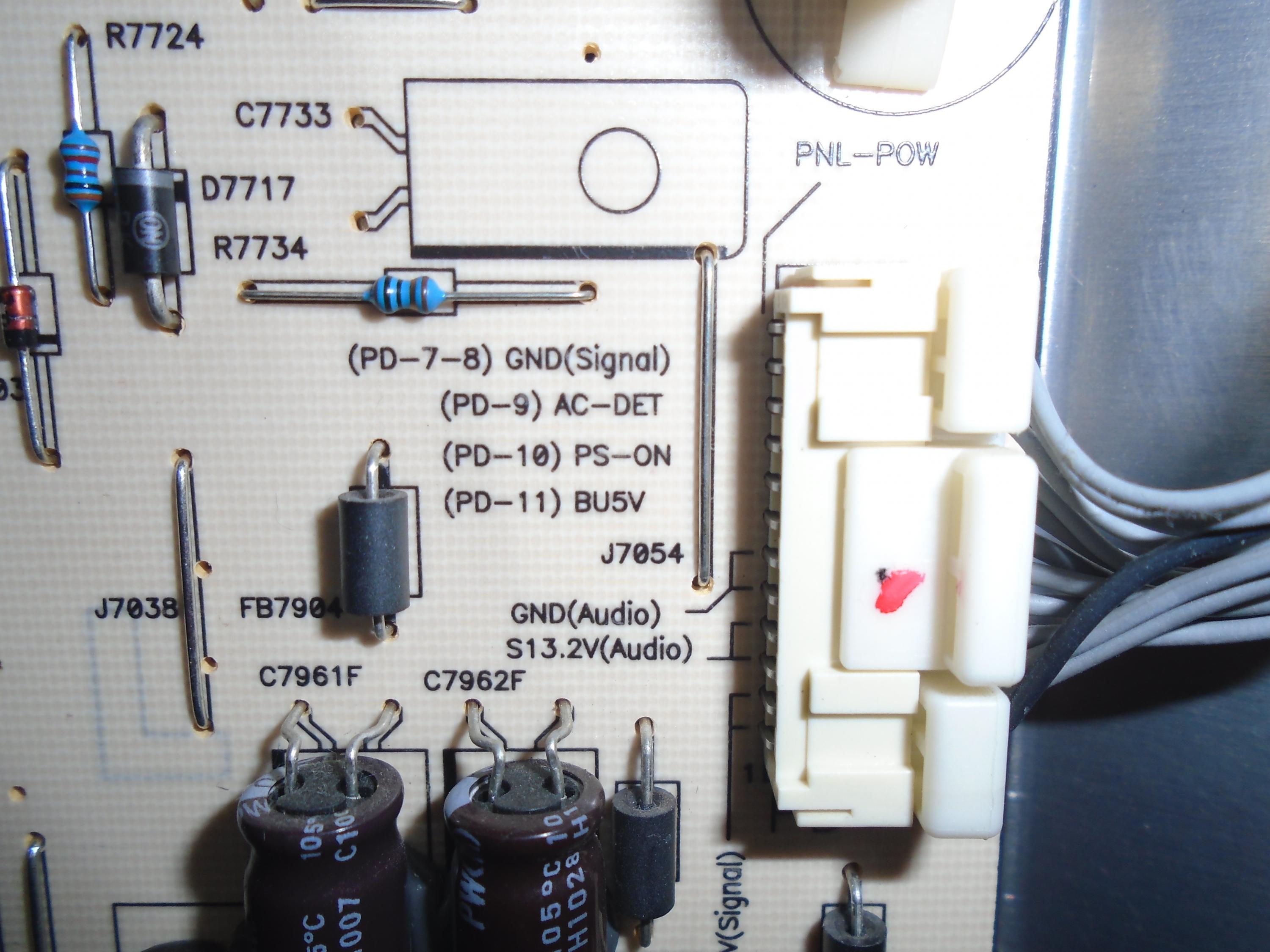

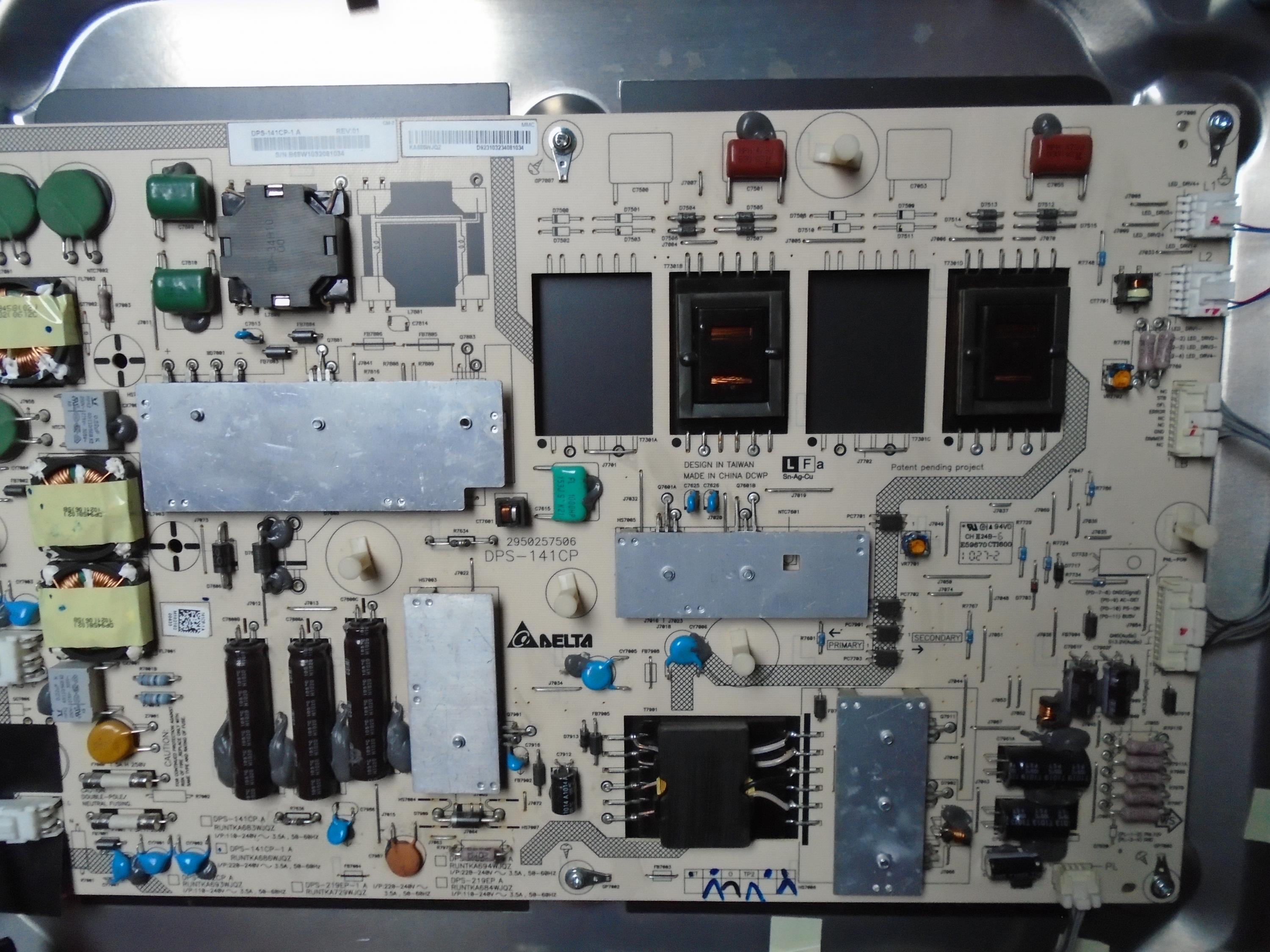

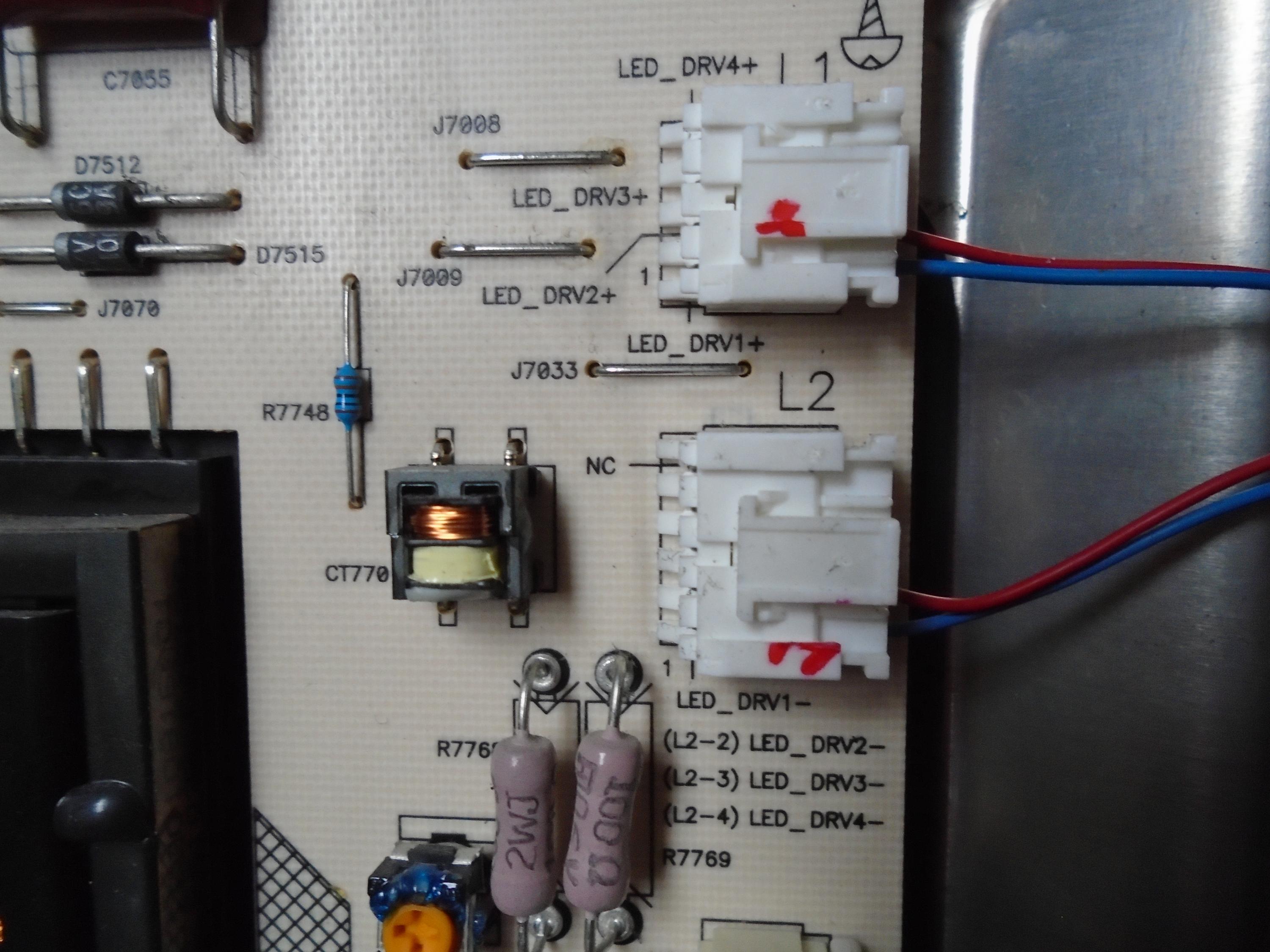

    Can you post some sharp photo's of the power supply and of the connectors with legends along side.
      Re: Sharp lc46le811e one flash on inverted v
      Here You Are Dick

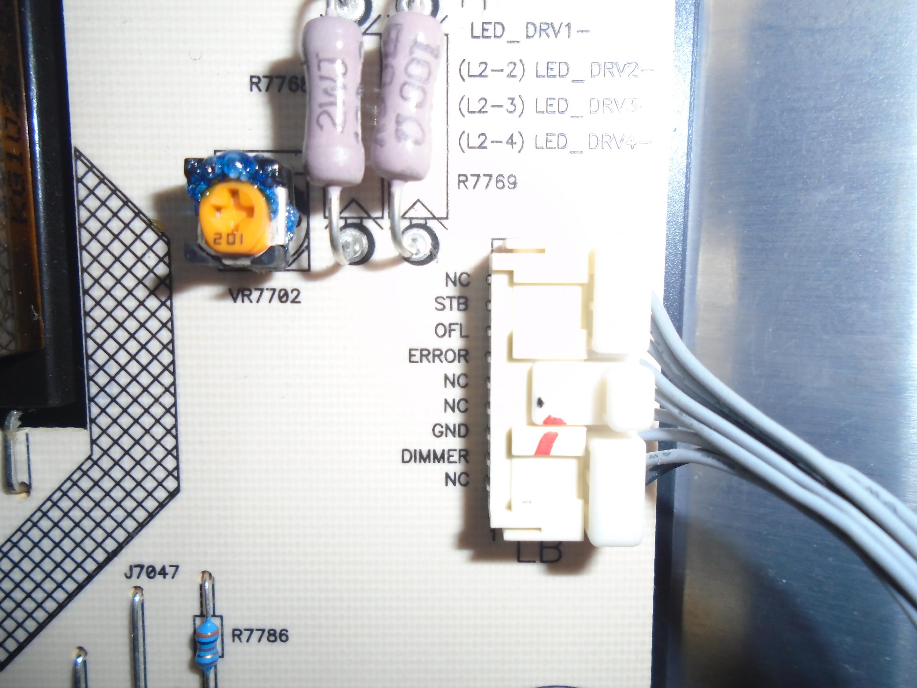

            Recently someone said that the one of the pins on the pot had become detached and with soldering it back into place brought the Leds back on. Can't remember the model but I see there a pot alongside the Led connector in your photo.
                  i will check that area again and report back thanks
